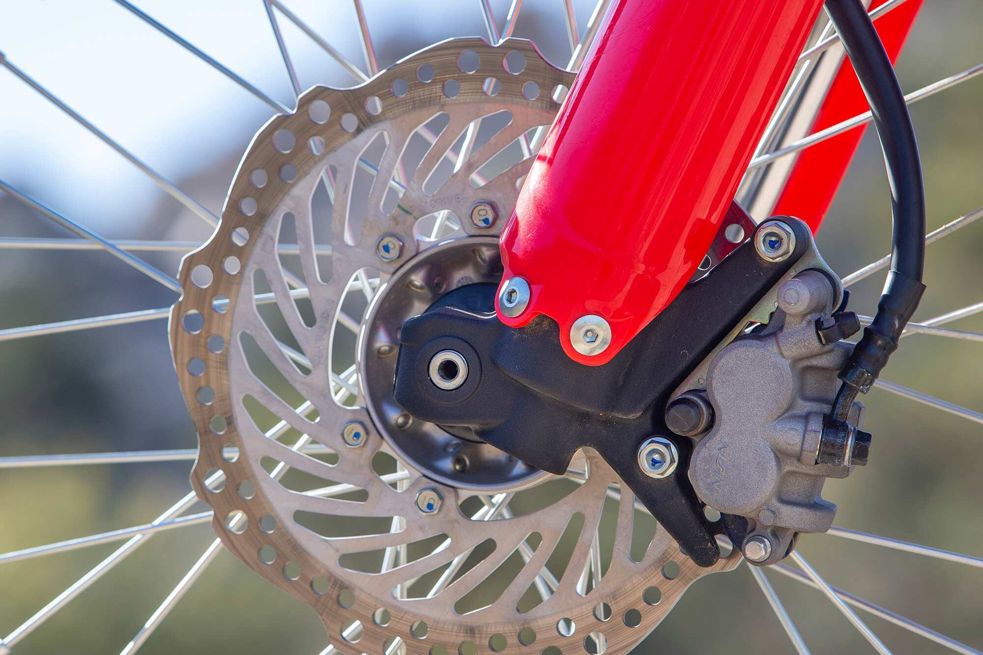

Despite having a Nissin two-piston caliper and 256mm disc (just 4mm smaller than Honda’s motocross and off-road models), the CRF300L’s front brake leaves something to be desired. It’s not strong or progressive enough for our liking.
Despite having a Nissin two-piston caliper and 256mm disc (just 4mm smaller than Honda’s motocross and off-road models), the CRF300L’s front brake leaves something to be desired. It’s not strong or progressive enough for our liking. (Jeff Allen/)
Ground clearance is acceptable at 11.2 inches, allowing for rough play. However, a skid plate would be a good idea; for that you’ll need to turn to the aftermarket. The only other obvious area in need of improvement, chassis-wise, is the front brake. The Nissin two-piston caliper and 256mm disc feels timid and vague, not really delivering strong or progressive action. To be fair, this occurred only when pushing the bike at a quicker pace, perhaps a bit faster than its intended use case. On the other hand, the single-piston rear brake caliper and 220mm disc is quite sensitive with offered consistent feel, predictable progression, and the capability of easily locking up the rear wheel at any speed.
