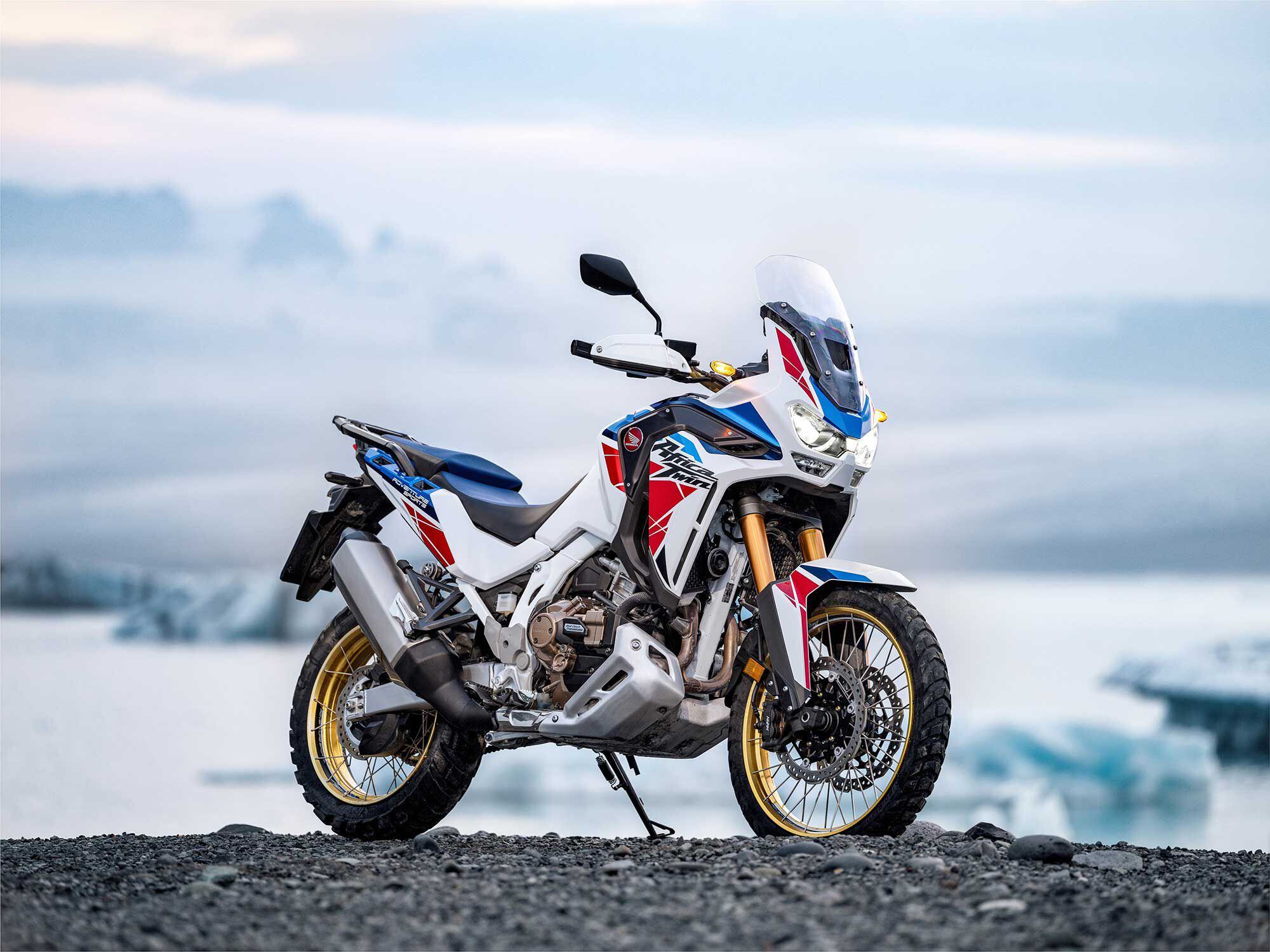

While perhaps not particularly well known in North America, Honda’s original XRV650 Africa Twin stormed the European crossover market some 30 years ago and held its class-leading position until passing the torch to the CRF1000L Africa Twin in 2016. While the two machines shared a name and the basic concept of the high-versatility dual sport/adventure bike, their individual executions of that idea are radically different and perfectly representative of their eras.
The original bike was a svelte 52-degree V-twin. The current machine is a counterbalanced parallel twin with a 270-degree crankshaft; in addition to its versatile chassis geometry and a smooth, flexible, powerful engine, there’s also the option of Honda’s automatic Dual Clutch Transmission (DCT), which greatly assists the rider in demanding off-road sections. In 2018, with a few technical updates, the Adventure Sports version was added to the mix.

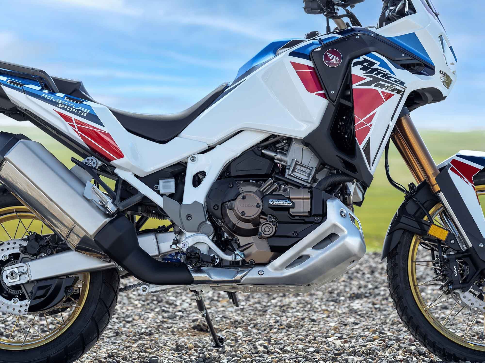

For 2022 both the standard Africa Twin and the Adventure Sports model benefit from technical updates designed to keep them atop their market segment. According to information released in Europe, the fully Euro 5 homologated 2022 engine now displaces 1,084cc, up from the original’s 998cc. The increase comes from a longer stroke, up from 75.1mm to 81.5mm; the bore remains unchanged at 92mm. With the larger engine, output increases from 94 to 101 hp, at the same 7,500 rpm, while peak torque went up from 73 to 77.5 pound-feet at an equally unchanged 6,250 rpm.
The substantial peak-torque increase also fattens the whole torque curve from 2,500 rpm onward. The extra power and torque don’t come from the extra displacement alone. New cam timing and an increase in valve lift (from 9.2 to 10.1mm intake and from 8.6 to 9.3 exhaust) play a significant role, as does increased volumetric efficiency thanks to 46mm throttle bodies, reshaped inlet runners, and repositioned injectors. The engine retains its compact, efficient Unicam SOHC layout and twin-plug ignition, and the exhaust system now includes a new variable exhaust valve.

Honda’s DCT engine paired to the Africa Twin Adventure Sports model is well suited for touring.
Honda’s DCT engine paired to the Africa Twin Adventure Sports model is well suited for touring. (Honda/)
