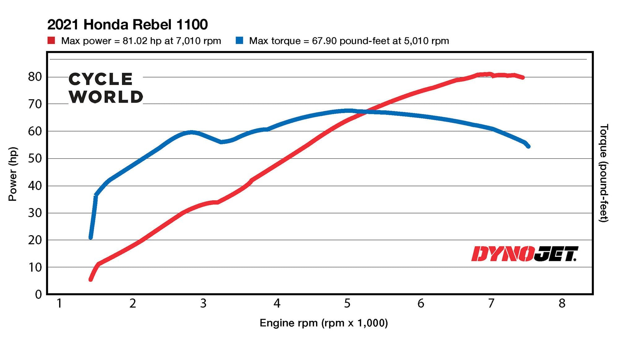

Horsepower and torque figures of the 2021 Honda Rebel 1100 measured on the <i>Cycle World</i> dyno.
Horsepower and torque figures of the 2021 Honda Rebel 1100 measured on the <i>Cycle World</i> dyno. (Robert Martin Jr./)
Standard to the Cycle World testing protocol, we ran the Rebel 1100 on our in-house Dynojet 250i dyno recording horsepower and torque figures. The Honda produced a peak 81.02 hp at 7,010 rpm and 67.90 pound-feet of torque at 5,010 rpm. For reference, that’s double the 40.8 hp of the Rebel 500.
It is undeniably a large jump in performance from the less-powerful small-bore Rebel models, but a look at the linear power delivery and rider-friendly nature still make it an approachable cruiser model. As Honda planned, it offers room for less-experienced Rebels to grow and veterans to enjoy.
