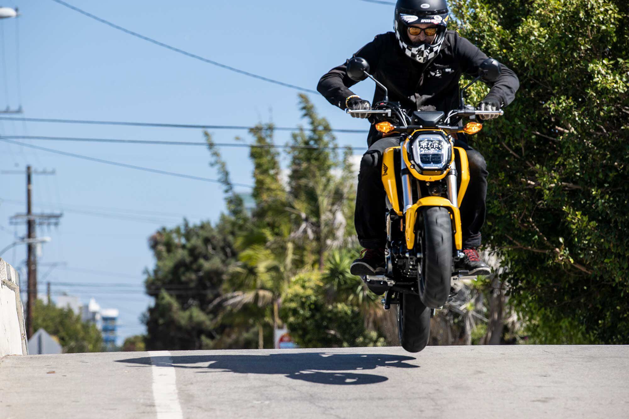

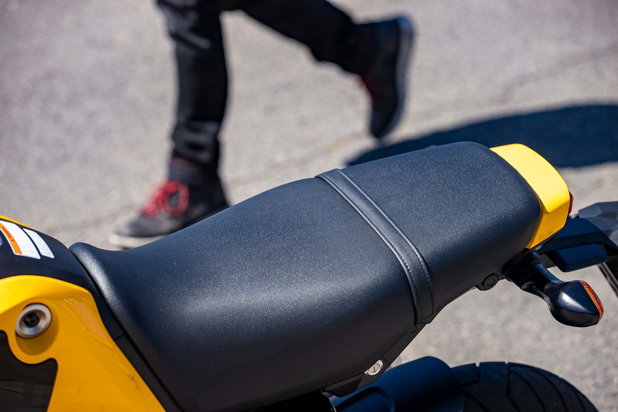

At 6-foot-4, I never expected to fit on a Grom. Anyone who happens to catch a glimpse of me on the thing is practically obligated to toss off a Grape Ape or Shriners joke. But the freshly redone ergonomics make the little bike a joy to ride. The new seat is longer, more cushioned, and totally flat, still providing room for a passenger but allowing a solo rider to slide back on the seat more easily. The new seat sits atop a new subframe, one slightly smaller than before and now removable. Small jaunts around town and one-hour-long rides across Los Angeles were both surprisingly comfortable and easy.
Despite, or perhaps because of, its small size, the Grom is incredibly well suited for city riding and congested environments.

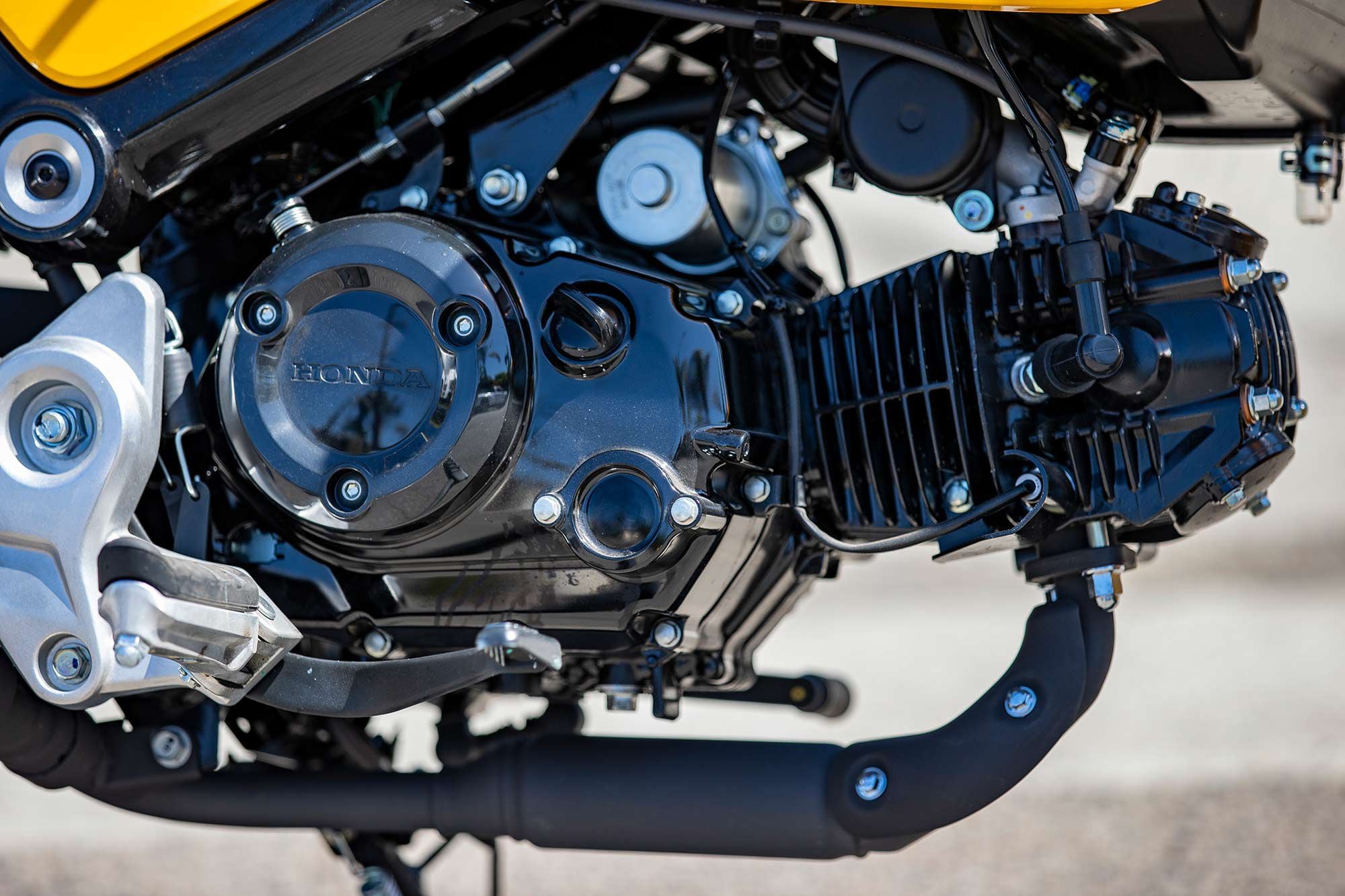

And this year, it’s a slightly faster little Honda. In updating the engine, Honda wanted to make it more fuel efficient and more easily maintained at home. It achieves this, partially, with a removable oil filter, compared to past models where owners would just clean the oil spinner and screen. A larger airbox also increases intervals between maintenance, as Honda claims it will only need to be changed every 10,000 miles in “normal riding conditions.”
The engine now features a slightly longer stroke and smaller bore, as well as a compression ratio bump from 9.3:1 to 10.0:1, a recipe for torque and engine response. That comes despite a claim of lower fuel consumption on average and some pretty significant changes to the bike’s gearing.

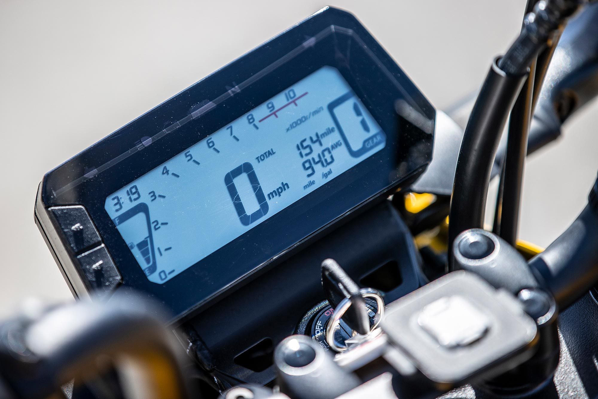

The 2022 Grom now has a gear position indicator in the top right corner of its digital gauge.
The 2022 Grom now has a gear position indicator in the top right corner of its digital gauge. (Jeff Allen/)

The most notable updates for the 2022 Grom happen inside the engine, with higher compression, new bore and stroke dimensions, and the addition of a fifth gear.
The most notable updates for the 2022 Grom happen inside the engine, with higher compression, new bore and stroke dimensions, and the addition of a fifth gear. (Jeff Allen/)

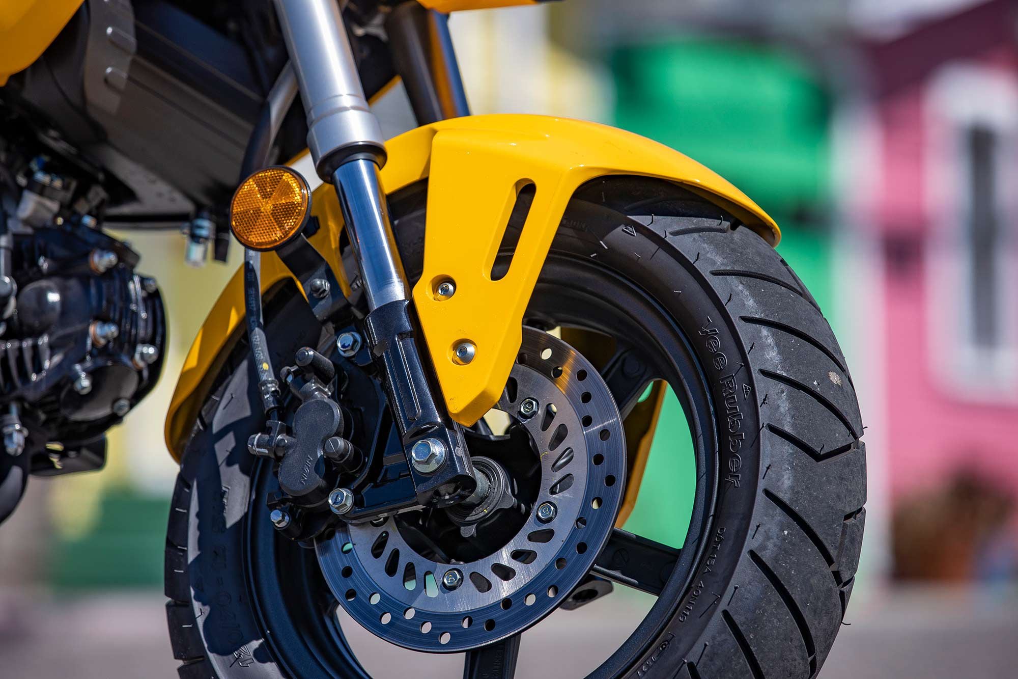

Suspension and braking components on the Grom remained unchanged, keeping the MSRP the same as last year and leaving room for the aftermarket.
Suspension and braking components on the Grom remained unchanged, keeping the MSRP the same as last year and leaving room for the aftermarket. (Jeff Allen/)
Braking
As with the suspension, the braking components remain unchanged on this third generation of Grom. The bike is of course light, so its dual-piston caliper grips the front 220mm rotor with plenty of strength and good feel at the lever. The rear single-piston caliper and 190mm rotor work just fine as well, easily bringing the Grom’s 228 pounds (weight measured full of gas, ready to ride) to a halt.

Ergonomic revisions to the Grom include a more cushioned seat that replaces the earlier contoured shape with a long, flat one.
Ergonomic revisions to the Grom include a more cushioned seat that replaces the earlier contoured shape with a long, flat one. (Jeff Allen/)

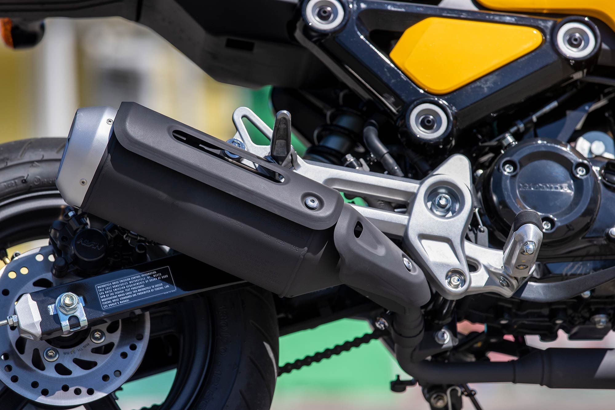

To more easily accommodate aftermarket mufflers, the Grom’s exhaust system is now two pieces.
To more easily accommodate aftermarket mufflers, the Grom’s exhaust system is now two pieces. (Jeff Allen/)
