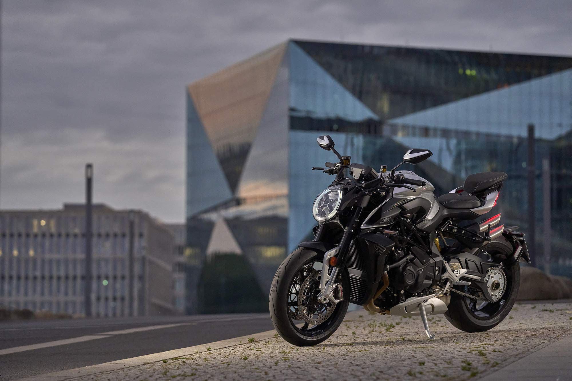

MV Agusta’s latest Brutale 1000 RS aims to be a little more approachable and a little more accommodating for long-distance riders.
MV Agusta’s latest Brutale 1000 RS aims to be a little more approachable and a little more accommodating for long-distance riders. (MV Agusta/)

Brutale 1000 RS visual differences include new five-spoke wheels, the handlebar configuration, and the seating. Suspension is Marzocchi up front and Sachs in the back.
Brutale 1000 RS visual differences include new five-spoke wheels, the handlebar configuration, and the seating. Suspension is Marzocchi up front and Sachs in the back. (MV Agusta/)

The Brutale is aptly named: Has a family of motorcycles ever looked as deliberate, exotic, aggressive, and densely muscular as the current lineup?
The Brutale is aptly named: Has a family of motorcycles ever looked as deliberate, exotic, aggressive, and densely muscular as the current lineup? (MV Agusta/)
