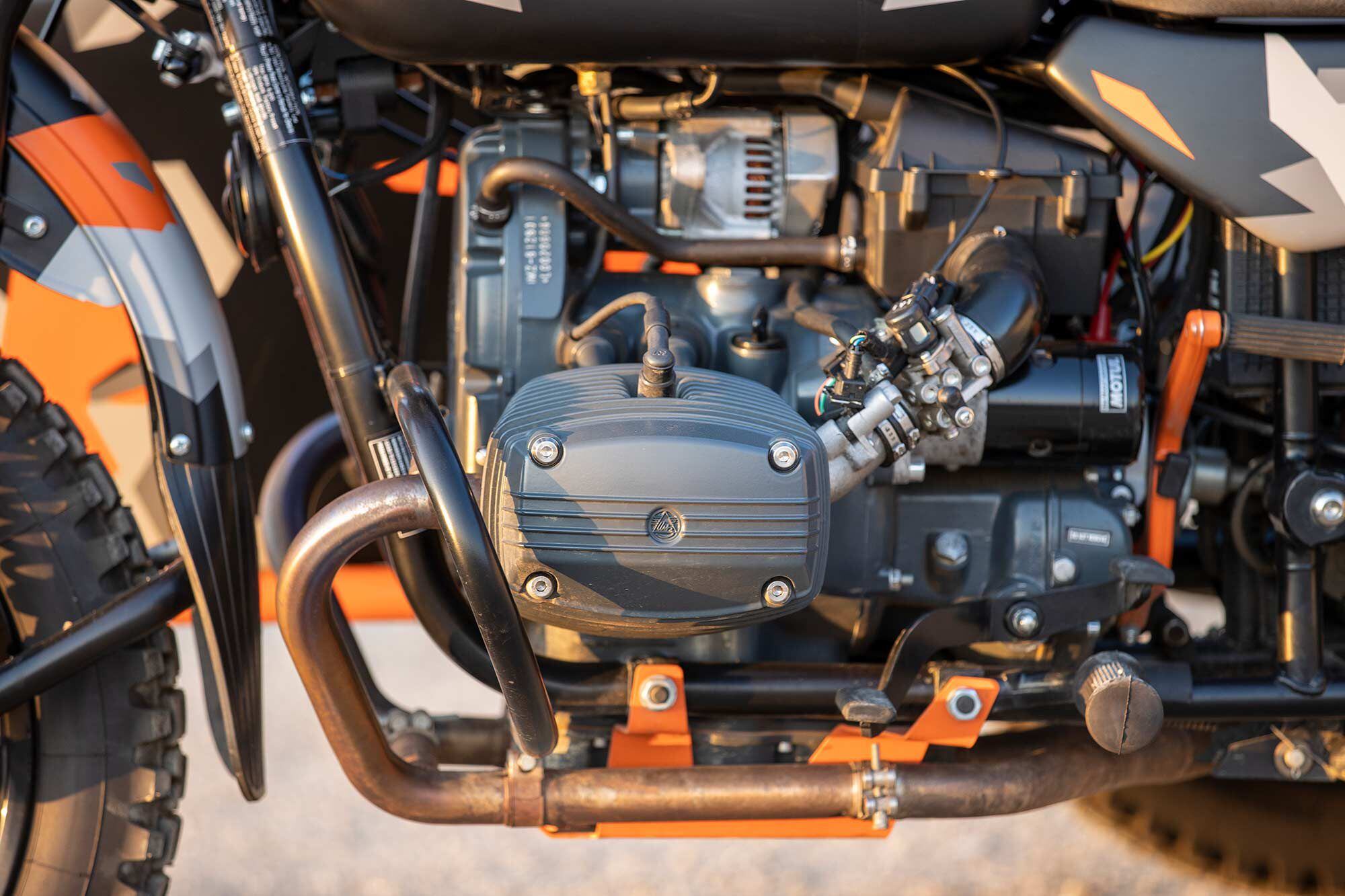

Powered by an air-cooled 749cc pushrod boxer with 41 hp and a minimal sprinkling of modern niceties such as fuel injection, the Gear Up Geo feels vintage in a good way. You can hear the pushrods and rocker arms doing their thing. Fueling, especially on start up, is not what you would call refined. Sometimes the battery feels like it’s on its last leg, though the engine always kicks off. It’s a coin flip whether or not the check engine light will be on. But the G.U.G. runs every time. And every time is a good time.

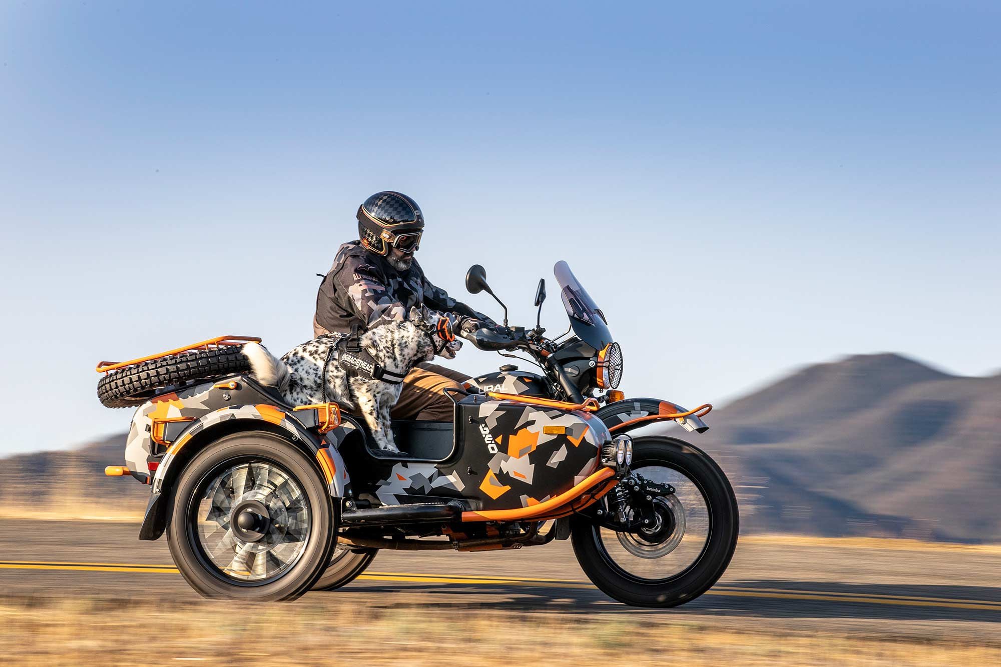

As long, that is, as you take your time. Just enjoy the ride. It’s not fast, but it’s quick enough from between intersections to stay out of the way of most anything with more wheels than you. During light-to-light rips, you pay more attention to the heel/toe shifter than anything else. Shifts, only three possible in total, must be made deliberately and sternly when blasting to 65 mph. This Ural will go faster than that, up to around 80, but not one single bit of the Ural is happy at that speed; the engine feels like it will throw a rod at any second, and the chassis is busier than usual. Stay in the slow lane. Nod and wave at all the people taking photos. You are your own little parade; consider filling the sidecar with candy and tossing it to pedestrians. Enjoy the vibe.

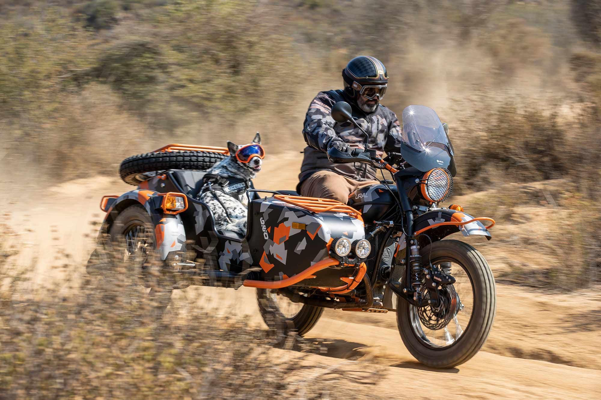

Mark Hoyer, Cycle World’s indefatigable boss, once described riding a Ural as wrestling a seizure-prone three-legged bear drunk on vodka. That’s apt. Normal motorcycle physics do not apply here, but oh man are there plenty of physics. When turning left you push against the sidecar wheel, causing understeer, while the steering becomes as heavy as that Russian bear. At least it feels stable; going right, on the other hand, is a balancing act. Traction from two tires bearing most of the motorcycle’s weight make the left side of the motorcycle much lighter than it is, which in turn makes the sidecar lift into the air if you turn too sharply for your speed. It’s fun when you want to fly the car, but you must always be aware of the forces in play. It helps to have a passenger, in my case a 50-pound Australian cattle dog named Gracie.
Having some weight in the sidecar helps with stability in right-hand corners.
Having some weight in the sidecar helps with stability in right-hand corners. (Jeff Allen/)

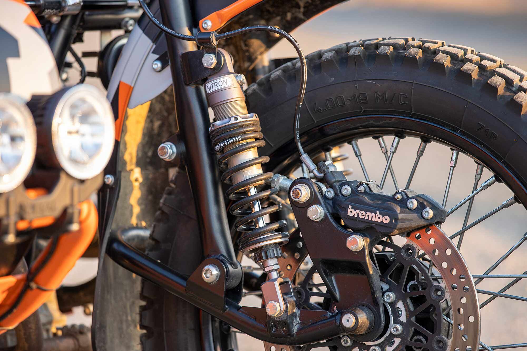

With a total of five fully adjustable Nitron shocks on the leading-link front suspension, swingarm, and sidecar, the ride is much improved over a standard Gear Up. Small bumps are soaked up without a shudder through the chassis and large bumps don’t upset the bear cart. Bottoming resistance is greatly improved, which is beneficial on and off-road. On the street the G.U.G. is composed as a three-wheel Russian motorcycle can be. Off-road it’s a blast—a handful, but a blast nonetheless.
Suspension action is greatly improved on the Geo on and off-road.
Suspension action is greatly improved on the Geo on and off-road. (Jeff Allen/)
Engage the two-wheel-drive lever (yes, 2WD!) to lock the rear wheel to the sidecar wheel via a shaft and you have plenty of drive in the sand and loose dirt. Snow and mud, I assume, would also be no problem, though our dry California summer didn’t afford us the opportunity. Blasting right-handed berms are possible with a brake slide followed by a wide-open throttle and a clutch dump. When going left, though, just take your time, lest you end up on your side with an angry passenger. If you get stuck, no worries; just throw the Geo in reverse and back right on out with both rear tires pulling you out of whatever you have gotten into.

Ural finally switched to disc brakes as of 2016, and stopping power from the four-piston Brembo caliper up front is strong. At the rear a single-piston HB Big Bore caliper is linked to a Brembo single-piston unit on the sidecar; both offer plenty of power with excellent feel and modulation, though the lever travel is quite long. And ABS, you ask? Just like traction control, it’s not an option.
