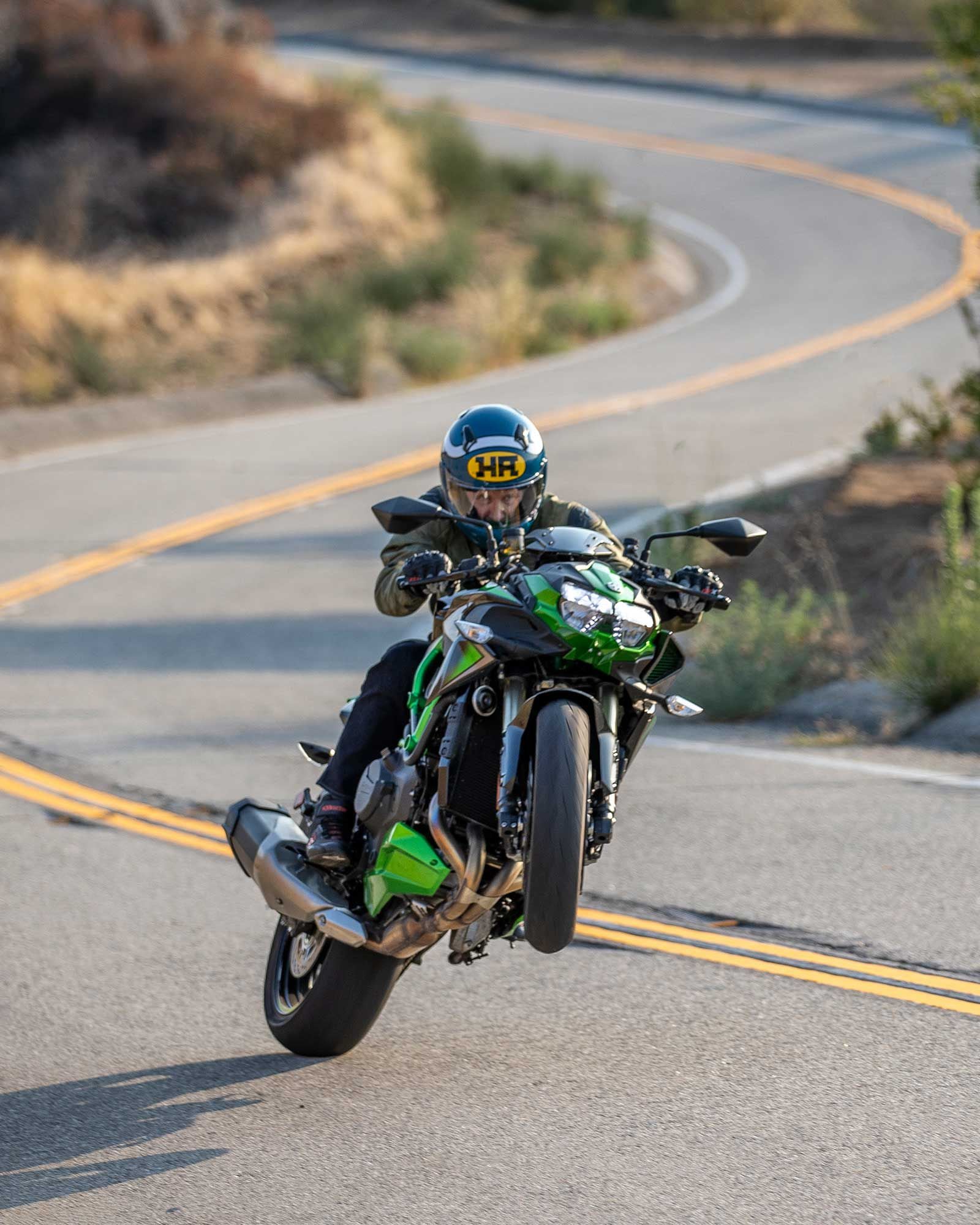

Is the 2021 Kawasaki Z H2 SE an unruly beast? Only when you want it to be.
Is the 2021 Kawasaki Z H2 SE an unruly beast? Only when you want it to be. (Jeff Allen/)
“Dude,” said Michael Gilbert, Cycle World’s road test editor. “This thing is a beast! Do your best to avoid complications with... The Law.”
That was my warning upon taking delivery of the 2021 Kawasaki supercharged Z H2 SE. I’d spent many years testing at CW, racing top superbikes and World Endurance machines, and helping to develop many streetbikes for Honda including the RC211V, so naturally I thought  it couldn’t be that good.

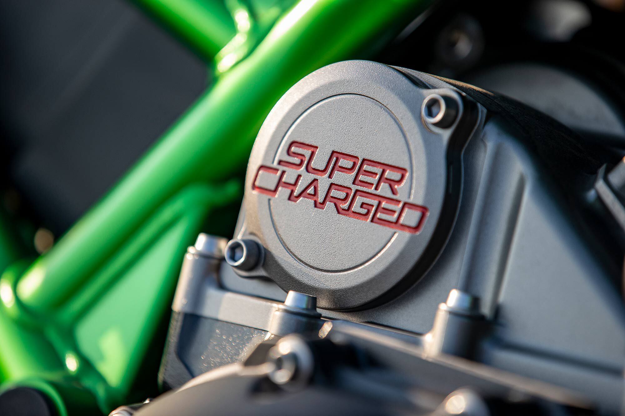

Thumbing the engine to life, I immediately noticed the deep growl coming from the H2′s left side, where a fairing-mounted intake directs cool air into a 110,000-rpm supercharger. I cautiously worked my way out of the parking lot to the freeway. The power of this bike is, honestly, very subtle and smooth. But once I had some open space in front of me, I got a small taste of that power’s ungodly wrath as the H2 yanked my arms forward with diabolical acceleration on the way to a much higher speed than I should have been doing.
The supercharger on the Z H2 spins at 110,000 rpm at full boost.
The supercharger on the Z H2 spins at 110,000 rpm at full boost. (Jeff Allen/)

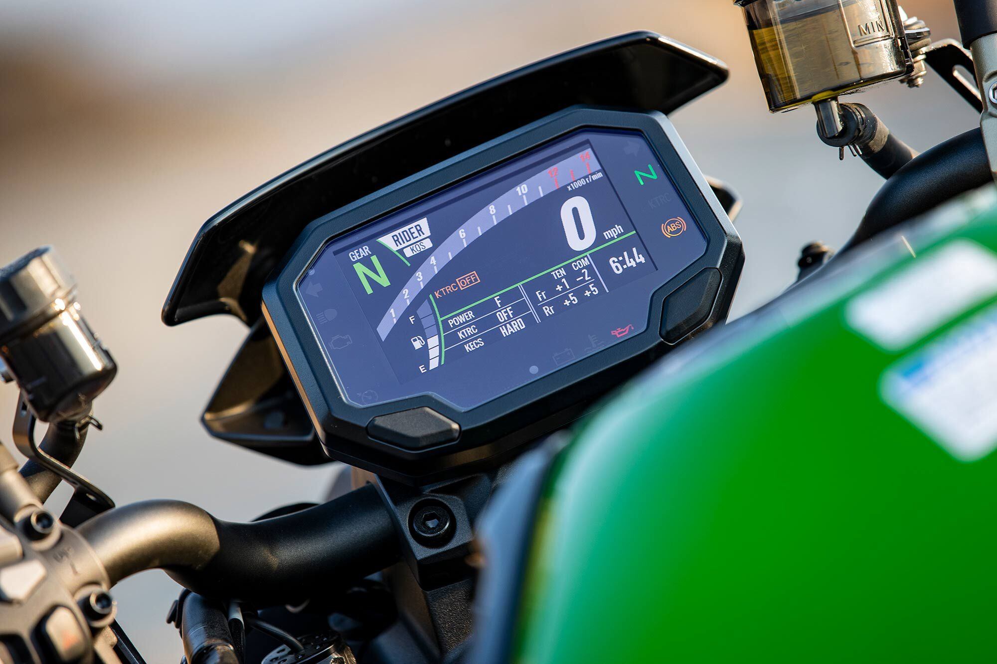

Maybe Michael and Justin were on to something. But this bike’s not all brains and no brawn. This is a pretty cool bike that features many sophisticated rider aids along with behind-the-scenes electronics. There’s a semi-active Kawasaki Electronic Control Suspension (KECS) system monitored by an Inertial Measurement Unit (IMU)-enhanced electronics package, which joins Kawasaki Traction Control (KTRC), Launch Mode (KLCM), and the Intelligent antilock Brake System (KIBS) as the inputs for Kawasaki Cornering Management Function (KCMF). This family of systems incorporates multiple engine and chassis sensors to help facilitate smooth cornering and help keep the rider out of trouble.
Sound like pretty trick stuff? It is. From a rider adjustment side and as with many top-level premium models, practically everything on the H2, aside from having manual front and rear spring preload adjustment, is electronically controlled and adjustable via the handlebar-mounted controls; the relevant sequences and windows are shown on a well-laid-out 4.3-inch TFT color meter display. And while it all sounds like a lot, the whole process ended up being pretty simple after I spent some time reading the owner’s manual and practicing.
There is a lot of info communicated through the Z H2 SE’s dash.
There is a lot of info communicated through the Z H2 SE’s dash. (Jeff Allen/)

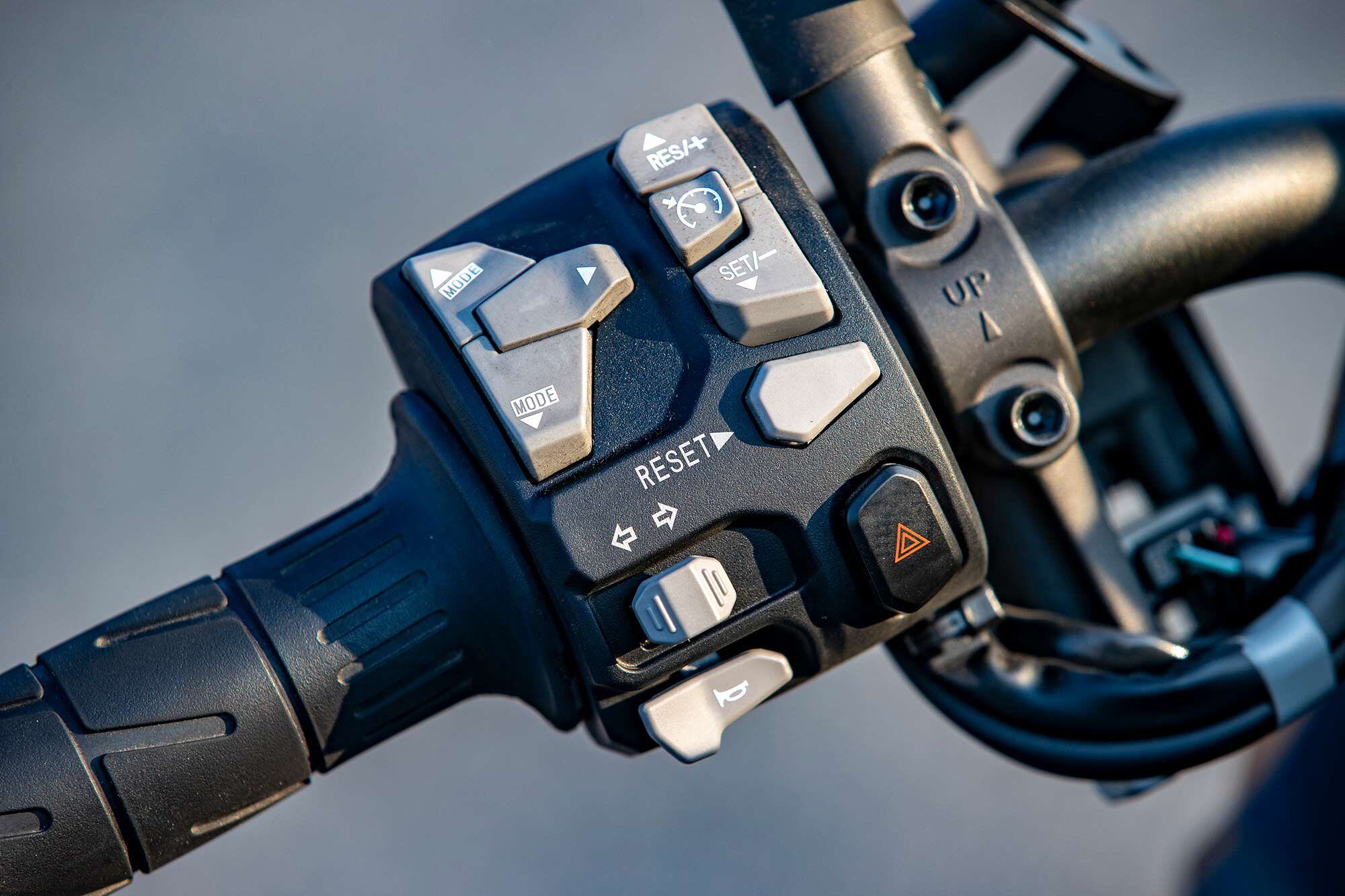

With all buttons, screens, and functions sussed out, I was off to my old endurance training roads in the mountains. Programming a softer suspension setting for a 40-mile freeway ride was simple. The H2 has three preprogrammed ride modes, Sport, Road, and Rain; like most modern ride modes, these have presets for power, traction control, and suspension to appropriately match conditions. The H2 also features three different programmable “Rider” settings, for which Hard, Normal, and Soft suspension settings are determined by the rider. Power levels and traction control can also be changed in Rider mode, which is convenient as it allows, say, a fast-ride suspension setting (Hard), around town/passenger setting (Normal), and a freeway setting (Soft) that can be changed in seconds without tools or even getting off the bike. You just have to be at a full stop. I’m starting to think technology is a good thing.
Your left thumb will get a workout while setting up the Z H2’s suspension, modes, and cruise control.
Your left thumb will get a workout while setting up the Z H2’s suspension, modes, and cruise control. (Jeff Allen/)
Once I pushed all the correct buttons to adjust the front and rear damping to full soft on the 43mm Showa Skyhook EERA (Electronically Equipped Ride Adjustment) fork and shock, I was off on a cushy freeway jaunt. The H2 provides a rock-solid ride in a straight line with softer damping, but it’s pretty bouncy in the rear and wallows around on the sweeping, bumpy interchanges, even at legal speeds. It wasn’t long before I added some damping back in the shock. But while on the straight freeway I finally had an opportunity to see what the H2 has in the engine department.

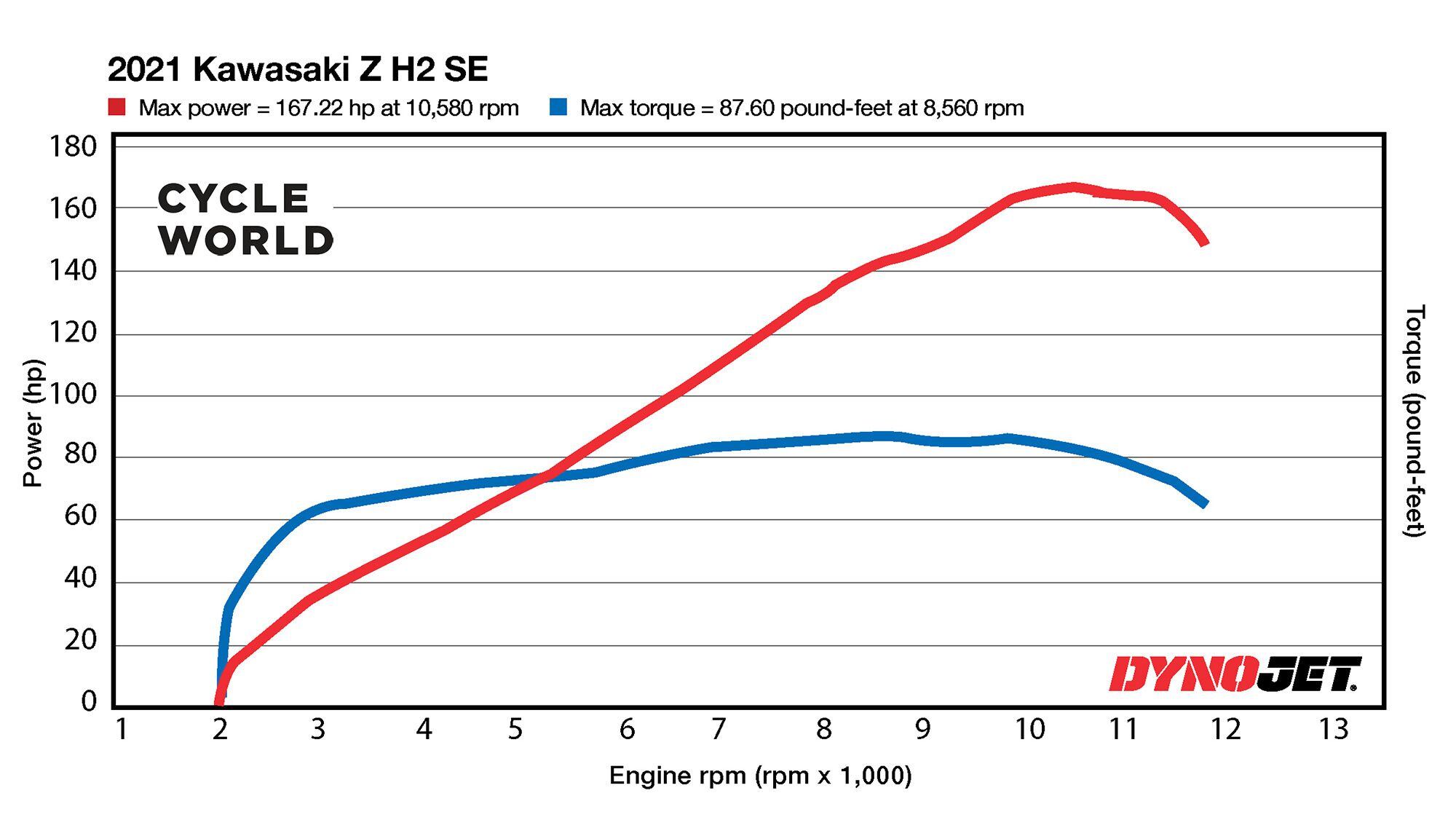

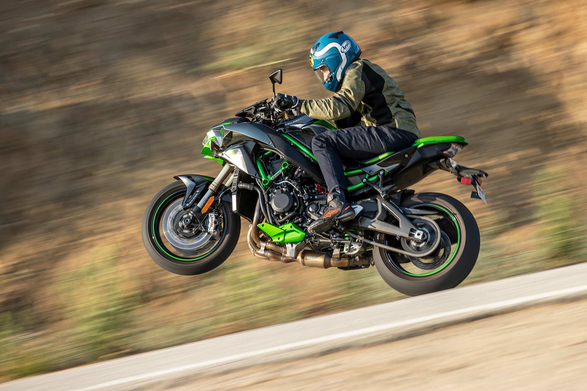

What it has is truly amazing. The H2 easily lofts the front wheel in third gear with a little provocation, but make absolutely sure there’s nothing in front of you. The H2 catapults a rider into warp speed almost instantly—and then it keeps accelerating very, very quickly. On the CW Dynojet dyno this bike cranked out 167.2 hp at only 10,580 rpm and 87.6 pound-feet of torque at a 8,560-rpm peak. To say it “peaks” may actually be a bit misleading; the H2 has an almost electric torque feel starting from 2,000 rpm and basically adds 20 hp with every 1,000 rpm. Resisting any further speed temptation, if you really want to, is quite simple. Just set the cruise control with the push of two buttons.
At the base of the mountains, I quickly and easily changed to my Rider Hard setting and got to work on suspension settings to see how the Beast handles those 533 pounds. There are four traction control levels: Off, plus 1, 2, and 3. Maximum TC is more suited for rain and slippery surfaces and feels similar to Rain mode. At this level the bike won’t lift the front wheel; once a difference between front and rear wheel speeds is detected, it instantly turns down the power. The TC is very seamless, merely feeling like a weak engine. Settings 1 and 2 are less intrusive; it’s still relatively easy to activate the TC but it’s pretty transparent. I still preferred TC to be off, even with worn-out tires.
On the <i>Cycle World</i> dyno the 2021 Z H2 SE put out 167.2 hp to its 190 rear tire.
On the <i>Cycle World</i> dyno the 2021 Z H2 SE put out 167.2 hp to its 190 rear tire. (Robert Martin Jr./)

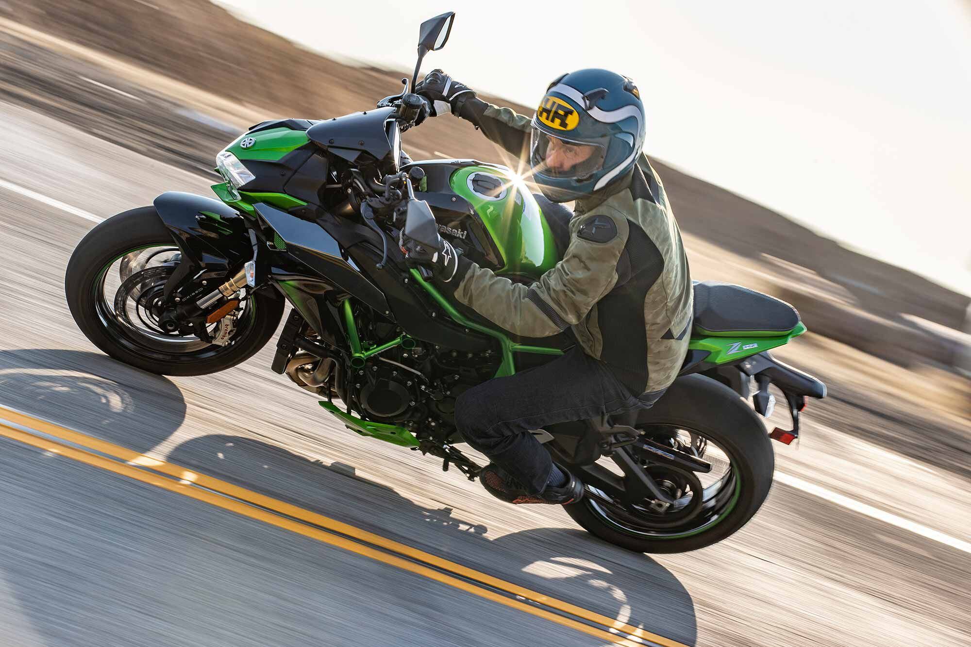

In the end, my final suspension settings for a 5-foot-10, 165-pound rider on winding mountain roads were shock preload at plus 1.25 turns more preload, with compression and rebound damping maxxed out; the fork settled in at minus two turns of preload from stock, with compression at minus two and rebound at plus one. I would’ve liked to have increased shock preload to further improve steering and control rear bump absorption but, the lack of available rebound damping was the limiting factor here. I also lowered the tire pressures from the manufacturer’s recommendation of 36/42 psi front/rear to 30/30 psi; these lower tire pressures provided a more subtle ride along with a bigger contact patch and, since I wasn’t going warp speed, I didn’t need the added tire stiffness the higher pressures provide.
With the ability to change the suspension settings to your liking, you can get the Z H2 to behave well in the mountains as well as on freeway hard slab.
With the ability to change the suspension settings to your liking, you can get the Z H2 to behave well in the mountains as well as on freeway hard slab. (Jeff Allen/)

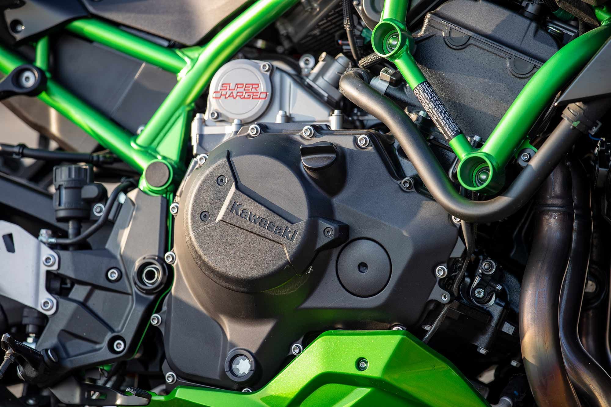

With TC handled, power set to Full, and suspension settings dialed in, the fun factor increased exponentially. The engine has so much usable torque and bottom/midrange power after 3,000 rpm that I found myself using third gear in slower, 35–40 mph uphill corners and forcefully driving out, painting black stripes with the rear tire. The ultraslick Kawasaki Quick Shifter (KQS) and the dog-ring transmission made it easy to  short-shift quickly through the six-speed gearbox. No more time lag of pulling in the clutch and/or backing off the throttle to upshift; just keep the throttle pinned and click through the gears for a sweet sound as the H2 smoothly catapults you forward without ever upsetting the chassis. Downshifting with the KQS with assist and slipper clutch is usually ultrasmooth while sporty riding on the mountain, though when going easy around town the smooth downshifting seems a bit inconsistent at times.
A 998cc DOHC inline-four force-fed by a centrifugal supercharger powers the Z H2.
A 998cc DOHC inline-four force-fed by a centrifugal supercharger powers the Z H2. (Jeff Allen/)

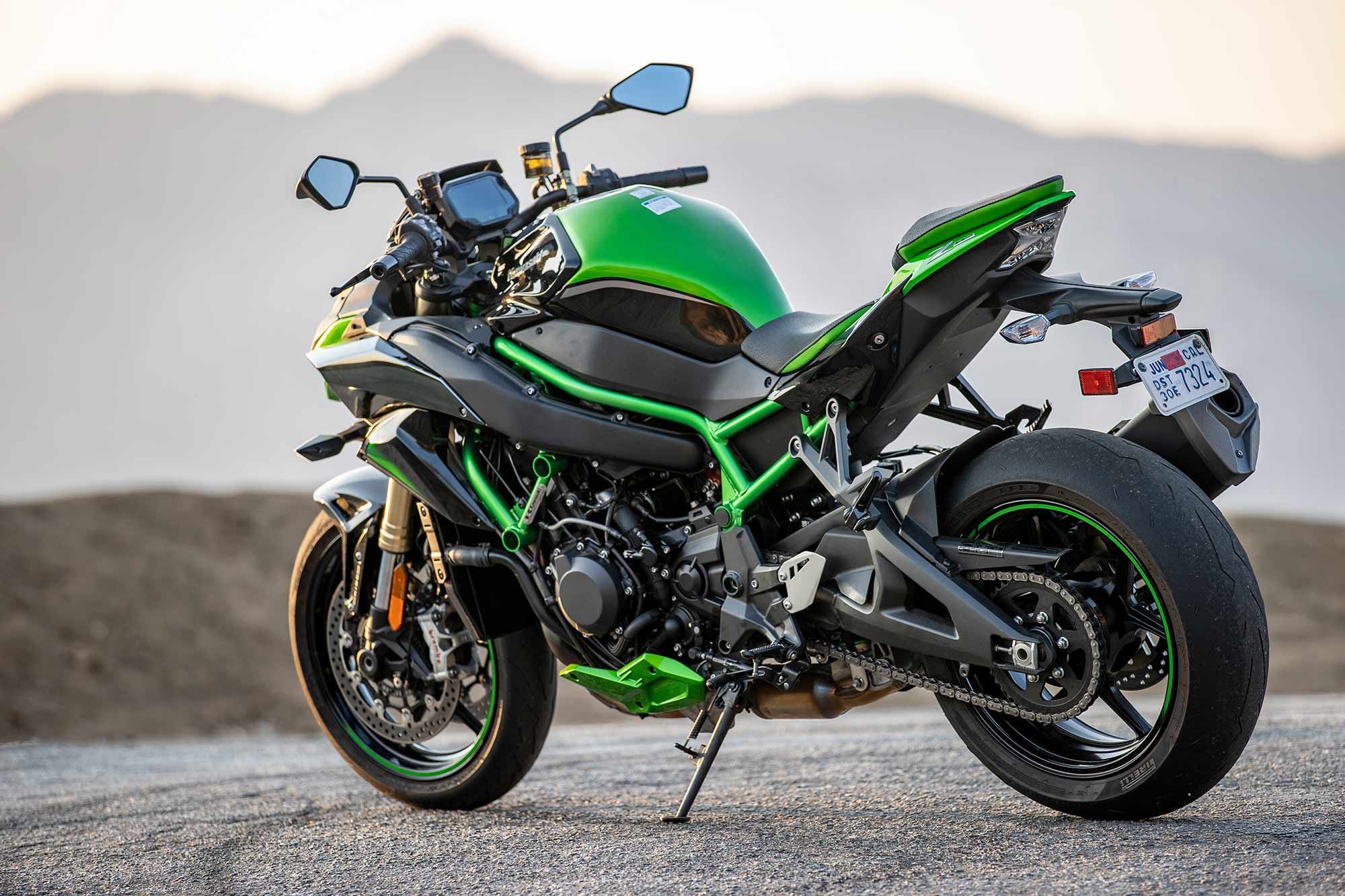

Good as it is, it’s not quite perfect. Better off/on throttle response and a bit more rebound damping in the shock would help elevate the H2′s fun factor. The throttle has a bit of hesitation at the initial opening from fully closed, creating a small delay; it’s not too disrupting, and doesn’t upset the chassis, but it is noticeable. Smaller change points would be to angle the footpeg kick plates in a bit so the rider could pivot their feet on the footpegs, which would also give the bike a narrower feel. The frame between the rider’s legs is a bit wide, but based on the engine design and architecture, there’s only so much the designers can do. It’s a small price to pay for the H2′s incredible performance and stable handling.
It does have a wild side, but the Z H2 SE  also can be tame as you need it to be.
It does have a wild side, but the Z H2 SE also can be tame as you need it to be. (Jeff Allen/)
Overall, the 2021 Z H2 SE is an amazingly fun machine. The supercharged 998cc engine and familiar trellis frame have been produced since 2015 in various models, including the track-only—and insanely fast—Ninja H2 R, the more comfort-based Ninja H2 SX SE+, and other models with engine and chassis tuning specific for each segment; it’s a well-proven engine/frame combo. In short, this is an amazing street beast with a significant wild side, but like all beasts, it has a softer, gentler side too. Just do your best to avoid complications with The Law.

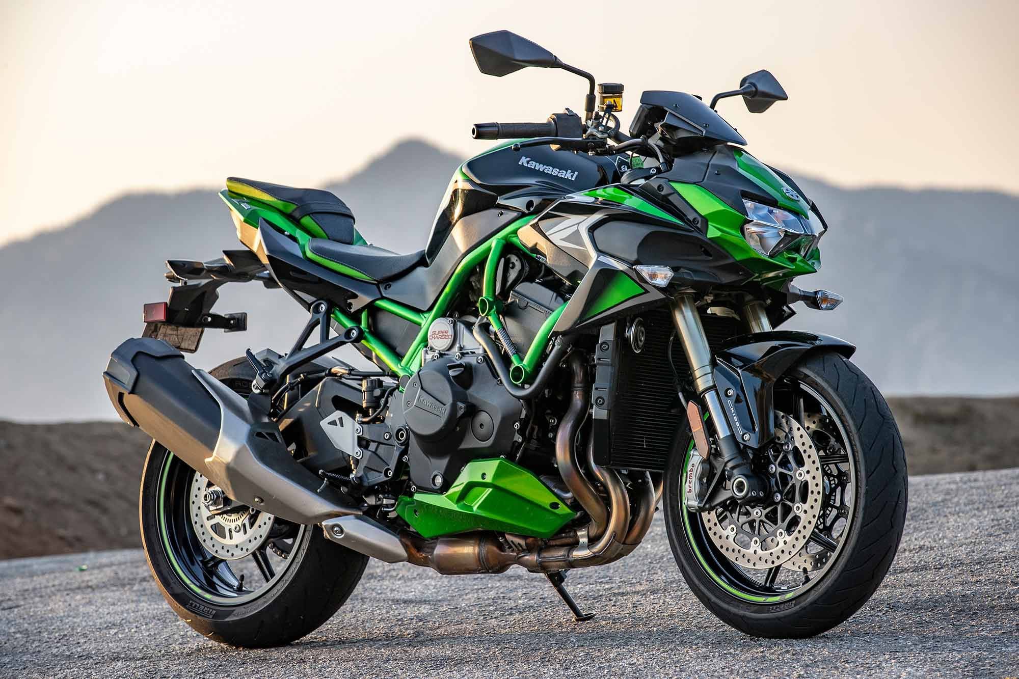

2021 Kawasaki Z H2 SE Specifications
MSRP: $19,700
Engine: DOHC, liquid-cooled, 4-stroke 4-cylinder; 16 valves, supercharged
Displacement: 998cc
Bore x Stroke: 76.0 x 55.0mm
Compression Ratio: 11.2:1
Cycle World Measured Horsepower: 167.2 hp @ 10,580 rpm
Cycle World Measured Torque: 87.6 lb.-ft. @ 8,560 rpm
Fuel System: DFI w/ 40mm throttle bodies
Engine Management/Ignition: TCBI w/ Digital Advance
Frame: Tubular steel
Front Suspension: 43mm Showa SFF-BP; KECS compression and rebound damping, spring preload adjustable; 4.7 in. travel
Rear Suspension: Showa shock; KECS compression and rebound damping, spring preload adjustable; 5.3 in. travel
Front Brake: Radial-mount Brembo Stylema Monoblock calipers, dual 320mm discs w/ KIBS
Rear Brake: 1-piston caliper, 260mm disc w/ KIBS
Tires, Front/Rear: 120/70-17 / 190/55-17
Rake/Trail: 24.9°/4.1 in.
Wheelbase: 57.3 in.
Ground Clearance: 5.5 in.
Seat Height: 32.7 in.
Fuel Capacity: 5.0 gal.
Cycle World Measured Wet Weight: 533 lb.
