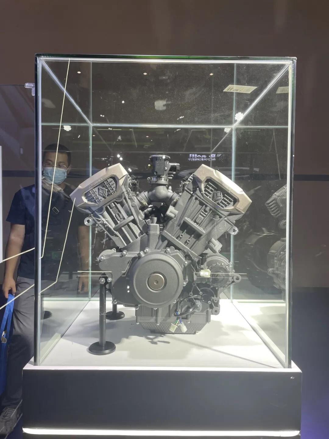

At last week’s CIMA show in China, Benda showed two new V-4 engines, one of which was this 1,198cc version.
At last week’s CIMA show in China, Benda showed two new V-4 engines, one of which was this 1,198cc version. (Benda Motorcycles/)

The two motors are based on the same design but feature very different capacities to span a wide performance range. Both engines are water-cooled 70-degree V-4s with DOHC cylinder heads and 16 valves, featuring an inlet manifold connecting the four intake ports to two electronic throttle bodies. That’s a hint that these aren’t out-and-out performance engines to challenge motors like Ducati’s Desmosedici Stradale or Aprilia’s RSV4 engine, though they’ll still be some of the most impressive four-cylinders to have emerged from China, with the bigger V-4 potentially the most powerful Chinese-made motorcycle engine of all.
The larger version, with the catch name “BD476,” comes in at 1,198cc but has a relatively long stroke and narrow bore when compared to the latest superbike engines. The bore is 76mm and the stroke measures 66mm, giving internal dimensions that match the original 1,200 iteration of Yamaha’s VMAX. The engine’s overall layout is reminiscent of the VMAX motor although this isn’t the sort of out-and-out copy that we’ve seen from some Chinese bikes in the past. Elements like the 11.5:1 compression ratio don’t match the Yamaha’s specs, showing it’s not identical on the inside, either.
The VMAX similarity might also indicate the sort of bike that the engine might end up in. Benda might have plans for a sportbike in the future but its initial offerings have been firmly in the cruiser and street roadster classes. The new 1,198cc V-4 certainly promises plenty of performance for that sort of machine; peak power is 152 bhp at 9,500 rpm, backed up by 89 pound-feet of torque at 7,500 rpm.
