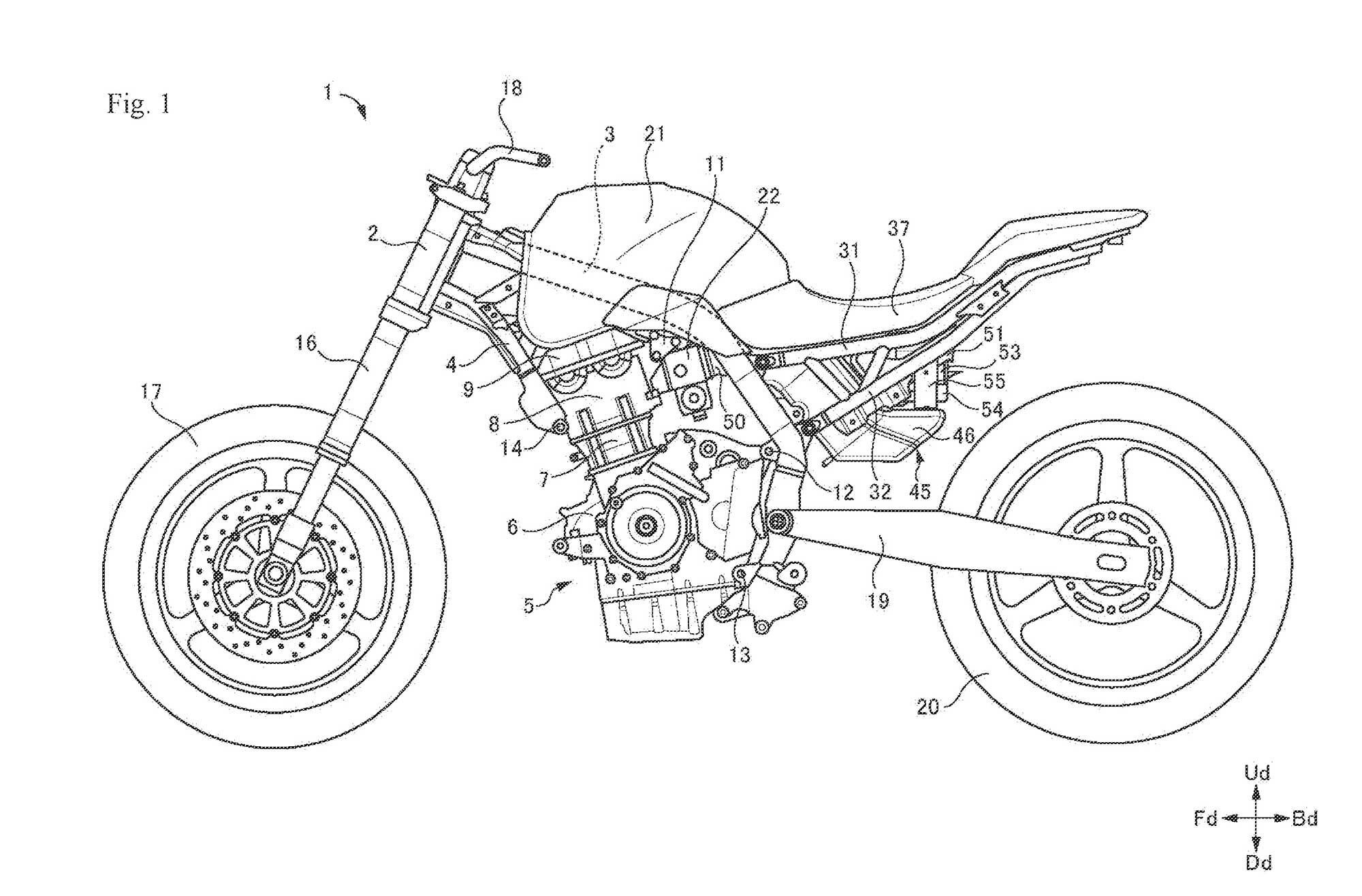

A new patent shows an SV650-style machine built around a DOHC 700cc engine design.
A new patent shows an SV650-style machine built around a DOHC 700cc engine design. (Japanese Patent Office/)

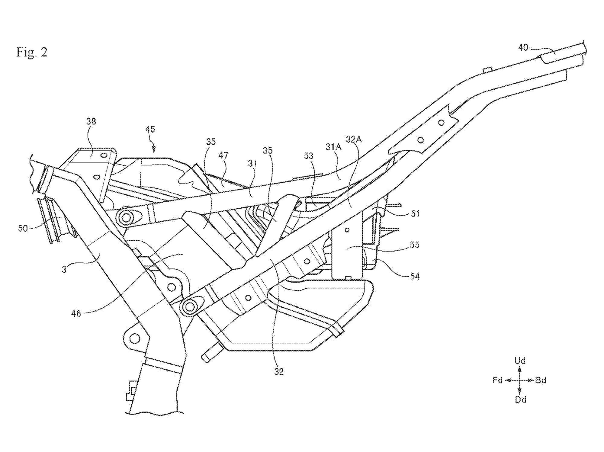

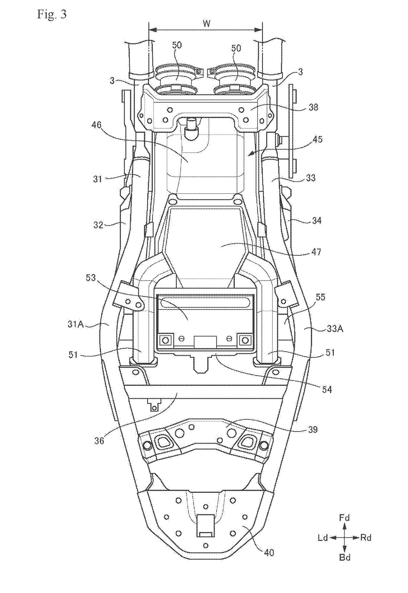

The normally aspirated engine design locates the airbox under the rider’s seat, where it can also support the battery.
The normally aspirated engine design locates the airbox under the rider’s seat, where it can also support the battery. (Japanese Patent Office/)

That location allows more room for the fuel tank as well, though air intakes would now face rearward.
That location allows more room for the fuel tank as well, though air intakes would now face rearward. (Japanese Patent Office/)

Most recently we’ve seen a couple of patents for normally aspirated versions of the engine, and now another has been published that gives a clear look at an SV650-style machine built around the motor.
The latest patent differs from previous ones, showing an unusual arrangement of the airbox to stop it from intruding into the fuel tank area. In previous designs for both the turbocharged and normally aspirated versions of the new engine, the airbox sat above the cylinder head, under the tank, with an intercooler alongside it on the turbo bike. That allowed a very direct route for the air pipework on the turbo version, but clearly restricted the potential size of the tank.

The new design is based around an airbox placed in a new position under the rider’s seat, where it does double duty by also providing a platform for the bike’s battery. Unusually, the layout means that the air intakes face rearward, eliminating any potential “ram air” effect, but the patent points out that the sacrifice is worthwhile as it allows the airbox to be much larger than it would be if mounted under the fuel tank, potentially giving a greater performance advantage than ram air would allow.
With an increasing focus on serviceability, particularly among budget-priced bikes where maintenance costs can be a deal breaker, the underseat airbox design also allows for the air filter to be swapped without removing the tank.
