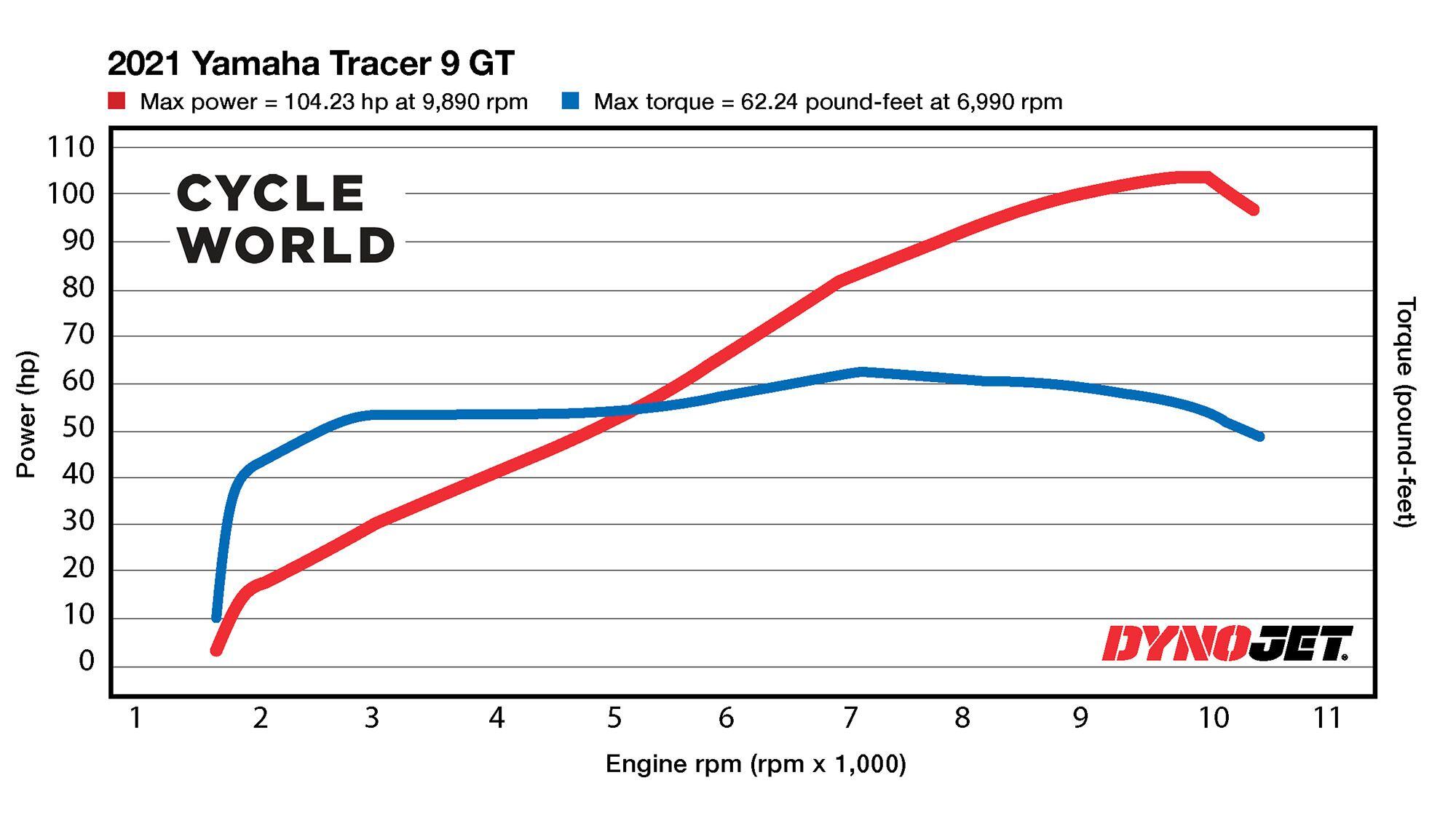

Horsepower and torque figures on the 2021 Yamaha Tracer 9 GT.
Horsepower and torque figures on the 2021 Yamaha Tracer 9 GT. (Robert Martin Jr./)

Following our first experience aboard the Tracer 9 GT, we placed it on our in-house Dynojet 250i dynamometer, recording horsepower and torque figures. The Tracer produced a peak of 104.23 hp at 9,890 rpm and 62.24 pound-feet of torque at 6,990 rpm. The numbers are very similar to the 104.90 hp of the last Tracer 900 GT we tested, but gets a slight bump in torque from its 59.80 pound-feet. It’s also worthy to note that the 2021-model Tracer’s horsepower curve drops off sooner and more aggressively as it approaches its slightly lower 10,500-rpm redline (from 11,200).
