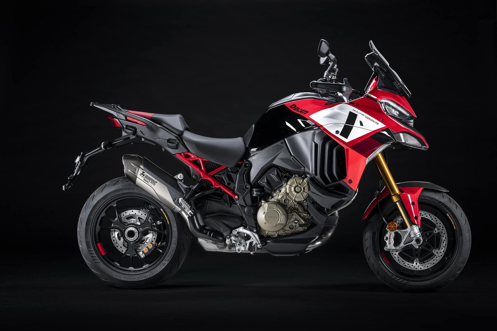

The new Multistrada V4 Pikes Peak takes a Ducati favorite and refocuses it for the pavement with 17-inch wheels and a single-sided swingarm.
The new Multistrada V4 Pikes Peak takes a Ducati favorite and refocuses it for the pavement with 17-inch wheels and a single-sided swingarm. (Ducati/)

New 17-inch Wheels, New Chassis
This new version is an evolution of the Multistrada V4 Sport with revised suspension settings; the engine remains unchanged. The new Pikes Peak rolls on 17-inch wheels front and rear rather than the standard model’s 19-inch front and 17-inch rear combo. The wheels are Marchesini forged aluminum pieces, 6 pounds lighter than the cast aluminum wheels on the Multistrada V4 S and S Sport. In total, the Multistrada V4 Pikes Peak is 9 pounds lighter thanks to the wheels and extensive carbon fiber body components, in particular the front section of the partly redesigned upper fairing, the side panels, and the front mudguard. Further underscoring the new bike’s sporting intent, the wheels are shod with Pirelli Diablo Rosso IV tires, a 120/70-17 front and 190/55-17 rear.

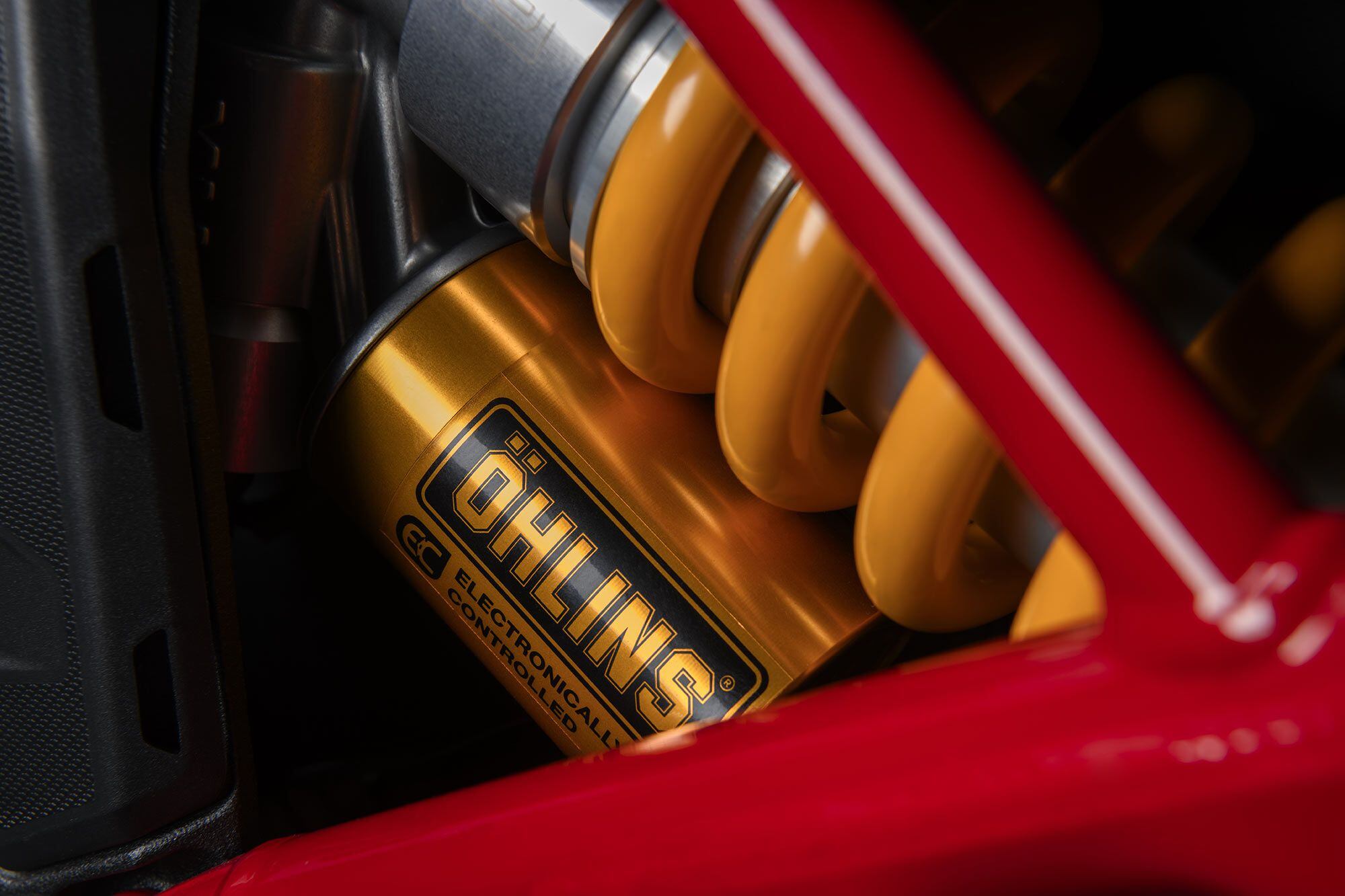

The Pikes Peak model gets Öhlins Smart EC 2.0 suspension front and rear, which should significantly improve handling.
The Pikes Peak model gets Öhlins Smart EC 2.0 suspension front and rear, which should significantly improve handling. (Ducati/)
The Pikes Peak also gets some major suspension upgrades aimed at enhancing its sporting performance on pavement. An electronically managed Öhlins Smart EC 2.0 fork and shock adapt their damping action in relation to the riding style and the road conditions. In addition, the Pikes Peak dispenses with the Multistrada’s conventional swingarm, replacing it with a single-sided piece from the Panigale V4. This is a big change, enhancing the bike’s sporting image more than the new bodywork.
The new wheel sizes required revised chassis geometry. To compensate for the loss of trail, steering rake increased from 24.5 degrees to 25.75 degrees. This means that the front wheel has moved forward and the wheelbase has consequently grown by about an inch. Trail should be back to the original measurement of 105.5mm. Seat height is 33 inches, and the riding posture has been refined by moving the pegs a little higher and farther back, while the lower, narrower handlebar and a new smoked windshield offer protection from windblast.

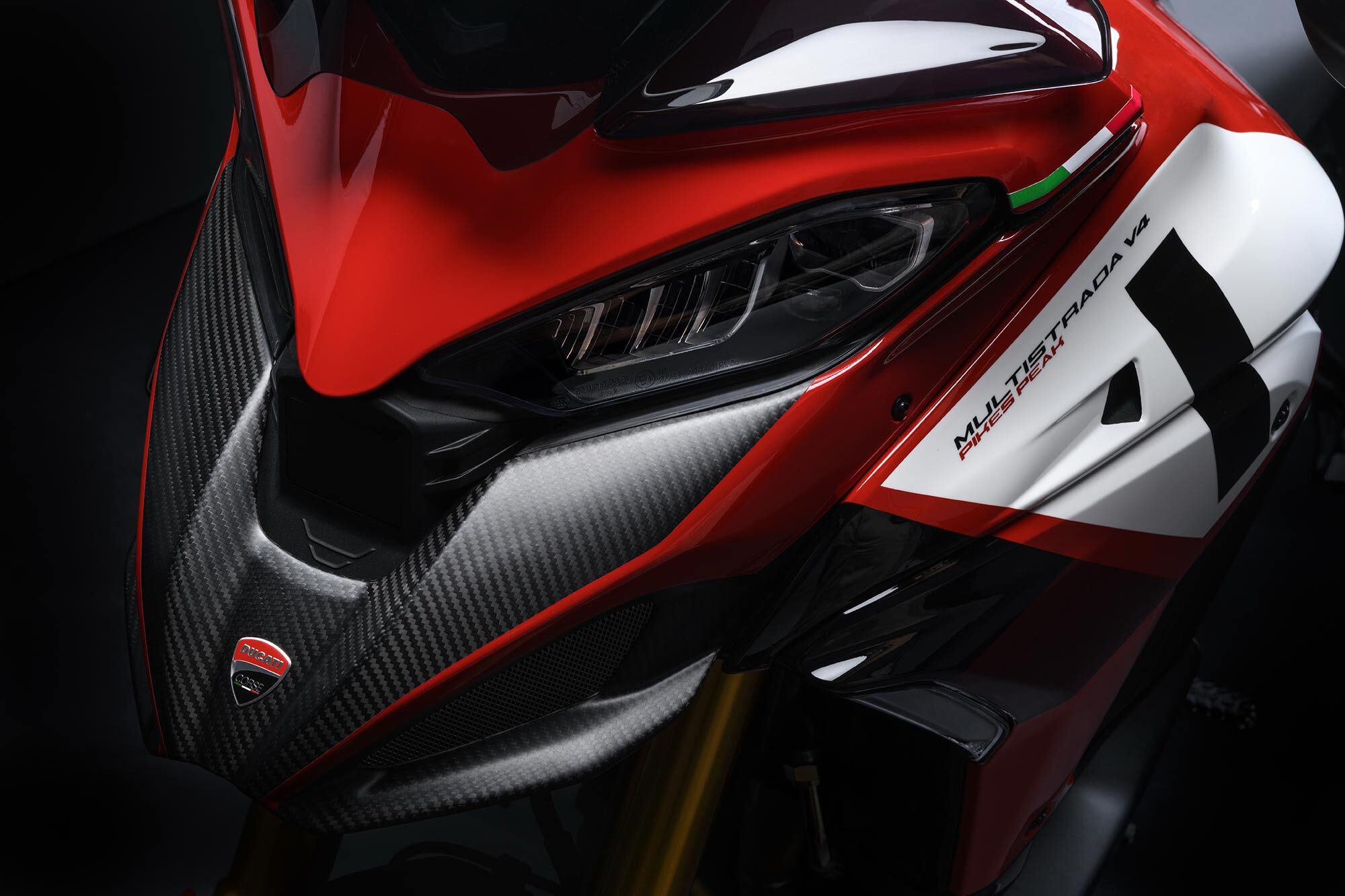

Carbon fiber bodywork and new wheels shave more than 9 pounds from the Multistrada, in addition to changing the bike’s look.
Carbon fiber bodywork and new wheels shave more than 9 pounds from the Multistrada, in addition to changing the bike’s look. (Ducati/)

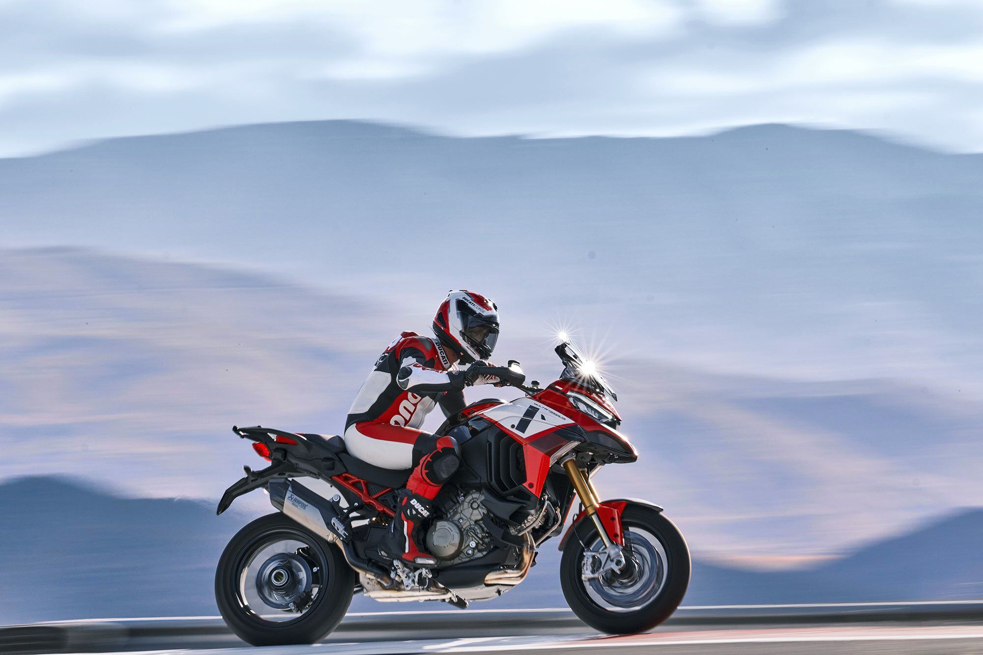

Anyone who’s ever ridden Pikes Peak will immediately understand what this bike is about. The graphics are inspired by the Desmosedici GP ’21.
Anyone who’s ever ridden Pikes Peak will immediately understand what this bike is about. The graphics are inspired by the Desmosedici GP ’21. (Ducati/)
