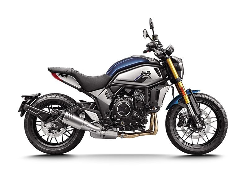

The 700CL-X isn’t a secret at this point—it’s already been launched in Asia, Europe, and Australia—but I can already hear cries of “Chinese junk” echoing off the comments board. So let’s cut to that right up front; however you feel about Chinese labor practices is a separate issue, but as far as specifications, build quality, and riding attributes go, the CL-X is the real deal.
Looks-wise—and even spec-wise—you can slot this stylish naked middleweight into a sort of neo-retro middle ground between the Yamaha XSR700 and the Ducati Scrambler, right down to the aluminum side panels (which CFM says are modular and customizable), front wheel sizes, and even tire choice. Based around CFMoto’s constantly refined 650cc engine from the 650NK, the 700CL-X still uses the same bottom end but swaps in forged pistons and split connecting rods in addition to stroking it for a larger displacement. Although it’s not quite all-new, or even cutting-edge, the 693cc liquid-cooled dual-overhead-cam parallel twin has enough punch to generate a claimed peak power of 74 hp at 8,500 rpm, allied to 50 pound-feet of torque. Those numbers alone are enough to put it up against Yamaha’s CP 2-powered bikes and Ducati’s Scramblers, with even a slight edge over the Kawasaki Z650. Of course, we’ll have to wait for a fully cleared US-spec production model to be sure.
Steel tube frame uses parts as a styling element; the 693cc parallel-twin sits between the tubes rather than atop a backbone.
Steel tube frame uses parts as a styling element; the 693cc parallel-twin sits between the tubes rather than atop a backbone. (CFMoto/)
A closer look at the chassis brings up a few interesting quirks, like a fuel tank that sits inside the frame (and is bracketed by those CL-X badged panels) whose trellis-style tubes even serve as styling elements. But the overall look is cohesive, with an aggressive profile from the tank all the way down to the deeply dished saddle. Out back is a nicely sculpted aluminum swingarm, while the distinctive headlight design up front repeats the “X” theme seen throughout the bike, like on the clutch cover and all the way back to the extremely tidy tailsection. The component list is also impressive, with features like a fully adjustable 41mm KYB inverted fork, a six-speed transmission with a slipper clutch, one-touch cruise control, and Bosch EFI and two-channel ABS, all standard.
Build quality and finishes are above what you’d expect in the segment—Chinese or not—with lots of clean details, tidy frame welds, and carefully routed cables.

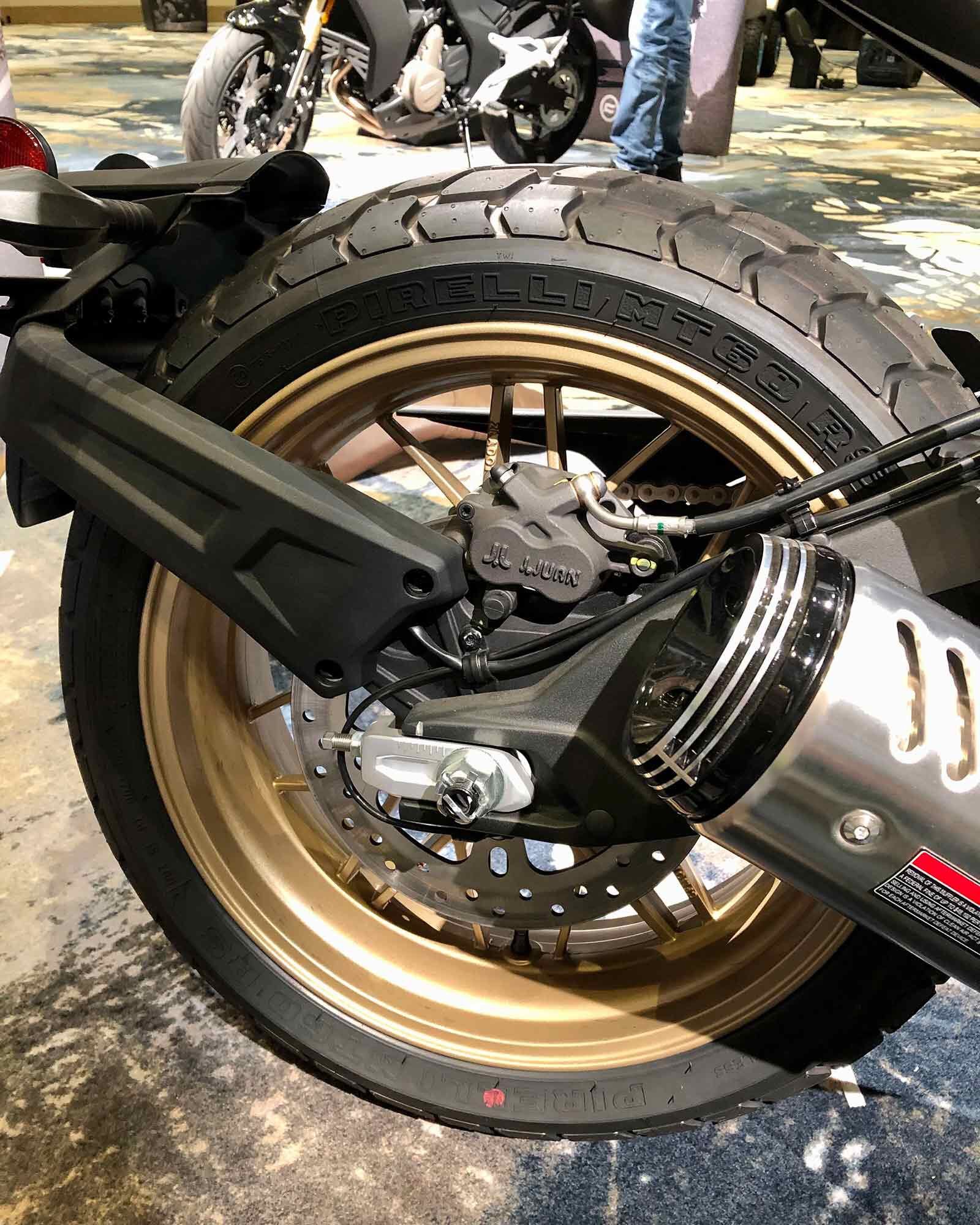

With clear, flat roads and not much in the way of turns, we never had to push the chassis too much, with the wide bar giving plenty of leverage to hustle the bike into turns easily, even with that blocky Pirelli MT 60 RS front tire. The composure is a nice surprise, with the 41mm fork feeling stable and planted in small and medium bumps, with good feel through the bars and very little dive on heavy braking. What’s more, heavier riders can tweak the settings to suit them—there’s preload and compression adjustment in the left fork leg and preload and rebound damping on the right—a feature you won’t find on the immediate competition. The preload-adjustable rear shock proved a bit harsh in the lumpier stuff, but in overall terms was more than adequate for our short ride.
What about braking? Well, two discs are always better than one, but in this application, the CL-X’s J.Juan single 320mm front disc is up to the task, with a four-pot caliper and two-channel ABS. A light lever allows an easy two-finger squeeze, with plenty of power—and more importantly, progressive feel—to get the job done on a bike of this size and weight.

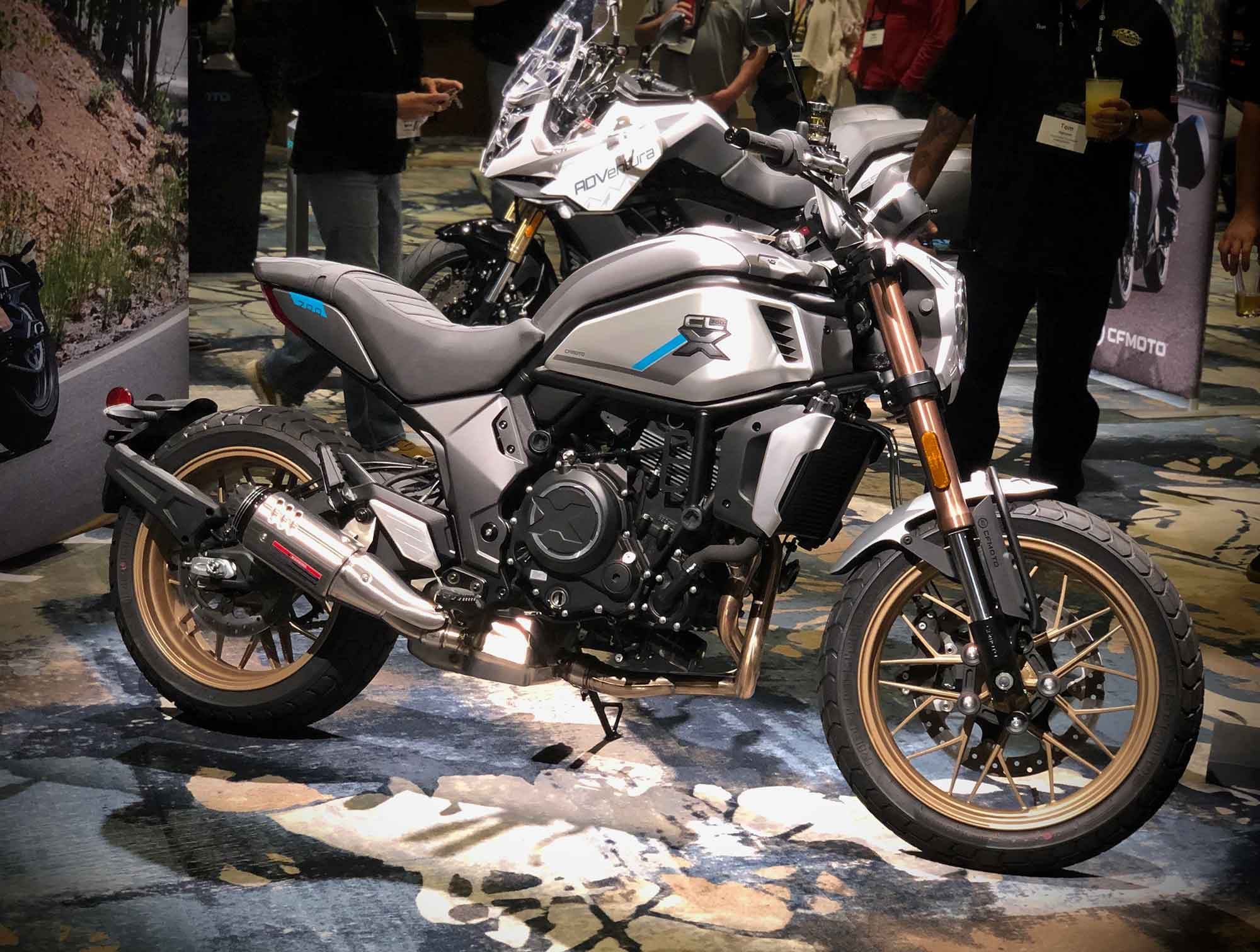

The US will also get the up-spec 700CL-X Sport version, which gets a solo seat, clip-ons, and higher-spec Brembo Stylema brakes to go along with a slightly higher price tag.
The US will also get the up-spec 700CL-X Sport version, which gets a solo seat, clip-ons, and higher-spec Brembo Stylema brakes to go along with a slightly higher price tag. (Andrew Cherney/)
Since the 700CL-X has now appeared elsewhere in three versions—the base model CL-X Heritage, the more cafe-styled Sport, and finally, the Adventure—we know the design has been finalized, so it’s fair to say the model will look pretty much as we see it here when it hits US dealers mid-2022.
