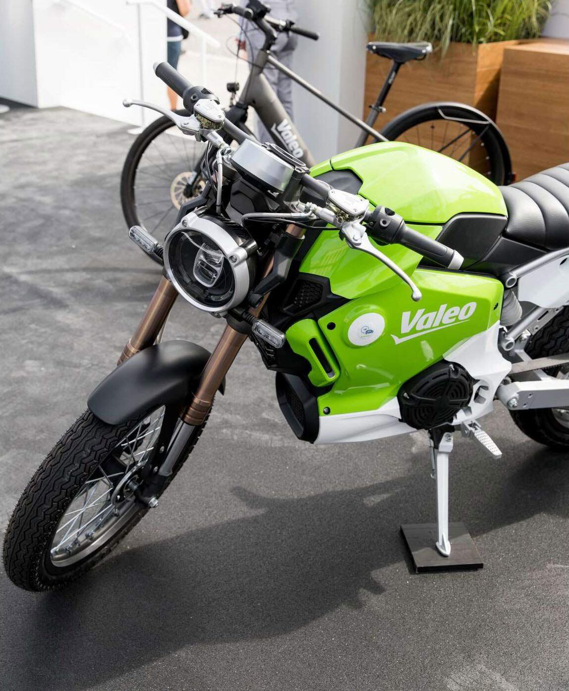

Ignore the fact that under the green paint lies a fairly stock-looking Vmoto Super Soco TC Max; the interesting part of Valeo’s newly revealed electric bike prototype is the mass-manufactured powertrain that the firm plans to offer as an off-the-shelf solution to motorcycle companies looking for a shortcut into the electric market.

While the prototype borrows the Super Soco TC Max chassis and bodywork, the air-cooled 48-volt motor and related electronics are all unique.
While the prototype borrows the Super Soco TC Max chassis and bodywork, the air-cooled 48-volt motor and related electronics are all unique. (Valeo/)
This motorcycle prototype was shown at last week’s CES 2022 event in Las Vegas, and while the chassis and bodywork are borrowed straight from the Super Soco TC Max, the motor, batteries, and electronics are all unique. Where the Soco has a 60-volt battery and a motor with a continuous rated power of 3.9kW (and a peak of 5kW), the Valeo design uses the firm’s 48-volt electronics and a motor that’s derived from hybrid and electric powertrains created for cars. Valeo claims to have more than 30 percent of the market share in the 48-volt hybrid field, and it’s reusing the same technology for its motorcycle components, giving economies of scale that couldn’t be reached with a dedicated, bike-only design.

The drive system features an air-cooled 48-volt motor, an integrated transmission, and a control unit, all combined into one package weighing less than 37.5 pounds (17kg). Initially, the prototype uses a belt-driven reduction gearset, but Valeo says the next generation, already in the pipeline, will use epicyclic reduction gears to improve performance. Peak power is 9.4kW, nearly twice what the Super Soco TC Max offers, to give the performance equivalent of a 125cc gas-powered bike, and the electric motor/transmission unit is more than 90 percent efficient in transferring power from the battery to the rear wheel.
