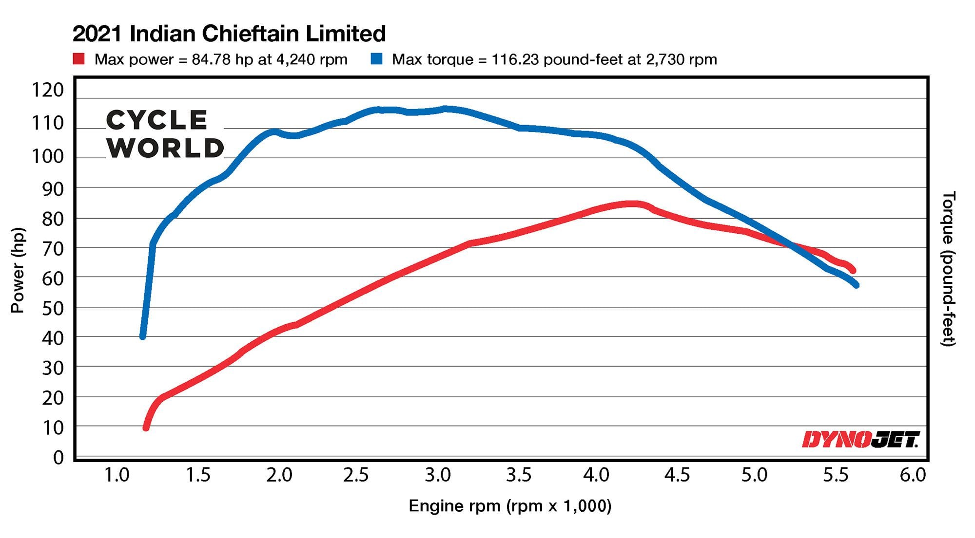

Horsepower and torque figures of the 2021 Indian Chieftain Limited recorded on the Cycle World dyno.
Horsepower and torque figures of the 2021 Indian Chieftain Limited recorded on the Cycle World dyno. (Robert Martin Jr./)
Prior to an upcoming comparison test with rival bagger competition, we ran our 2021 Indian Chieftain Limited test unit, recording the horsepower and torque figures. The Chieftain produced a peak of 84.78 hp at 4,240 rpm and 116.23 pound-feet of torque at 2,730 rpm, right on par with competing Harley-Davidson and BMW models.
