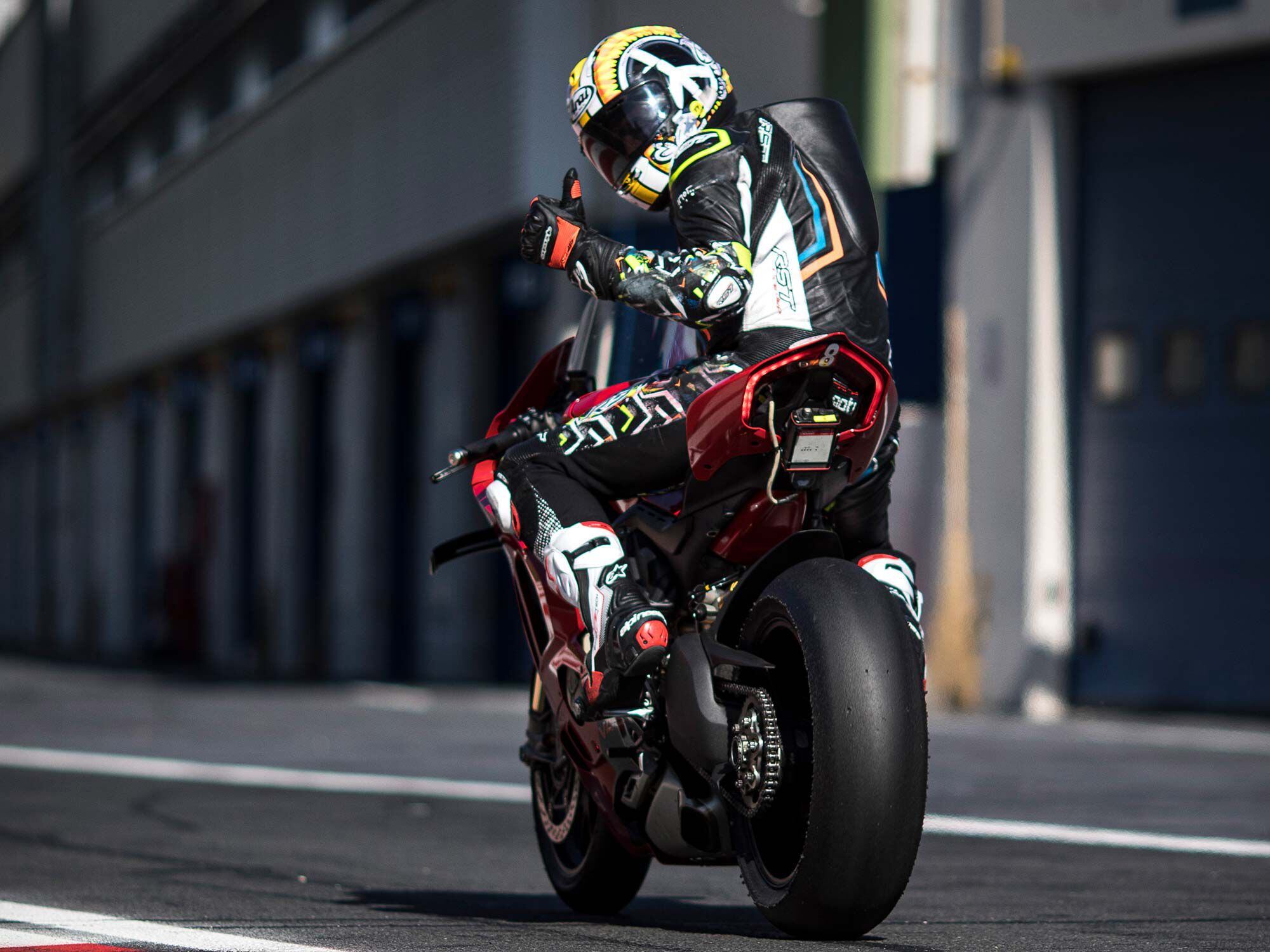

The Vallelunga racetrack just outside Rome is basking in sunshine and completely silent. All the garage doors, bar one, are closed. Only a lone Ducati race truck and a handful of engineers in Ducati Corse teamwear give any indication of impending racetrack activity.
I slide into the back of the open garage, where I’m greeted by legendary development rider Alessandro Valia and the ever-friendly Ducati test team. Near the garage door, their noses poking into pit lane, are two bikes under Ducati dust covers. I can just make out that they’re on paddock stands, tire warmers wrapped around their Pirelli slicks, but I have no idea which is the new-for-2022 V4 S and which is the older 2021 Panigale.
It’s the end of October 2021, two months before the official press launch of Ducati’s new Panigale V4 S in Jerez, and such is the secrecy surrounding the new bike that I’m asked to hand over my phone. I’m not given any detailed specifications. I don’t even know if the 2022 V4 S has more power or refreshed electronics or if the chassis is somehow different. What I do know is that my job is to ride the bikes back to back and see what the lap timer and data reveal.
This was going to be more than just a lap time shootout. Ducati fitting datalogging equipment to both bikes to understand why and where the new Panigale V4 S would be faster.
This was going to be more than just a lap time shootout. Ducati fitting datalogging equipment to both bikes to understand why and where the new Panigale V4 S would be faster. (Ducati/)
First I’ll spin some laps on the 2021 bike, then have a session on the 2022 model. We’ll dial in any changes, for example increasing or reducing rider-aid intervention or trying different riding modes, until I’m comfortable with both bikes on the demanding track. Then Ducati will fit fresh Pirelli slicks, switch on the datalogger, and allow me to set some lap times. I’ll get five flying laps to set my best time on each bike. To keep me on my toes, I will be joined on track by Valia and Michele Pirro, Ducati’s MotoGP test rider. The pressure is on. I’m hopeful that my lap times won’t be too embarrassing.

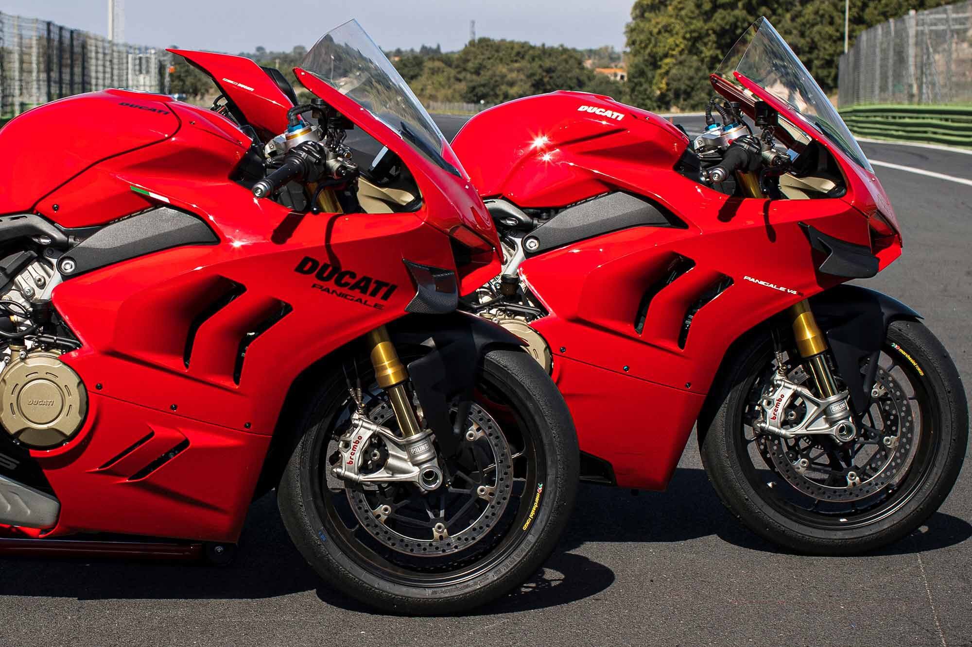

I can’t hide my excitement as busy team technicians remove the covers from the Panigales. I have no idea what to expect—the factory hasn’t even admitted to the existence of a new-for-2022 Panigale yet. But thankfully Ducati hasn’t messed with a proven recipe; the bike is still as sleek and as desirable as ever. There are more gills on the bodywork, the aerodynamic wings have changed, and the exhaust is different, though I can’t be sure about any internal changes. The bodywork extends underneath the bike, and the red V4 logo near the exhaust exit is a nice touch too.
With both bikes side by side, it’s easy to see changes in the seat and fuel tank shape; the newer seat is much flatter and made of different materials.
Once the 2022 and 2021 Panigale V4 S models are side by side it’s easy to see the changes. Out in the wild, it’s not so visually apparent.
Once the 2022 and 2021 Panigale V4 S models are side by side it’s easy to see the changes. Out in the wild, it’s not so visually apparent. (Ducati/)
The brakes, wheels, and suspension appear the same, but without any specs it’s impossible to know. Glancing from bike to bike is like a real-life game of spot the difference. I think the new bike looks a little more aggressive, more gills, slightly racier. There’s just something about it.

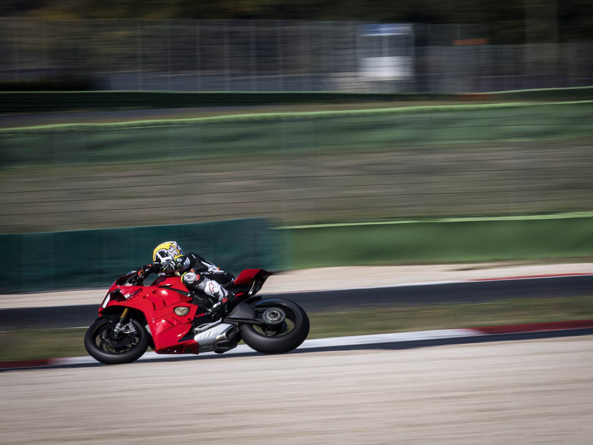

I know what to expect, but the 2021 Panigale still takes my breath away. It’s blisteringly quick and loves to rev. After a few laps to get used to the track I’m up to speed, the outgoing model giving me a hard workout. Managing 210-plus hp is hard physical work, especially around Vallelunga; the first half of the track is super fast, requiring bravery and intimate track knowledge; the second half is much slower, tighter, and more technical. It’s an excellent and comprehensive test of both bikes. On the cool-down lap I realized I am still amazed by the 2021 model. Why wouldn’t I be? I was blown away by its ruthless track ability at its press launch in 2020 in Bahrain, and my opinion hasn’t changed. It still performs like an ultimate. Ducati will have to pull out all the stops to improve on this.
On the track the 2021 Panigale V4 S is still a stunner and a ruthless performer.
On the track the 2021 Panigale V4 S is still a stunner and a ruthless performer. (Ducati/)

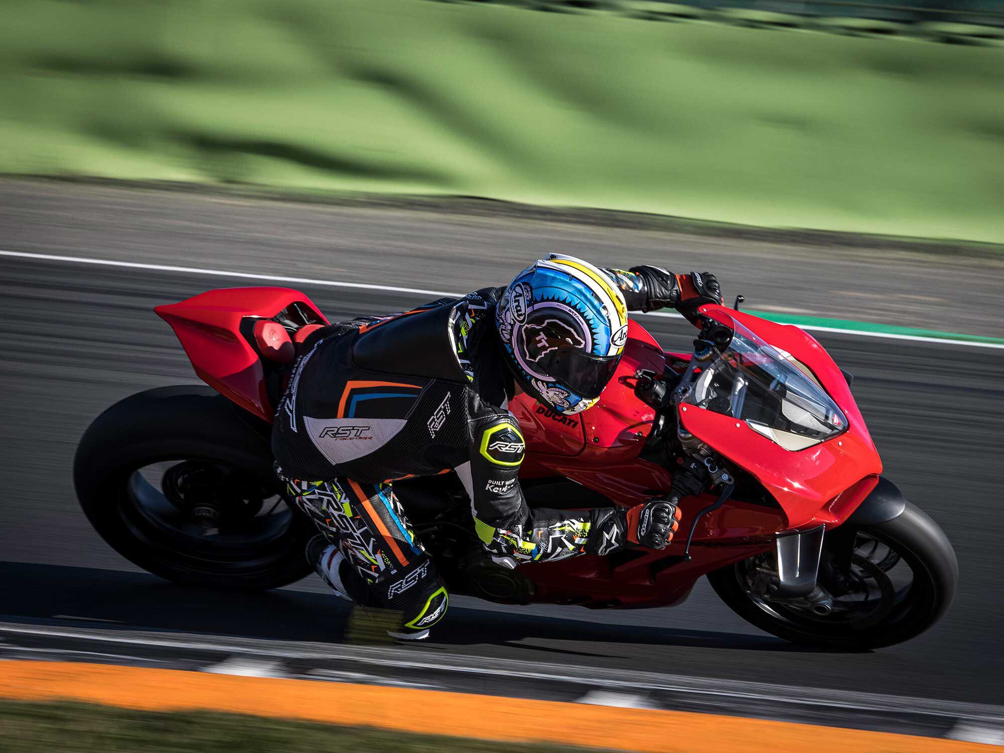

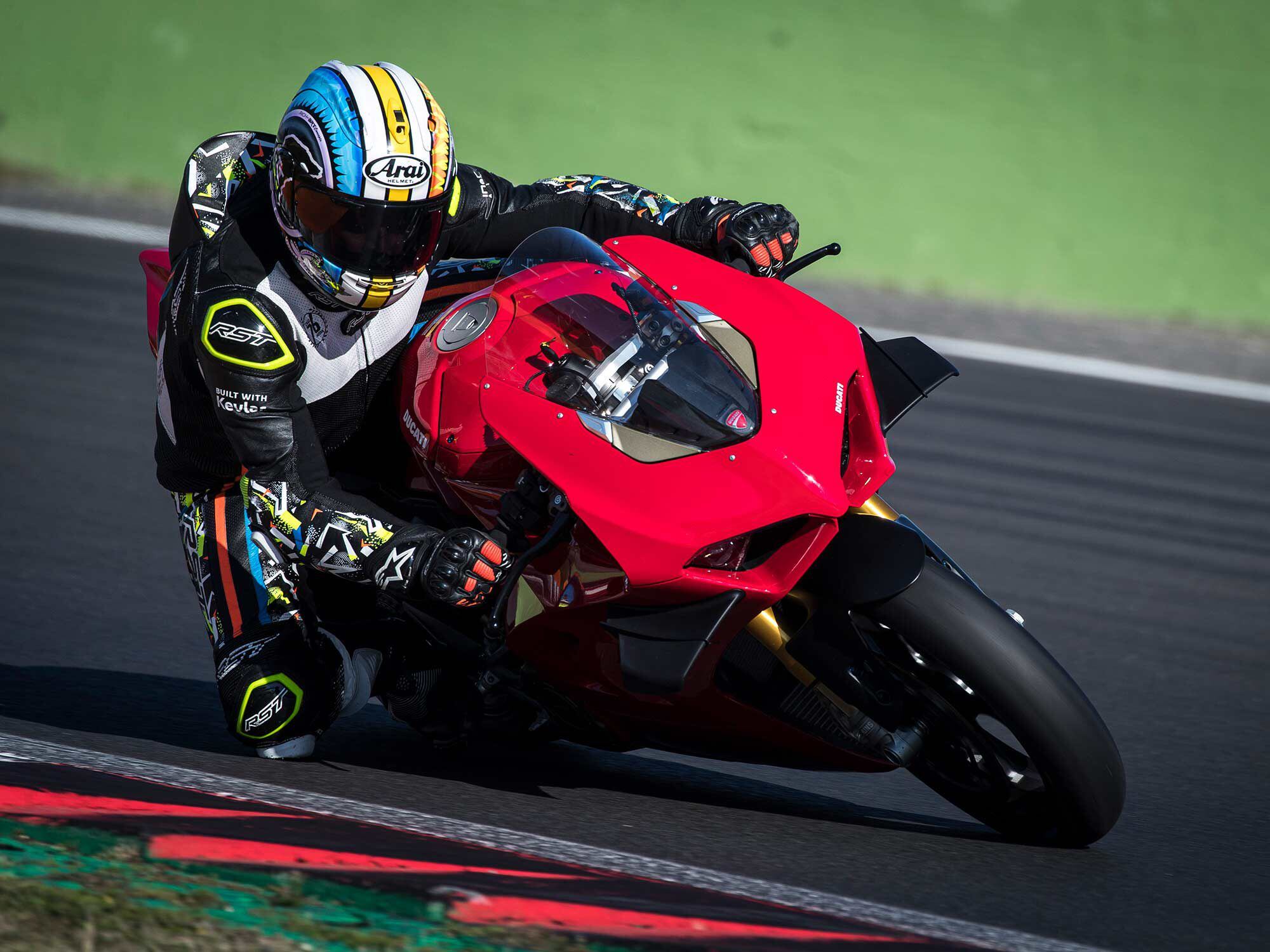

The 2022 model may look only marginally tweaked, but just by riding down the pit lane I can feel change. The riding position has been rethought, as has the size and interface of the fuel tank; both changes are as blatant as a lockdown party in Downing Street. Riders now sit more in the bike, more behind the fuel tank rather than over the fuel cap. The tank itself is wider. The riding position feels more old school and more natural, and I like it.
The first lap is taken cautiously, as I’m unsure what to expect. But by lap two I already feel at home and comfortable. In fact, after a few laps, I feel more at home on the 2022 than the more familiar 2021. Maybe I’m riding slower in fear of crashing, so I decide to elevate my pace and try to feel the difference. Power and torque are astonishing, as on the 2021 model, but I wouldn’t say Ducati has injected more engine performance. The chassis’ turn-in and response, however, are certainly different. On Valllelunga’s long technical corners I feel much more confident pushing the front end and the brakes can be held for longer and deeper into the apex. I feel more in tune with the bike, connected with the front Pirelli’s contact patch. I want to lean over farther, and when I run into turns with too much corner speed, I sense there is more in reserve.
The 2022 Brembo Stylema brake calipers may appear identical to the old bike’s, but I’m sure I’m braking later and that the experience is less physical. The bodywork and new seat are working with me, supporting my bulk rather than allowing me to slide up the fuel tank.
It’s easier to become one with the latest-generation Panigale V4 S.
It’s easier to become one with the latest-generation Panigale V4 S. (Ducati/)
I’m also using first gear far more on the new 2022 machine. This is particularly noticeable toward the end of the lap, where it helps with deceleration and gives more drive out of corners. Throttle delivery also seems smoother, the quickshifter faster. It’s all marginal but nonetheless noticeable: The 2021 Panigale has excellent rider aids and throttle delivery, but the 2022 model is one step above.
The new TFT display on the 2022 Panigale is hugely addictive. I’m chasing lap times and splits, and the dash makes it feel like the coolest video game ever. Still, I’m mindful that this is a very special and important bike to Ducati, and I don’t want to introduce it to a gravel trap by having my eyes on the numbers too long.

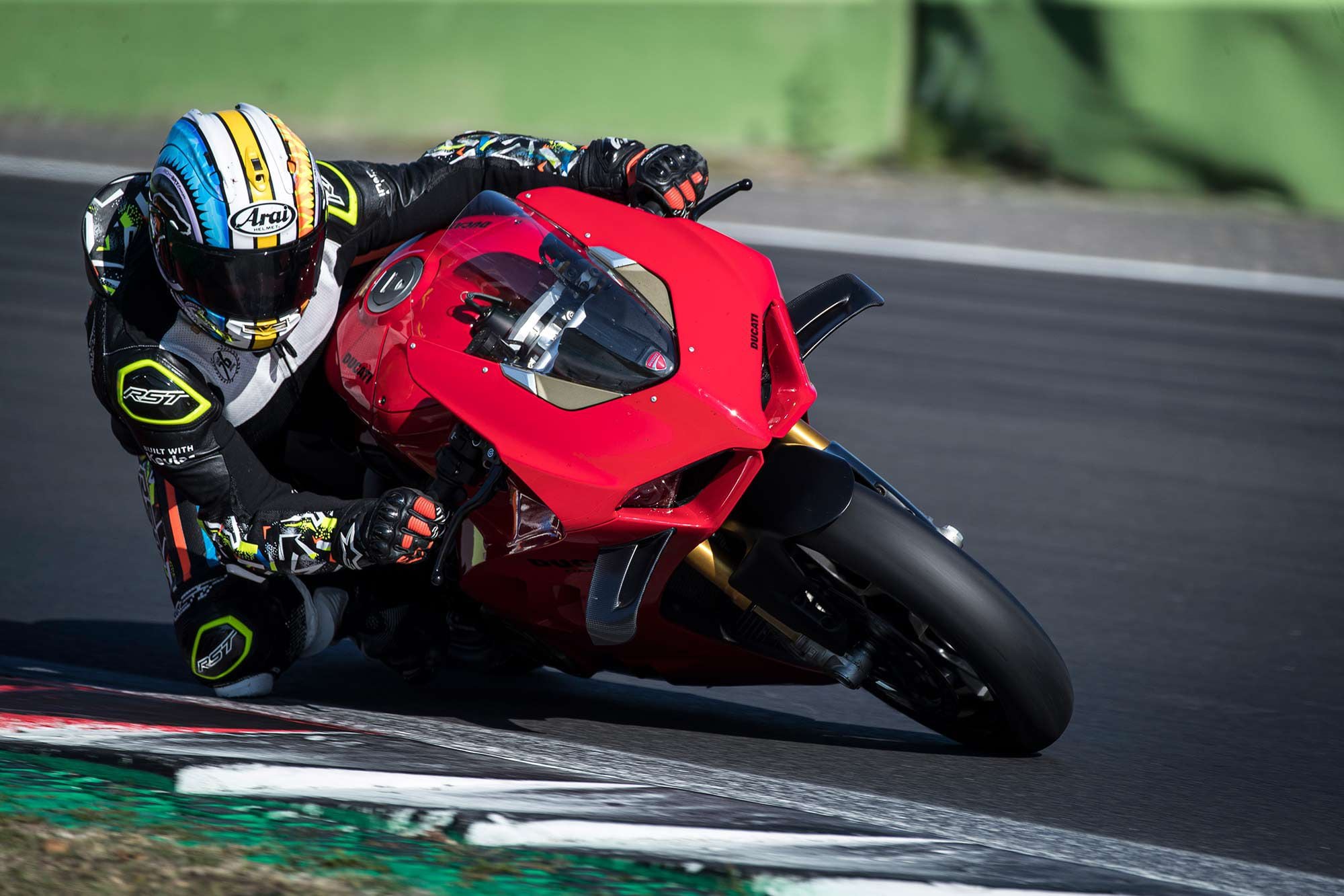

The current 2021 model will be first. I want to set a decent lap, but naturally I don’t want to crash, and if I push too hard, I’ll start to make mistakes. It’s hugely enlightening jumping back onto the 2021 model, which is still blisteringly quick, but harder to ride fast and certainly more physical. It just doesn’t have that one-to-one front end feeling that’s present in the 2022 model. It’s breathtakingly fast, of course, but for a trackday rider and amateur racer like me,  the 2022 model is near perfect.
Pushing the 2022 model to the limit is less taxing physically and mentally.
Pushing the 2022 model to the limit is less taxing physically and mentally. (Ducati/)
I’m pushing, but don’t feel like I’m on the edge. After five laps I’m reasonably happy, as I was riding to a decent limit with a little in reserve, and I found I could be more consistent too. Strangely, it doesn’t feel as fast as the 2021 Panigale, for the simple reason that it’s easier to ride. If I’d been fitted with a heart monitor, I’d bet my heart rate would have been higher on the slower but distinctly livelier 2021.

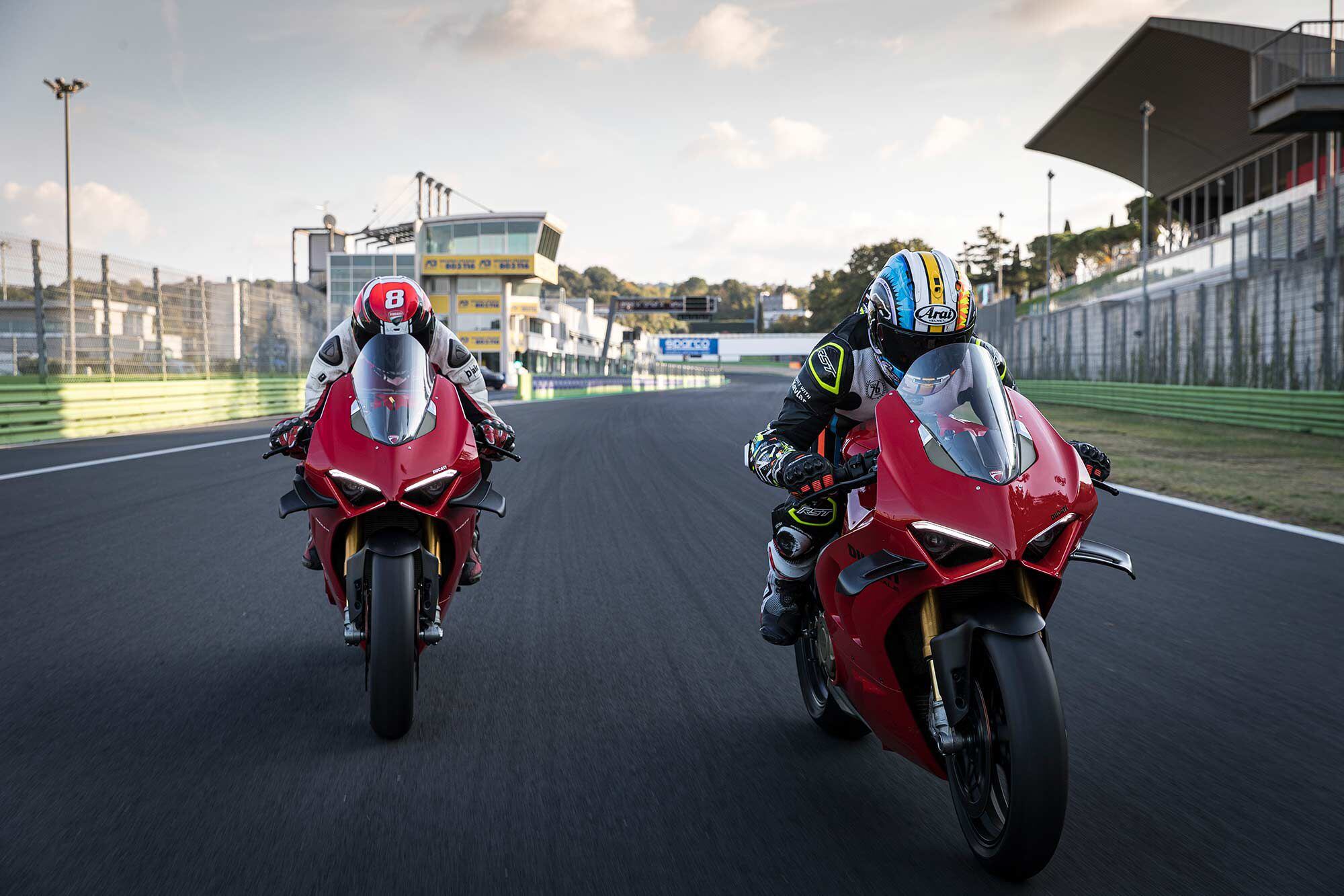

Two other testers joined official Ducati test rider Pirro on track. By the end of the day, one rider had improved by 0.9 second, another by 1.2 second, and Pirro by 0.5.
Pirro was on fire and set a remarkable lap of 1.39.086, which was not only 0.5 second faster than his effort on the 2021 Panigale but just three seconds slower than the lap time set during race one in the highly competitive Italian Superbike Championship (1.36.147). His lap time on a road-legal 2022 Panigale was good enough for a top-10 finish in race one.
Turning laps with Ducati’s test riders.
Turning laps with Ducati’s test riders. (Ducati/)
