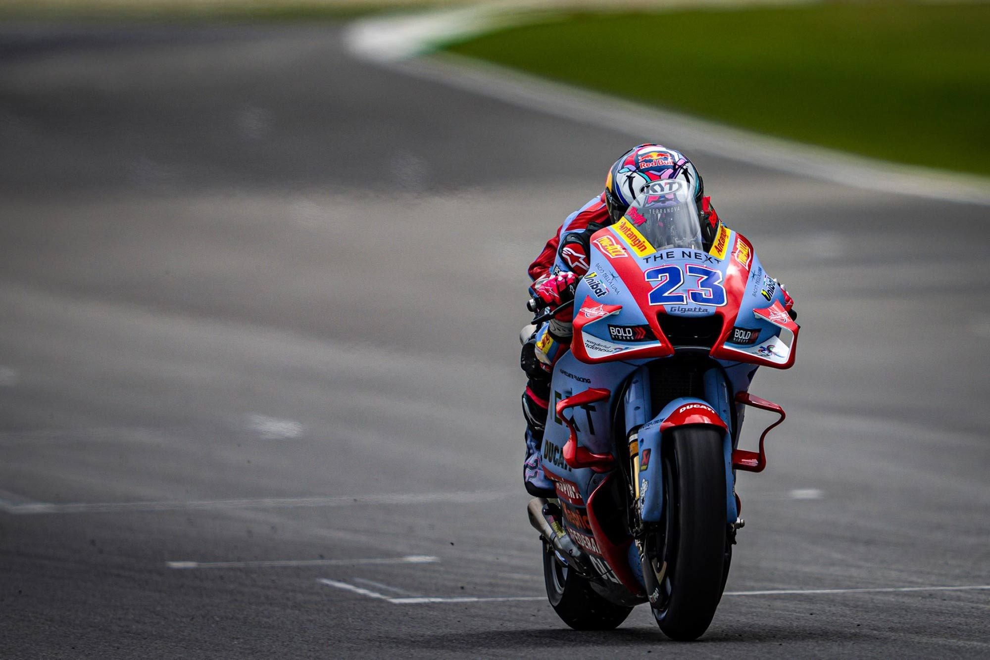

Sophomore year Ducati MotoGP racer Enea Bastianini recorded the fastest-ever lap around the Malaysian circuit.
Sophomore year Ducati MotoGP racer Enea Bastianini recorded the fastest-ever lap around the Malaysian circuit. (MotoGP/)

This was a not-so-subtle reference to Enea Bastianini (Gresini satellite team) who on Sunday (the second day of the test) set a new track record at 1:58.131—on a 2021 Ducati.
Asked if last year’s bike is better at the moment, Miller said, “Yeah, I think so. We know that bike very well.

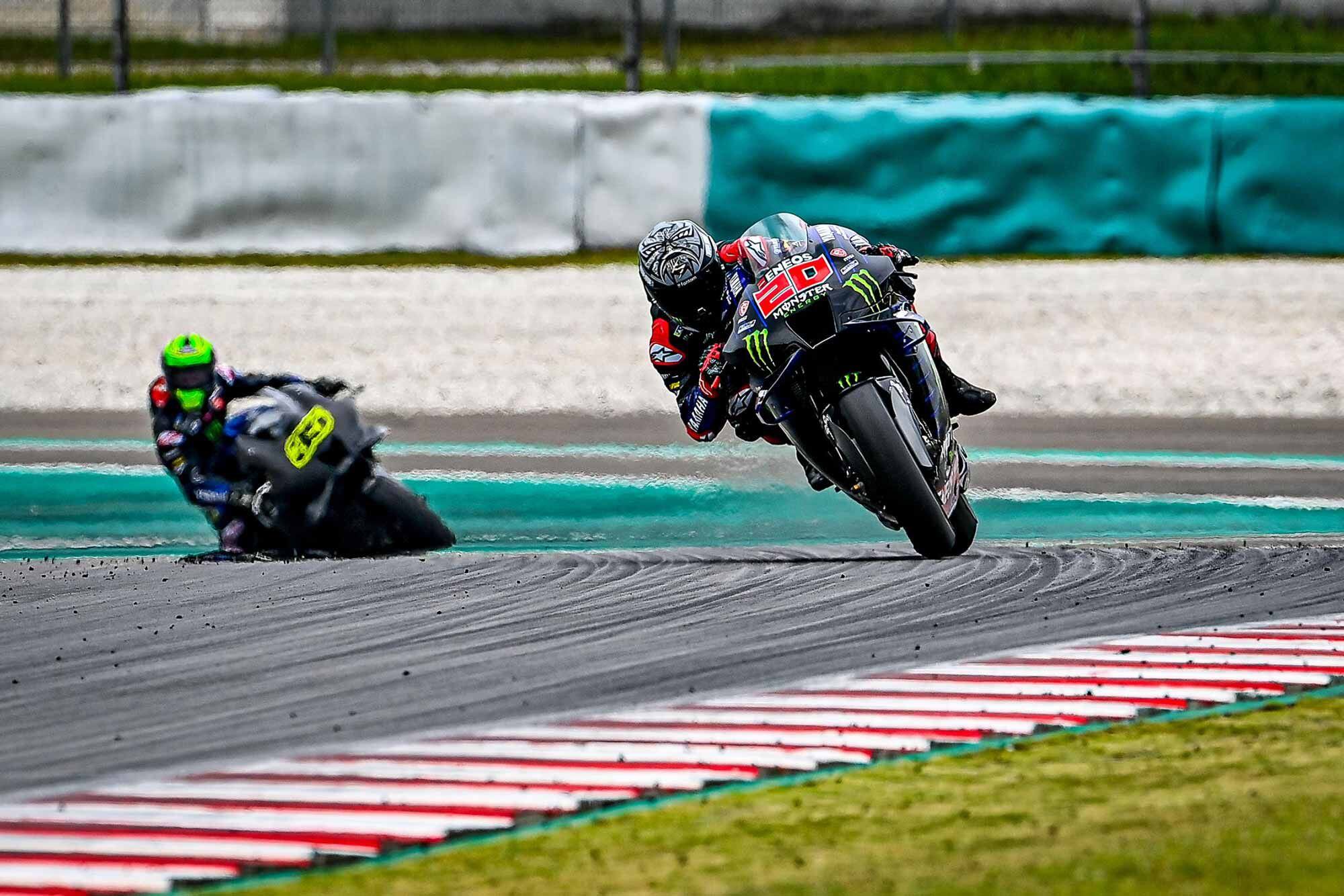

Reigning world champion Fabio Quartararo and Yamaha test rider Cal Crutchlow searched for top speed aboard their YZR-M1s, which proved to be underwhelming.
Reigning world champion Fabio Quartararo and Yamaha test rider Cal Crutchlow searched for top speed aboard their YZR-M1s, which proved to be underwhelming. (MotoGP/)
More Power! More Speed!
Last year’s world champion, Yamaha’s Fabio Quartararo (seventh), had hoped aloud for more power, but that has never been Yamaha’s way. Quartararo seems disappointed, saying only that he would once again have to adapt his riding to the lack of top speed.
“To be honest I expected much more from this test.” Saying he was a bit out of practice on the first day. By the second day he noted that “straight away from the first lap I was riding more naturally.” The team had reserved two tires for a late-Sunday best-time run, but rain came.
Quartararo noted that Ducati was already super fast, but that Aprilia, Honda, and Suzuki have also strongly advanced. He accumulated crucial points early last season, but Ducati was dominant in the second half.
In recent times Quartararo has been Yamaha’s most powerful “technology,” the only rider to put the Yamaha up front. Yet Yamaha engineers must have made changes they expect to raise performance. Can Mr. Q translate them into lap times? Andrea Dovizioso, in his role as Yamaha factory tester, has said that only by riding the Yamaha Quartararo’s way can it succeed, and he (Dovi) finds himself unable to do that. We want to know more!

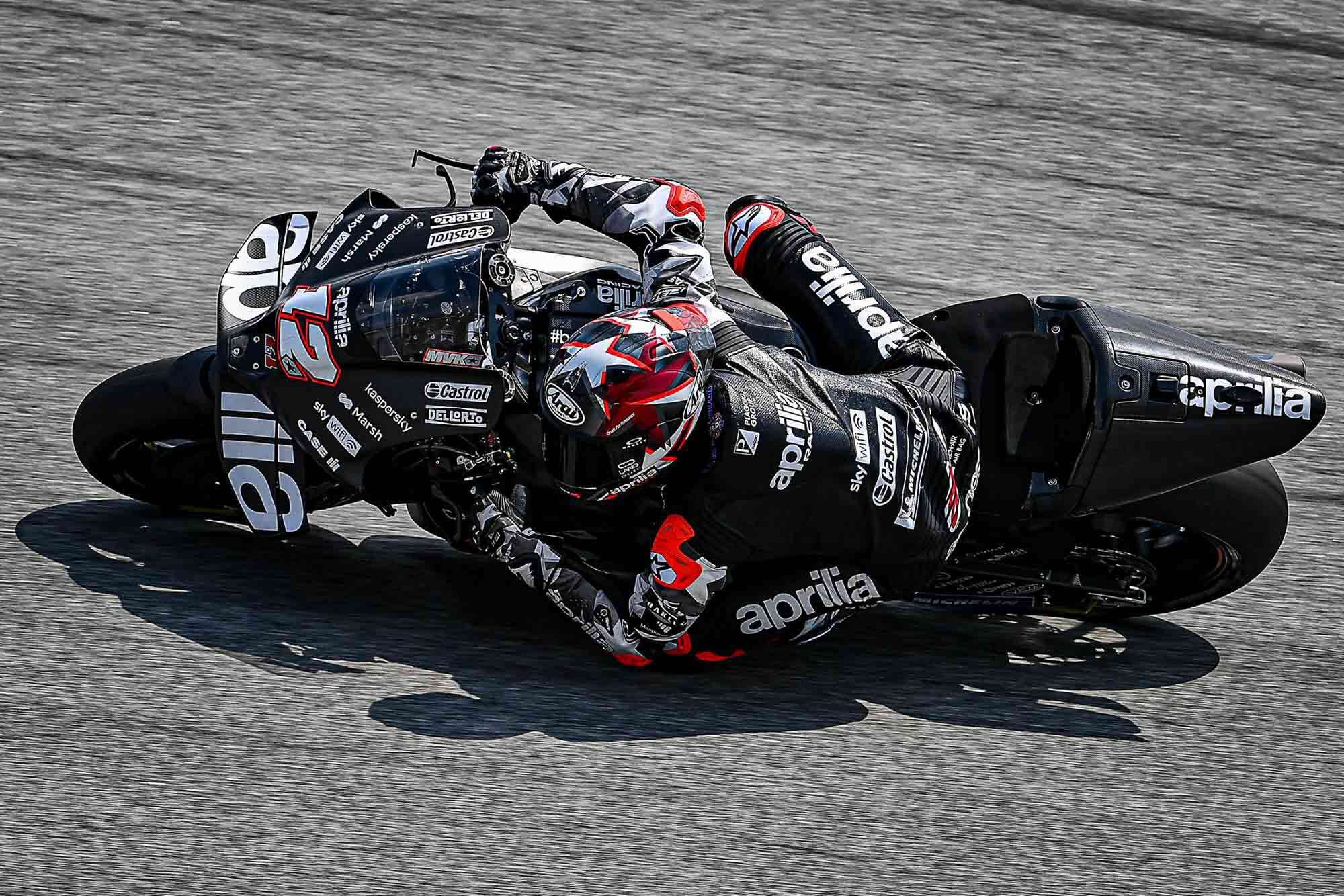

Most impressive on the first day were the new Aprilias, of which Aleix Espargaró (second quickest over the two days) said, “It’s better! The bike is definitely better. Whether it’s enough or not…we will see during the races.
“The best thing is the turning. The bike is more narrow…”
“The bike is not a revolution, it’s a continuation of the RS-GP21, but more narrow and more agile.
“What we have to improve is still chattering…Here in Malaysia in 2020 I remember having chattering…something we need to improve.”
“The engine is a little bit stronger than last year but not enough.”
Aprilia team manager Romano Albesiano likened the new bike to “moving a building two meters. It’s not a big change, but you have to move everything.”
Aprilia is the only constructor still enjoying “technical concessions.” Despite scoring a first podium last year it is permitted to make engine modifications during the season, and is allowed two additional engine changes per rider. Such concessions are granted to not-yet-successful teams, helping them catch up during the season, and because an engine still in active development is less reliable than a proven design.
Espargaró said, “The strongest thing about the bike is the turning.” That may result from the flexibility of what is described as this year’s thinner frame. Aprilia may have found something new and valuable, or it may just have discovered an old contradiction: Reduce chassis stiffness enough in pursuing corner grip and you create chatter—or worse—instability.
So far, the new chassis works. Espargaró said, “You can carry as much speed as you want. It’s unbelievable how much the bike turns, but I’m limited by the chattering. Even in our fast laps Maverick [Viñales—who was fifth quickest over the weekend] and myself have to close the throttle a bit and enter the corner slower to avoid the vibration, but not because I will go wide.”
Will the Aprilia next appear with a tuned-mass damper in its seatback, to stop the chatter?

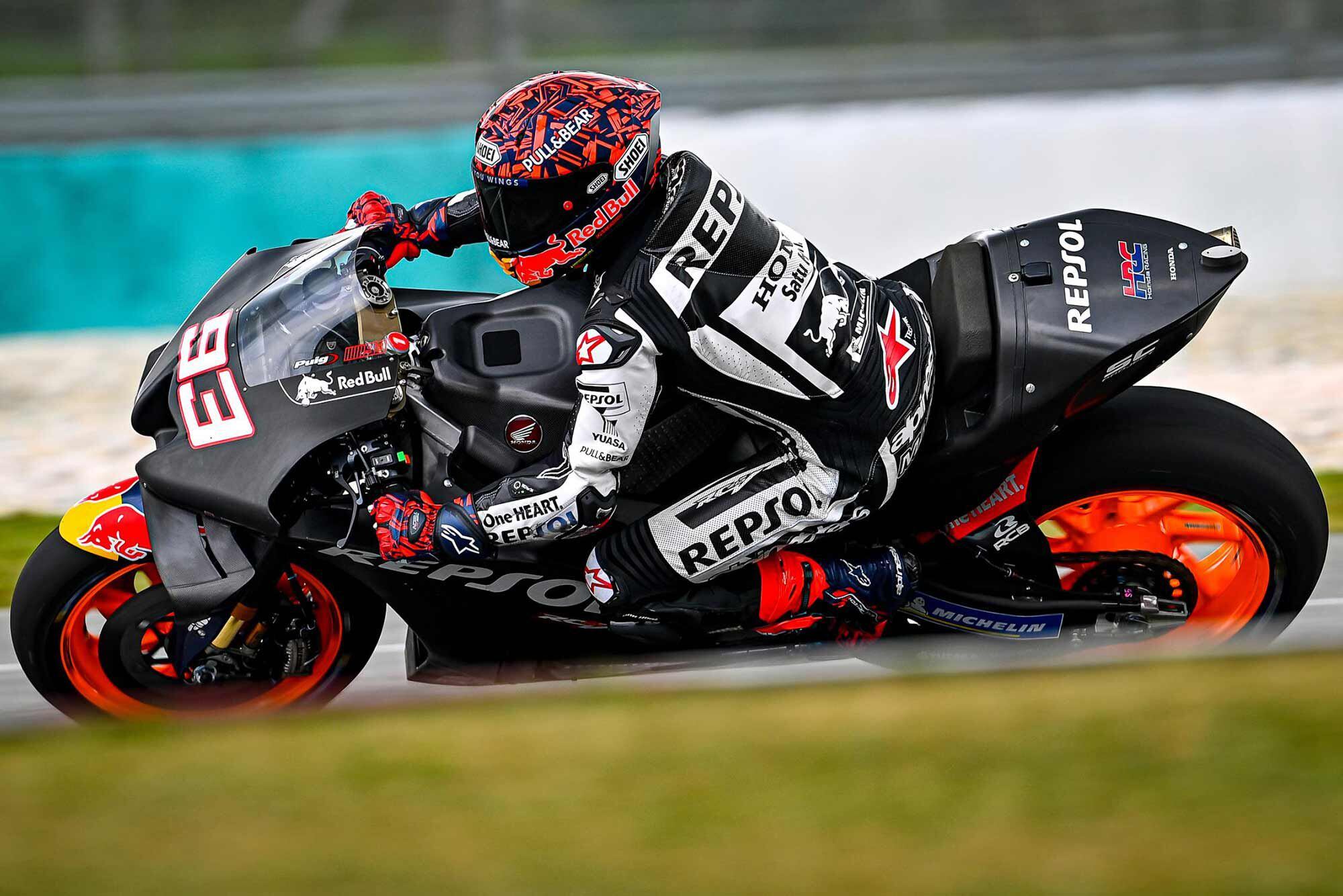

All eyes were on Marc Márquez, who returned to the MotoGP paddock following a training incident that caused a period of double vision for the eight-time world champion.
All eyes were on Marc Márquez, who returned to the MotoGP paddock following a training incident that caused a period of double vision for the eight-time world champion. (MotoGP/)

Marc Márquez was present at the test (eighth overall, 0.201 second off Bastianini’s new record). but mainly said he was pleased that the new bike has speed.
“Immediately I understood that the lap is easier to get with the new bike.”
Central to the changes has been work to improve rear grip (typically on corner entry), and this has changed the response at the front: “…front feeling, that has changed a lot,” he said.
He lost the front in a minor tip-over at T15. As so often during recovery from his injury and subsequent operations, he is not at full physical condition, but so far there has been no recurrence of diplopia—the double vision that appeared after his MX crash. To be as close to the front as this despite the mysteries of a new bike and less-than-top physical condition is a good sign.
