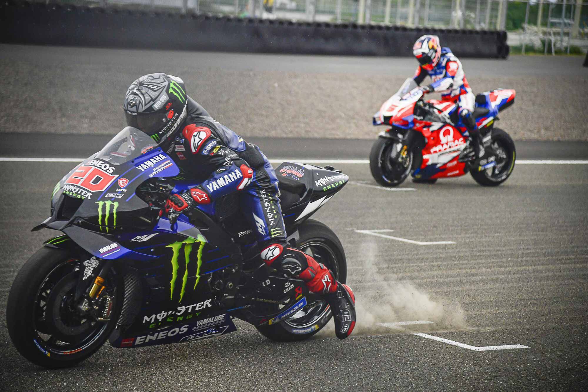

How dirty was the start of the Mandalika MotoGP test? So dirty that Fabio Quartararo looks like he is practicing his flat-track starts.
How dirty was the start of the Mandalika MotoGP test? So dirty that Fabio Quartararo looks like he is practicing his flat-track starts. (MotoGP/)
The recent MotoGP test at Mandalika, Indonesia, was the first time most of the paddock had experienced this track, putting first-year and veteran riders on an equal footing. There was also rain before practice began on Friday, covering the circuit with a brown dust and affording little grip. After no success with the track’s cleaning apparatus, the organizers made the extraordinary decision to use the MotoGP bikes themselves (at how many thousands of euros per track mile, each?) to clear a narrow line. Older readers may remember that at some US and Canadian events of the 1960s and ‘70s, organizers would dry a wet track by sending out every van in the paddock to drive around the circuit—the mechanics’ race!
Alex Márquez takes responsibility for suggesting this ad hoc approach: “In the morning it was very dirty. Everyone was waiting for somebody to clean the track or something…but nobody went out. So I gave the idea to Race Direction.”
Riders also noted they were being painfully pelted by stones from crumbling asphalt. Aleix Espargaró said, “In every corner you get the small stones.”

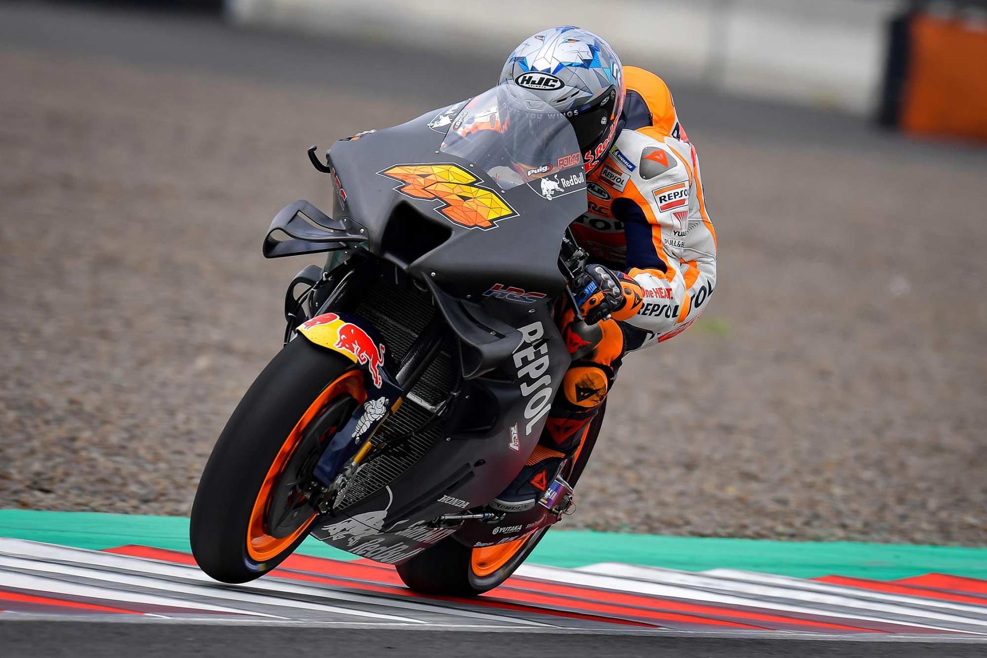

That said, Pol Espargaró set the fastest time on Friday—he and Marc Márquez reckoned the Honda to be working well.
Related: Testing, testing…
Pol Espargaró was the quickest on Friday.
Pol Espargaró was the quickest on Friday. (MotoGP/)

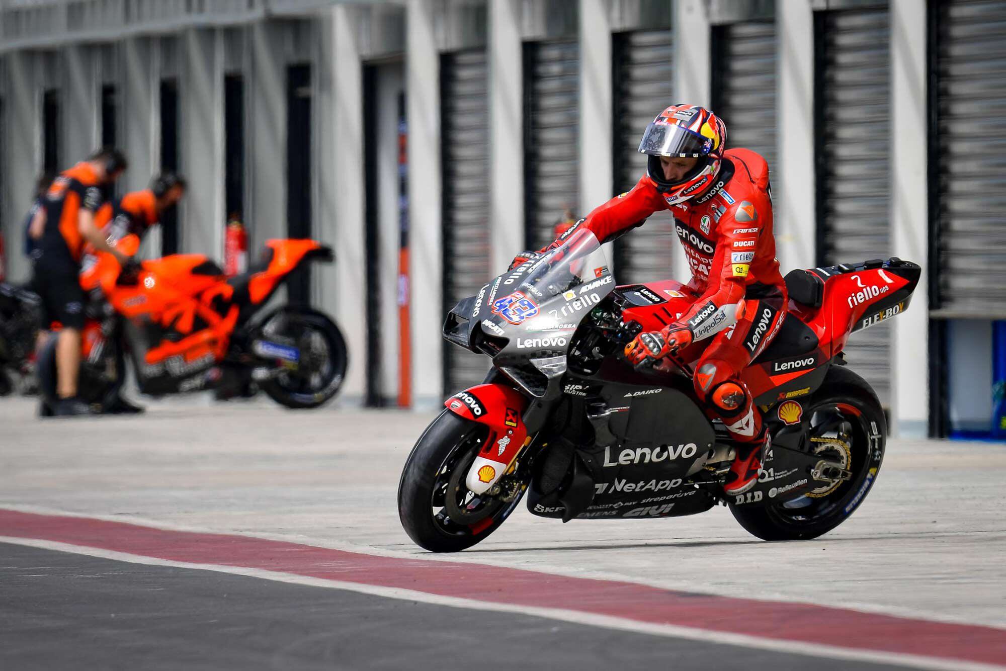

Everyone was speaking of “making another step,” but on the slow-clearing track it was hard to find a pattern. That will take care of itself at the first GP, Qatar, where we will see how the race sims run in FP3 and 4 truly stack up. Who is ready to go race distance in minimum time? The 2022 Ducatis have more power than last year, and yet they remain rideable. Ducati Corse director Paolo Ciabatti commented on the new variable ride height (VRH) system at the front, now able to help lower CG and increase acceleration off corners as well as the start.
“The lowering device? The story of the wings and the spoon is often repeated. Ducati innovates while remaining within the regulations. We are sorry to hear that it is being questioned.”

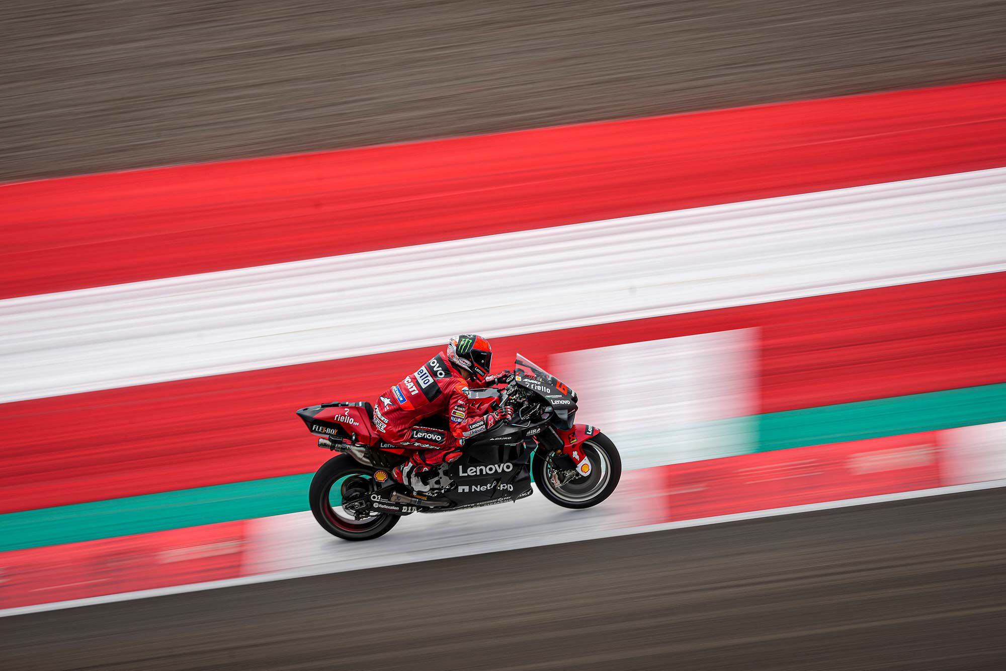

Questions were raised about Ducati’s variable ride height; Ducati Corse director Paolo Ciabatti says it’s the same story as when they brought winglets and the rear tire scoop into use: “Ducati innovates while remaining within the regulations.”
Questions were raised about Ducati’s variable ride height; Ducati Corse director Paolo Ciabatti says it’s the same story as when they brought winglets and the rear tire scoop into use: “Ducati innovates while remaining within the regulations.” (Ducati/)
Making such new systems work as planned is only part of the problem. The real biggie is integrating them into the machine’s overall handling. We’ve already seen some glitches; for example, a too-rapid rise in ride height at the end of braking.

Riders were in and out of the pits on three lap outings to collect feedback on bike setups and part testing.
Riders were in and out of the pits on three lap outings to collect feedback on bike setups and part testing. (MotoGP/)
