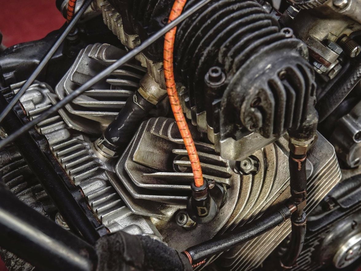

Fins are essential for cooling on air-cooled engines, but they are also beautiful.
Fins are essential for cooling on air-cooled engines, but they are also beautiful. (Douglas MacRae/)

Although false fins exist, there is satisfying sincerity in real ones. Fins must be deepest and most numerous where temperatures are the highest: on an engine’s heads and specifically around their hot exhaust ports. Look at a classic Triumph 650 of the 1960s and you will see the famous head and fin shape dictated by the need to push cooling air between the two outward-splayed exhaust ports. When they appear on cylinders, fins are deepest at the top, closest to the fire, and taper toward the bottom. These contours drive the reverence many of us have for cooling fins: The very shape and location of the fins reveals where the greatest need for them exists. Engineering honesty.
