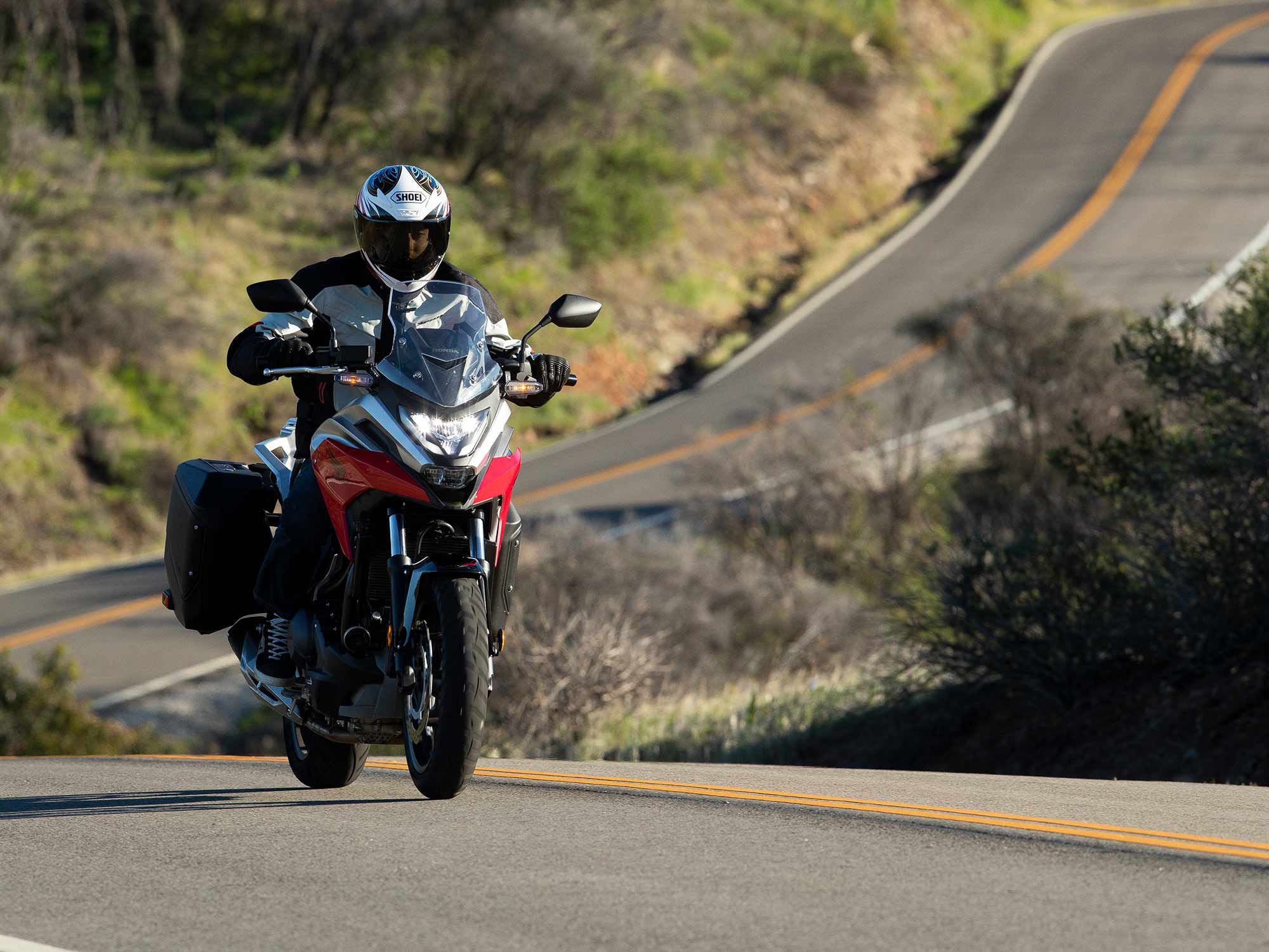

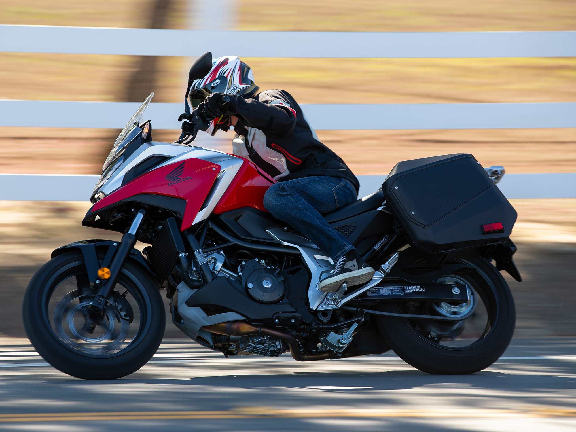

Honda’s NC750X DCT might be as practical as motorcycles can get.
Honda’s NC750X DCT might be as practical as motorcycles can get. (Adam Campbell/)
Practicality, in the truest sense of the word, is hard to come by in motorcycling these days. The specialization of the marketplace has divided the showroom floor by making bikes so sharply focused that versatility has been developed out of the equation. Bikes have primarily been designed on a performance, styling, or even lifestyle basis, and for a new rider, that narrowness of focus can make choosing a motorcycle confusing and often intimidating.
But the practical philosophy is the driving force behind the Honda NC750X. For example, rather than take an existing motorcycle engine and repurpose it, Honda basically took the four-cylinder engine from its Fit/Jazz subcompact car and cut it in half. So instead of the usual motorcycle powerplant, which is designed for high power density and rpm, the NC750X parallel-twin engine’s forte is excellent efficiency at lower revs, as demonstrated by its comparatively low 6,500-rpm redline. Check out Kevin Cameron’s discussion of the NC750X’s predecessor engine, the NC700, here.

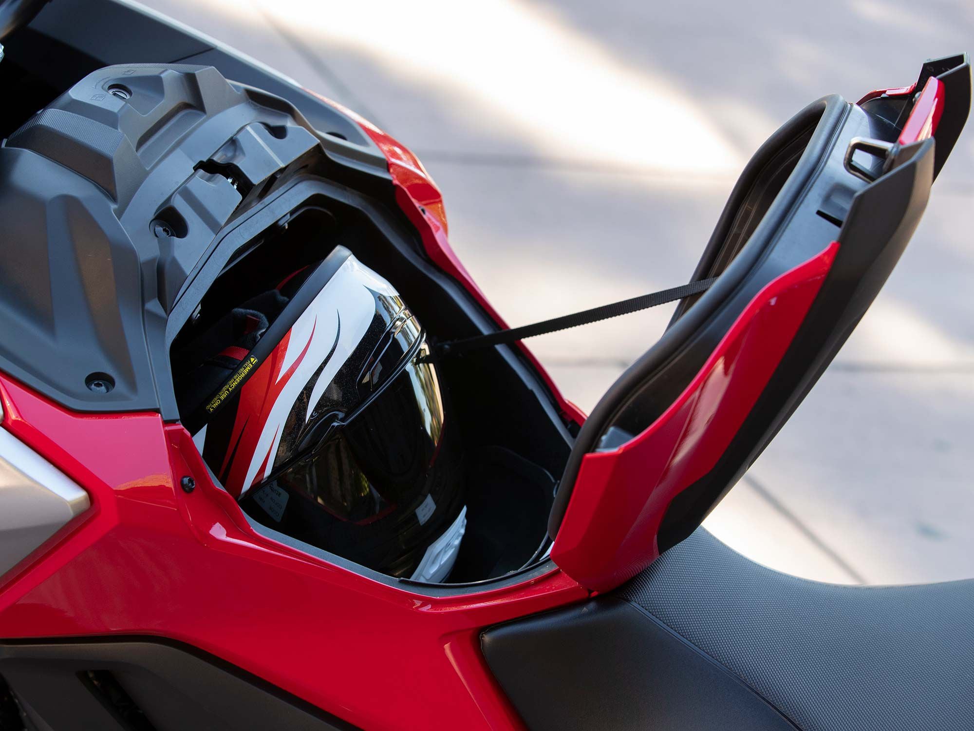

The engine design also allowed Honda to tilt the cylinders forward at a 55-degree angle, which provides numerous benefits: It permits a fairly low 31.6-inch seat height, which fosters confidence in new riders (and the seat feels much lower than that due to a shape that narrows at the front); it allows for a cavernous 23-liter ignition-keyed storage space, big enough for a full-face helmet or a decent load of groceries, where the fuel tank normally sits; and the 3.8-gallon fuel tank can be relocated below the rider’s seat, so the NC750X DCT’s center of mass is kept very low to aid handling.

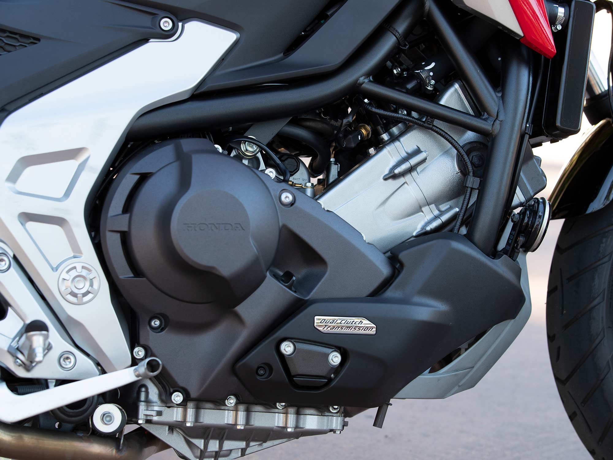

In there, there’s half of a car engine—a very small one.
In there, there’s half of a car engine—a very small one. (Adam Campbell/)
In fact, despite its somewhat porky 493-pound wet weight and 60-inch wheelbase, the NC750X DCT is surprisingly agile, and steering is light and neutral at all speeds. Yet the chassis remains very stable in nearly all situations, and there’s good ground clearance before the footpeg tips touch down. It’s easy to get the Honda moving quickly through any set of corners, a situation aided by decent grip from the stock Metzeler Tourance Next tires. The bike uses a nonadjustable 41mm Showa Dual Bending Valve fork, which is a sort of poor man’s cartridge fork straddling the design gap between a standard fixed-orifice damping rod unit and a shim-stack cartridge design. This cleverness, combined with a single rear shock, does an admirable job of keeping chassis pitch to a minimum. The bike only begins to come unglued when pushed to a pace that the vast majority of NC750X owners won’t approach.

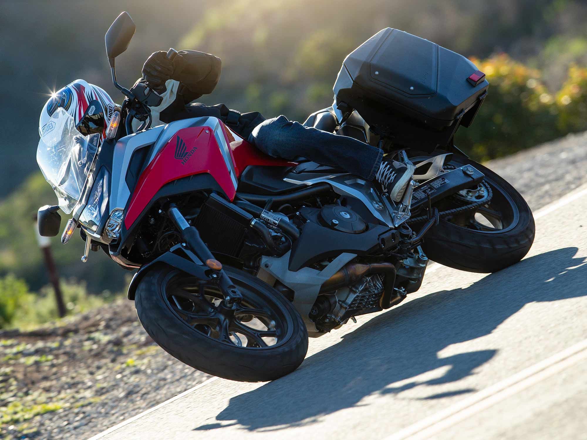

Despite being fairly low-spec in the chassis department, the NC750X DCT is stable in corners.
Despite being fairly low-spec in the chassis department, the NC750X DCT is stable in corners. (Adam Campbell/)
Braking from the single 320mm disc with twin-piston slide-pin caliper up front is adequate, but is much better and stronger when used in conjunction with the single rear 240mm disc and single-piston caliper. Perhaps Honda’s Combined ABS would have been a good choice for the NC, but cost considerations likely canceled that idea.

With the fuel tank located below the rider, Honda placed a handy storage compartment in front of the rider.
With the fuel tank located below the rider, Honda placed a handy storage compartment in front of the rider. (Adam Campbell/)

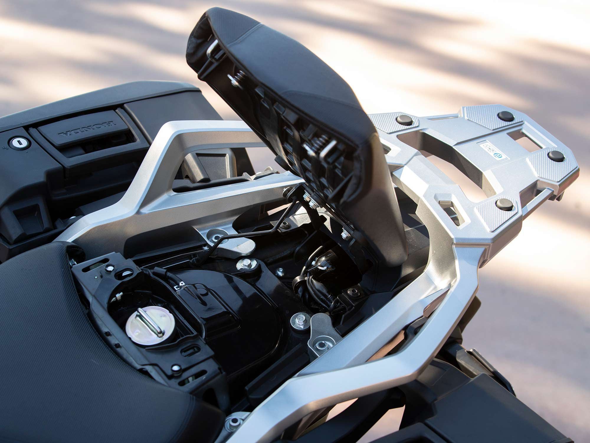

The NC750X’s fuel filler is located under the passenger seat.

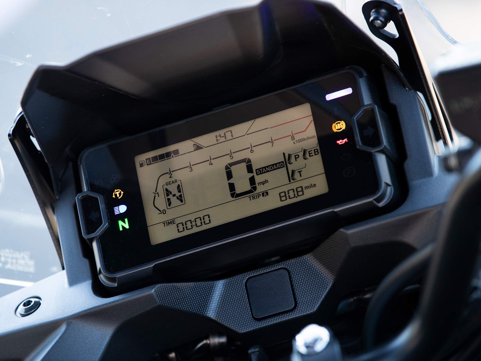

The NC750X’s fuel filler is located under the passenger seat. (Adam Campbell/)The LCD dash feels like it was built to a price, as you would expect from a motorcycle such as the NC750X DCT.
The LCD dash feels like it was built to a price, as you would expect from a motorcycle such as the NC750X DCT. (Adam Campbell/)Ride modes change the character of the NC750X DCT from easy commuting to backroad fun.
