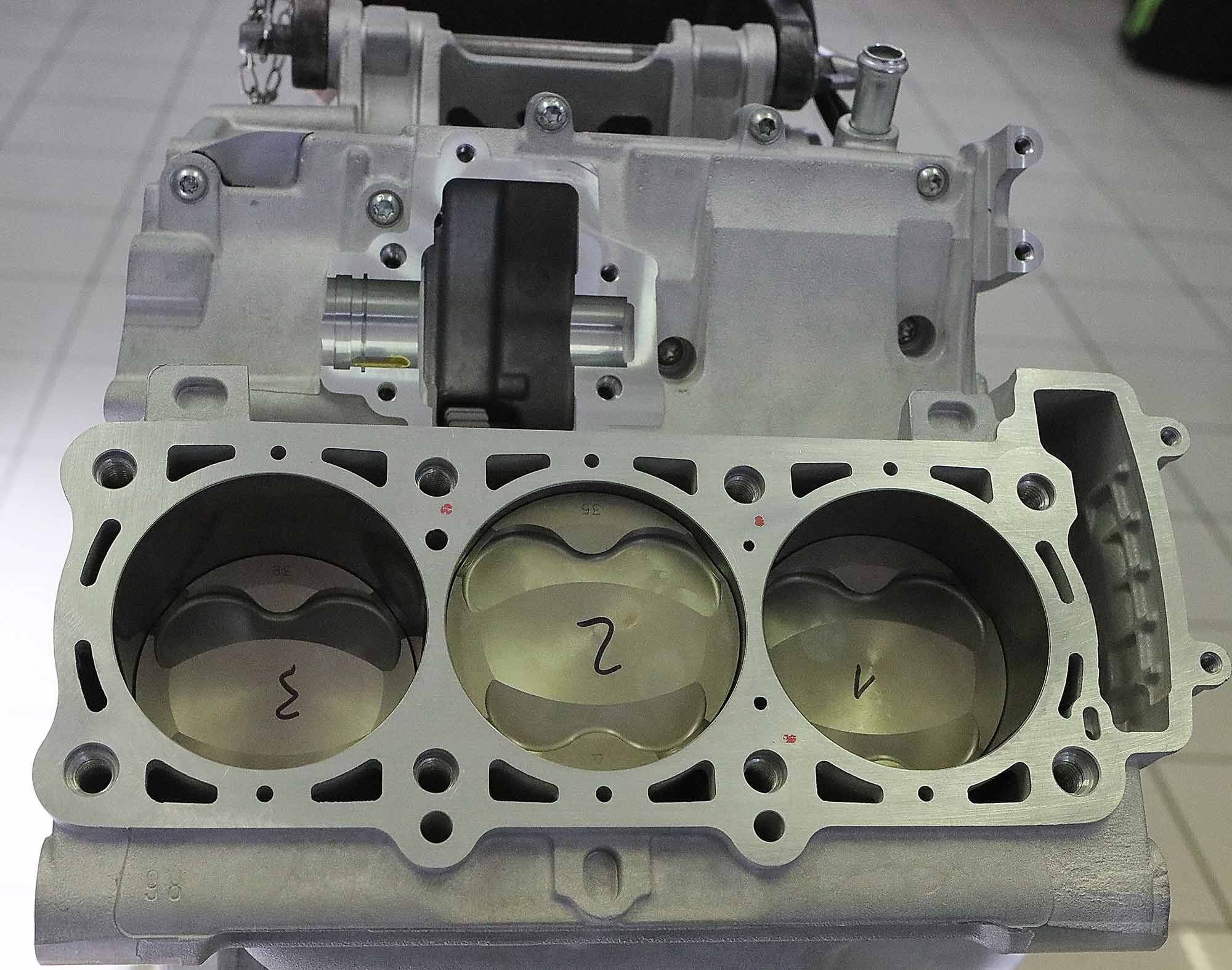

The cylinder block is a closed-deck design. The 81mm pistons have a clean top with large squish areas and a 12.5:1 compression ratio. Cylinder block, crankcase, and head are all gravity sand cast. New dies ensure superior quality and structural consistency.

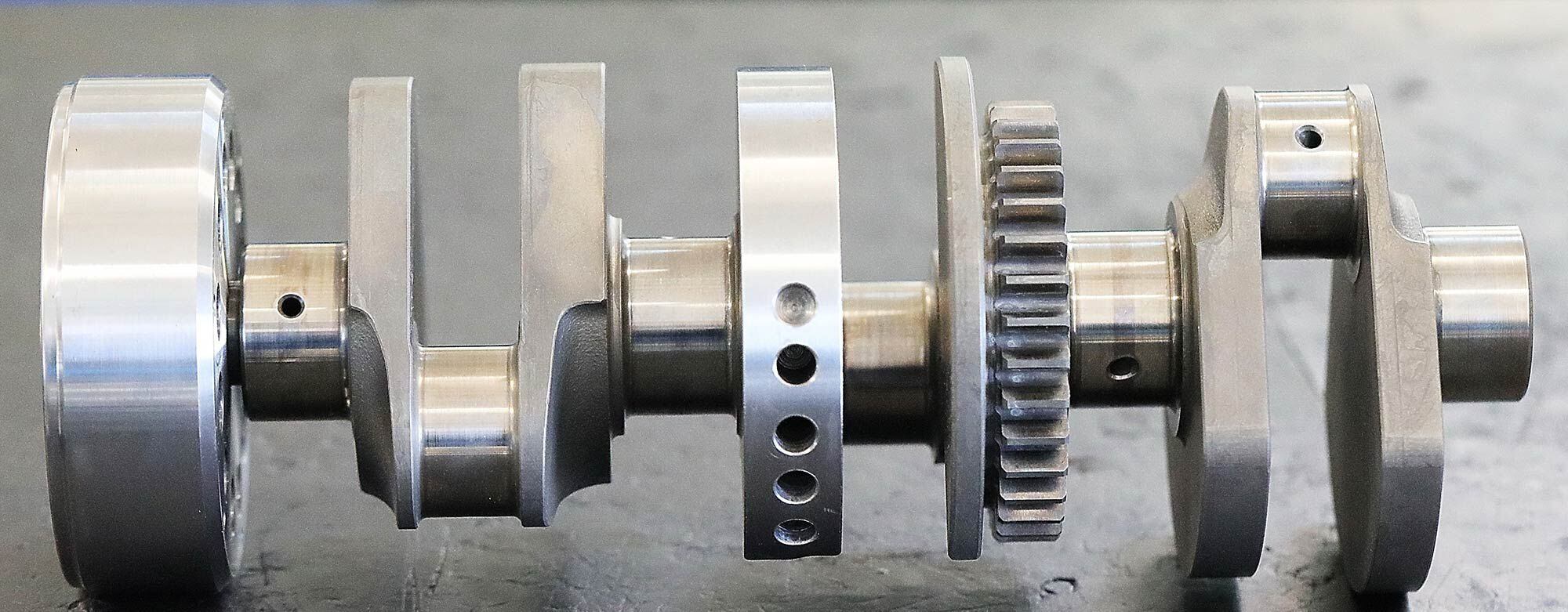

The cylinder block is a closed-deck design. The 81mm pistons have a clean top with large squish areas and a 12.5:1 compression ratio. Cylinder block, crankcase, and head are all gravity sand cast. New dies ensure superior quality and structural consistency. (Bruno dePrato/)The new crankshaft not only provides a longer 60.2mm stroke, but is also stronger, with four 37mm main journals and three 35mm rod journals. The integral gear drives the balancing shaft at 1:1 to cancel the vibrations generated by the primary-order rocking momentum typical of an inline-three.

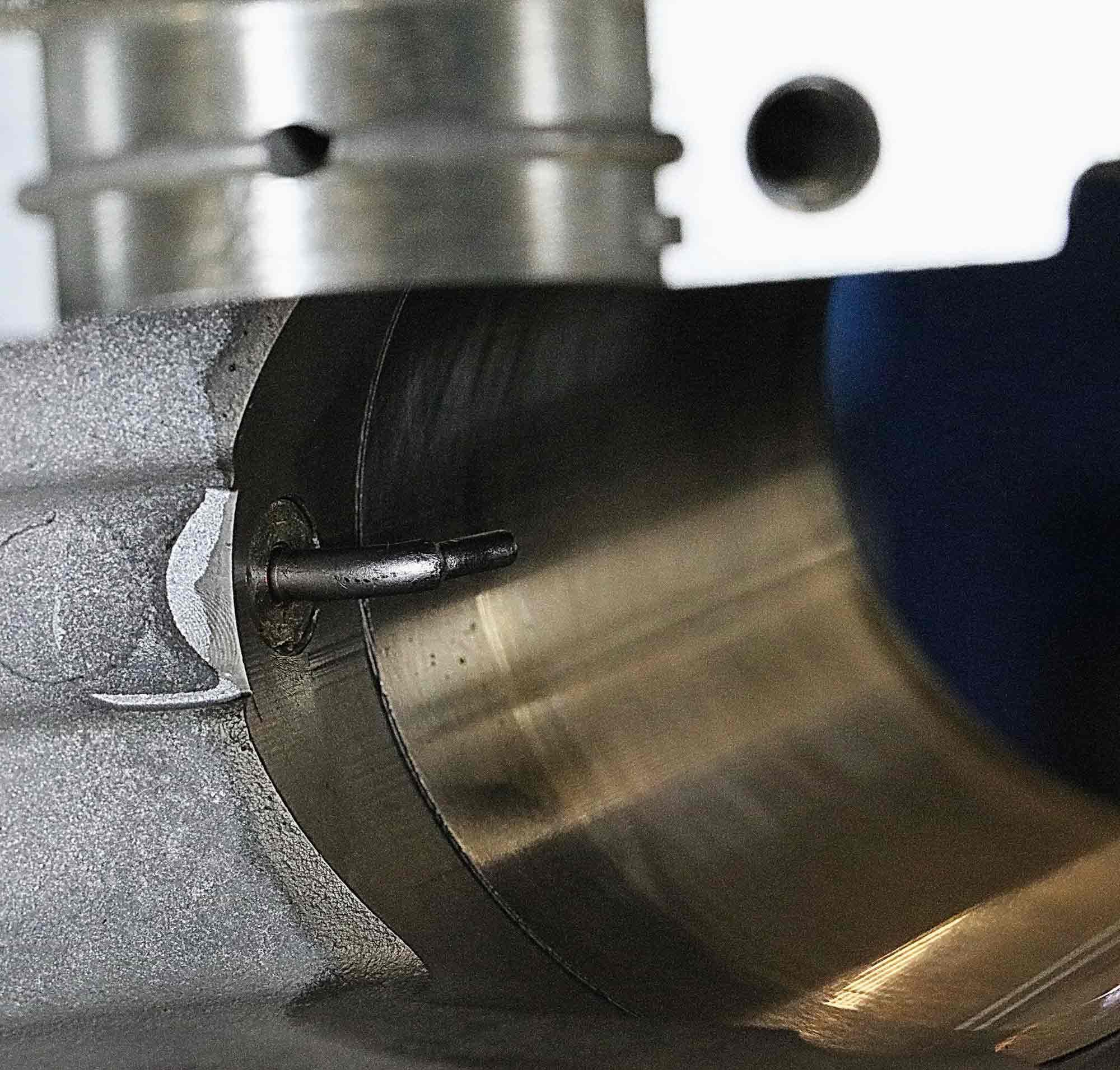

The new crankshaft not only provides a longer 60.2mm stroke, but is also stronger, with four 37mm main journals and three 35mm rod journals. The integral gear drives the balancing shaft at 1:1 to cancel the vibrations generated by the primary-order rocking momentum typical of an inline-three. (Bruno dePrato/)A nozzle spraying a jet of cooling oil to the underside of each piston is located at the bottom of each cylinder bore.

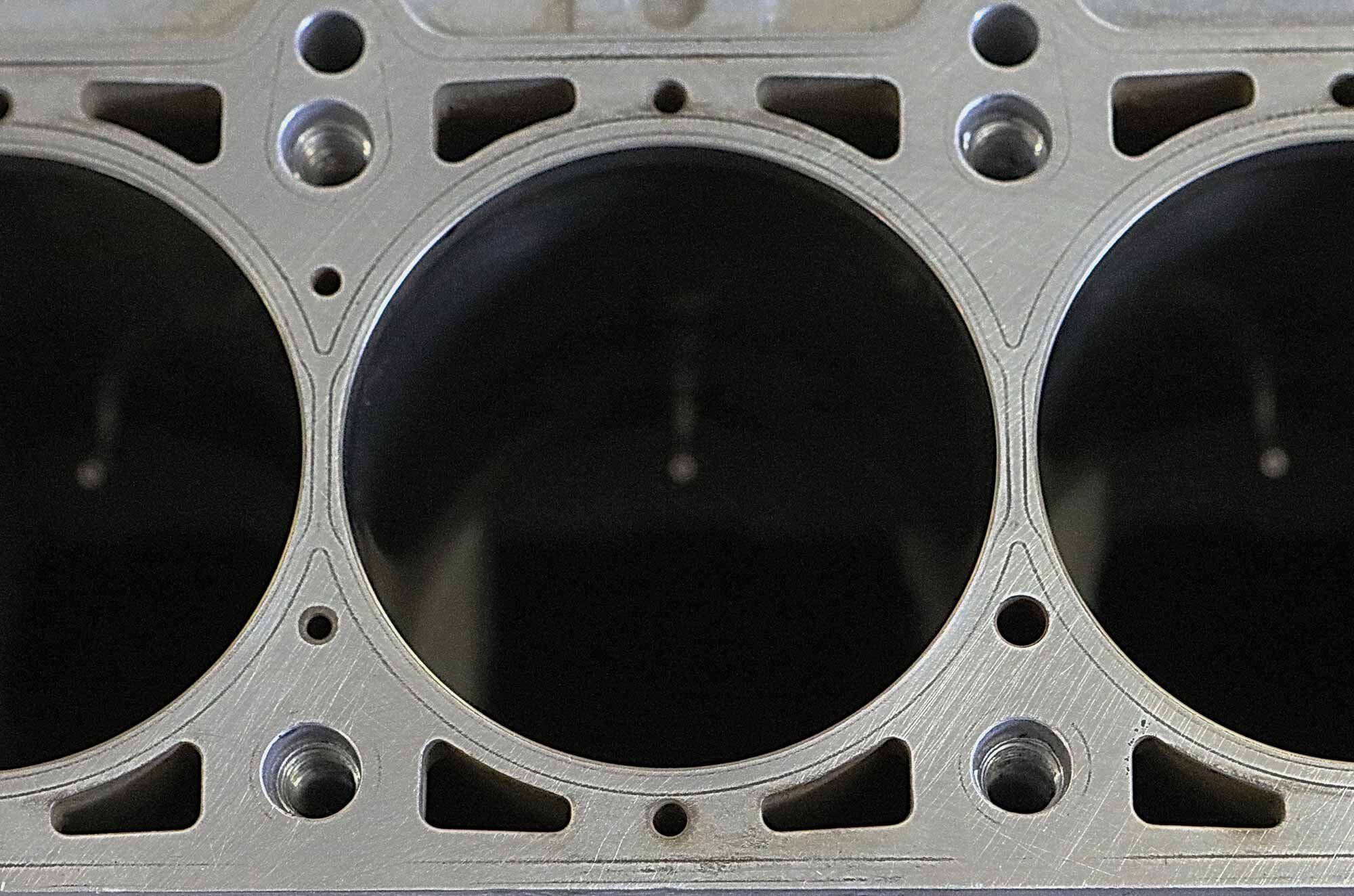

A nozzle spraying a jet of cooling oil to the underside of each piston is located at the bottom of each cylinder bore. (Bruno dePrato/)At 81mm, the 950’s cylinder bores are 2mm larger than the 800’s. To make them fit and keep the engine narrow, the cylinder barrels are integral to the aluminum block, Nikasil plated, and use a siamesed design. Center-to-center bore spacing remains unchanged, a fundamental factor in keeping the new engine and its tooling costs competitively priced.

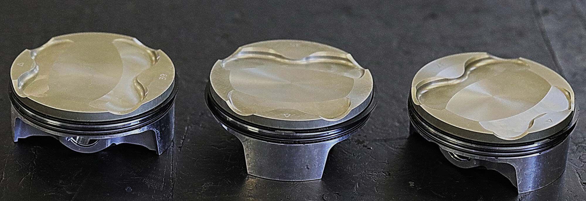

At 81mm, the 950’s cylinder bores are 2mm larger than the 800’s. To make them fit and keep the engine narrow, the cylinder barrels are integral to the aluminum block, Nikasil plated, and use a siamesed design. Center-to-center bore spacing remains unchanged, a fundamental factor in keeping the new engine and its tooling costs competitively priced. (Bruno dePrato/)Pistons are a two-ring-plus-oil-scraper design, very light and featuring very compact skirts. The piston crowns feature large and well-contoured squish areas and a very clean, slightly dished profile for optimal flame travel and combustion.

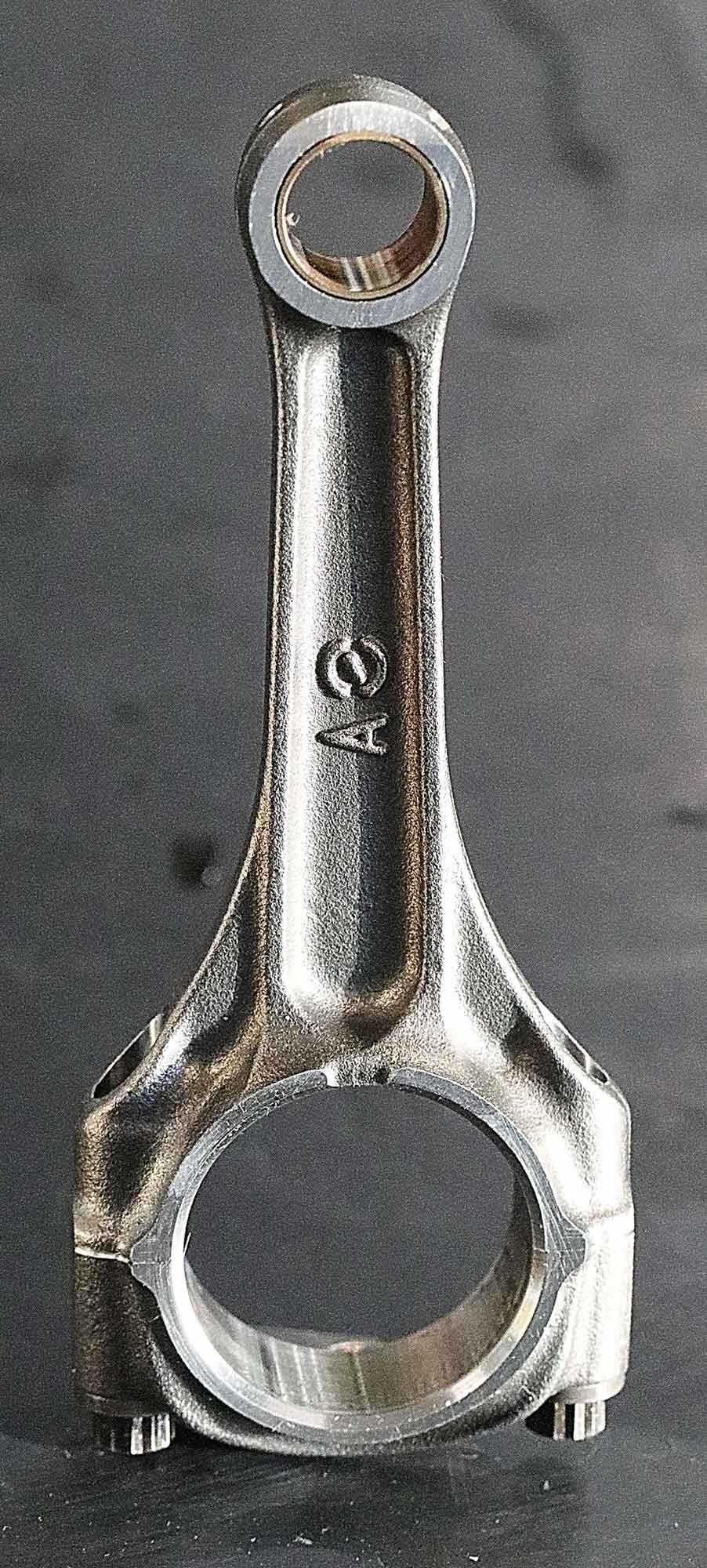

Pistons are a two-ring-plus-oil-scraper design, very light and featuring very compact skirts. The piston crowns feature large and well-contoured squish areas and a very clean, slightly dished profile for optimal flame travel and combustion. (Bruno dePrato/)Connecting rods are totally new in both design and size. Even though they are 10mm longer to maintain the correct stroke-to-con-rod-length ratio, they’re still very light.

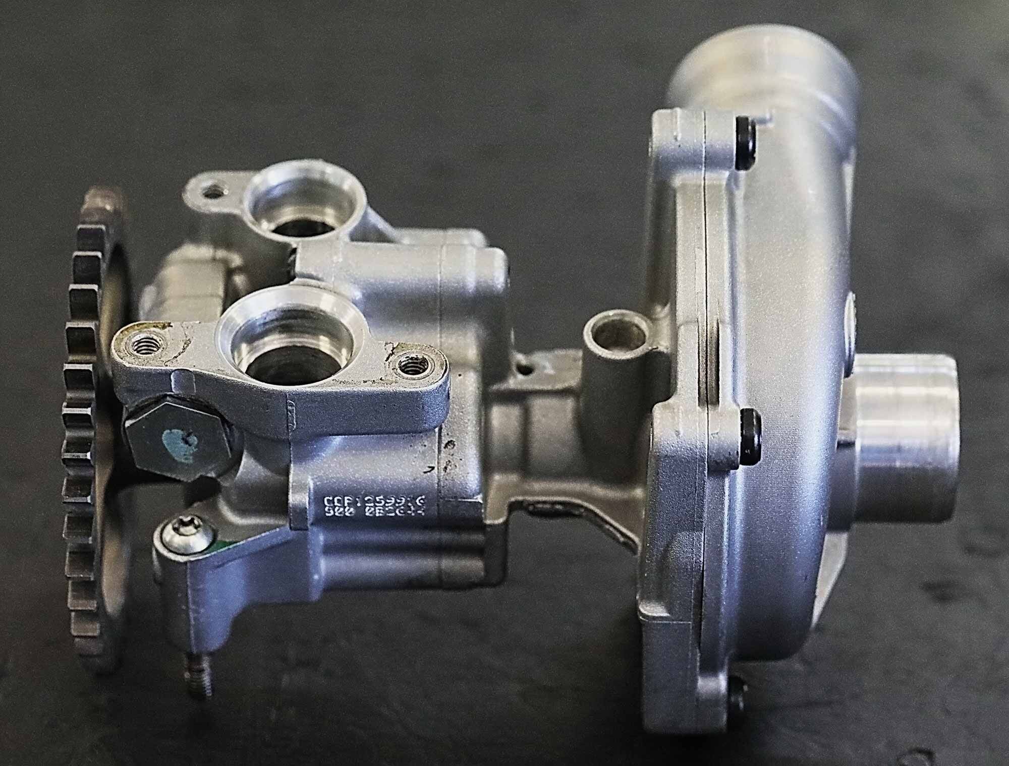

Connecting rods are totally new in both design and size. Even though they are 10mm longer to maintain the correct stroke-to-con-rod-length ratio, they’re still very light. (Bruno dePrato/)The oil-cooler pump is new, compact, and immensely more functional than the previous unit.

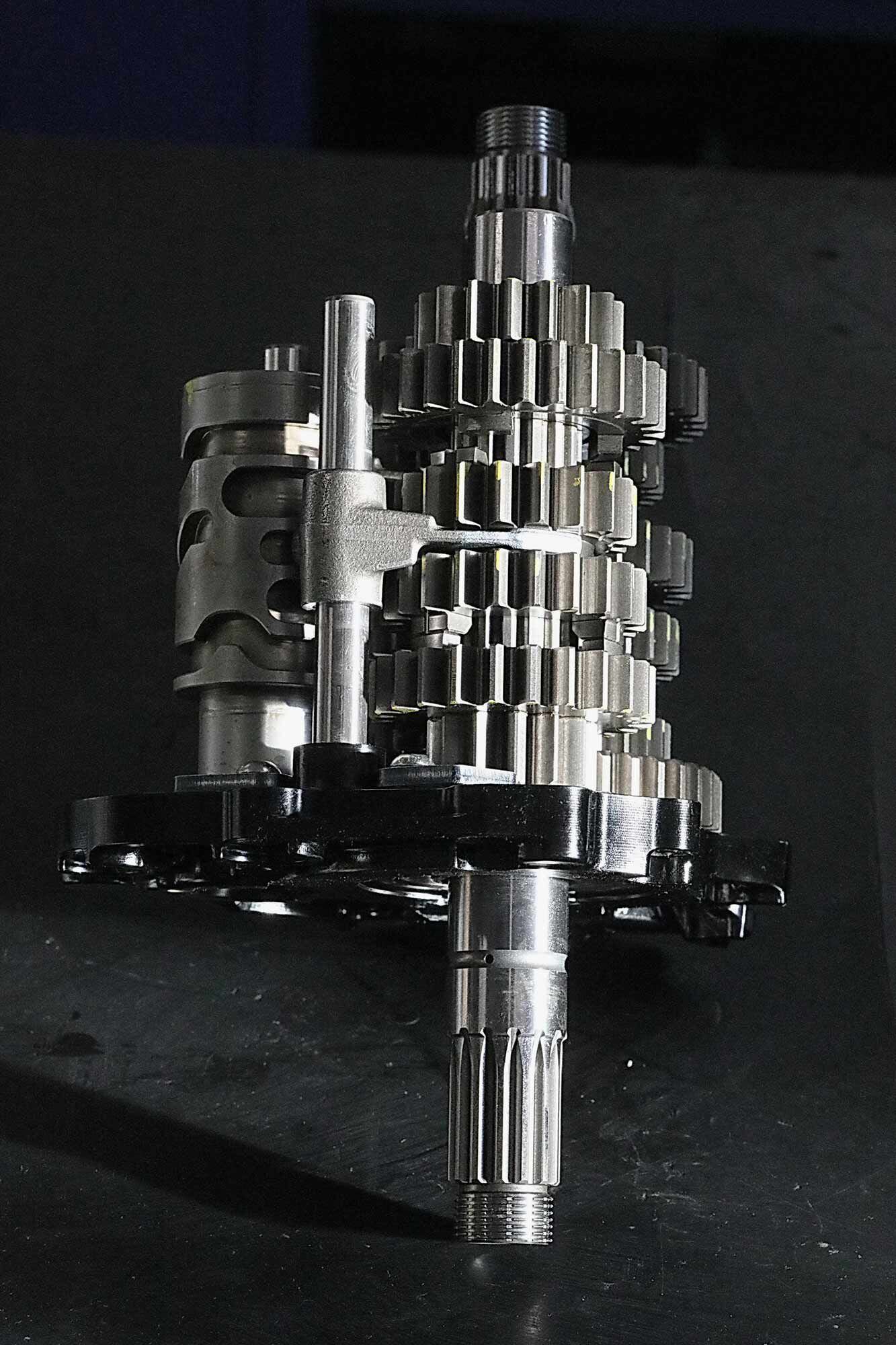

The oil-cooler pump is new, compact, and immensely more functional than the previous unit. (Bruno dePrato/)The six-speed gearbox is all new and both stronger and smoother. Straight-cut advanced-module gears are expected to be quieter and absorb less power than Gleason-type helical-cut gears.

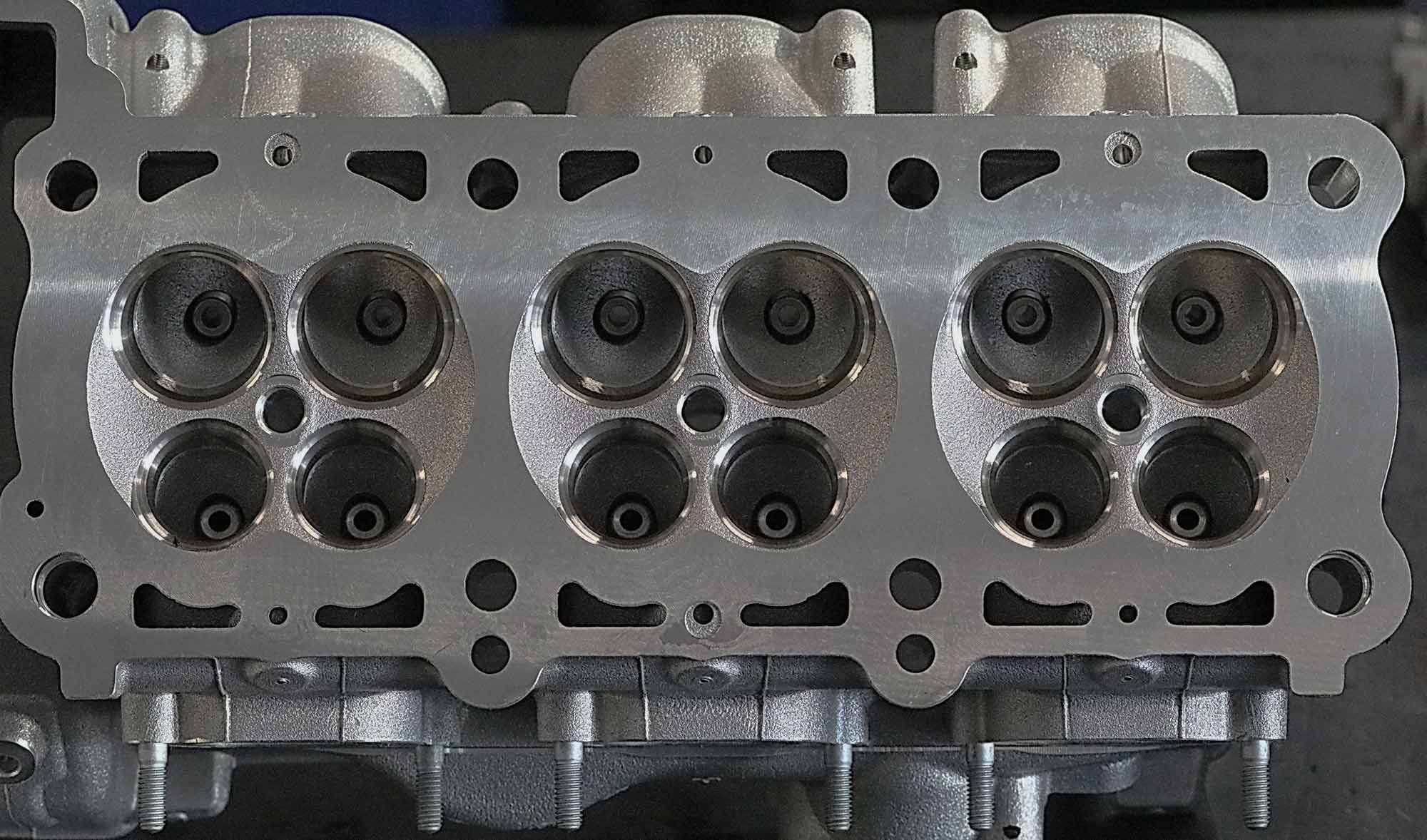

The six-speed gearbox is all new and both stronger and smoother. Straight-cut advanced-module gears are expected to be quieter and absorb less power than Gleason-type helical-cut gears. (Bruno dePrato/)The 950’s head features a shallow combustion-chamber profile, with valves set at 23 degrees (included) angle for a 12.5:1 compression ratio. Intake valves measure 31.8mm, exhausts 26.7mm.
The 950’s head features a shallow combustion-chamber profile, with valves set at 23 degrees (included) angle for a 12.5:1 compression ratio. Intake valves measure 31.8mm, exhausts 26.7mm. (Bruno de Prato/)
