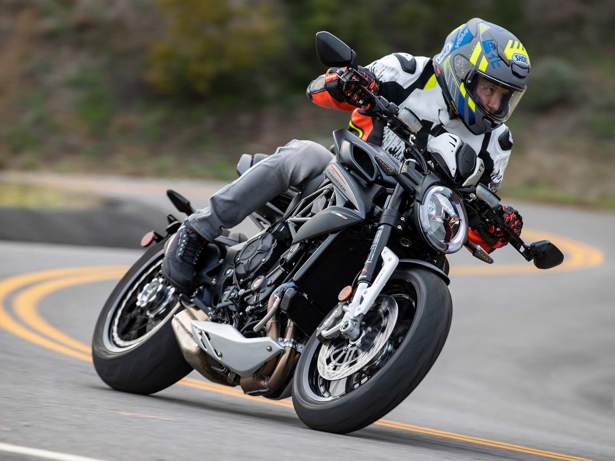

It’s hard to keep a low profile on the 2022 MV Agusta Dragster RR SCS.
It’s hard to keep a low profile on the 2022 MV Agusta Dragster RR SCS. (Jeff Allen/)
I’ve always had a sweet spot in my heart for MV Agusta. Like most people, I find that part of my attraction to this most boutique of boutique manufacturers comes from the way MV’s designers turn wicked concepts into striking reality with no regard to price consciousness or manufacturing volume. Also, MV Agusta riders aren’t likely to see another example of their bike on an average Sunday ride, and when their MV gets noticed—and its distinctive looks, sound, and cool factor mean it almost certainly will be—the reaction the bike receives is unlike anything else.

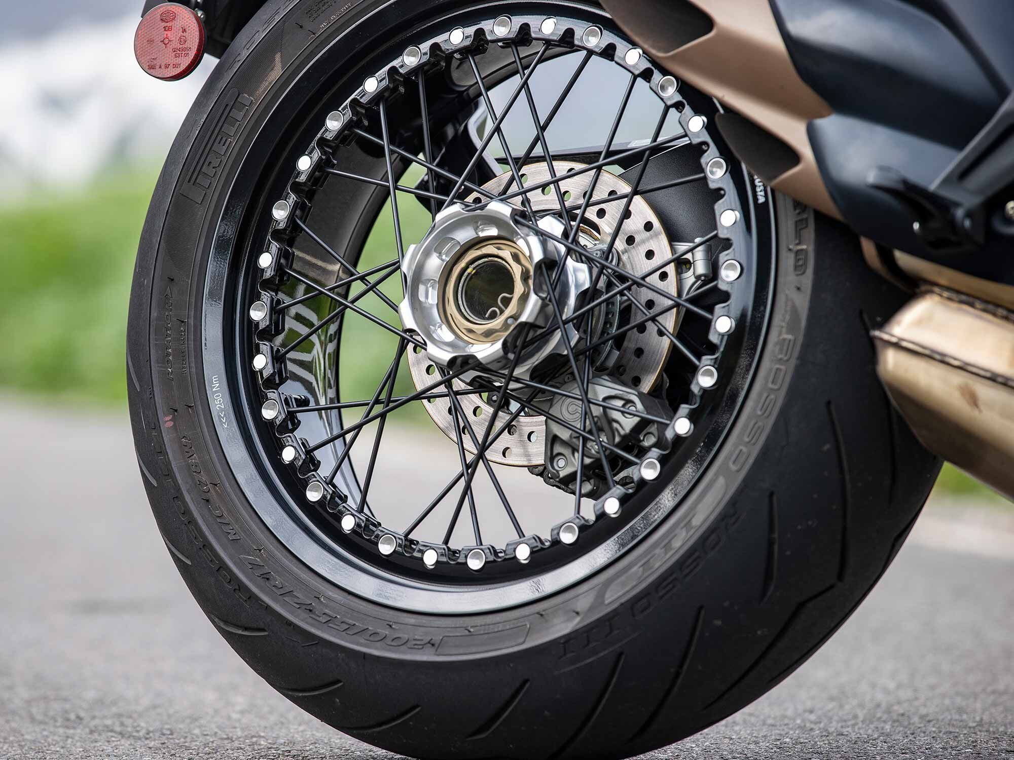

Riding around Southern California, we did get those nods of approval; the bike is quite striking, with notable design features including the single-sided swingarm and black-spoked wheels; particularly interesting are the rear wheel spokes, which are attached only to one side of the rim for a strikingly unique look.
The Dragster’s spoked rear wheel is undeniably cool.
The Dragster’s spoked rear wheel is undeniably cool. (Jeff Allen/)

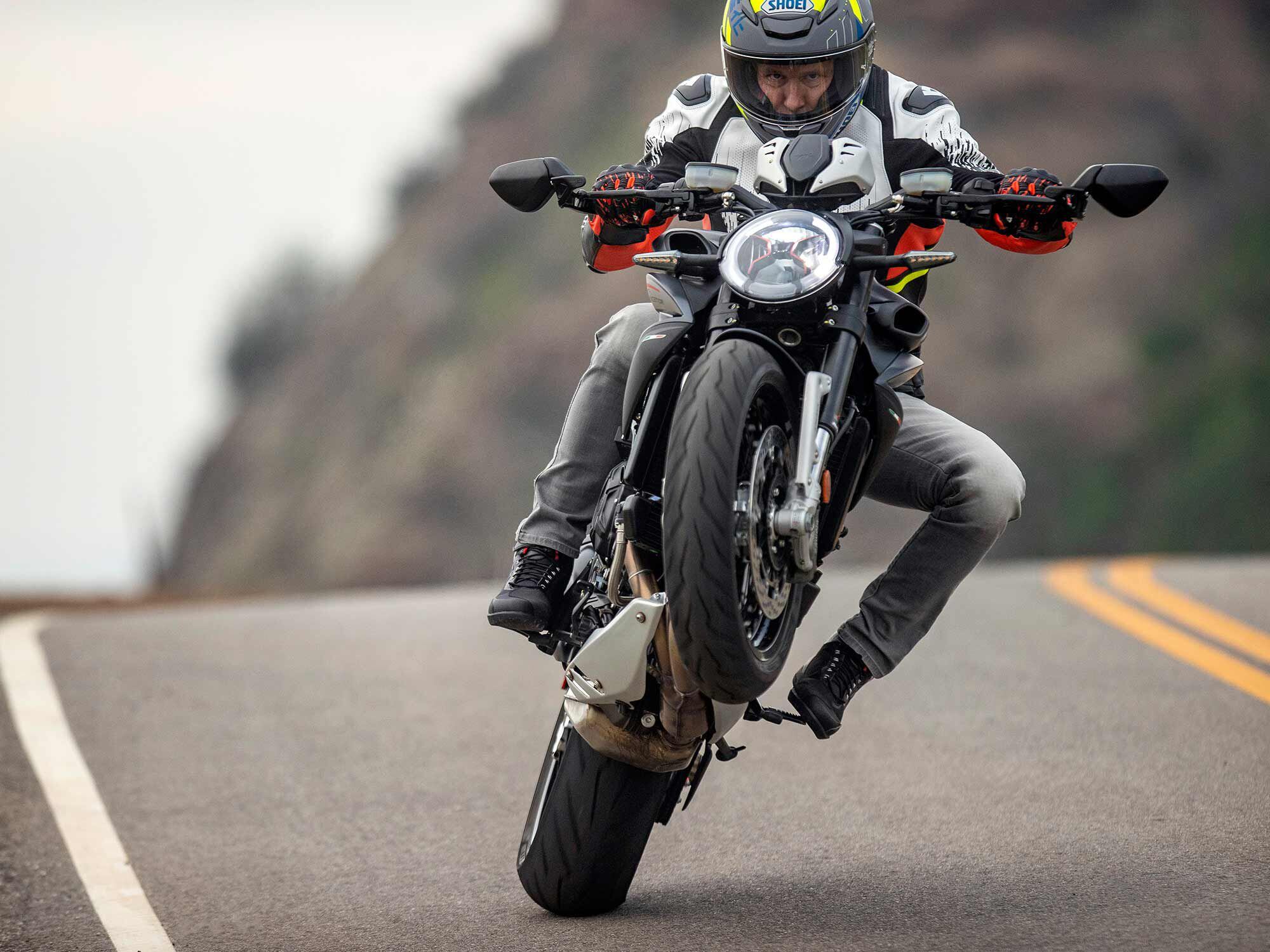

Practically speaking, the MV’s wide, flat, forward-rotated two-piece handlebar feels a bit awkward, and with mirrors mounted at the ends of each handlebar, the RR looks as wide as it feels. In reality, it should be regarded as wide indeed, because splitting California traffic at stop lights or navigating through narrow spots gets a bit dodgy; riders will find themselves rotating their mirrors inward quite often. These bar-end mirrors are also more susceptible to vibration, especially at freeway-plus speeds, when it’s difficult to discern if the vehicle behind you has its lights in front or on top—until they’re flashing. Pretty important stuff here. While I did not experience any flashing lights, constant mirror adjustment and vibration eventually caused the mirrors to loosen to the point where they vibrated inward on their own. Ugh.
A wide and flat handlebar can feel awkward, especially while lane-splitting on California’s congested freeways.
A wide and flat handlebar can feel awkward, especially while lane-splitting on California’s congested freeways. (Jeff Allen/)

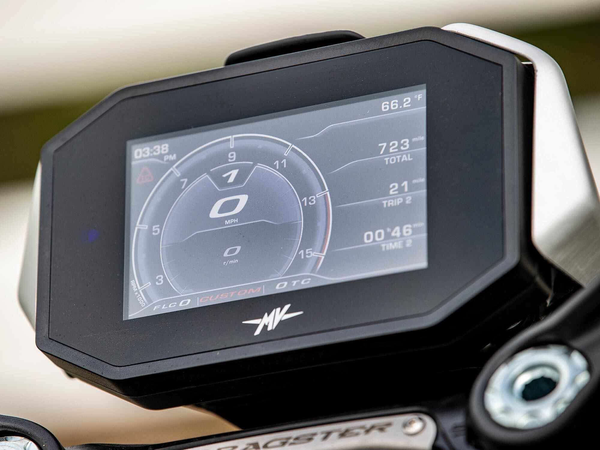

One thing missing from the Dragster’s dash is a fuel gauge. There is a reserve warning, but it would be helpful to have a gauge as fuel consumption varies wildly between commuting and blasting through the canyons.
One thing missing from the Dragster’s dash is a fuel gauge. There is a reserve warning, but it would be helpful to have a gauge as fuel consumption varies wildly between commuting and blasting through the canyons. (Jeff Allen/)
The track display provides a ton of information, all built around the six-axis IMU and its multitude of sensors. If the rider dares to keep one eye on the dash, they can see separate left and right real-time lean angles along with maximum lean, separate braking and acceleration Gs, a lap counter, lap time, maximum speed and more. After the ride, the display allows a review of GPS tracking as well.
There’s also an MVRide app allowing smartphones to access the MV data and make changes to the RR. The app also allows the rider to interface their phone through the dash for notifications, music, texts, and more; a lot of connectivity, if the rider wants that kind of access.

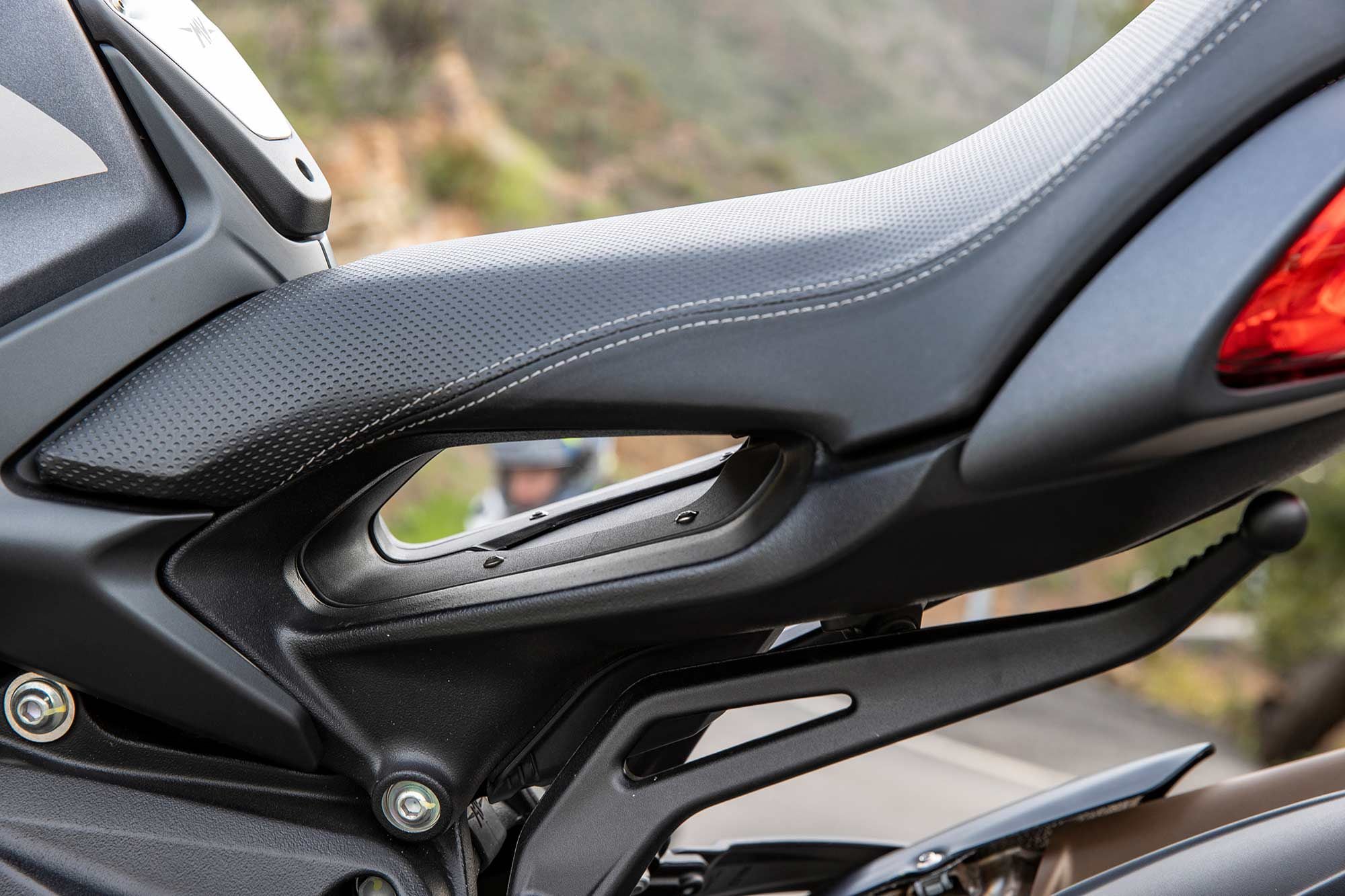

For any length of time spent touring down your favorite stretch of highway, using the navigation system, cruise control, talking on the phone, or listening to music, I’d strongly suggest a seat upgrade. Even though the stock seat is a memory foam unit, this 165-pound rider had a sore arse after about 40 miles of freeway flogging.
Although the seat features memory foam, it gets uncomfortable quickly.
Although the seat features memory foam, it gets uncomfortable quickly. (Jeff Allen/)

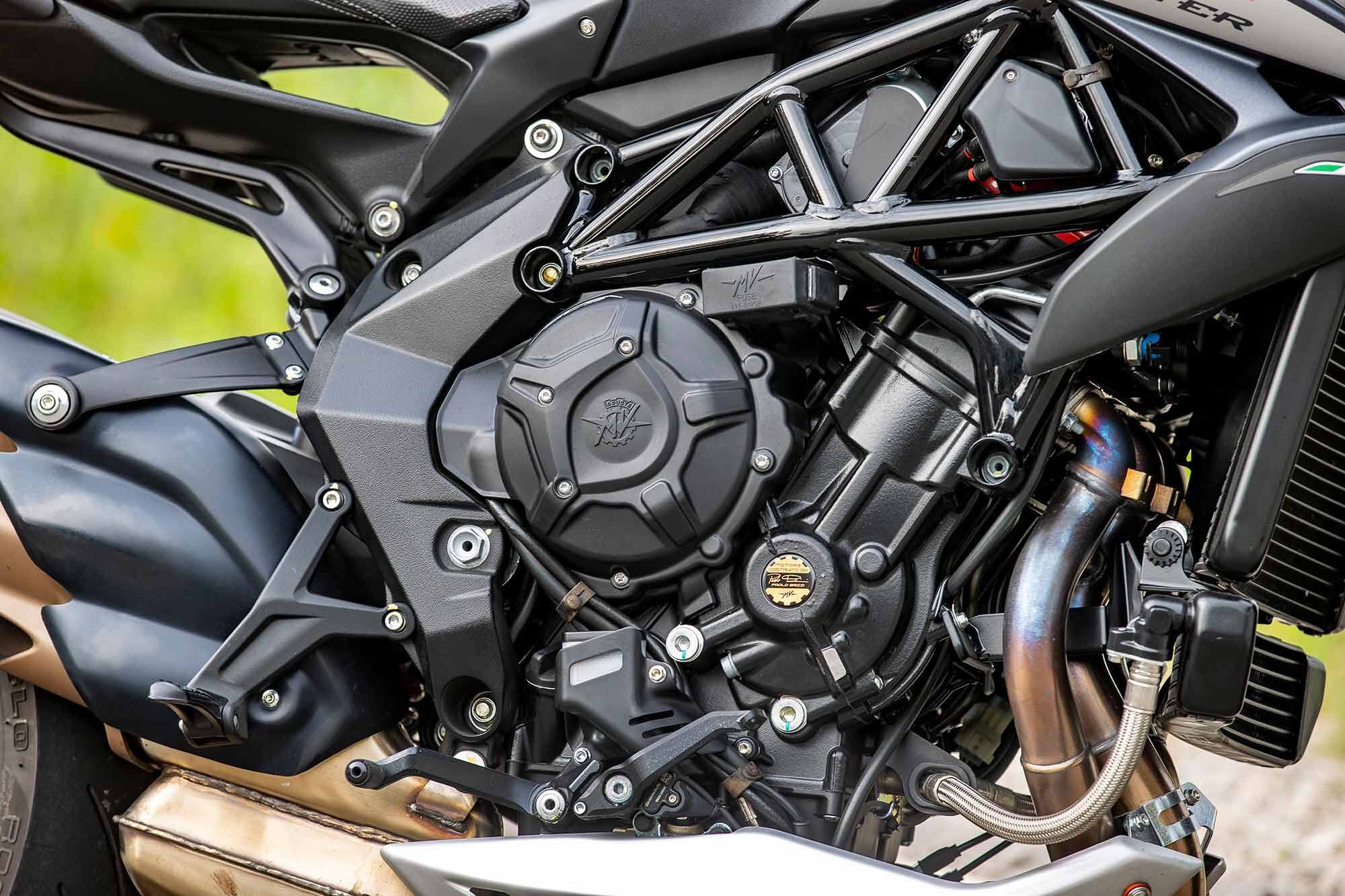

On the <i>CW</i> dyno the Dragster’s triple cranked out 119.4 hp and 59.4 pound-feet.
On the <i>CW</i> dyno the Dragster’s triple cranked out 119.4 hp and 59.4 pound-feet. (Jeff Allen/)
One surprise about riding in this spirited manner was getting only 26 mpg from the 4.3-gallon fuel tank, which, come to think of it, may have contributed to that 12 miles of reserve range. Well, fun comes at a price, and a simple freeway cruise should get you north of the 43.1 overall mpg I observed.

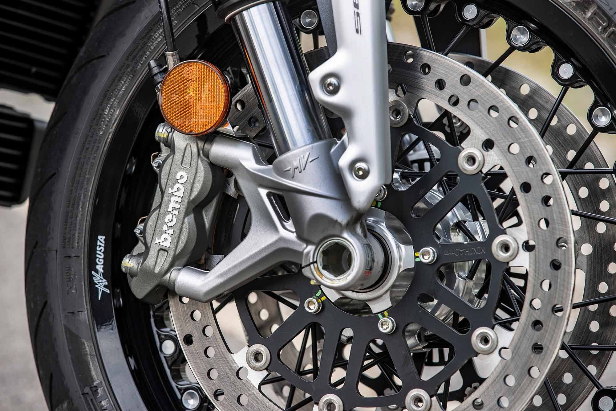

Helping to stop the MV, which is 455 pounds when full of gas and ready to ride, are four-piston Brembo calipers up front forcefully squeezing dual 320mm rotors. Even though the brakes are strong with good feel, with ABS intervention for higher-performance street riding, we felt the ABS kicked in a bit early during our brake testing and panic stops, which actually decreased our expected stopping power.
Four-piston Brembo calipers matched to 320mm discs provide strong stopping power but ABS does intervene too early.
Four-piston Brembo calipers matched to 320mm discs provide strong stopping power but ABS does intervene too early. (Jeff Allen/)

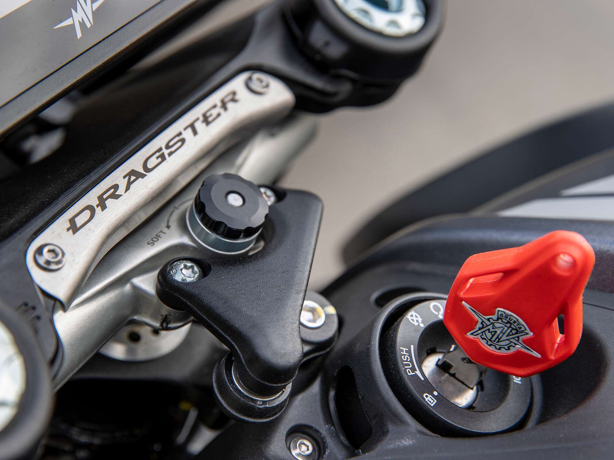

The suspension setup that provided me (165 pounds) the best all-around balance and ride performance are:
  • Front fork springs at maximum preload; compression damping at maximum - 1.75 turns; rebound damping at maximum - 0.5 turn
  • Rear shock spring at no change from factory setting; compression damping at maximum - 2.75 turns; rebound damping at maximum - 0.5 turn
  • Steering damper at maximum
I would have liked to try a bit more preload, or even heavier fork springs, but then that would also require more rebound damping. Also, for heavier riders who require additional preload or stiffer shock spring, the same would apply with regard to rebound damping in the shock.
We set the steering damper to maximum.
We set the steering damper to maximum. (Jeff Allen/)

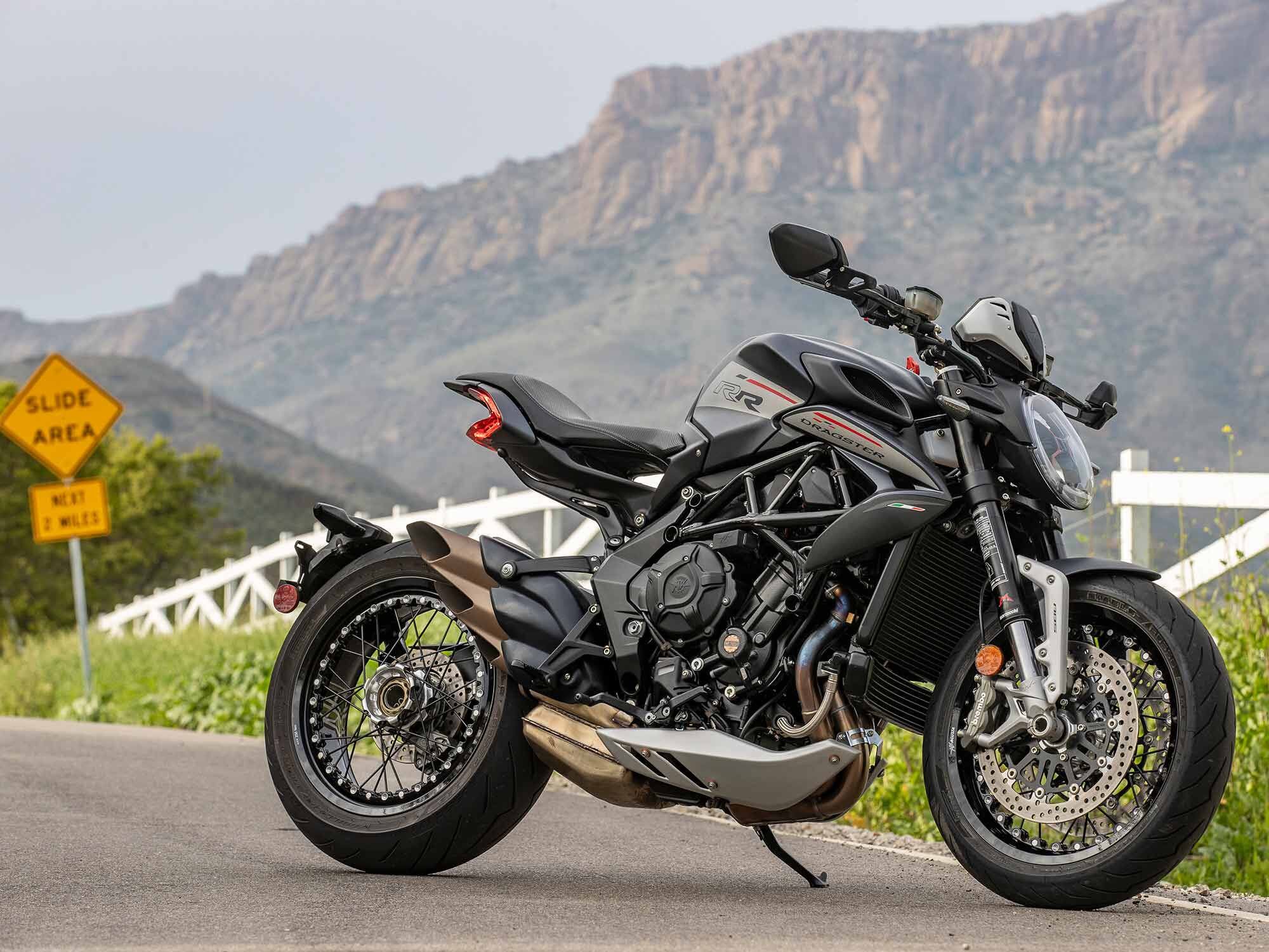

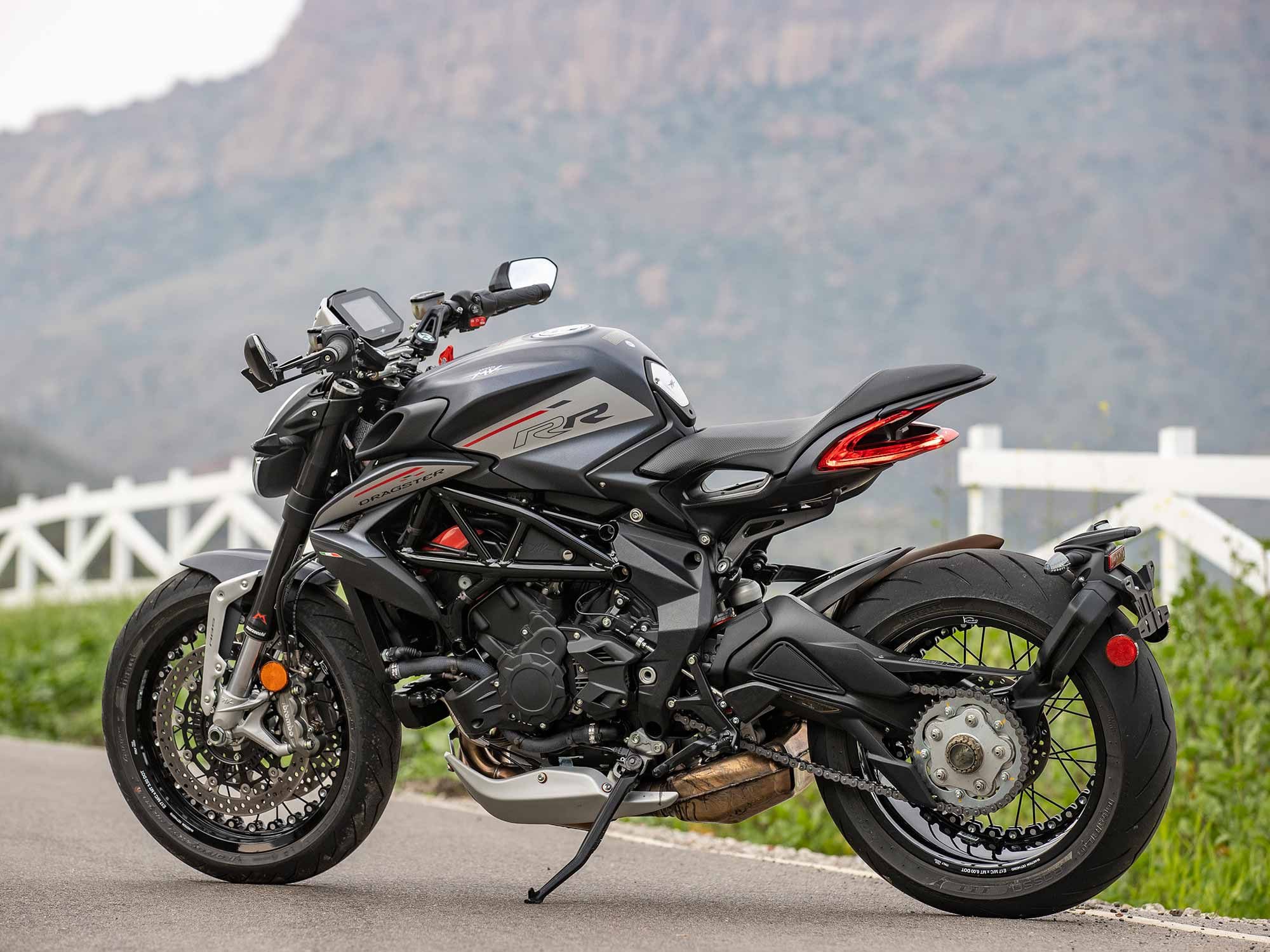

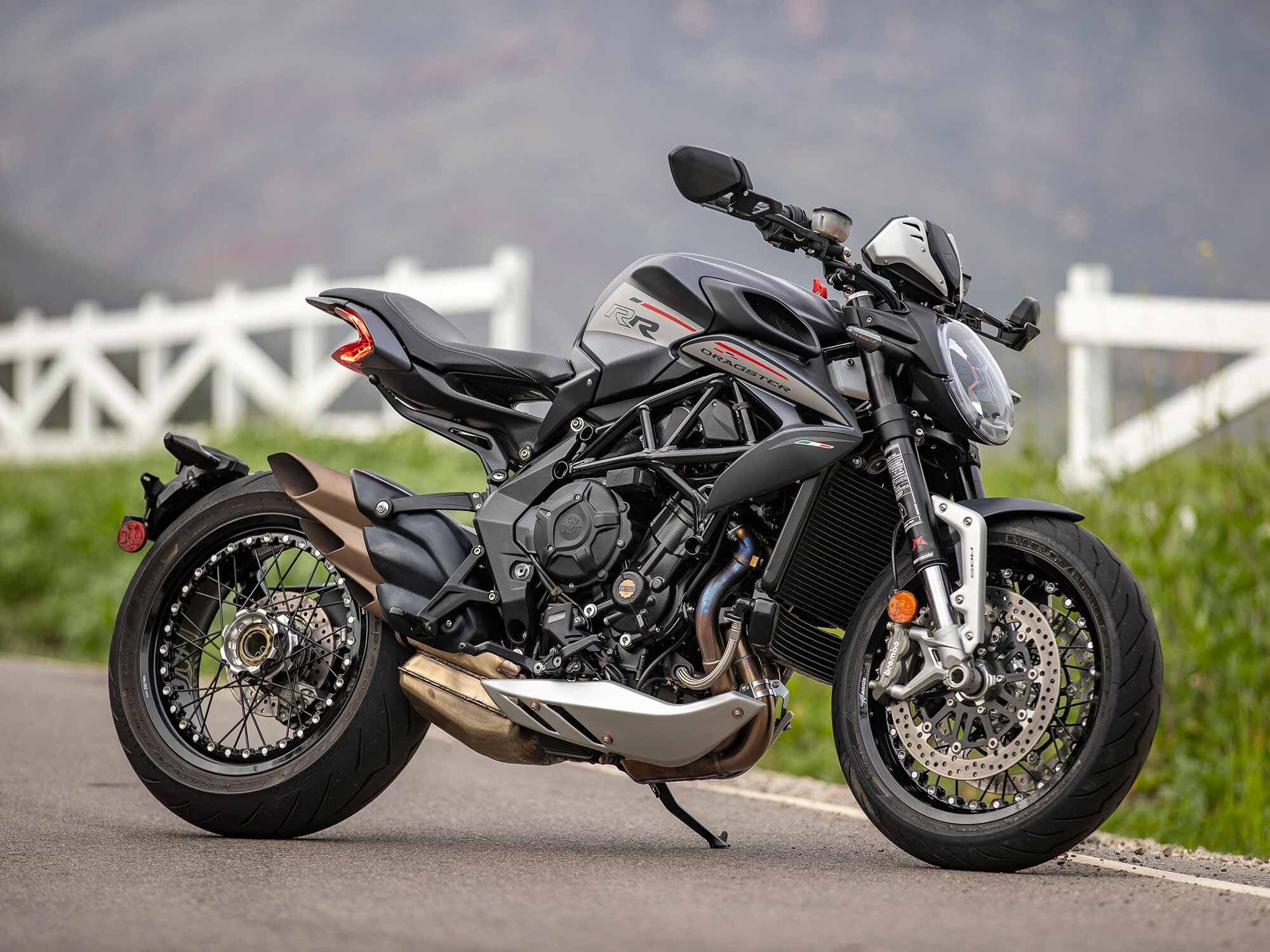

Even by modern naked standards, the MV Agusta Dragster RR SCS looks wild.
Even by modern naked standards, the MV Agusta Dragster RR SCS looks wild. (Jeff Allen/)Three slash-cut pipes, a single-sided swingarm, spoked wheels, and a trellis frame—sometimes it is hard to know where to stare on the Dragster RR SCS.
Three slash-cut pipes, a single-sided swingarm, spoked wheels, and a trellis frame—sometimes it is hard to know where to stare on the Dragster RR SCS. (Jeff Allen/)
