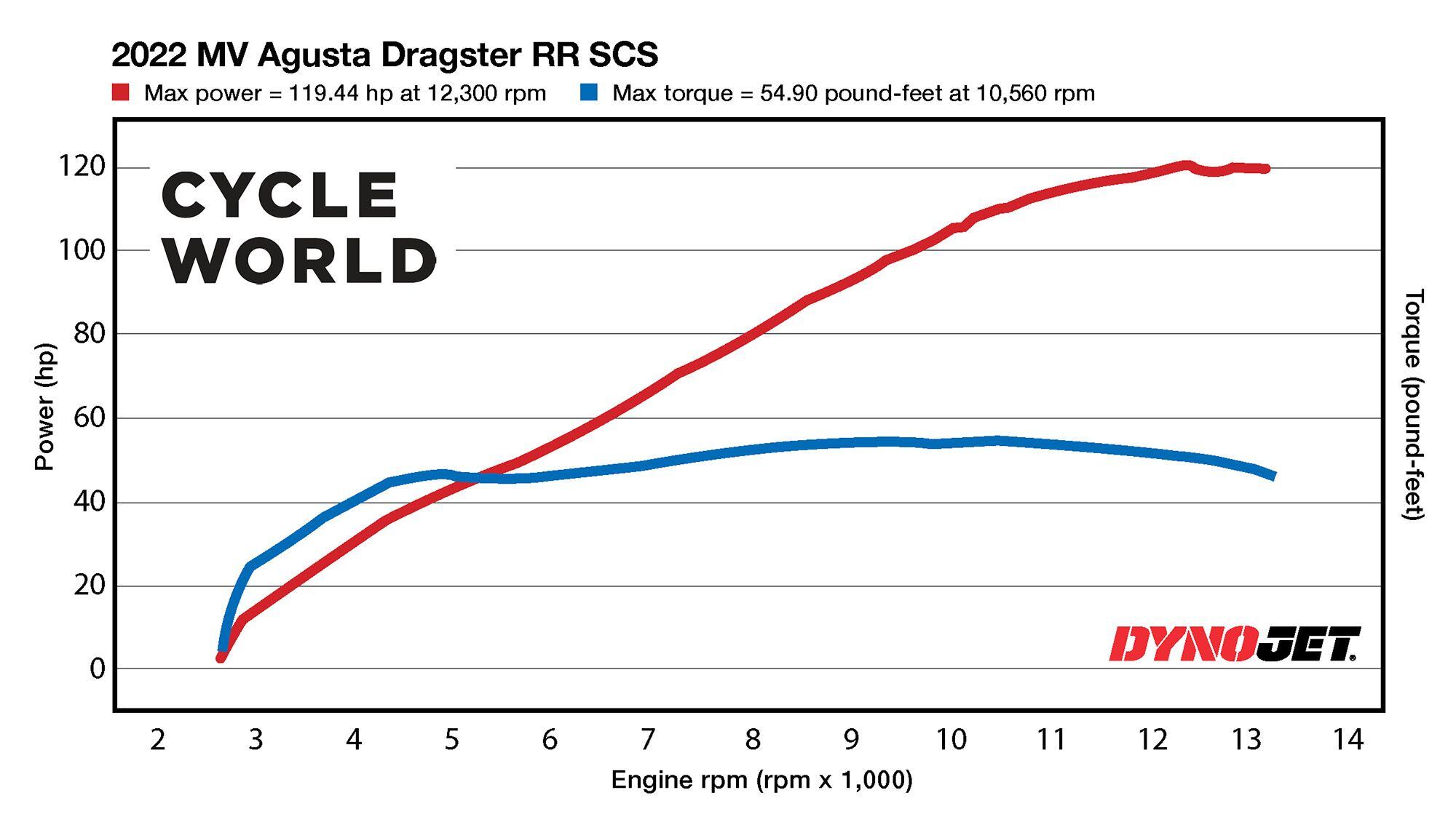

Horsepower and torque figures of the 2022 MV Agusta Dragster RR SCS.
Horsepower and torque figures of the 2022 MV Agusta Dragster RR SCS. (Robert Martin Jr./)
Ahead of our review of the 2022 Dragster RR SCS, we ran the motorcycle on our in-house Dynojet 250i dynamometer, recording horsepower and torque figures. The Dragster produced a peak 119.44 hp at 12,300 rpm and 54.90 pound-feet of torque at 10,560 rpm. For reference, those are very similar figures to that of the last Triumph Street Triple RS that we tested and slightly more horsepower than the Yamaha MT-09 SP produced. The most impressive aspect is the admirably flat torque curve that makes for strong and tractable acceleration from nearly any rpm. Horsepower output doesn’t surpass the 100 hp threshold until nearly 9,500 rpm, so taking advantage of the RR’s peak performance means keeping it singing.
