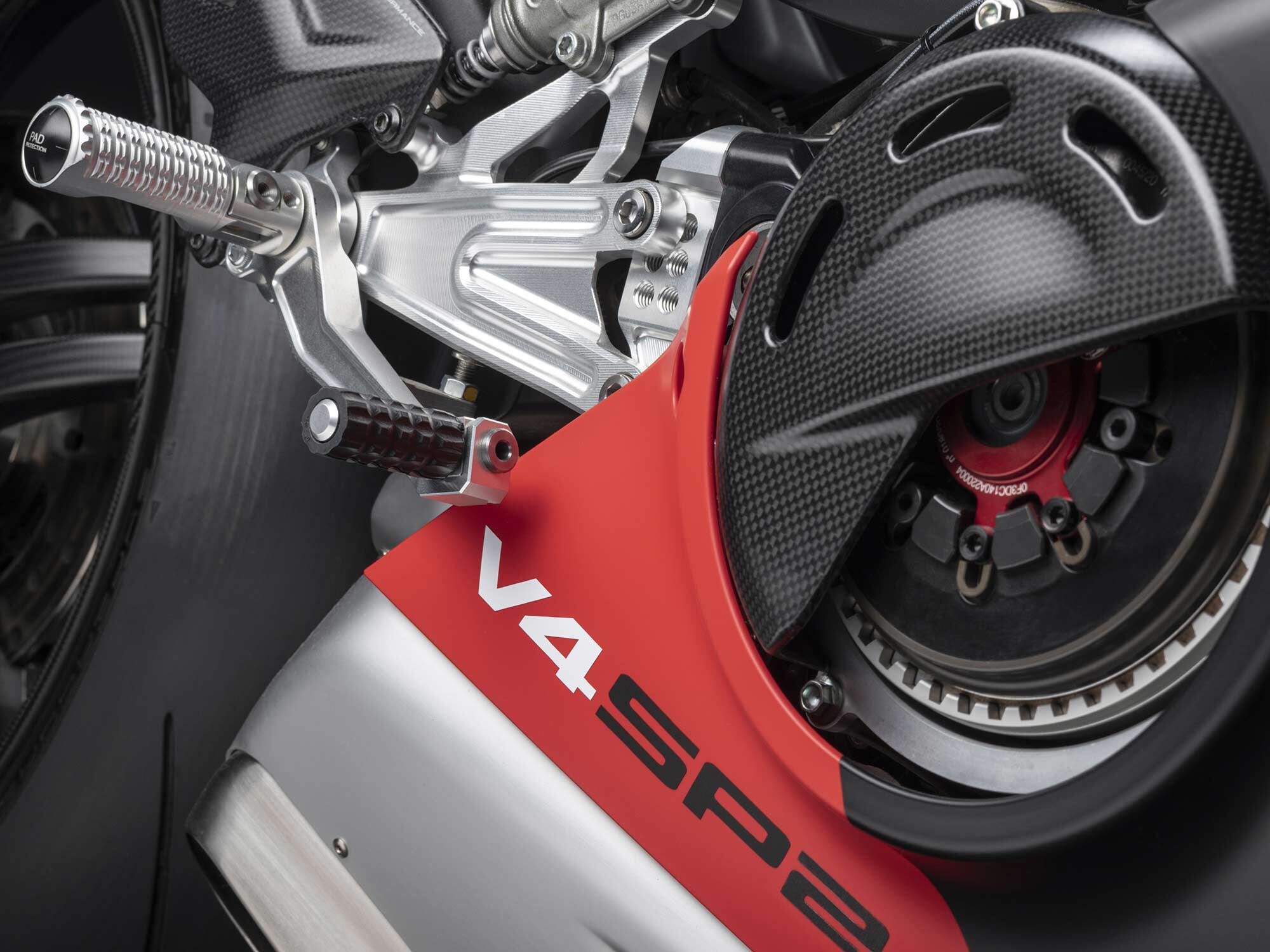

Let’s explore some of the SP2′s more tasty bits. First, it offers a STM-Evo SBK dry clutch in place of the regular oil-bath wet clutch. The STM-Evo unit is directly derived from Ducati’s World Superbike racers. The design ensures superior anti-hop performance, and riders can further tune it with a selection from Ducati’s special parts list, allowing them to custom tailor the clutch’s spring preload. The bike’s final drive uses a lighter, 520-type chain.
The SP2’s dry clutch is just the start of the exotica. Ducati also makes a selection of springs, so you can fine-tune clutch preload.
The SP2’s dry clutch is just the start of the exotica. Ducati also makes a selection of springs, so you can fine-tune clutch preload. (Ducati/)

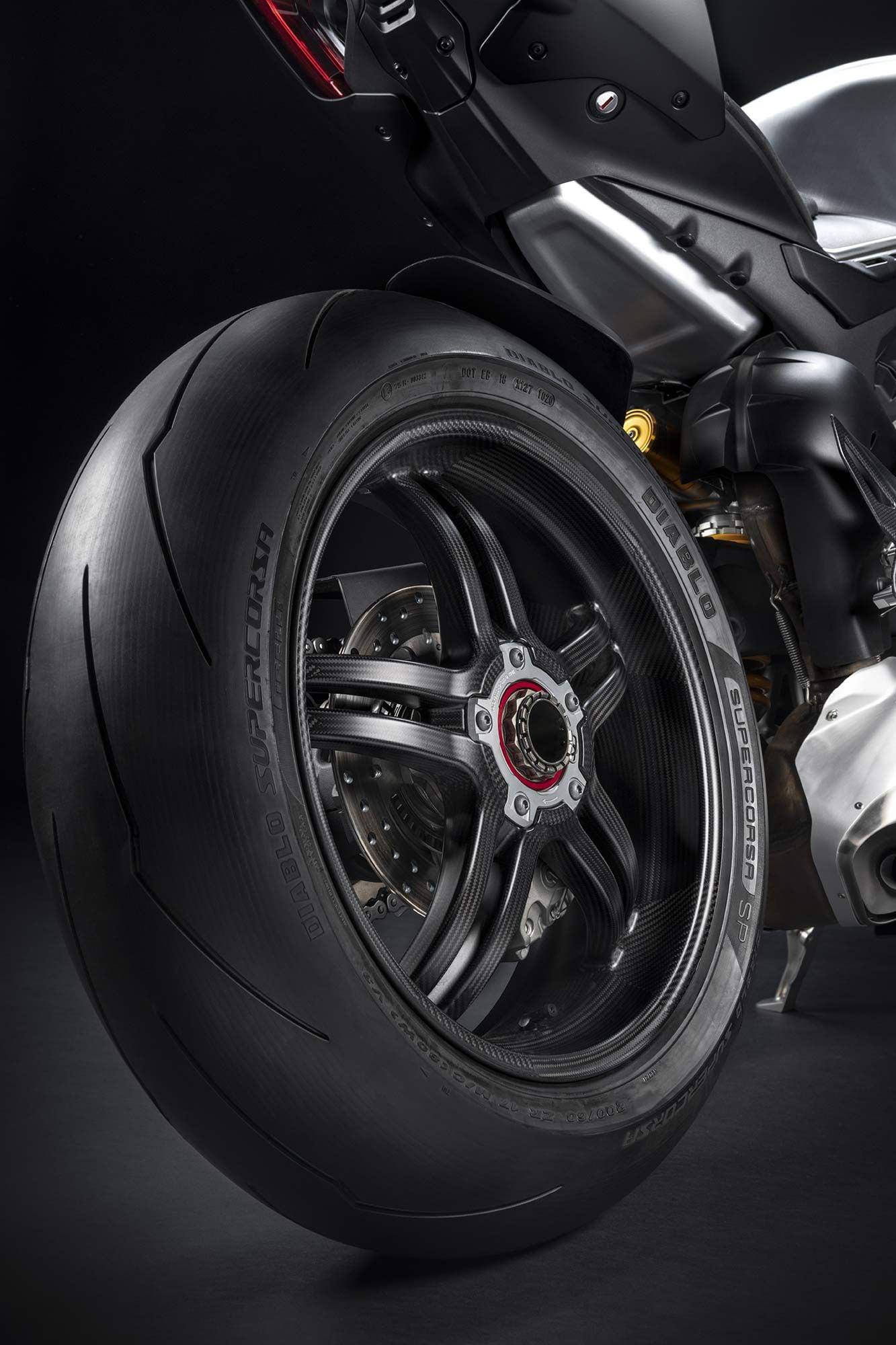

The Panigale V4 SP2′s vastly improved chassis settings and lighter weight are the bike’s other main virtues. Carbon wheels replace Panigale V4 S’s forged-aluminium equivalents, substantially reducing unsprung mass by about three pounds each. The carbon wheels also reduce gyroscopic effect, and of course, naturally add an extra touch of exclusivity. Wheel size doesn’t change, and are still the customary 17 x 3.50 front and 17 x 6.00 rear, mounted with Pirelli Diablo Supercorsa tires, 120/70-17 and 200/60-17 fore and aft.
If you’ve got it, flaunt it. Nothing shows off the SP2’s delicious carbon wheels like the bike’s single-sided swingarm.
If you’ve got it, flaunt it. Nothing shows off the SP2’s delicious carbon wheels like the bike’s single-sided swingarm. (Ducati/)

Since the Panigale V4 SP2 is intended to be the ultimate trackday bike, the mirrors and license plate holder are all quick release. The clutch and brake levers are lightened and micro adjustable, as are the foot controls and pegs. All are machined from aluminium billet, as are the triple clamps. While on that subject, each Panigale V4 SP2 is serially numbered in a limited edition, that number engraved into the top clamp.
