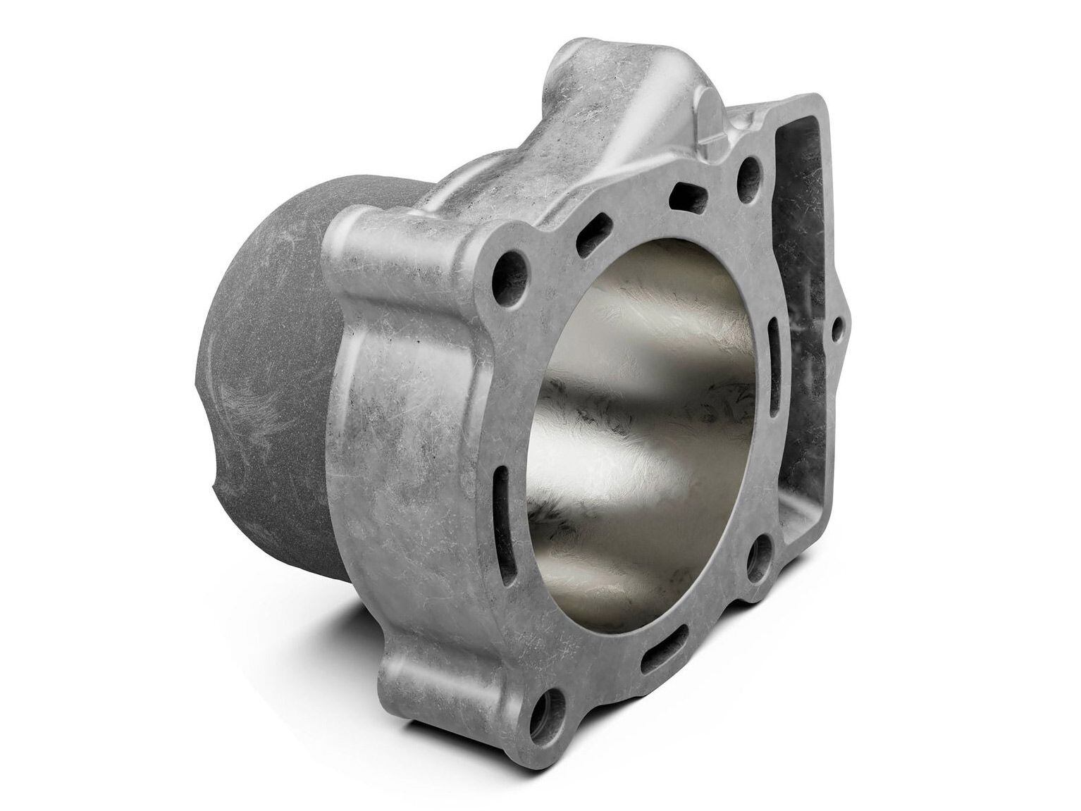

Modern cylinders are coated with hard plating to improve piston cooling.
Modern cylinders are coated with hard plating to improve piston cooling. (KTM/)

Look at almost any late-model motorcycle engine’s cylinder bore and you will no longer see the traditional (and heavy) iron cylinder liner. German engine-development engineers racked their brains for ways to boost power, equaling or exceeding the performance of Allied fighters. Their testing confirmed that by eliminating the iron liner, which conducts heat poorly, and applying hard, porous chromium plate directly onto an aluminum cylinder, they could cool hard-working pistons faster.
In the early 1960s, when Yamaha was confronted with high two-stroke piston temperatures causing outright seizure or piston-ring sticking from oil gumming, the Tuning Fork folks tried the same thing. First they tried anodizing the aluminum cylinder wall, turning it into hard ceramic aluminum oxide. When that proved unreliable they adopted hard but porous chrome plating, and by 1967 they had a durable solution. Current production motorcycle engines employ even more durable hard plating such as Nikasil to improve piston cooling and shed the 6 pounds that iron liners can add.
