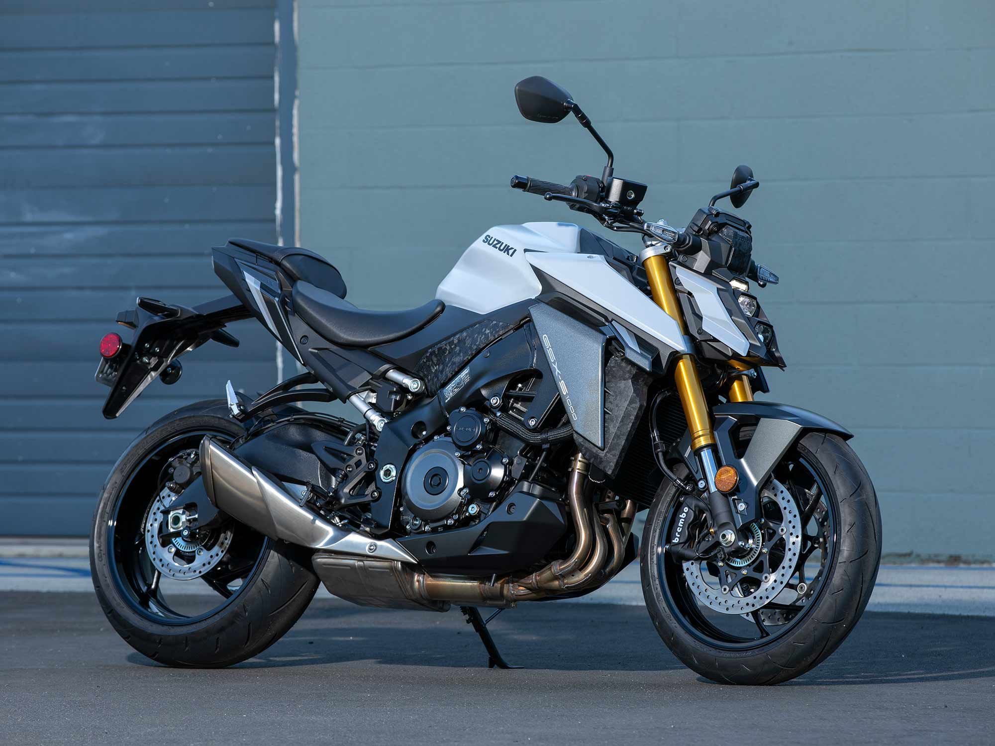

Metallic Matte Mechanical Gray is a real looker.
Metallic Matte Mechanical Gray is a real looker. (Kevin Wing/)

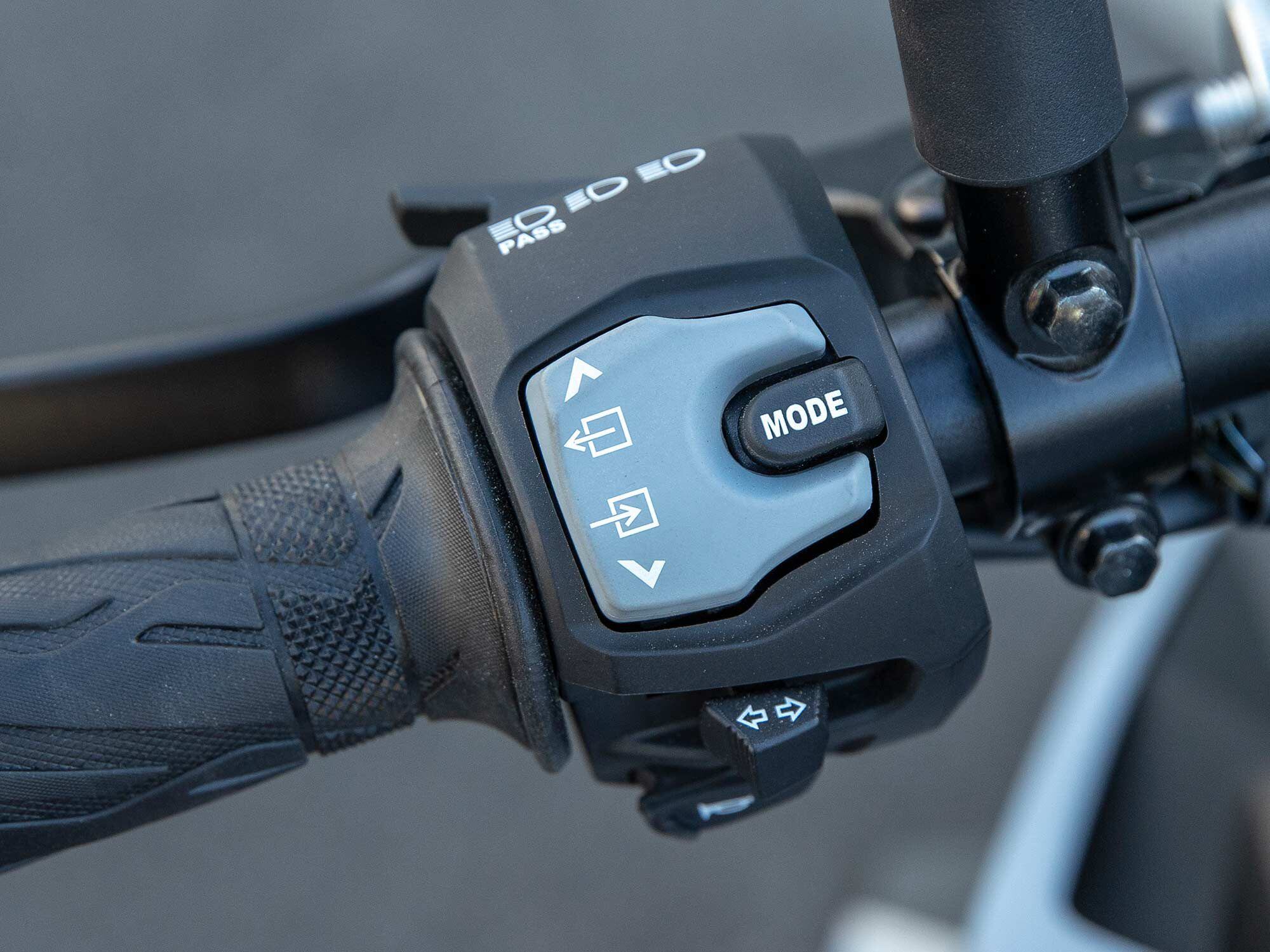

These magic buttons navigate the menus for ride modes and traction-control settings.
These magic buttons navigate the menus for ride modes and traction-control settings. (Kevin Wing/)

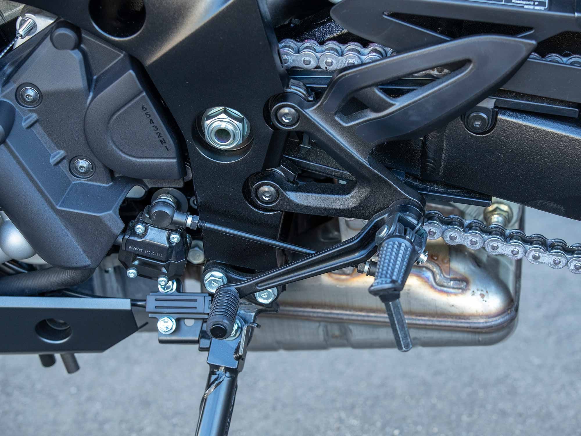

Keeping things smooth is the Bi-directional Quick Shift System (QS), which is completely new and differs somewhat from the new Hayabusa’s design. A new gear-position sensor is mounted to the engine case, no longer a plunger mechanism on the shift linkage.

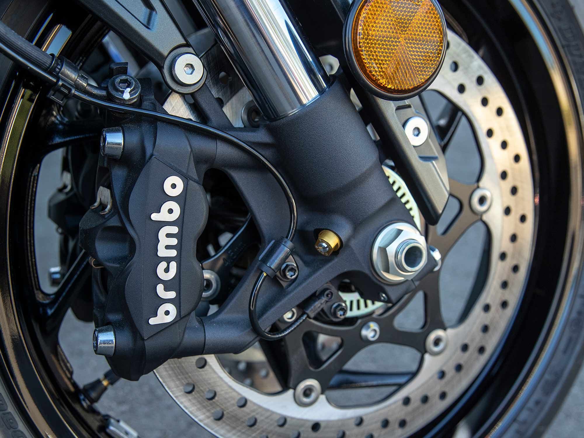

Brembo Monoblock four-piston calipers gnaw on a pair of 320mm discs.
Brembo Monoblock four-piston calipers gnaw on a pair of 320mm discs. (Kevin Wing/)
Six-spoke cast-aluminum wheels are equipped with Dunlop Roadsport 2 radial tires, a 120/70ZR-17 front and a fat 190/50ZR-17 on the rear, developed and optimized just for this bike. Wheelbase stretches 57.5 inches, which is just a tick more than an inch and a half longer than the 2022 GSX-R1000, and the S1000 gains about 30 pounds over that track-oriented machine.

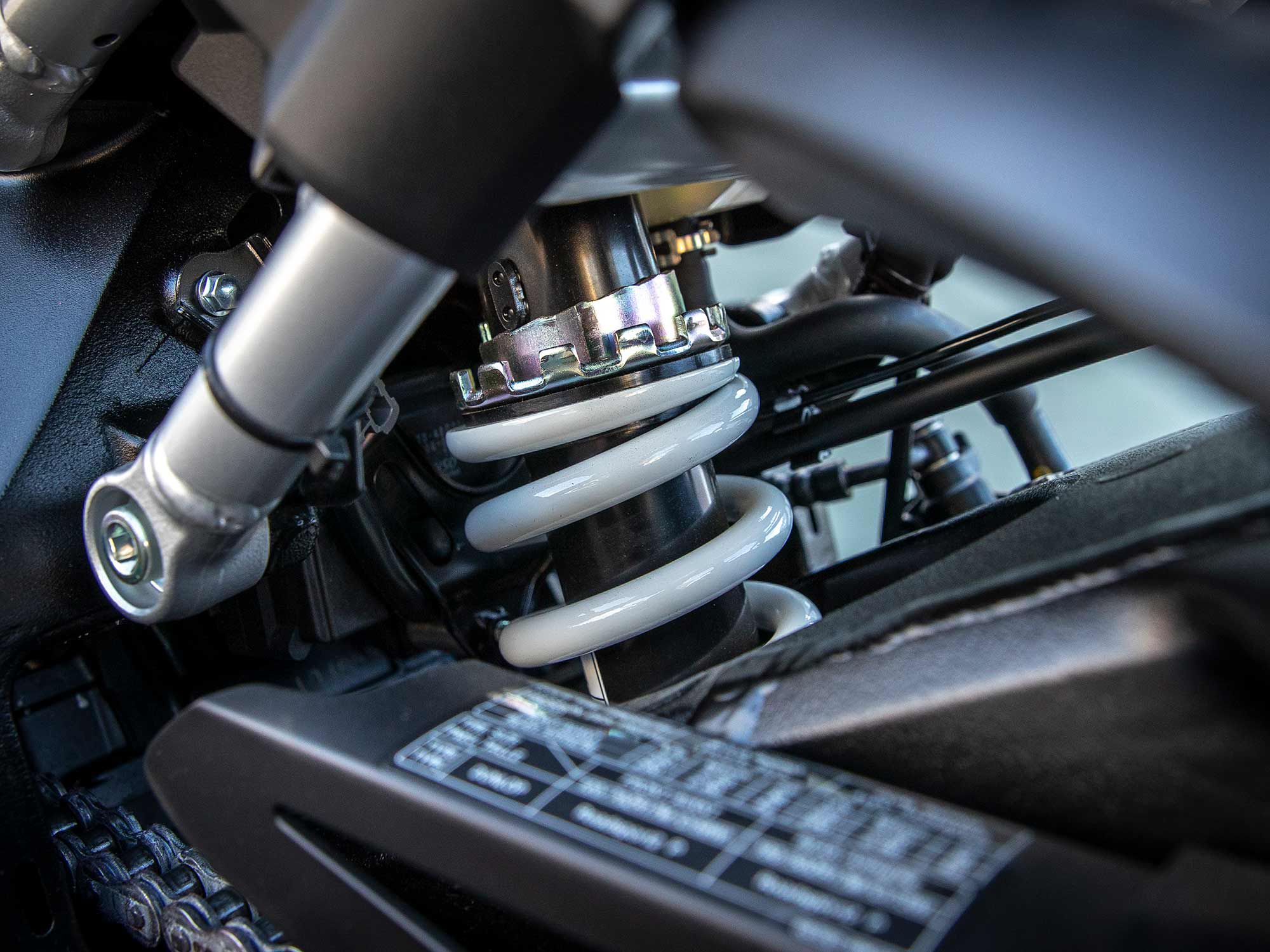

Keeping it simple, the shock is a KYB unit with provisions for spring preload and rebound damping.
Keeping it simple, the shock is a KYB unit with provisions for spring preload and rebound damping. (Kevin Wing/)

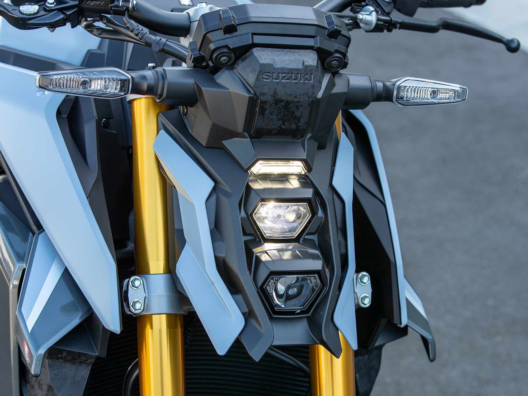

Compared to the previous-gen bike, the GSX-S1000 looks modern and sharp. The bodywork, headlights, and styling are aggressive and angular. The first thing you notice are the stacked Mono-focus LED headlights, which are tiny in size but pump out a ton of light through thick convex lenses that shape the beam pattern. The front radiator cowls blend nicely into the fuel tank cover, while mini MotoGP-style winglets are a nod to the championship-winning GSX-RR racer, though they’re undoubtedly for sheer styling and not actual aero. Textured side panels are said to help provide grip for the rider’s knees while adding to the look, while a clean tailsection and rear seat can be accessorized with a solo seat cover. An LED taillight will blaze the news of your intentions while slim LED signals front and rear blend in nicely when not in use and do their job when you want the jerk texting behind you to see you. Two color options are available, Metallic Triton Blue or Metallic Matte Mechanical Gray.
The new LED headlights are very cool looking and pump out some serious light through their convex lenses.
The new LED headlights are very cool looking and pump out some serious light through their convex lenses. (Kevin Wing/)

On the road the very first thing I noticed was the quickshifter. Compared to the already good performance of the Hayabusa’s unit, the GSX-S’ shifter is just that bit more refined, especially with the one-two shift. There were no missed or accidental shifts even when short-shifting at lower rpm. Speaking of short shifting, the S’ engine is really flexible; riders can carry a slightly taller gear and ride in a somewhat more relaxed fashion, relying on the torque to get around. Or, if the mood strikes, they can give it a good flogging and rev it out, depending on mood and disposition. The GSX-S1000 couldn’t care less either way. There is simply something utterly satisfying about a liter-class inline-four on a decent backroad.
The new bidirectional quickshifter utilizes a case-mounted mechanism instead of a plunger-type unit on a linkage. Clutchless shifts both up and down were crisp and well timed.
The new bidirectional quickshifter utilizes a case-mounted mechanism instead of a plunger-type unit on a linkage. Clutchless shifts both up and down were crisp and well timed. (Kevin Wing/)

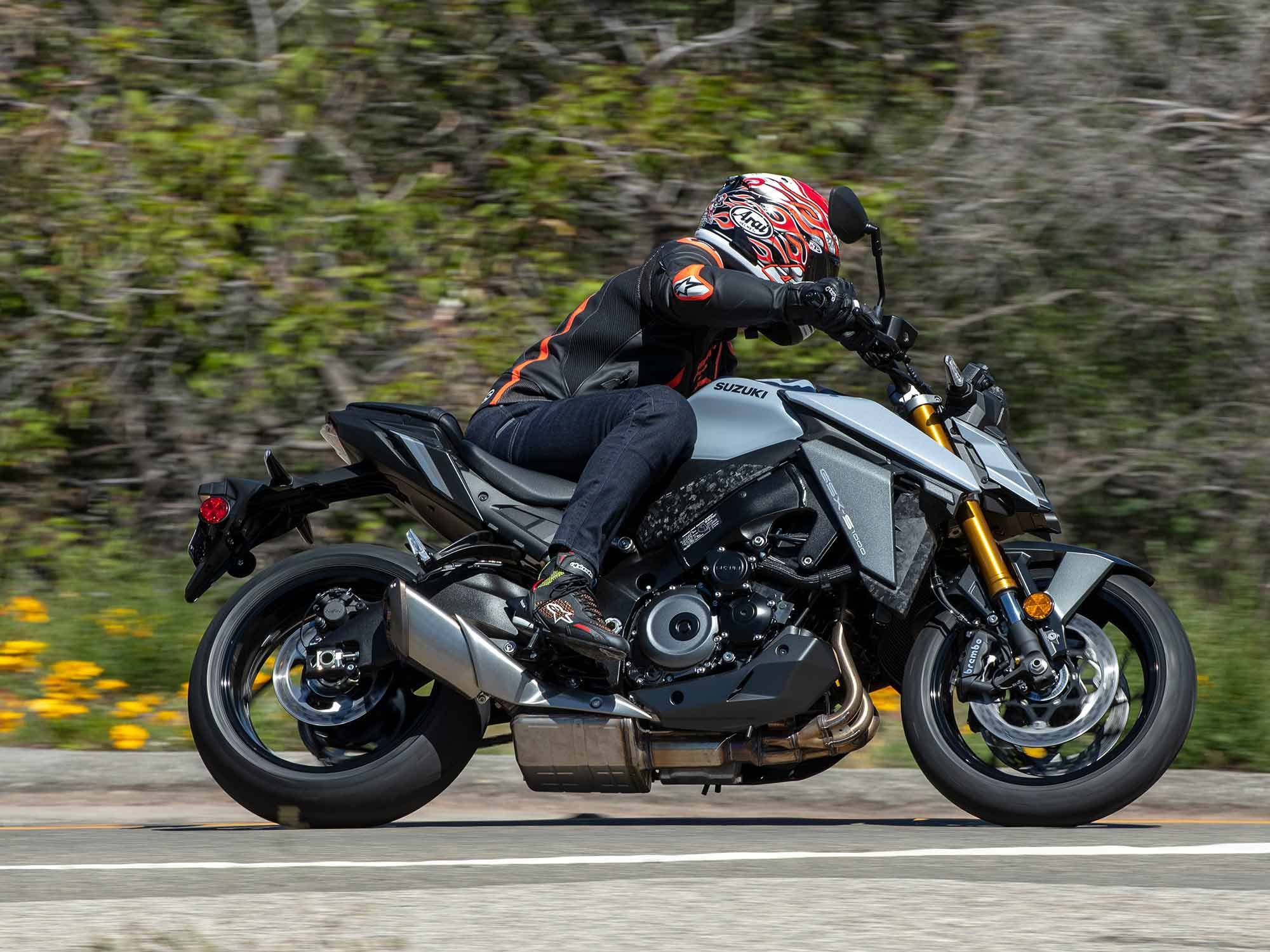

Long sweeping corners highlight the stable and planted character of the GSX-S1000′s chassis.
Long sweeping corners highlight the stable and planted character of the GSX-S1000′s chassis. (Kevin Wing/)
As mentioned, the roads we slayed went from fourth-gear sweepers to first-gear hairpins. The GSX-S has the wheelbase and geometry to feel totally planted and stable at speed, but the upright bars provide the leverage you need to get it to turn right now in the tight stuff. Despite some lingering dirt on the roads from recent mudslides, the combination of Dunlops and the planted front end provided lots of confidence to proceed without any drama. Many of the roads in the area resemble a set of supercross whoops, which meant the softish suspension settings that Suzuki dialed in for the ride weren’t a bad thing, but it would be best to get the rear end’s rebound damping dialed a bit more so it won’t boing anyone out of the seat occasionally after hitting some of the bigger undulations. The Brembo Monoblocks provide good power and feel, building progressively and predictably through the front lever’s stroke, but don’t expect them to have that superaggressive initial bite of race-oriented stoppers like the Brembo Stylema.

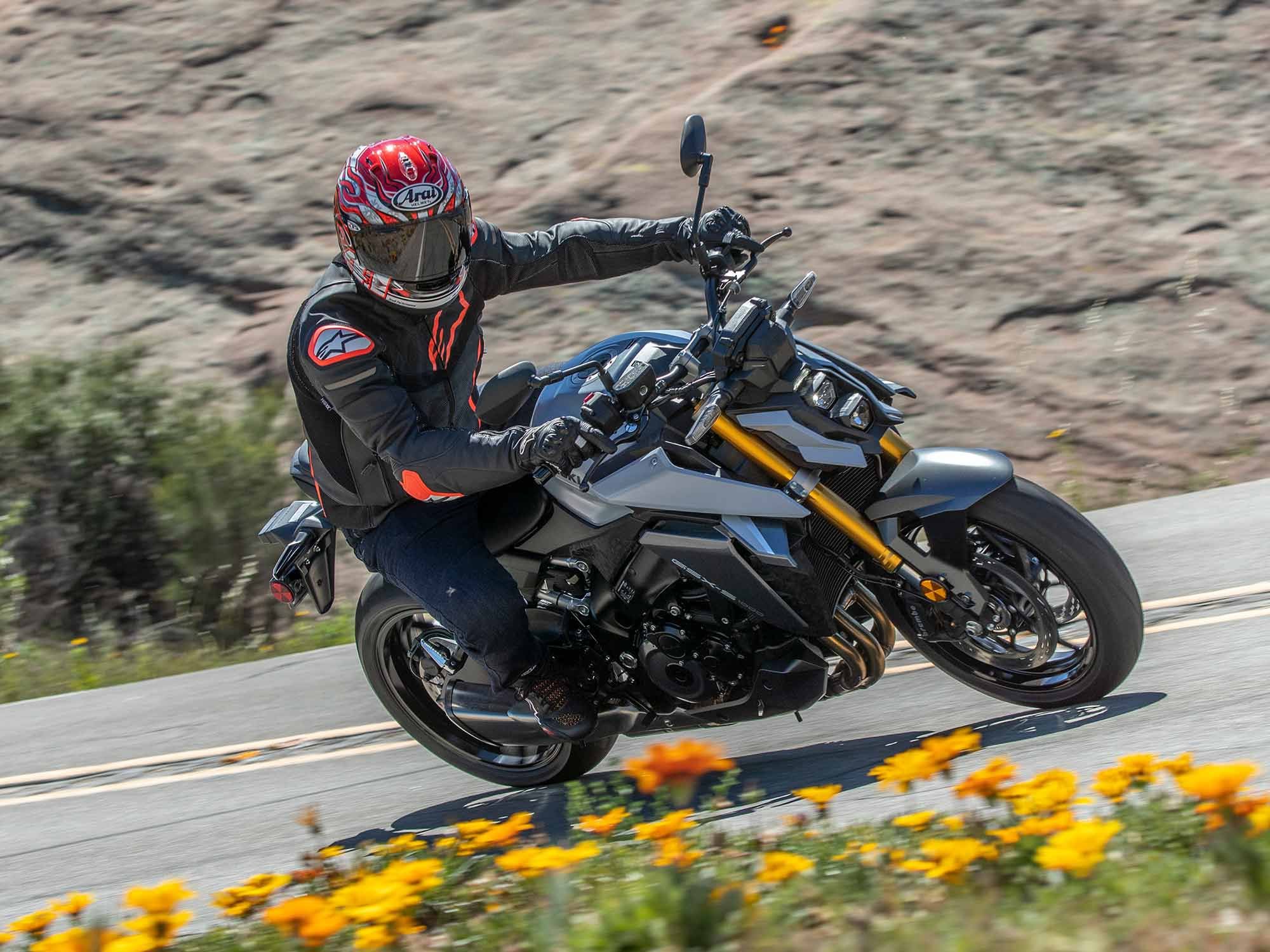

Front-end confidence is high on the GSX-S1000.
Front-end confidence is high on the GSX-S1000. (Kevin Wing/)

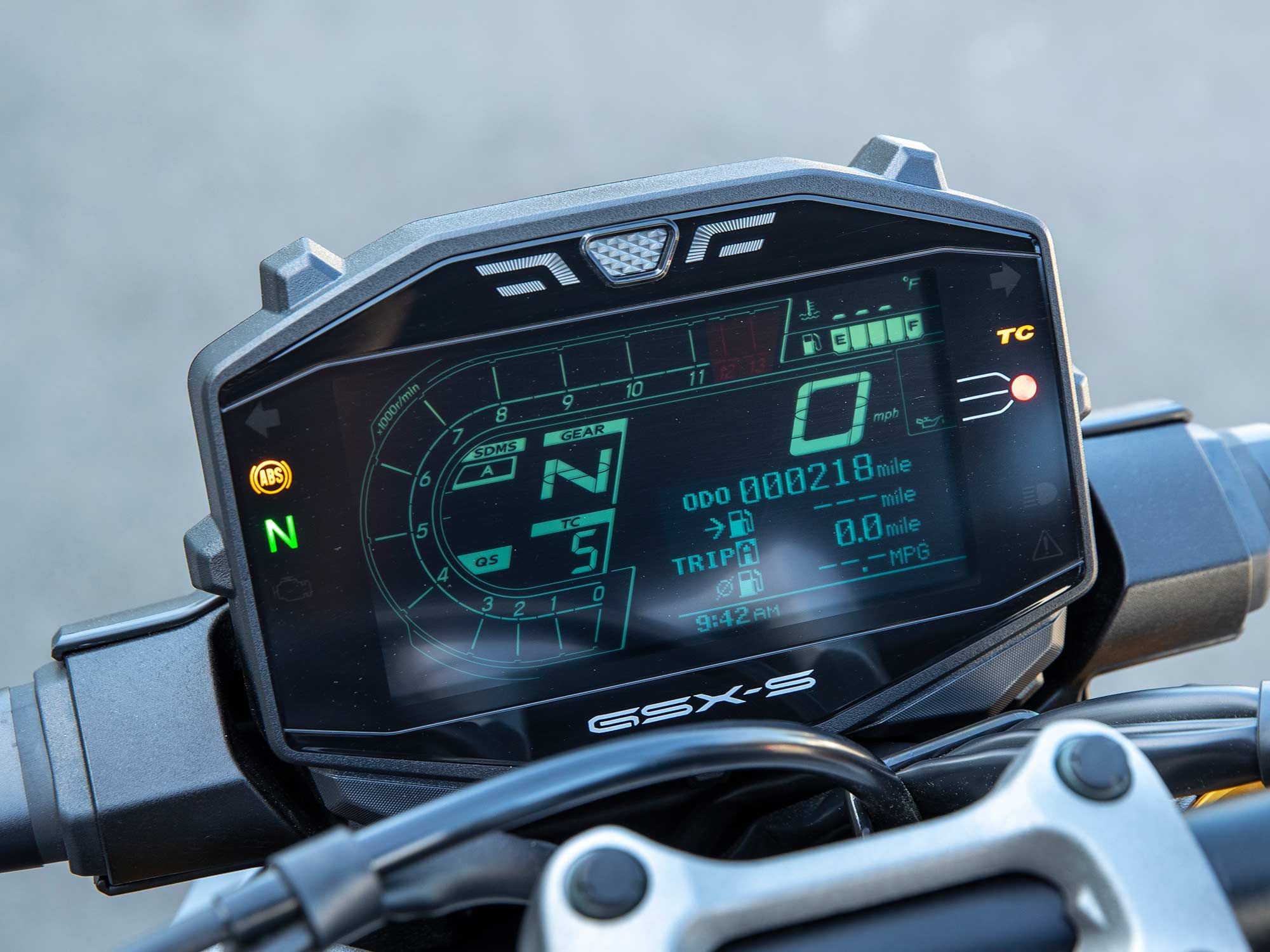

There really aren’t many complaints here, but it’s definitely hard to love the LCD dash. There are two problems here: First off, the screen doesn’t have anything around it to shade it from the sun, so it’s susceptible to glare. On a TFT-style screen with more contrast and the ability to crank up the brightness, this would be a nonissue. The other issue is that the screen sucks dust onto its surface about as effectively as the Death Star tractor-beamed the Millennium Falcon out of space. Constantly wiping the dash with a glove becomes a mandatory procedure; annoying, but not a deal breaker.
The LCD dash is starting to feel dated and functionally falls behind modern TFT displays. Glare and dust make reading it difficult at times.
The LCD dash is starting to feel dated and functionally falls behind modern TFT displays. Glare and dust make reading it difficult at times. (Kevin Wing/)
