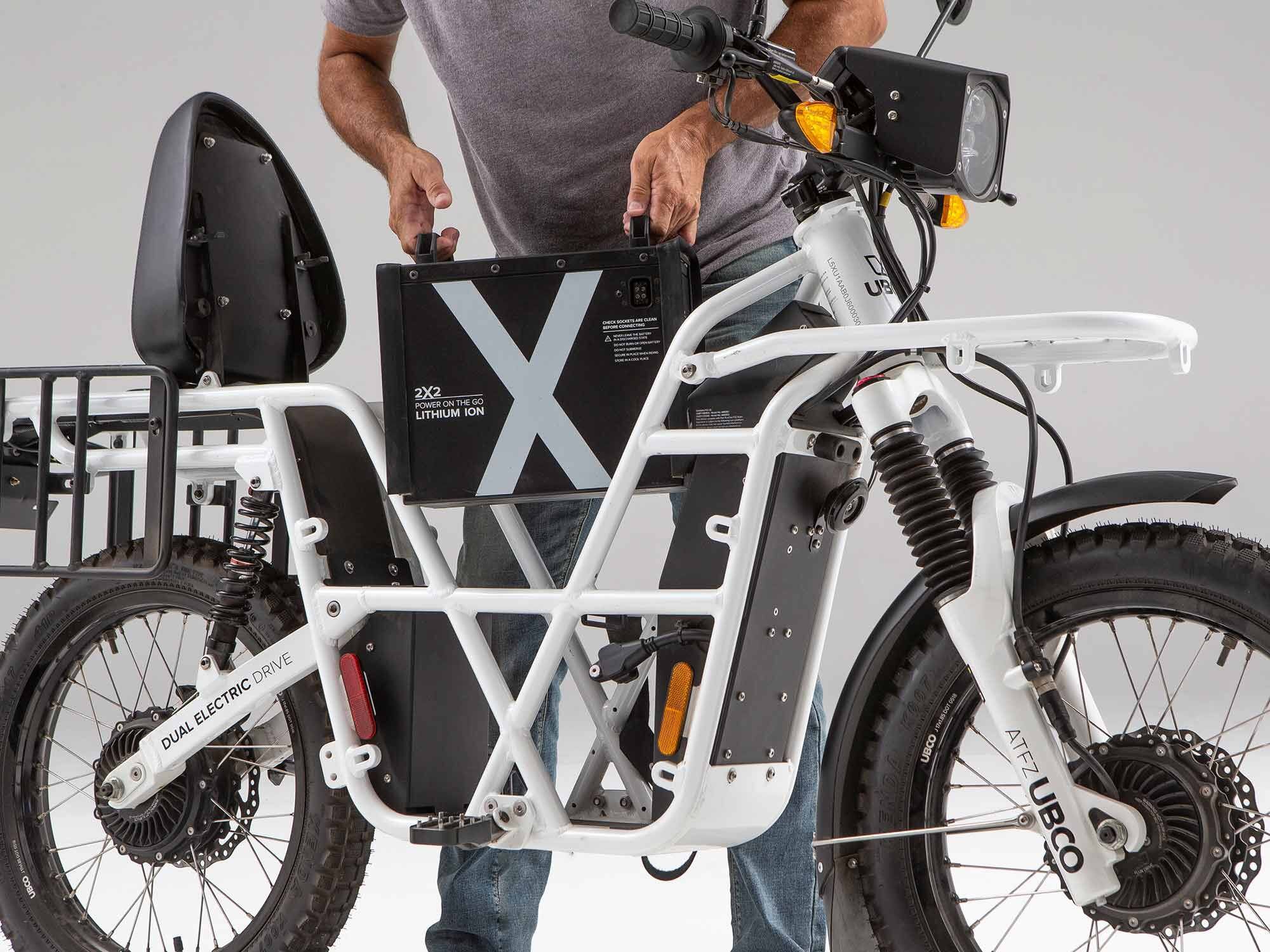

Moving away from fossil fuels isn’t so clear-cut.
Moving away from fossil fuels isn’t so clear-cut. (Ubco/)
