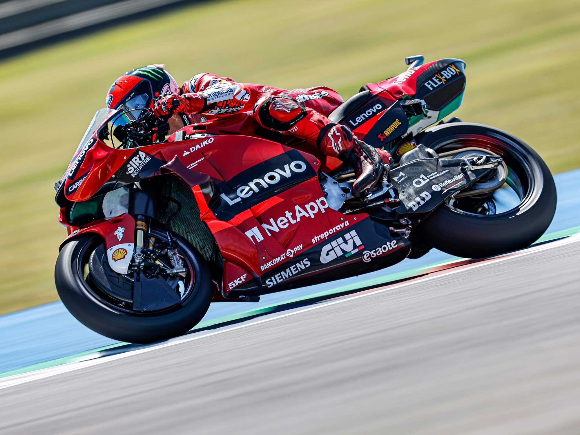

After much whining from manufacturers who are not Ducati, it seems MotoGP will ban front variable-ride-height devices for 2023. Such devices increase acceleration/braking ability by lowering center-of-mass height (this is why drag bikes are built as low as they are). The decision is a reaction to the predictable objections—it’s too expensive (which may mean “We can’t get our system working as well as the other teams have”) and it’s dangerous (rules require it to be rider-operated, but the riders already have other pressing matters to attend to).
Variable-ride-height devices lower the center of gravity for better acceleration and braking.
