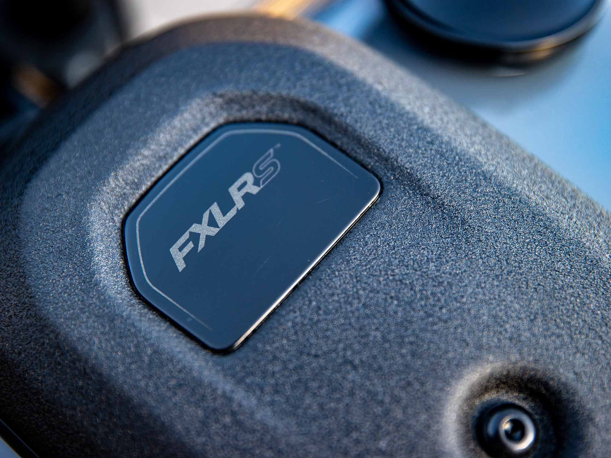

Earlier Low Rider models were defined by their 2-to-1 exhaust, tank-mounted gauges, and mag wheels. The 2020 Softail Low Rider S had some of these features, but these have been reduced with each new S model. After moving the previously tank-mounted gauge system to above the handlebar riser, the ‘22 Low Rider S’ only major visible tie to the earlier Low Rider (other than its entire silhouette) is the font on the gas tank and mag wheels. When asked about this departure, project lead Dais Nagao said to think of this as the Low Rider’s grandchild. It’s not the same bike, but they share the same inspiration and origins.

A Heavy Breather intake is tuned to work with the Milwaukee-Eight 117. (Jeff Allen/)This small decal replaces the previously tank-mounted gauges on the Low Rider S.
This small decal replaces the previously tank-mounted gauges on the Low Rider S. (Jeff Allen/)
