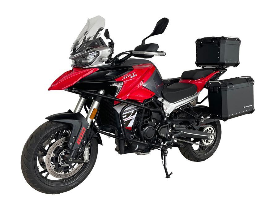

Type-approval documents show output claims of 95 hp from the engine, which may also appear in future Benelli models.
Type-approval documents show output claims of 95 hp from the engine, which may also appear in future Benelli models. (QJmotor/)
The new type-approval paperwork is slightly confusing. The two bikes photographed to illustrate the QJmotor SRT800 look very similar to the existing SRT750, which is built around the Benelli 754cc twin that’s effectively two cylinders from the old Tornado 1130 triple. They feature mildly updated styling, with a new tank and side panels, but the engine—despite being blacked out—looks like the Benelli-derived design. However, the text accompanying the application indicates the finished versions of the SRT800 will have the new engine that was seen in January’s patent.
