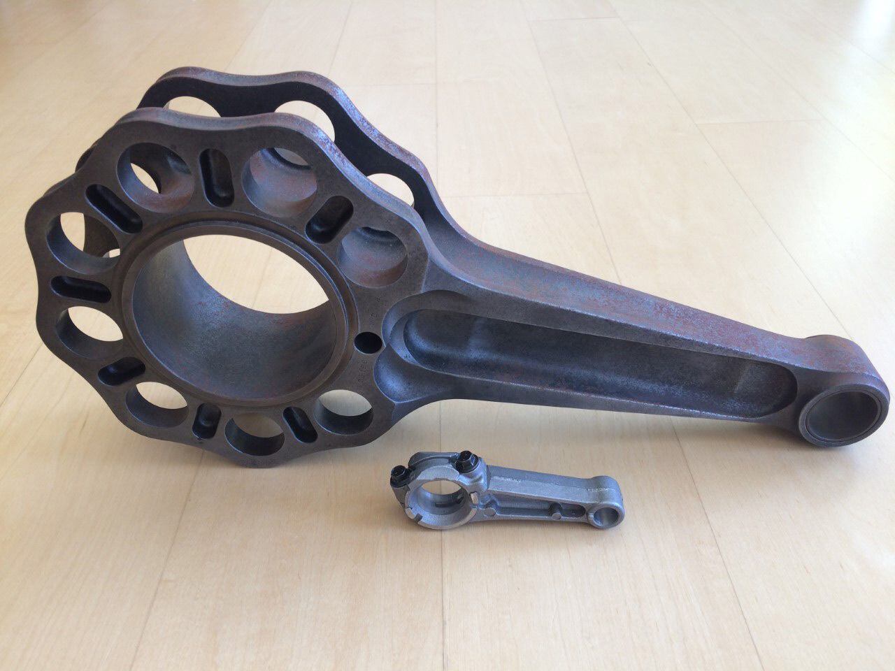

Which rod is longer? That big Pratt & Whitney R-2800 master rod tapes out at just under 18 inches and weighs over 18 pounds. Its rod ratio is 2.15, while the little forged-aluminum Briggs & Stratton part weighs just ounces, and returns a 1.94 rod ratio.
Which rod is longer? That big Pratt & Whitney R-2800 master rod tapes out at just under 18 inches and weighs over 18 pounds. Its rod ratio is 2.15, while the little forged-aluminum Briggs & Stratton part weighs just ounces, and returns a 1.94 rod ratio. (Mark Lindemann/)
But trying to reduce or eliminate side thrust by making the con-rod really long required a taller, heavier engine. Also, making the rod longer increased its weight, adding additional inertia load to the already hard-working crankpin bearing.
Result? Compromise—rod ratios between 2.0 and 2.2 proved short enough to avoid making engines ridiculously tall and rods too heavy for their bearings, yet were long enough to avoid the high side-thrust forces that scored cylinders.
