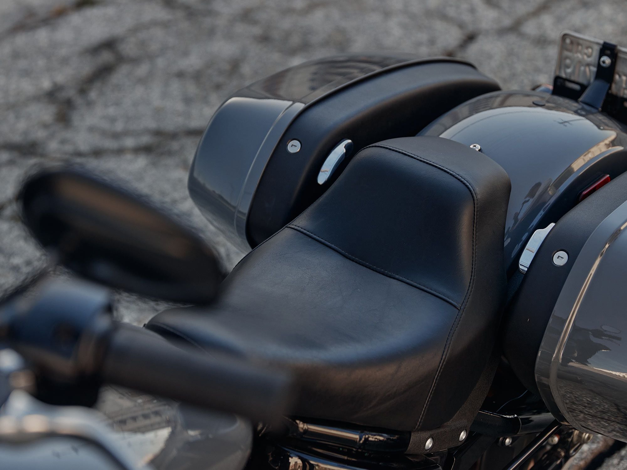

The steep-backed solo seat of the Low Rider ST is comfortable and fits the West Coast aesthetic H-D was after.
The steep-backed solo seat of the Low Rider ST is comfortable and fits the West Coast aesthetic H-D was after. (John Hebert/)The Low Rider S has turn signals mounted on the rear fender struts, but the ST has them on the LED taillight.
The Low Rider S has turn signals mounted on the rear fender struts, but the ST has them on the LED taillight. (John Hebert/)
The leather solo seat on the ST is steeply backed to lock the rider in during hard launches, and it works well. It’s a key element in the West Coast style that Harley-Davidson is after, but with plenty of padding and an efficient design, it’s nice and comfortable as well. A passenger seat and footpegs are available from the factory.

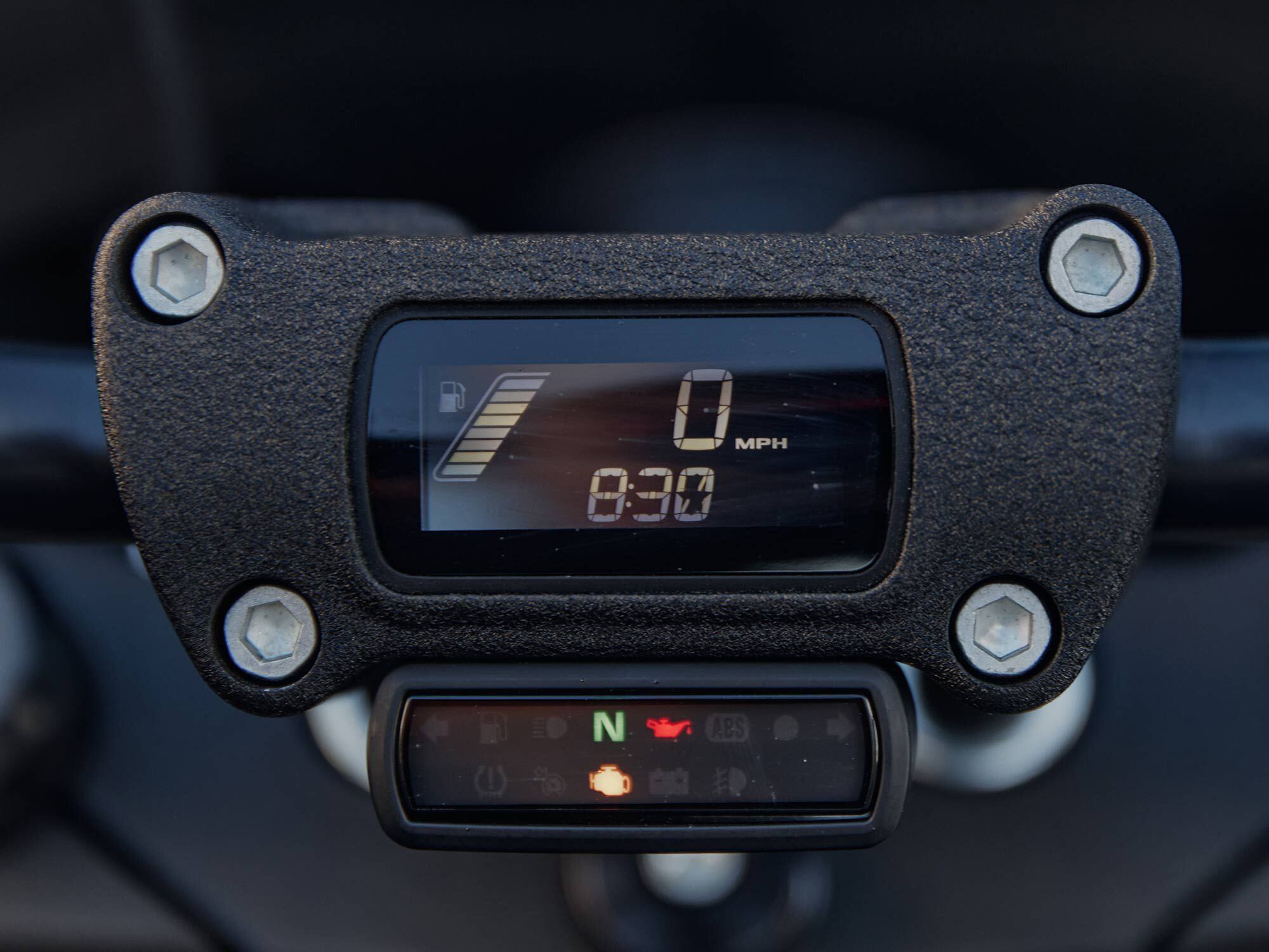

The ST’s instrumentation consists of a small digital “tech gauge” integrated into the handlebar riser’s top clamp, which keeps things clean and simple at the handlebars. The display is laid out clearly, but it’s not incredibly bright, and it can be hard to read in the sun or while wearing a tinted helmet visor.
The ST’s gauge system is minimal and laid out well, but can be hard to read in the bright sun.
The ST’s gauge system is minimal and laid out well, but can be hard to read in the bright sun. (John Hebert/)

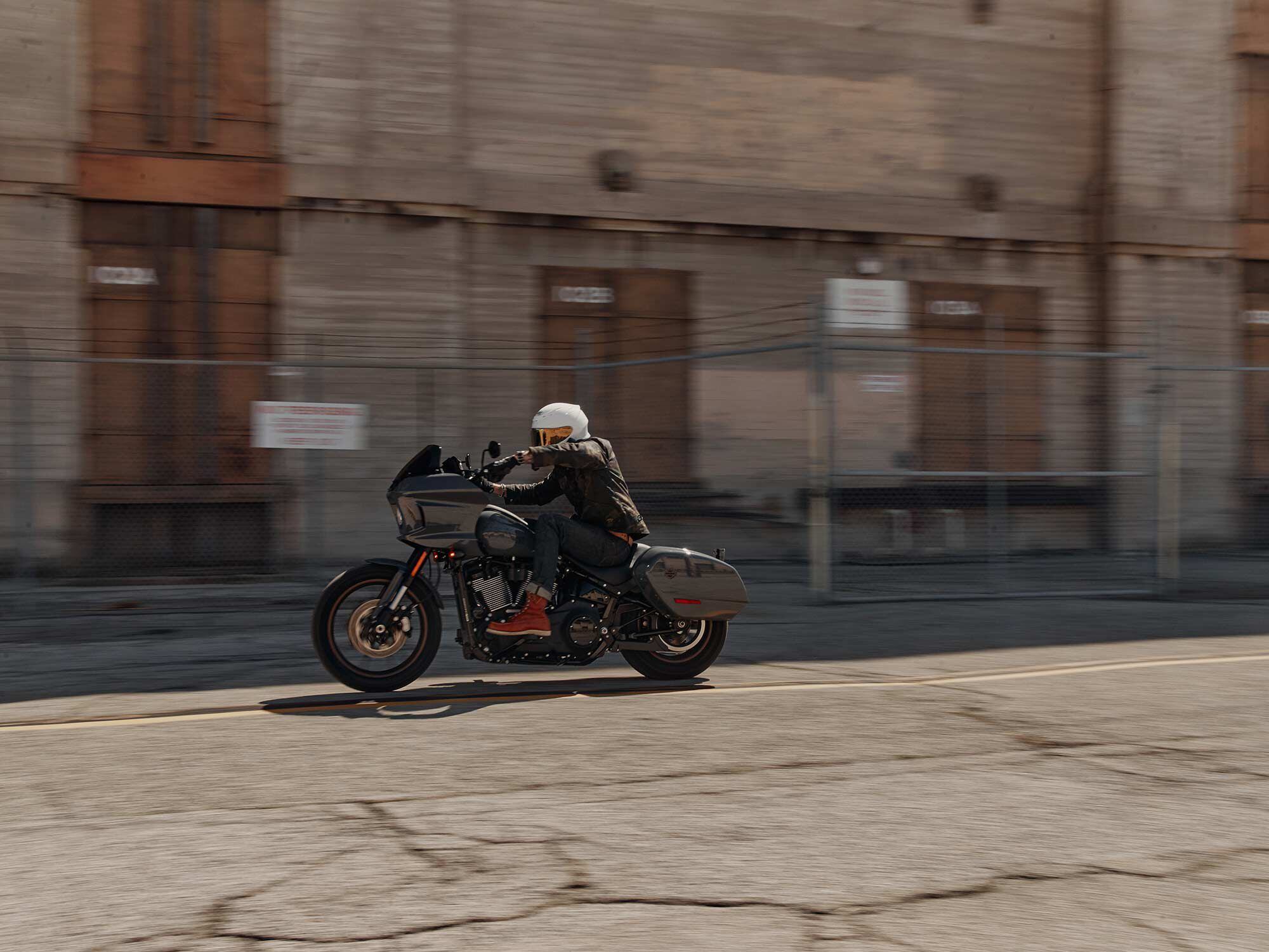

Immediately available torque makes hard launches fun—and loud.

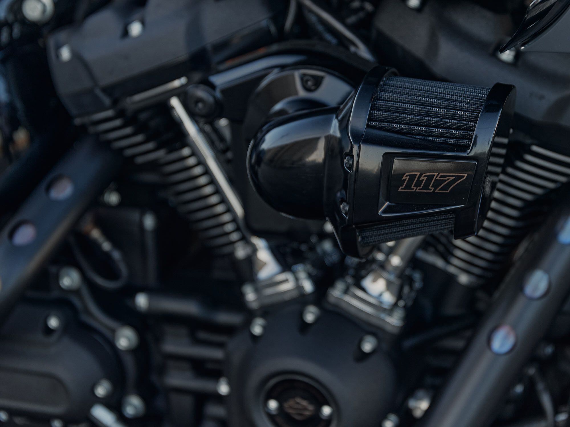

Immediately available torque makes hard launches fun—and loud. (John Hebert/)A forward-facing Heavy Breather air intake improves airflow compared to previous S models, but with mid-mounted foot controls, it would hit my knee.
A forward-facing Heavy Breather air intake improves airflow compared to previous S models, but with mid-mounted foot controls, it would hit my knee. (John Hebert/)

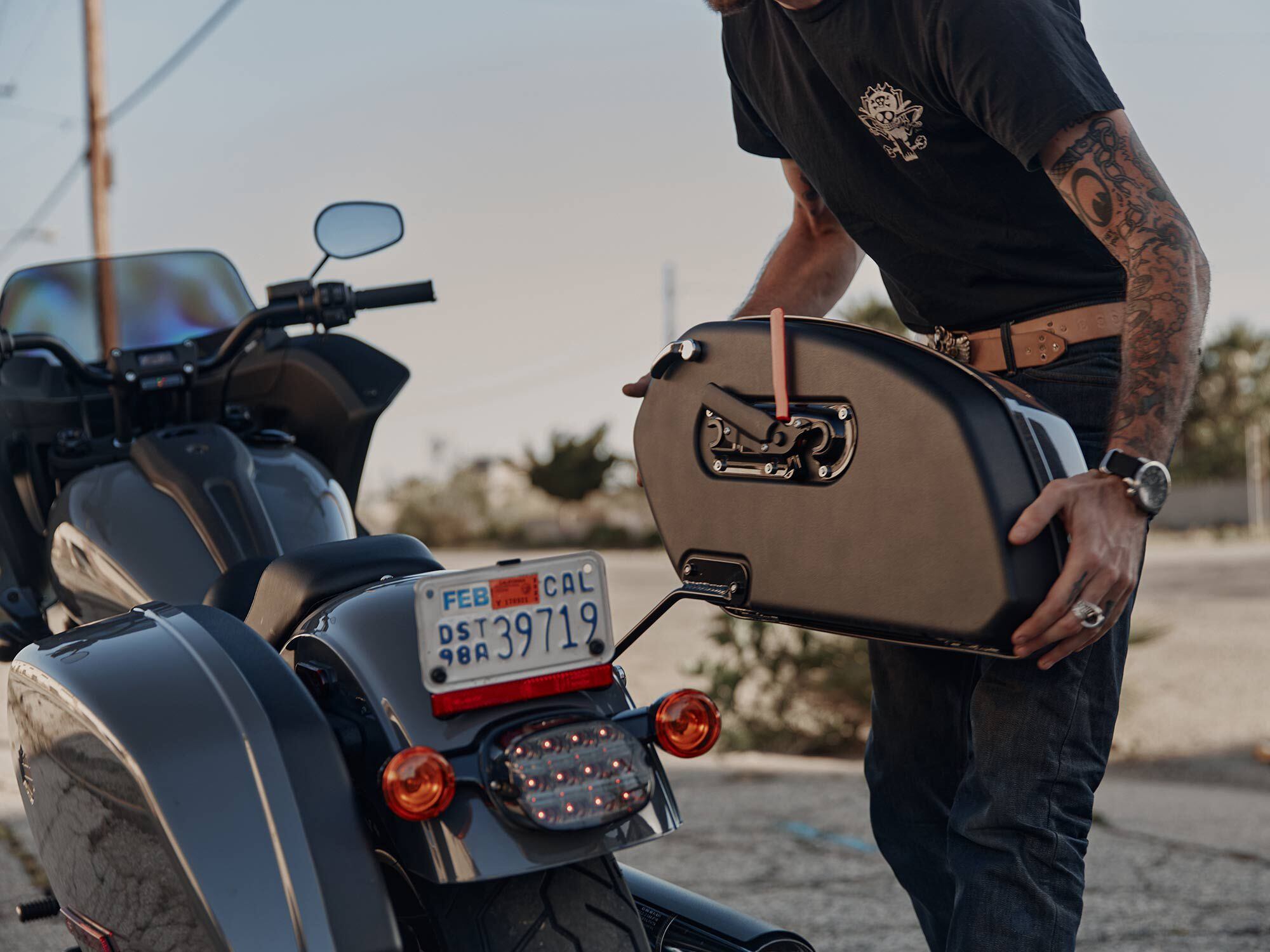

Modified versions of the Softail Sport Glide’s clamshell saddlebags are mounted high above the exhaust. This mounting placement both ensures that they won’t affect lean angle and helps to achieve a high-performing and aggressive look. They each lock with a key and together provide a total of 1.9 cubic feet of storage. The bags do need to be opened to be removed, but can be taken off very quickly. I was able to get both bags off of the bike in 20 seconds.
Both saddlebags can be removed quickly and easily with a small knob inside each bag.
Both saddlebags can be removed quickly and easily with a small knob inside each bag. (John Hebert/)

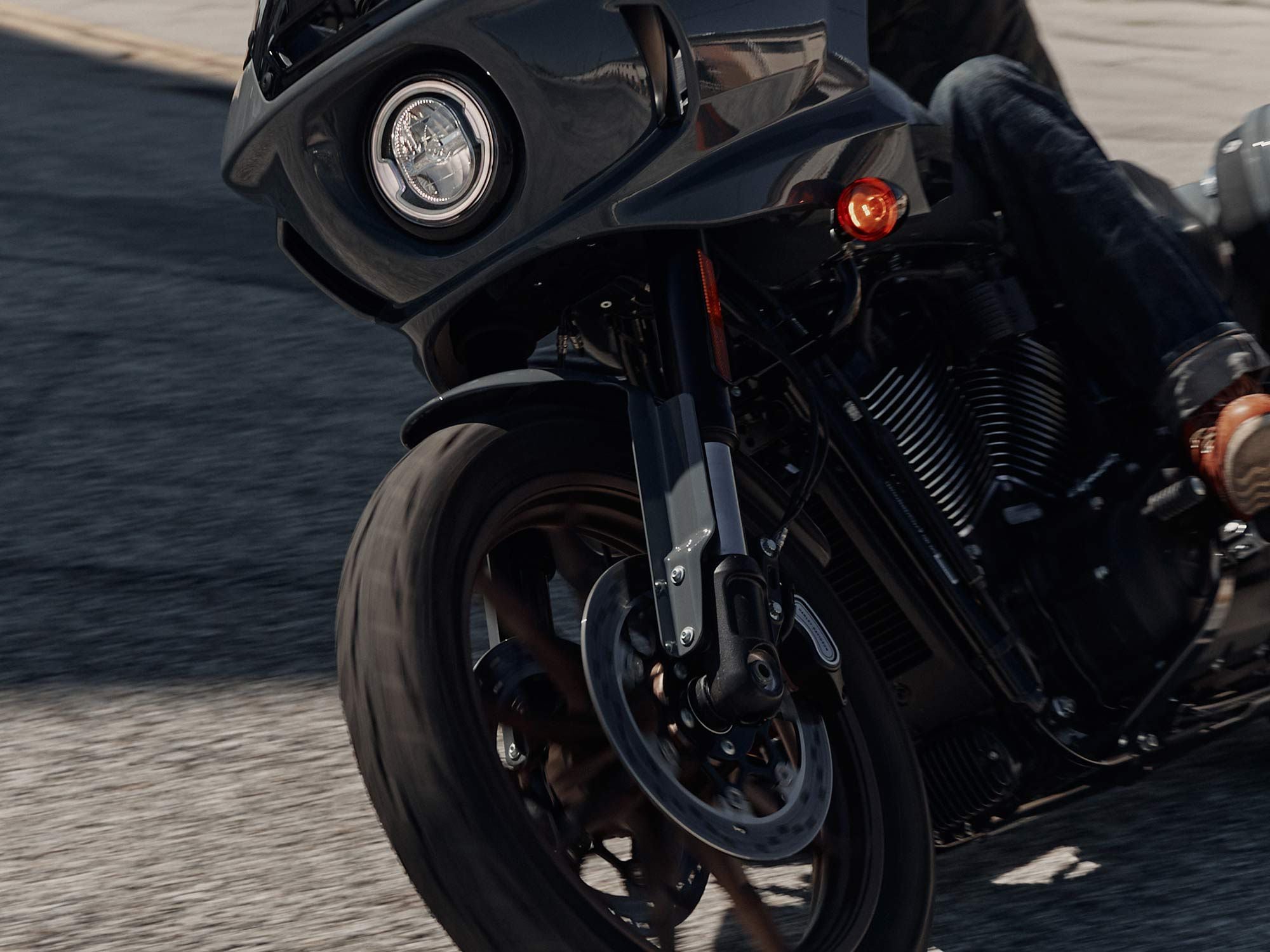

Paul Weiss, Harley-Davidson’s engineering manager, said that the goal was for the ST to ride just like the Low Rider S. I venture to say it rides even better. Aside from the saddlebags and fairing, the only change from this bike to that is a single-rate spring in the ST’s fork compared to the triple-rate spring on the S. We experienced excessive fork dive under hard braking on the S, but the stiffer spring rate of the ST’s fork fixed this problem with no hit to comfort.
Chassis geometry on the S and ST are identical, so the handling of these two bikes is very similar. The ST’s added 50 pounds can be felt while muscling the bike into a turn, but it’s not drastic. The fork’s stiffer spring rate balances the chassis better fore and aft while entering and exiting turns, creating a more planted road feel.
The Low Rider ST has a 43mm inverted fork with cartridge internals and a single-rate spring.
The Low Rider ST has a 43mm inverted fork with cartridge internals and a single-rate spring. (John Hebert/)While most of the ST is well finished, the ring around the headlight unexpectedly fell off several times during our testing.
While most of the ST is well finished, the ring around the headlight unexpectedly fell off several times during our testing. (John Hebert/)
