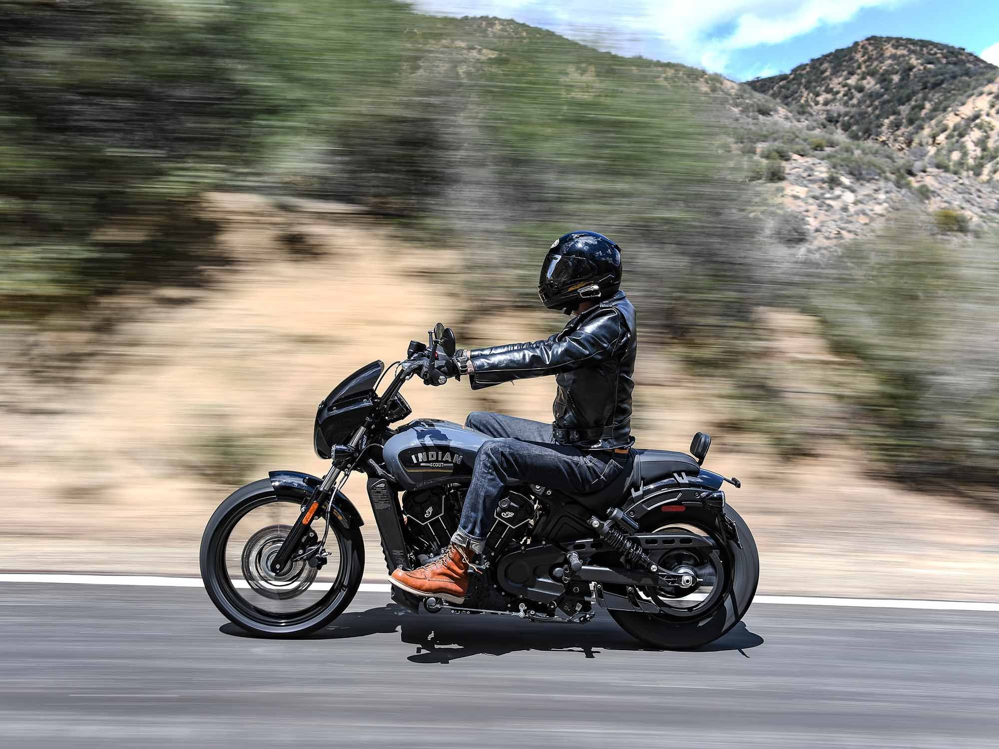

The 29 degrees of cornering clearance and 2 inches of rear suspension travel limit the Scout Rogue’s speed through turns.
The 29 degrees of cornering clearance and 2 inches of rear suspension travel limit the Scout Rogue’s speed through turns. (Barry Hathaway/)

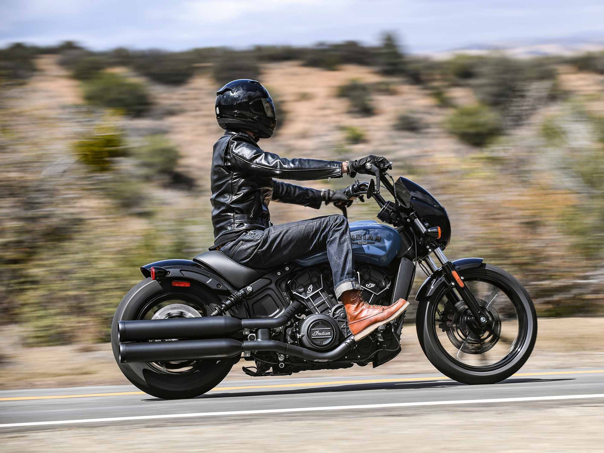

I chose a Scout Rogue in Storm Blue, and the first thing I noticed, after a year or so without riding a Scout model, is its low seat height. At 25.6 inches, the Rogue’s seat is over an inch lower than Honda’s Rebel 300, but the very thing that makes this model so approachable for many new or shorter riders has me, at 6-foot-4, cramped up with my knees well above the gas tank even with forward controls. I had to invert the bar-end mirrors to avoid hitting my knees every time I turned the handlebars. (Indian’s fleet manager, Billy, is a sweethearted gentleman and swapped them for me in a minute flat.) Unlike typical Scout models, however, the Rogue has mini-apehangers that put me in a surprisingly comfortable position for our day’s ride. If I hadn’t caught my goofy reflection in a window as I passed I would have been more than content. Ego be damned.

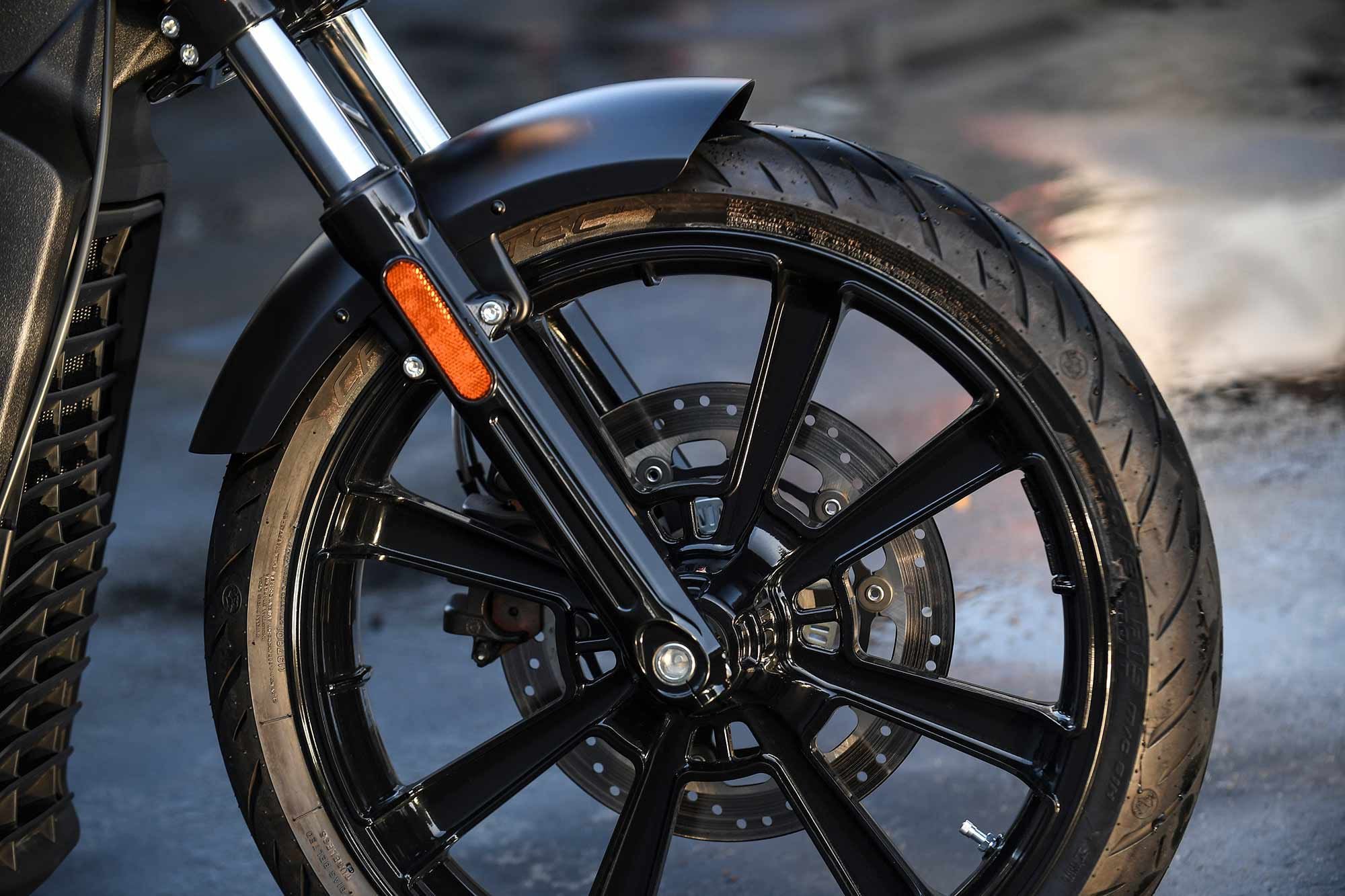

A 19-inch front wheel on the Scout Rogue makes the bike tip into turns with less effort than models with 16-inch fronts.
A 19-inch front wheel on the Scout Rogue makes the bike tip into turns with less effort than models with 16-inch fronts. (Barry Hathaway/)Ergonomics on the Scout Rogue were tight, but not terribly uncomfortable for Gales at 6-foot-4.
Ergonomics on the Scout Rogue were tight, but not terribly uncomfortable for Gales at 6-foot-4. (Barry Hathaway/)

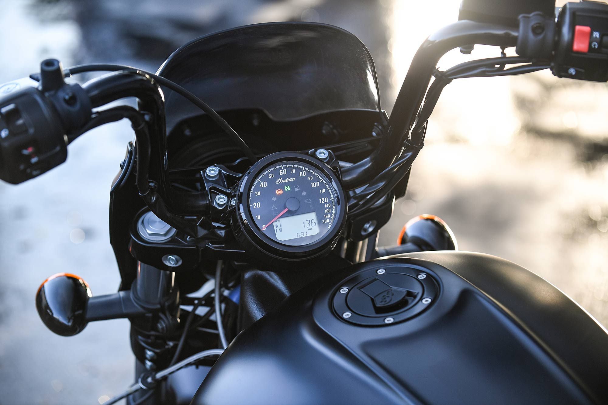

The Scout Rogue’s analog gauge has a small digital screen to display time, current gear, trip mileage, and more.
The Scout Rogue’s analog gauge has a small digital screen to display time, current gear, trip mileage, and more. (Barry Hathaway/)

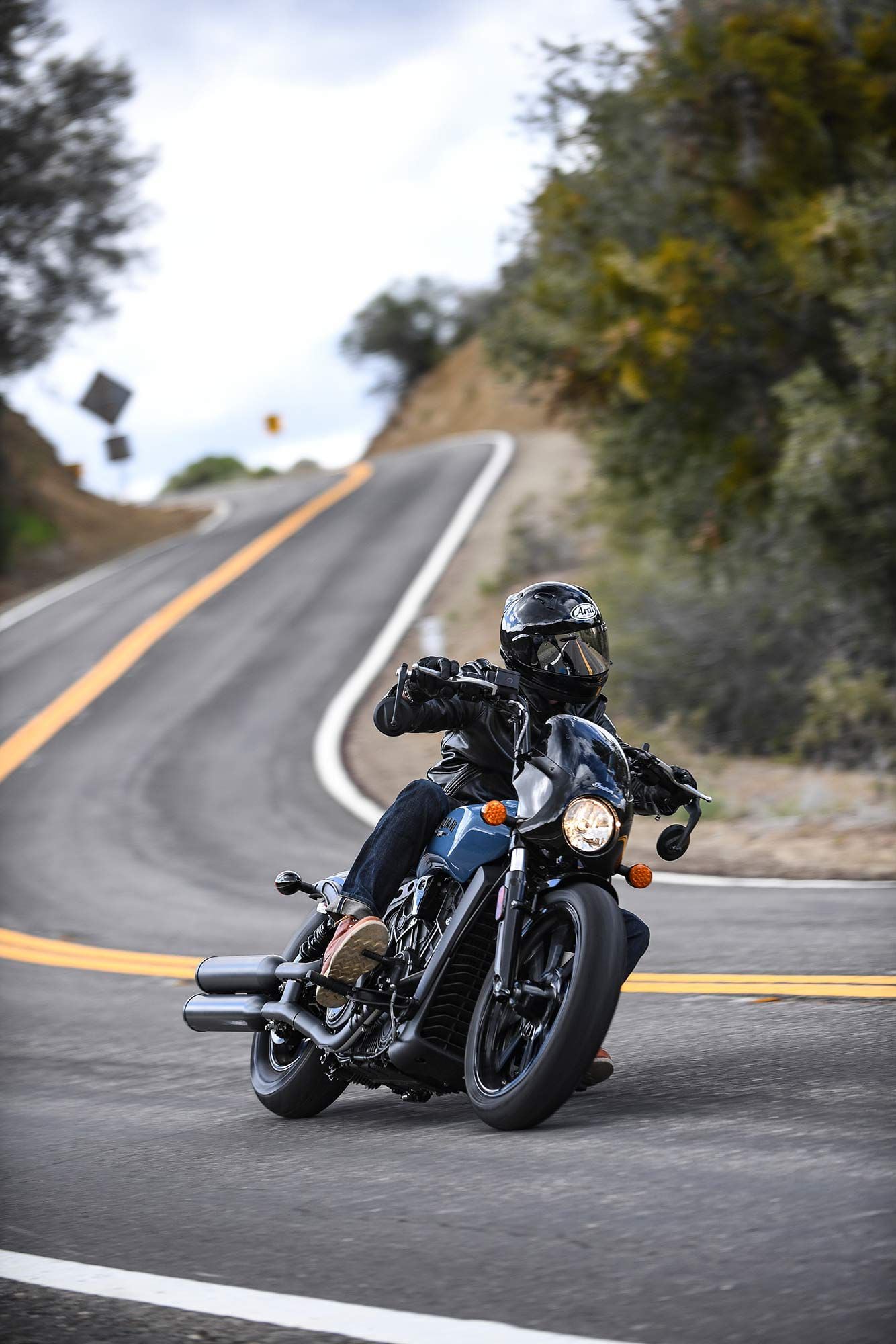

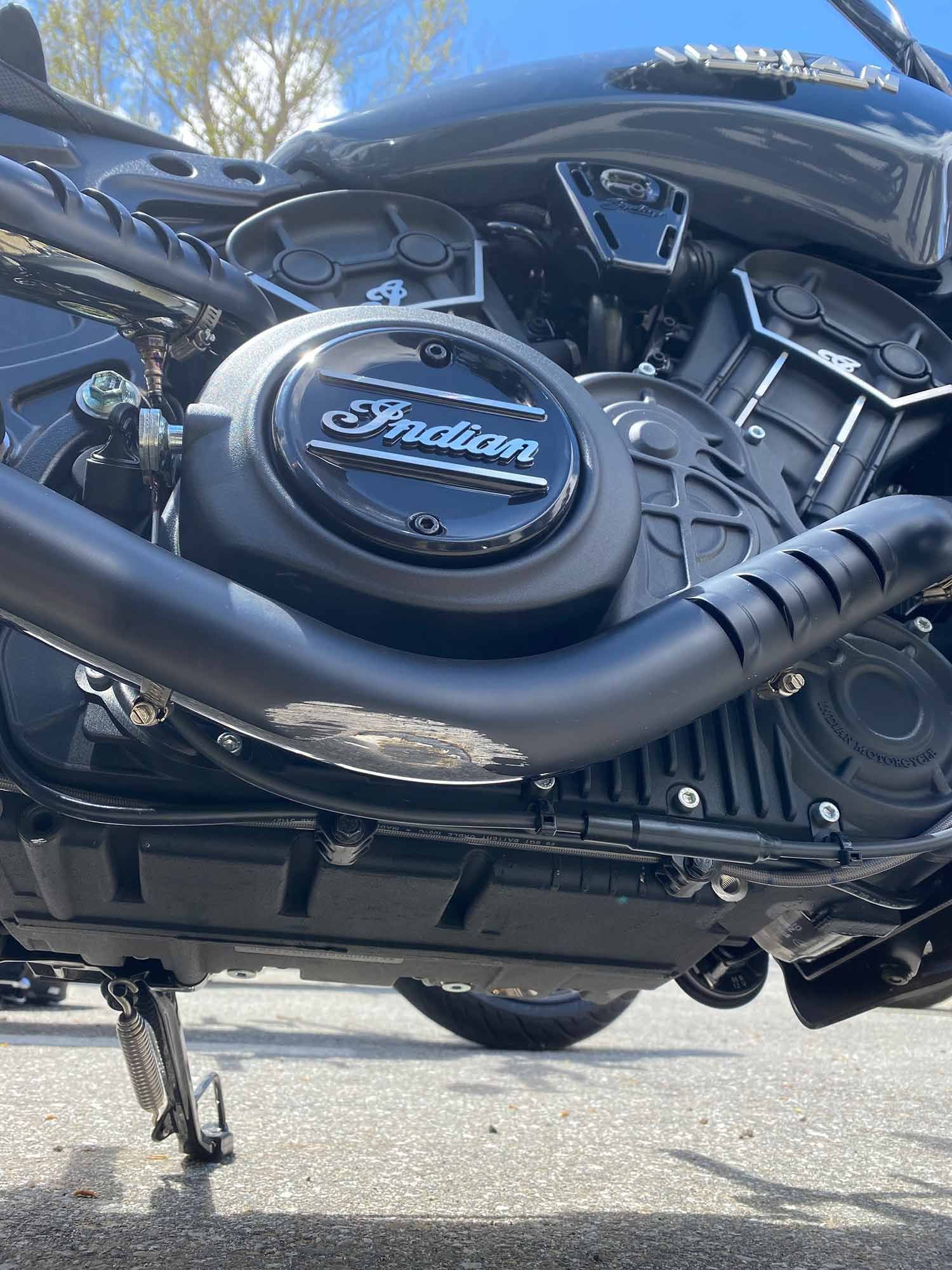

Later, when nearing Ojai on Highway 33, the Scout’s most limiting factor reared its head and would not subside until we reached the superslab once again: that 29-degree lean angle. Carving along the hillside blacktop, the Rogue’s footpegs scraped easily and often. Riders can adapt to this on left turns by picking up their foot or just riding out the footpeg’s bend. But on the right side, the exhaust pipe is so low that Indian actually cut out part of the heat shield to avoid further impeding lean angle. Hitting any sharp bump in a right-hand turn meant a hard hit on that header pipe. By lunchtime it had taken a significant beating. Another couple of days on this bike and the exhaust note would likely be much less muffled.
After only about 50 miles, hard cornering has begun to wear past the Rogue’s heat shield and into the exhaust pipe underneath.
After only about 50 miles, hard cornering has begun to wear past the Rogue’s heat shield and into the exhaust pipe underneath. (Barry Hathaway/)

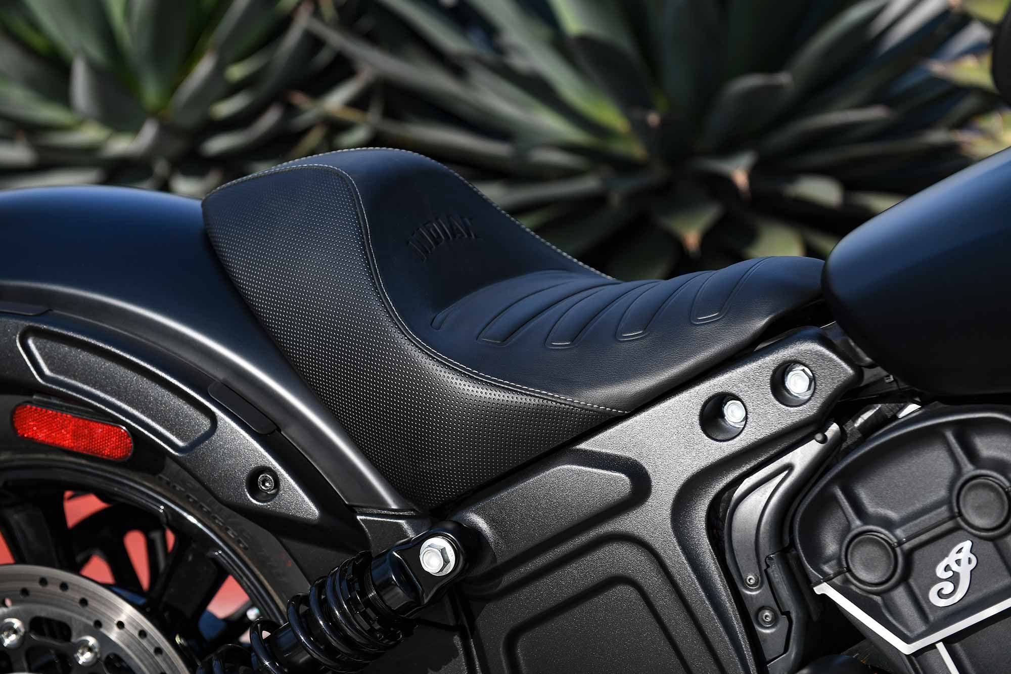

The new seat on the Scout Rogue is well padded and comfortable, but the forward-curved contour may be uncomfortable for riders with a wide seat.
The new seat on the Scout Rogue is well padded and comfortable, but the forward-curved contour may be uncomfortable for riders with a wide seat. (Barry Hathaway/)
