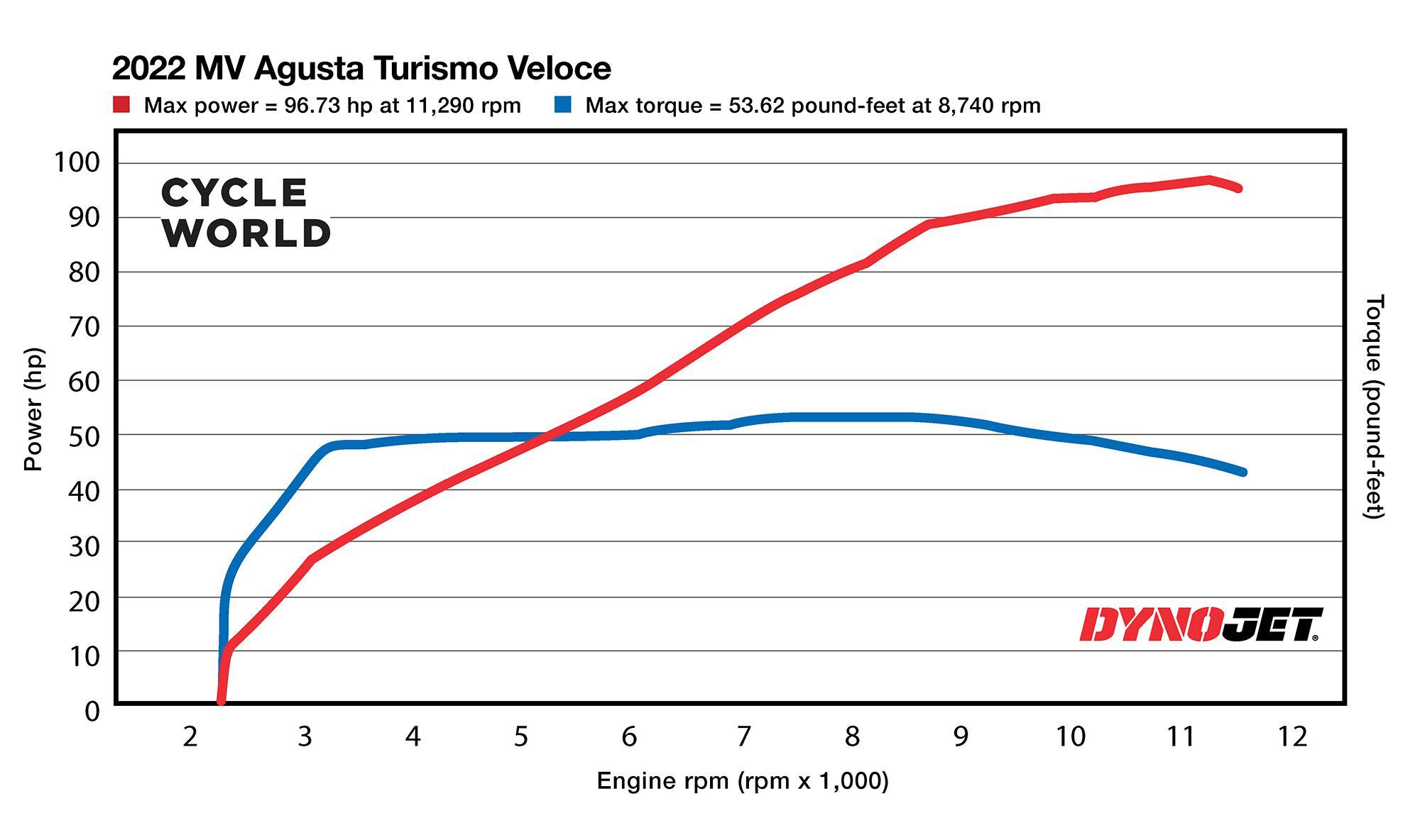

Horsepower and torque figures on the 2022 MV Agusta Turismo Veloce Lusso gathered on the <i>Cycle World</i> dyno.
Horsepower and torque figures on the 2022 MV Agusta Turismo Veloce Lusso gathered on the <i>Cycle World</i> dyno. (Robert Martin Jr./)
We placed the Turismo Veloce Lusso on Cycle World’s in-house Dynojet 250i dynamometer, recording horsepower and torque measurements ahead of an upcoming review of the MV Agusta. The inline-triple belted out 96.73 peak horsepower at 11,290 rpm and 53.62 pound-feet of torque at 8,740 rpm. Most remarkable is the Turismo’s tabletop-like flat torque curve, which grazes the threshold of 50 pound-feet from roughly 4,000 rpm without dipping below the same mark until 10,000 rpm. Pair that with a linear power delivery and what you have is a flexible powerplant for nearly every riding scenario.
In comparison to the Yamaha Tracer 9 GT that we last tested on the CW dyno, which is arguably one of the MV Agusta’s most similar-spec and strongest competitors, the Turismo produces similar but lower peak performance than the Yamaha’s 104.2 peak horsepower and 62.2 pound-feet of torque. This is in spite of a displacement disadvantage to the Yamaha’s 890cc inline-triple, but proves itself as an exotic contender in the segment.
