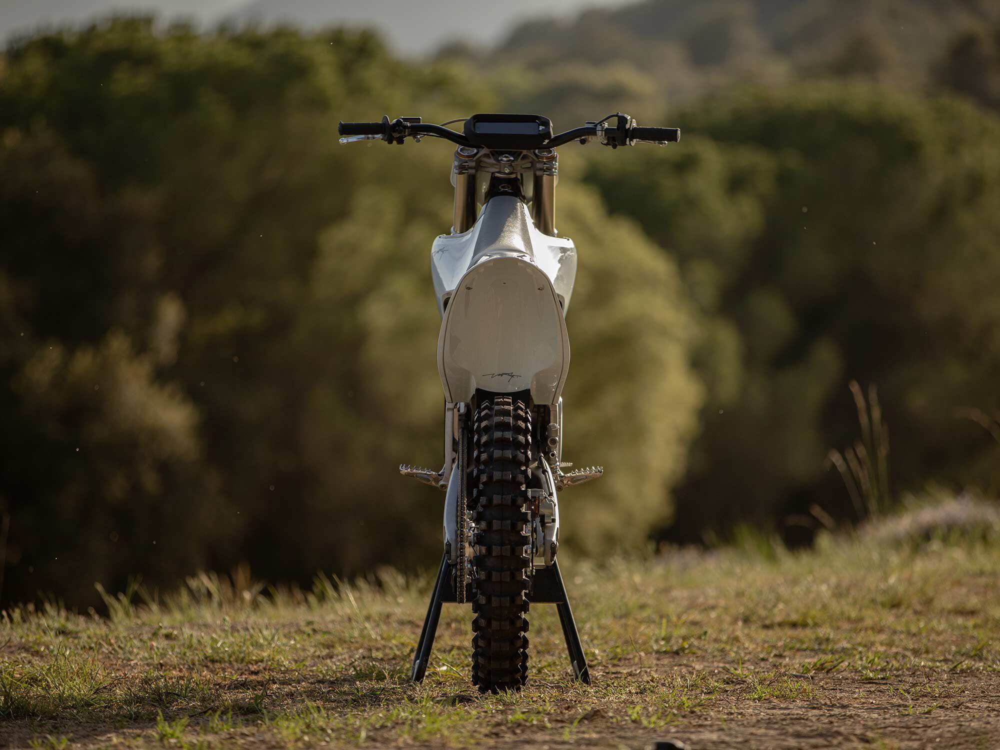

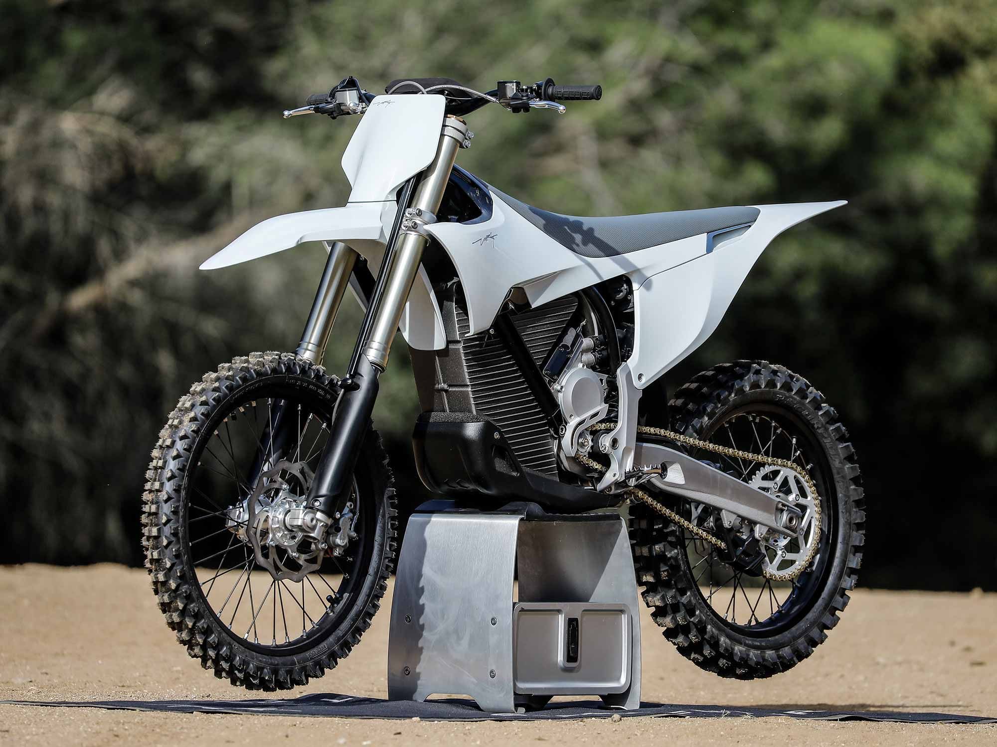

Stark claims the Varg weighs in at 242 pounds. Check out the stand with built-in charger.
Stark claims the Varg weighs in at 242 pounds. Check out the stand with built-in charger. (Stark Future/)
As far as feel is concerned, the small differences are interesting but generally beneficial. The bike has a noticeably slim build, so much so that some riders might actually have trouble holding on, though this would be easily remedied with grip tape and graphics. Not having a clutch is a strange sensation, though it’s nice to have some of the strain taken off the forearms and simply focusing on grip.

One of the coolest things about the bike from a pit perspective was the fully functional charging stand that adds watt-hours as the rider rests up. As it sits on the stand with a partially depleted battery (think practice laps), the Varg can get back to 100 percent in an hour or two, depending on whether it’s on a 120V or 240V outlet (we’ll have to assume your motocross track has outlets or you brought your generator of Ford F-150 Lightning). Basically, unless you’re a young top-level athlete at the peak of your physiology, the stand will help the Varg outlast you and it may even recover more quickly. And as a bonus, it’s super cool to look at, much like everything else Stark’s put out.

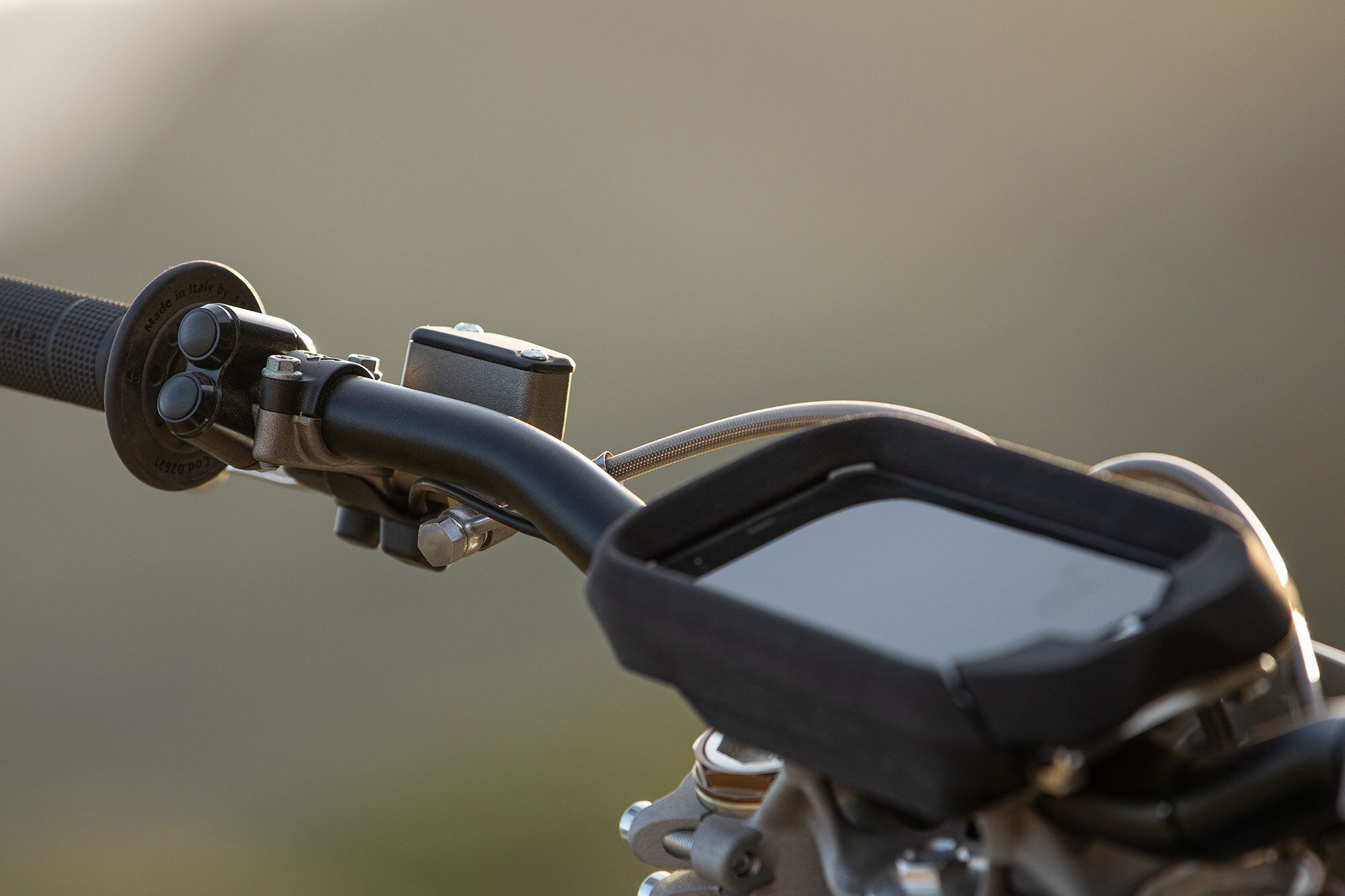

Stark Future says you can use the smartphone-based display to tune the Varg to your liking, and when you’re not riding you could use it as your actual phone.
Stark Future says you can use the smartphone-based display to tune the Varg to your liking, and when you’re not riding you could use it as your actual phone. (Stark Future/)
There’s a smartphone-based display on your crossbar pad, which could be a game changer; it’s literally like having a smartphone and tuner at your disposal while working on the bike and a full-color display while riding. How far will it evolve? Personally, I’d like to see meditation apps and Mad Skills Motocross shredding available in the future for riders waiting in staging mentally preparing for a gate drop. Will lap times, gap between riders, and other pertinent information be made available at some point? Sky’s the limit.

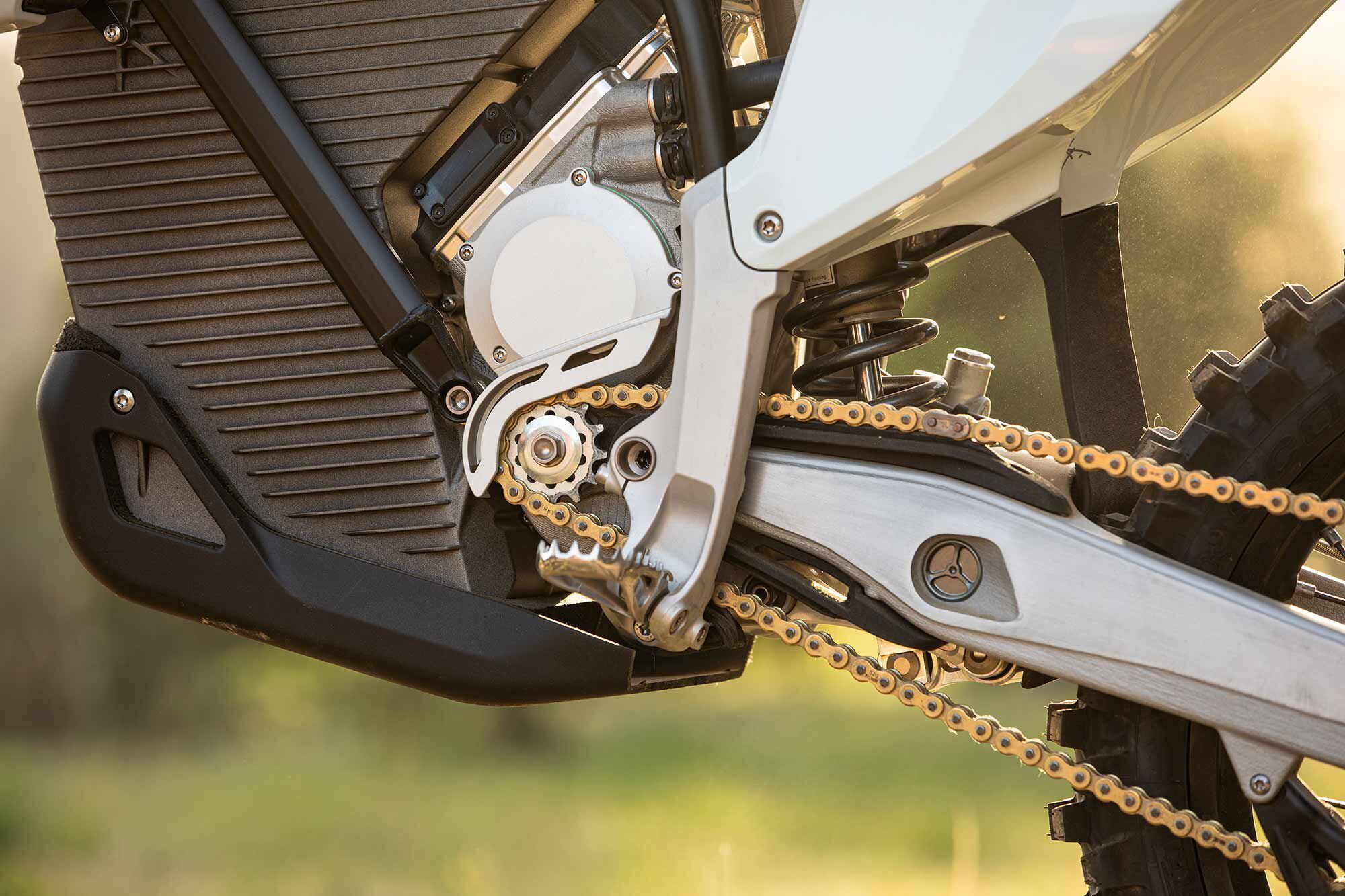

The beginning of any successful machine starts with chassis and suspension. Stark Future did everything it could to get a leg up on the competition in this department. The beauty of being new to the market is being able to take what the current players are doing and improve upon it; that’s one of the biggest advantages of starting from the ground up. That principle is most evident in Stark’s swingarm and linkage combo, which allows the componentry to sit a bit higher, which in turn lets the bike glide freely over jagged terrain or surfaces that might halt your forward drive. This is more useful for off-road and enduro but still good for motocross when you come up short on a jump landing. Stark opted for a chromoly steel frame joined to a honeycomb-structure battery case instead of an aluminum unit for strength with flex where it’s needed. Stark claims the frame is 50 percent lighter than those of the competition.
The Varg’s linkage is tucked up high and tight, minimizing the chances of it catching terrain or obstacles.
The Varg’s linkage is tucked up high and tight, minimizing the chances of it catching terrain or obstacles. (Stark Future/)
This is a smart move, as battery-powered bikes need more compliance to damp their sometimes unforgiving and overly rigid feel under large applications of throttle. This is relatively new territory for dirt bikes, seeing as there’s never been one with the ability to create so much power so quickly, but Stark’s chassis does well when driving forward under heavy acceleration.
The Varg is battle-ready with KYB suspension components and feels absolutely competitive. A 48mm fork and piggyback shock offer 310mm/12.2 inches of travel at each end. Both are fully adjustable, with the shock offering high- and low-speed compression-adjustment circuits. Stark worked with the European division of Technical Touch (KYB’s official suspension service for MXGP teams) to tune the Varg’s suspension settings.

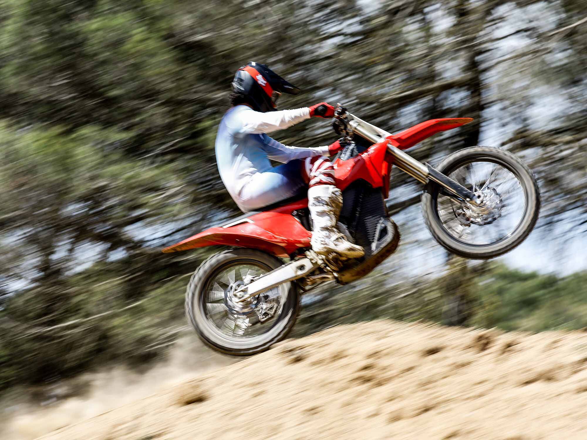

The track was a bit drier than ideal, but there were no issues putting the bike where it should be. The rear tire can break loose at almost any time if there’s overzealous throttle application, but it’s nice to have that power available when pivoting and driving out of corners Tokyo Drift style. Some riders will want to take a bit of weight off the front of the bike and put some more on the rear, which will help to reduce the chance of losing traction midcorner or while exiting a turn.

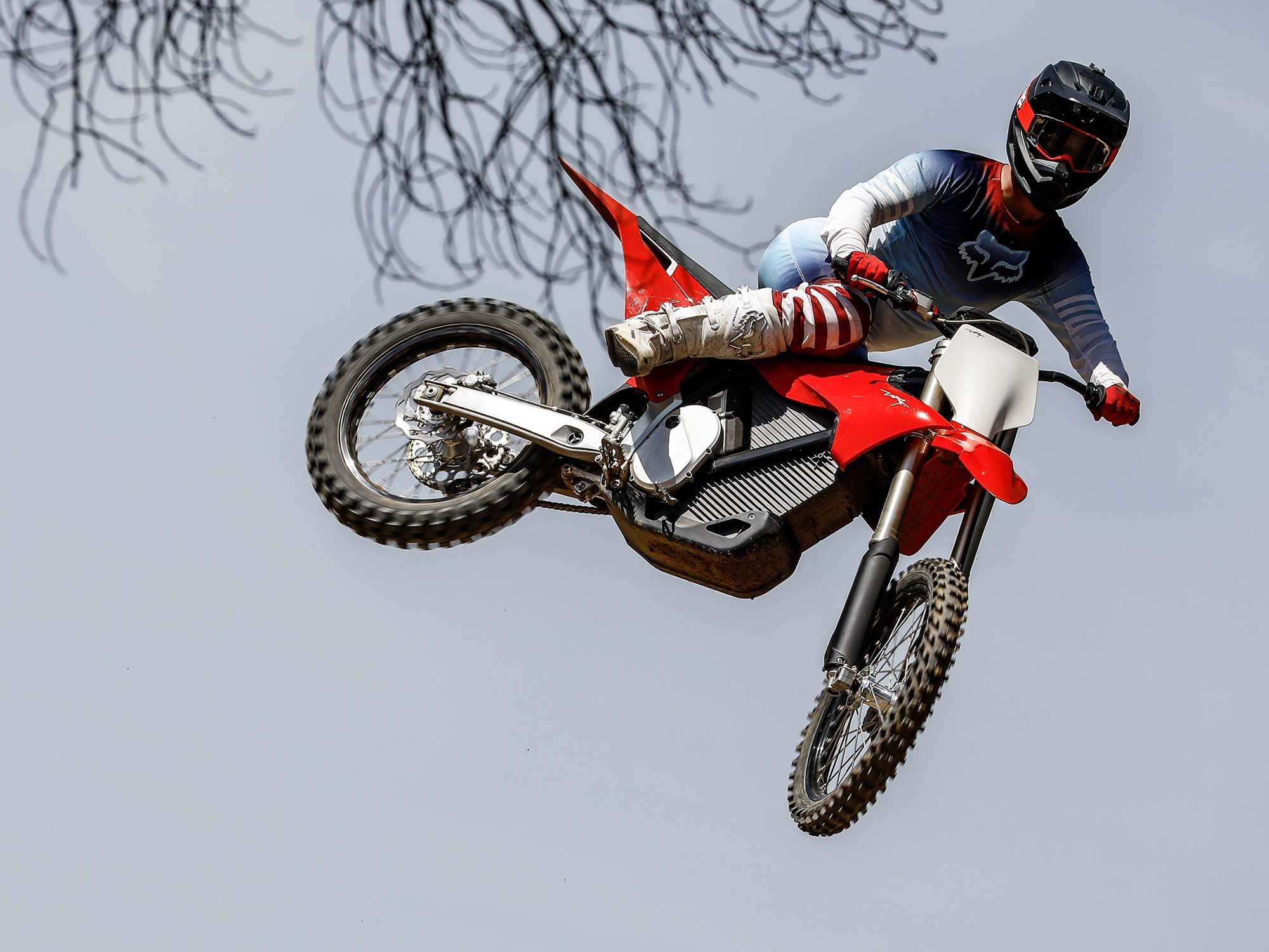

That omnipresent power delivery also comes into play when the Varg gets up in the air. Most riders have experienced that feeling in the pit of the stomach when coming off the face of a jump wrong and feeling the front start to drop. The Varg is a big help here; simply twisting the throttle significantly increases the leverage of the rear tire, thanks to instant throttle response and torque production, and raises the front end easier than a gas-powered bike. This bike changes the entire dynamic of jumping.
Steady throttle input with momentum is the best approach to jumping the Varg.
Steady throttle input with momentum is the best approach to jumping the Varg. (Stark Future/)
In fact, it can be surprising how fast things can change on takeoff, say the last 3–5 feet before a jump. A mere centimeter more throttle twist can result in many more feet covered, and in fact it was easy to overjump in the early laps. Jumping this electric motocrosser is all about momentum carried up to and off the takeoff and less of increasing power off the lip. It took a bit of getting used to the Varg’s surprising nimbleness and how easy it is to throw around. Still, by day’s end, it became second nature.
