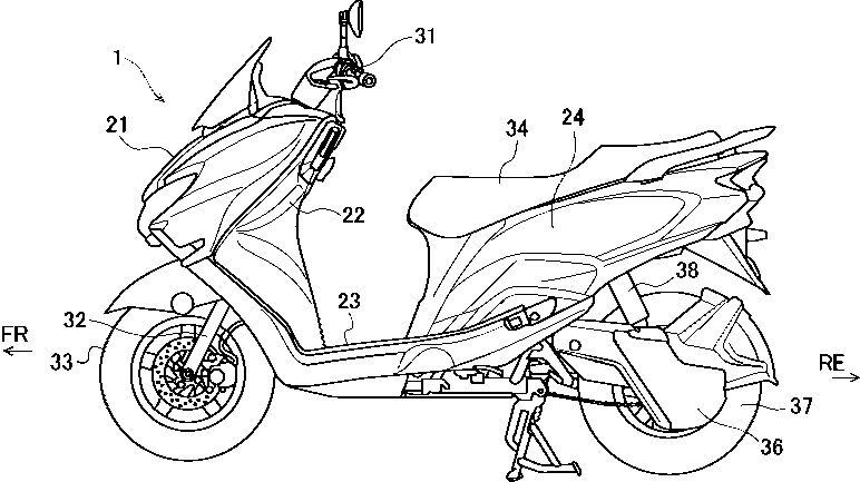

Patent drawings show that Suzuki has an electric Burgman-based scooter in the works.
Patent drawings show that Suzuki has an electric Burgman-based scooter in the works. (Suzuki/)
Suzuki hasn’t been shy about showing electric concept bikes over the years, but there has been little to show of them in terms of actual production models. That looks about to change very soon as a battery-powered scooter has been spied testing several times, and the company has filed a barrage of patent applications relating to the design in Japan.

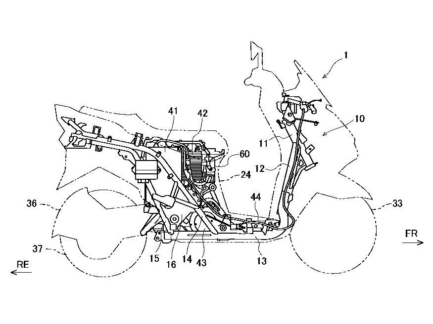

The patents, published in Japan, show that under the skin the bike has a conventional steel frame, similar to that of the Burgman 125 it shares its bodywork with. However, where the gas-powered model has the usual arrangement of an engine and transmission built into the swingarm, leaving the central section of the bike clear for luggage space and the fuel tank, the electric version uses a much more motorcycle-style layout with a chain-driven rear wheel and the motor mounted in the chassis.
The AC motor (43) takes power off of a DC-to-AC inverter, while a DC-to-DC converter (42) steps down power to the required level.
The AC motor (43) takes power off of a DC-to-AC inverter, while a DC-to-DC converter (42) steps down power to the required level. (Suzuki/)
It’s an AC motor, fitted relatively far forward in the frame, just at the base of the seat section of the bike. A DC-AC inverter sits under the rider’s feet to convert the battery’s DC output to AC for the motor, and a DC-DC converter is mounted on the side of the battery pack to step the voltage down.
