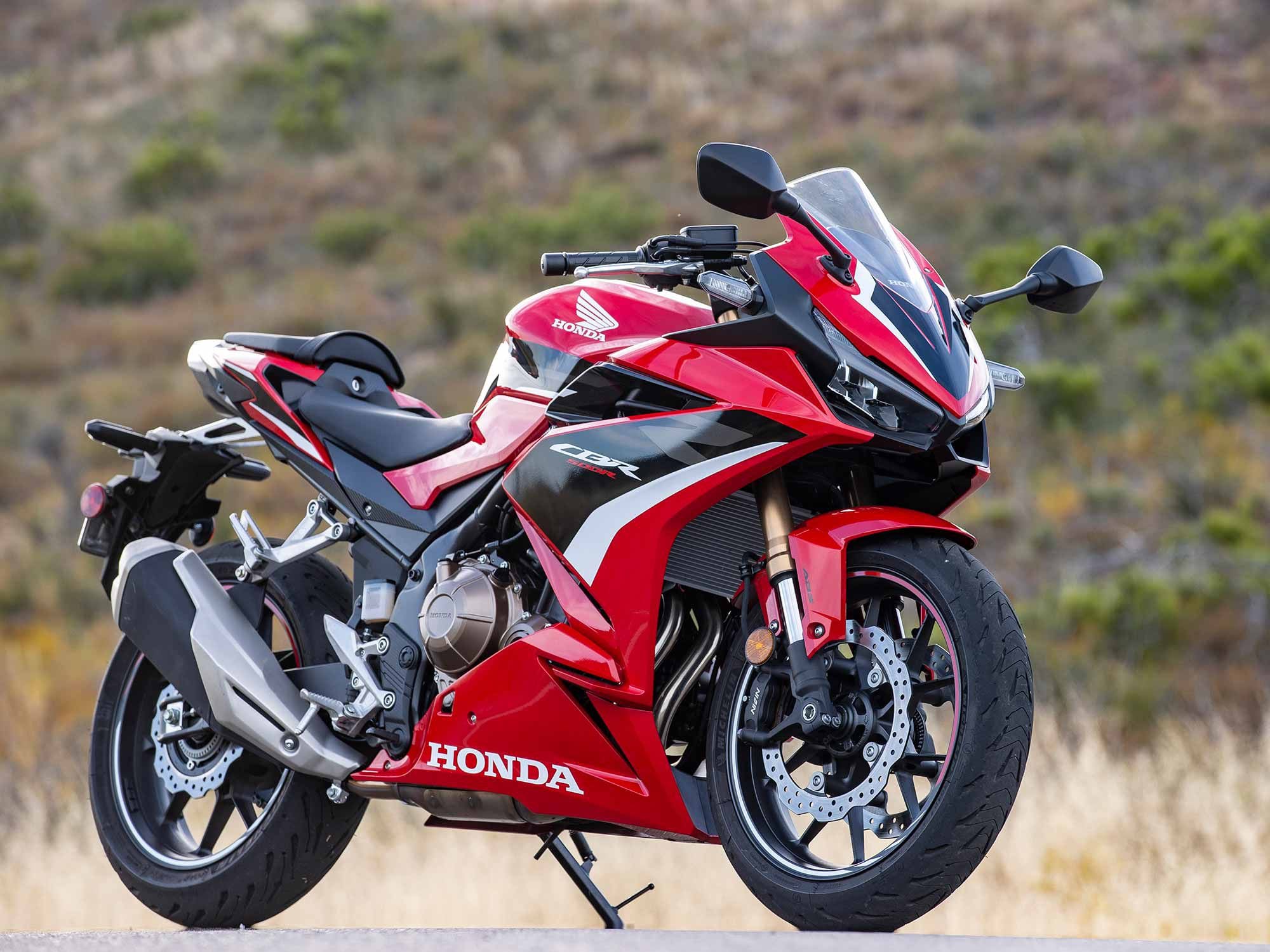

The Honda CBR500R is one of three entry-level models from Big Red to share the same basic platform, including the CB500F and adventure-inspired CB500X.
The Honda CBR500R is one of three entry-level models from Big Red to share the same basic platform, including the CB500F and adventure-inspired CB500X. (Jeff Allen/)

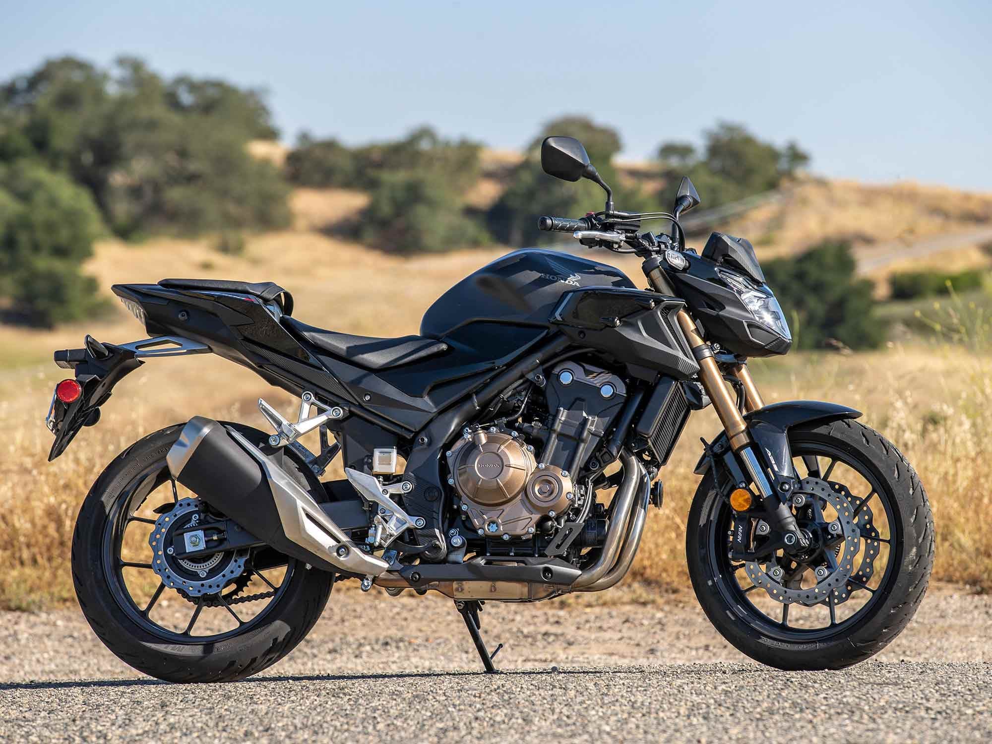

The CB500F differentiates itself from the CBR model with a wider, one-piece handlebar and minimal bodywork.
The CB500F differentiates itself from the CBR model with a wider, one-piece handlebar and minimal bodywork. (Jeff Allen/)

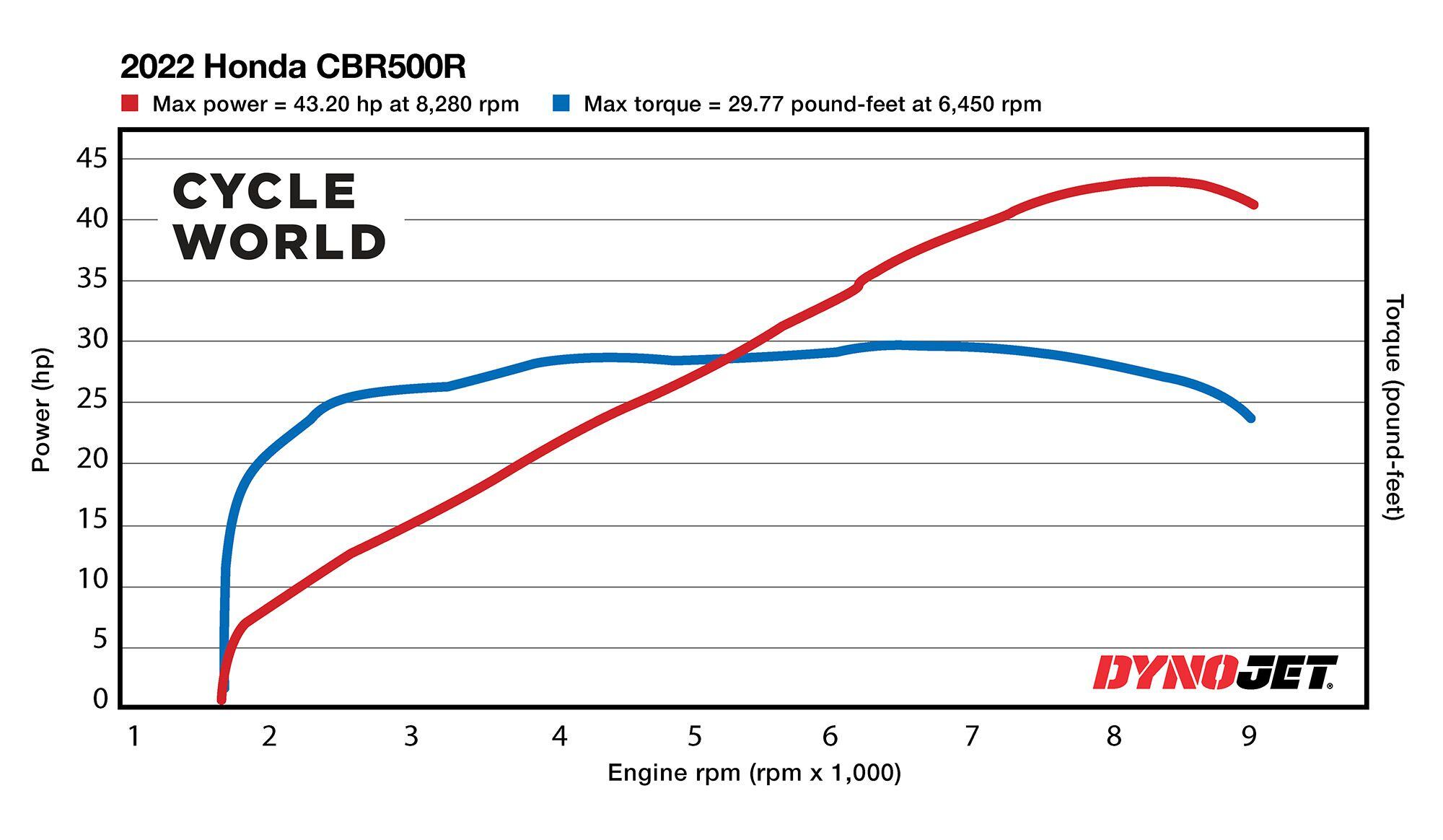

The 471cc 180-degree-crankshaft parallel-twin engine returns with no updates, but it’s not like it was in dire need of any. While certainly not a powerhouse (the CBR500R  cranked out 43.2 hp at 8,280 rpm and 29.77 pound-feet of torque at 6,450 rpm on the CW dyno, with the CB500F posting nearly identical numbers), there’s enough power and a nice, flat torque curve to scoot both bikes through city and highway traffic swiftly and easily without constantly rowing through the gearbox. Helping the acceleration cause is the lack of heft; the CB500F weighed 417 pounds fully fueled on the CW scales, with the full-fairing-equipped CBR coming in 8 pounds heavier.
Horsepower and torque figures of the 2022 Honda CB500R gathered on the <i>Cycle World</i> dyno. As expected, the CB500F produced nearly identical results.
Horsepower and torque figures of the 2022 Honda CB500R gathered on the <i>Cycle World</i> dyno. As expected, the CB500F produced nearly identical results. (Robert Martin Jr./)

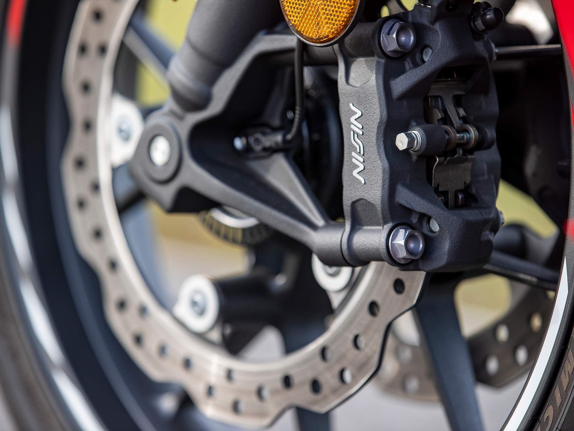

Upgrades to the Honda’s braking system included dual radial-mount four-piston Nissin calipers clamping to 296mm discs with ABS as standard equipment.
Upgrades to the Honda’s braking system included dual radial-mount four-piston Nissin calipers clamping to 296mm discs with ABS as standard equipment. (Jeff Allen/)
While the old CBR/CB-F had decent suspension action, it didn’t take much to overwhelm the damping rod fork. Any sharp bumps were felt straight through the bars, and aggressive braking would result in a lot of front-end dive. And even though braking power was adequate with the single front disc, any hard stopping required a lot of effort at the lever.
Both of those concerns have vanished with the 2022 models. Despite its nonadjustability, the Showa SFF-BP fork provides vastly superior wheel and chassis control compared to the previous unit, offering up far better feedback and stability at any pace. Overall braking with the new dual discs and radial-mount four-piston calipers is similarly improved, providing much better power and feel with less lever effort whether on city streets or twisty roads (the standard ABS is transparent and works well). Combine that with fairly firm damping rates in the spring-preload-adjustable rear shock; the very good grip/handling characteristics of the Michelin Road 5 tires; surprisingly good ground clearance for the reasonable legroom available (especially with the beginner-friendly 31-inch seat height); and supremely agile handling, and you have a sub-500cc entry-level motorcycle that is capable of a pace in tighter canyons that will have many sportbikes sweating. We actually found ourselves riding the two Hondas through the local canyons quite often because of how much fun they are to ride in that environment, and that’s not something you can say about many bikes in this category.

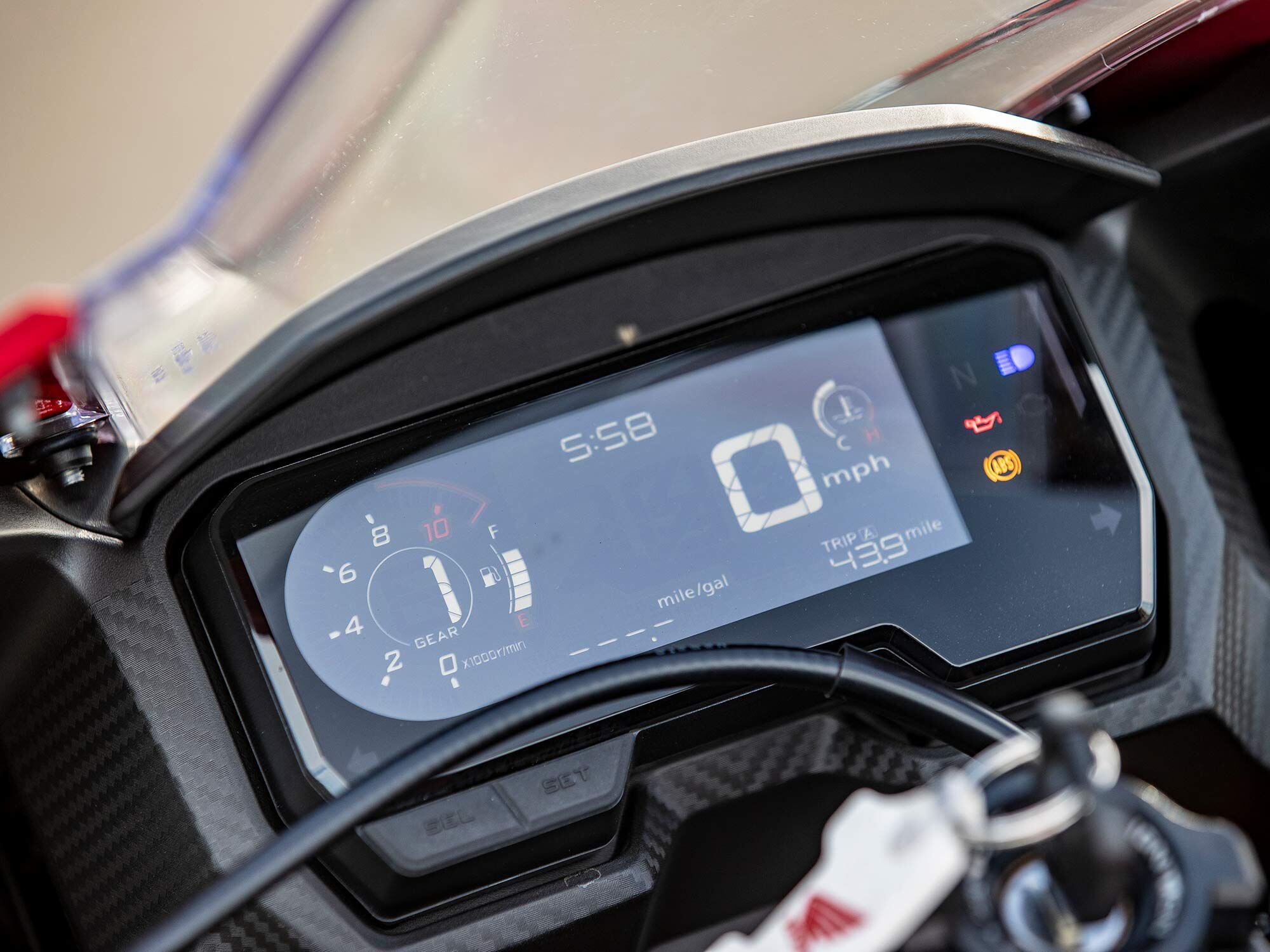

While simplistic with pertinent information, the dashboard of both models is outdated and tough to read in harsh light.
While simplistic with pertinent information, the dashboard of both models is outdated and tough to read in harsh light. (Jeff Allen/)
As far as gripes go, there were a few. With the CB500F, it centers on the LCD dashboard, which besides looking a bit dated was also difficult to see in bright daylight due to reflective glare and lack of contrast. The CBR’s dash is identical but easier to see because of a slightly different mounting angle and being shaded by the fairing and windscreen. But the CBR’s mirrors don’t function as well as the CB-F’s because they are mounted on the fairing; no matter how you adjust them, you have a limited rearward view because your elbows intrude on the image. And we aren’t fans of the ultrashort first gear; yes, it surely helps novice riders avoid stalling, but you blow through the gear within a matter of feet, and if you’re trying to accelerate briskly from a stoplight, it requires some throttle/clutch coordination to accomplish the shift to second gear smoothly.
