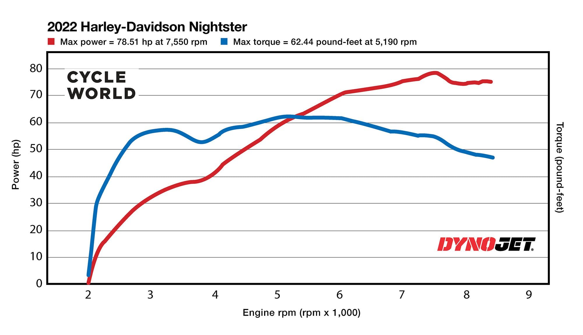

Horsepower and torque figures of the 2022 Harley-Davidson Nightster gathered on the <i>Cycle World</i> dyno.
Horsepower and torque figures of the 2022 Harley-Davidson Nightster gathered on the <i>Cycle World</i> dyno. (Robert Martin Jr./)
Following our first ride review of the 2022 Harley-Davidson Nightster, we placed it on the Cycle World Dynojet 250i dynamometer, recording horsepower and torque measurements. The Revolution Max 975 produced 78.51 hp at 7,550 rpm and 62.44 pound-feet of torque at 5,190 at the rear wheel. As noted in our review, the torque delivery isn’t immediate as seen in H-D’s air-cooled V-twin, with a significant dip between 3,000 and 4,000 rpm and only crossing the 60 pound-feet threshold just before 5,000 rpm. It’s quick revving too, hitting its 8,500 rpm redline shortly after peak power.
