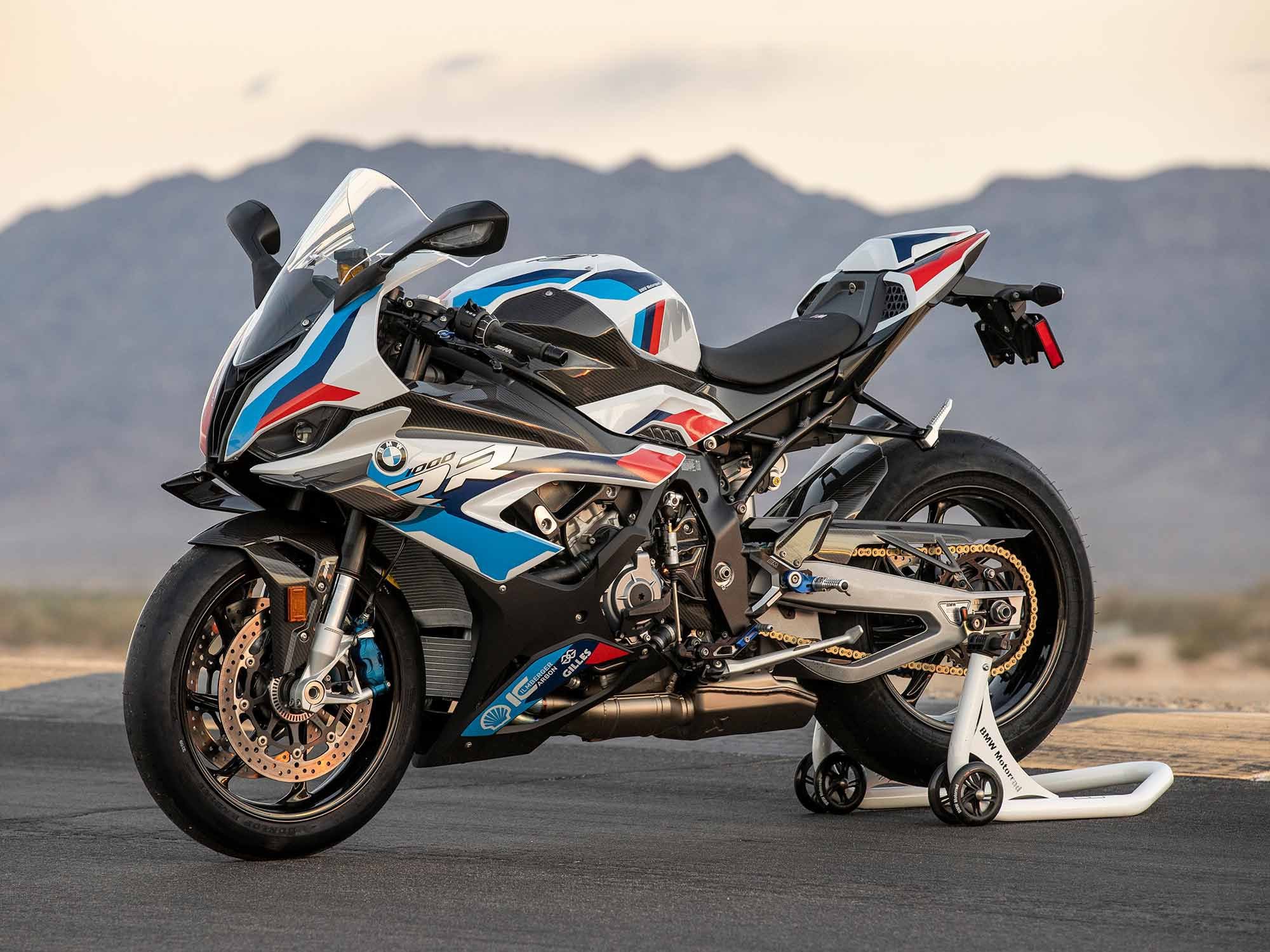

The curbs lining Chuckwalla Valley Raceway’s intricate 2.68-mile layout are the bogeys to the 2021 BMW M 1000 RR’s fighter-jet precision. The Bavarian-built literbike’s locked-on attitude showcases years of the company’s racing endeavors and technical expertise, and the bike serves as a platform for developing future improvements.
Of course, the M 1000 RR is also a homologation special. Every bit of the bike’s design and performance is focused on gaining advantage within the scope of World Superbike technical regulations. The street-spec equipment is there merely to meet DOT requirements and ensure it qualifies as a for-sale streetbike in accordance with the rules of production-based racing. Yes, the $37,490 M is there for well-heeled trackday connoisseurs or even club racers, but its number one role is to give BMW Motorrad and its supported racing efforts a machine on which to work their magic in search of the ideal lap time.
What you get is a motorcycle that Motorrad touts as the first two-wheel model to join BMW’s iconic M-series. It’s a competition-minded offspring of the S 1000 RR, a bike which has been a contender in the open-class production literbike category since its introduction in 2009. The difference is that the M 1000 RR is sharper and more exotic, allowing the elite to race to glory.

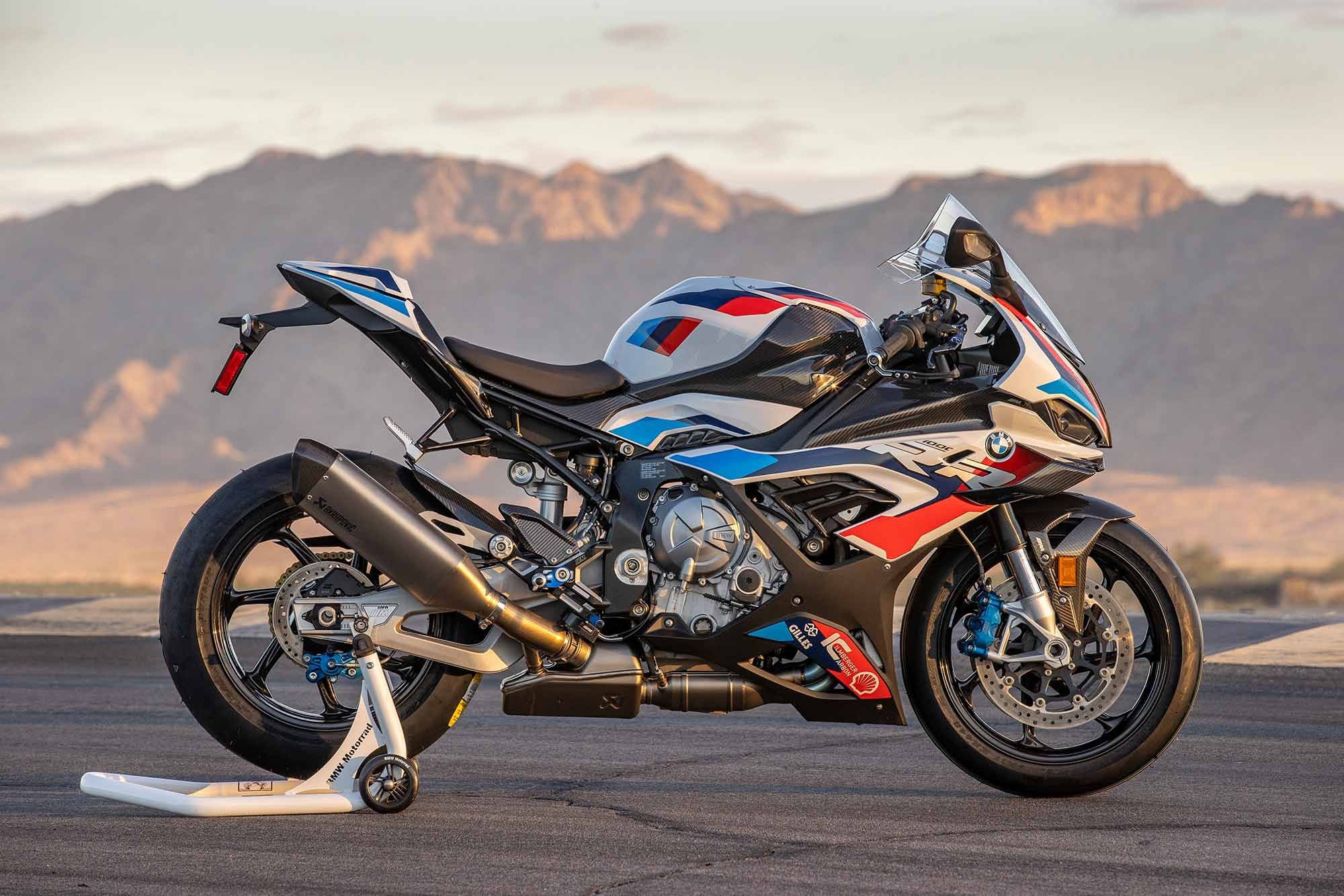

The M 1000 RR has an aggressive stance and tight dimensions that complement its lightweight handling.

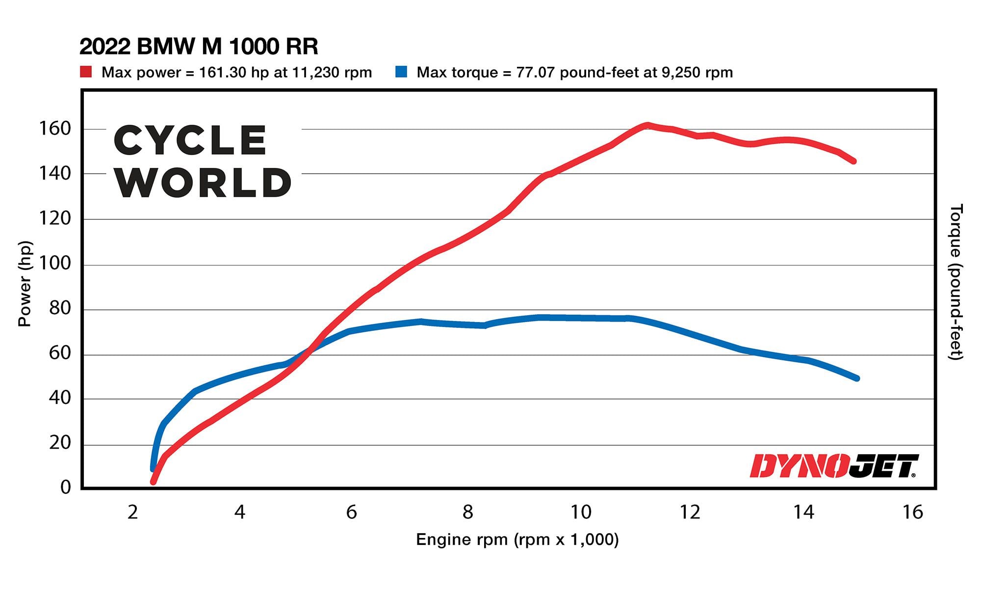

Horsepower and torque figures of the BMW M 1000 RR gathered on the Cycle World dyno. An important note: Our test unit was flashed with the dealer-installed “torque map.”
Horsepower and torque figures of the BMW M 1000 RR gathered on the Cycle World dyno. An important note: Our test unit was flashed with the dealer-installed “torque map.” (Robert Martin Jr./)
The result of these revisions is a powerplant that, BMW Motorrad claims, undramatically produces 205 hp at 13,000 rpm in US trim, the same numbers as the S 1000 RR in stock configuration. The lighter parts and higher redline are simply waiting for racer mods so the bike can make competitive power at the track. Our test unit was flashed with the dealer-installed “torque map,” which we tested on the in-house Cycle World Dynojet 250i dynamometer. The M RR produced a peak 161.30 hp at 11,230 rpm and 77.07 pound-feet of torque at 9,250. Analyzing the curves indicates the optional flash eliminates the S model’s frustrating dip between 6,000 and 8,000 rpm, but power quickly signs off just after 11,000 rpm, leaving 4,100 rpm of overrev waiting to be uncorked with race-spec tuning changes.

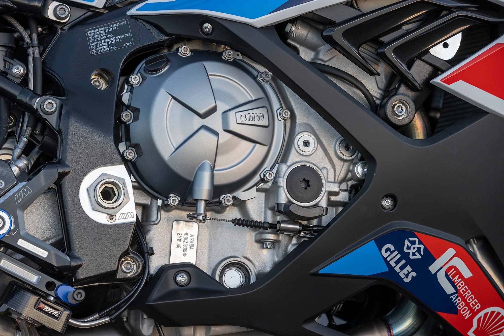

The sorcery is within the M 1000 RR inline-four engine. Trick components like the Pankl titanium connecting rods, two-ring Mahle forged pistons, and allow for quick revving to its 15,100 rpm redline.
The sorcery is within the M 1000 RR inline-four engine. Trick components like the Pankl titanium connecting rods, two-ring Mahle forged pistons, and allow for quick revving to its 15,100 rpm redline. (Jeff Allen/)

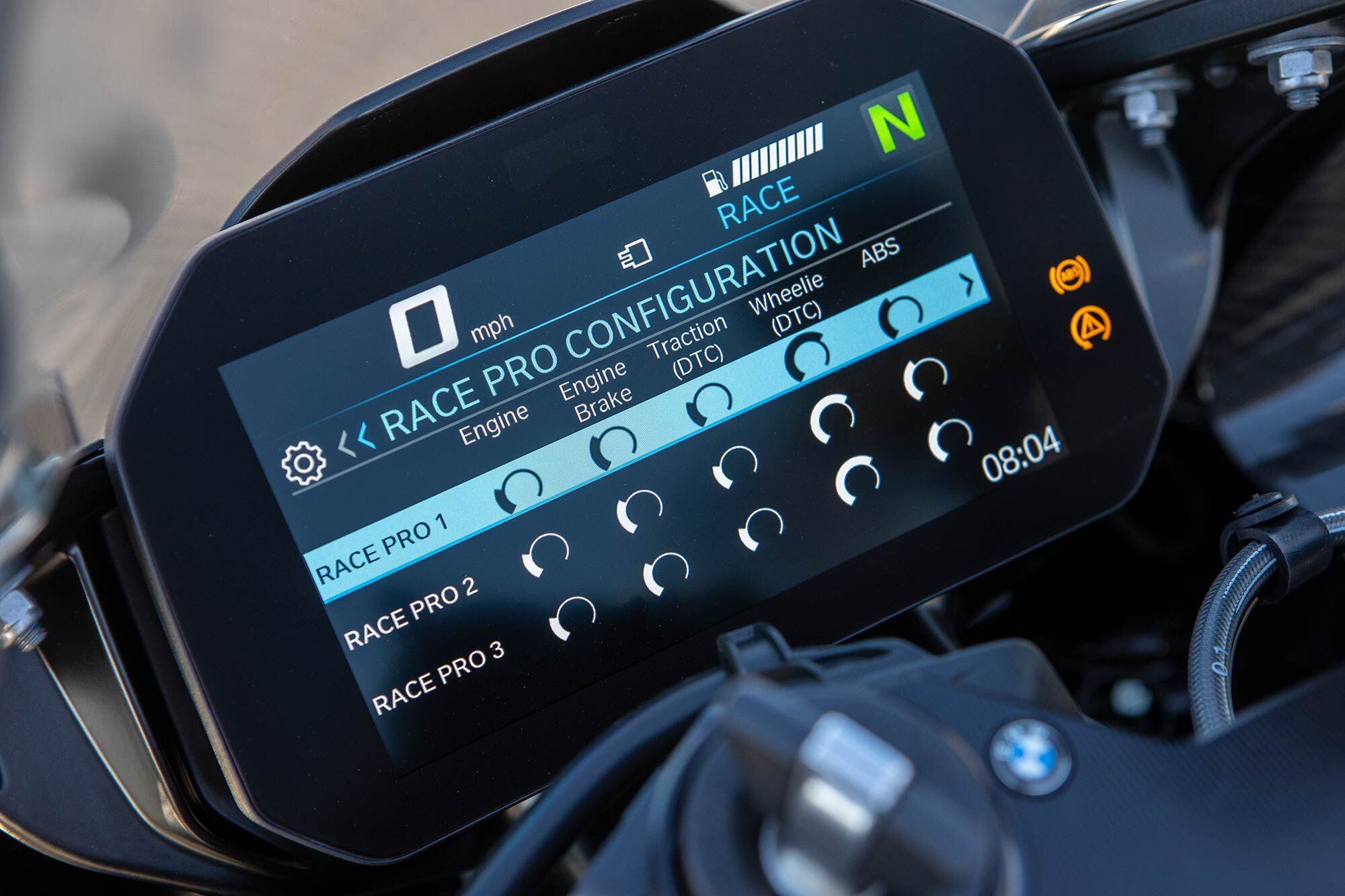

After working with all these options in the time allowed by our one-day track test, I found that dialing the TC to a less intrusive setting (my preference was -4 with wheelie control reduced to level 1) provided the most visceral riding experience. This helped the M RR make the most of its linear power delivery and low-end grunt; it exhibited ripping corner-exit acceleration while perfectly maintaining low-trajectory MotoGP-style power wheelies as seen in slow-motion replays. Awesome.
The TFT display of the M 1000 RR is top-notch, but toggling through its screens is time-consuming.
The TFT display of the M 1000 RR is top-notch, but toggling through its screens is time-consuming. (Jeff Allen/)

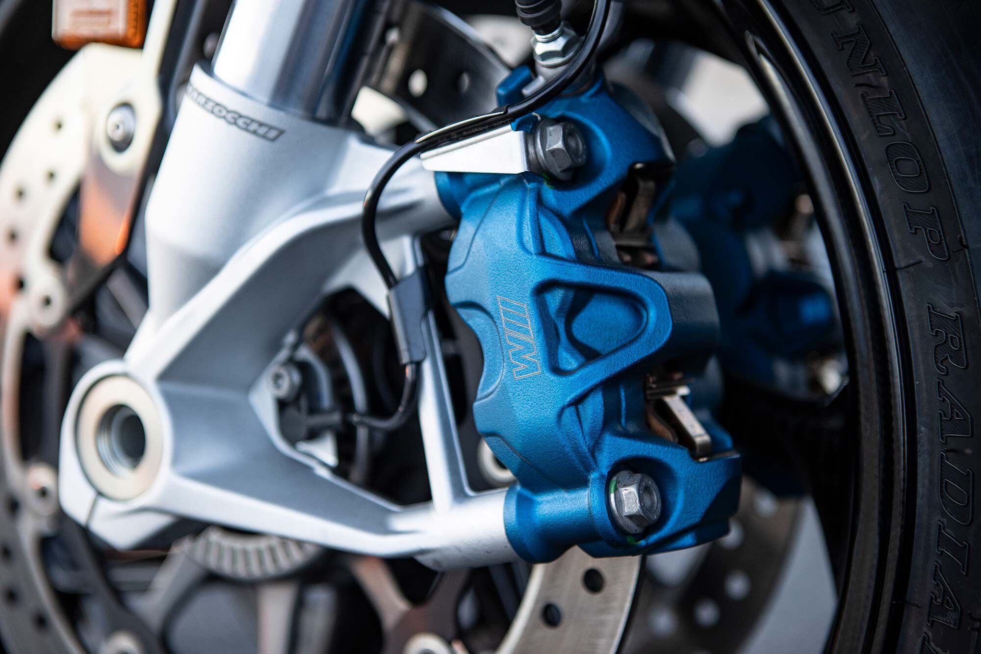

A set of blue anodized M-branded calipers add to the BMW’s bling and performance.
A set of blue anodized M-branded calipers add to the BMW’s bling and performance. (Jeff Allen/)
The front end is so good that its M-branded brake calipers, co-developed with Nissin, are a mild letdown after aggressive initial bite, as lever feel isn’t great as you trail-brake to the apex. Outright power is superb, but there’s an opportunity for more communication and sensitivity when pushing the limit. Three-level selectable electronic engine-braking function can be tuned to suit your style.

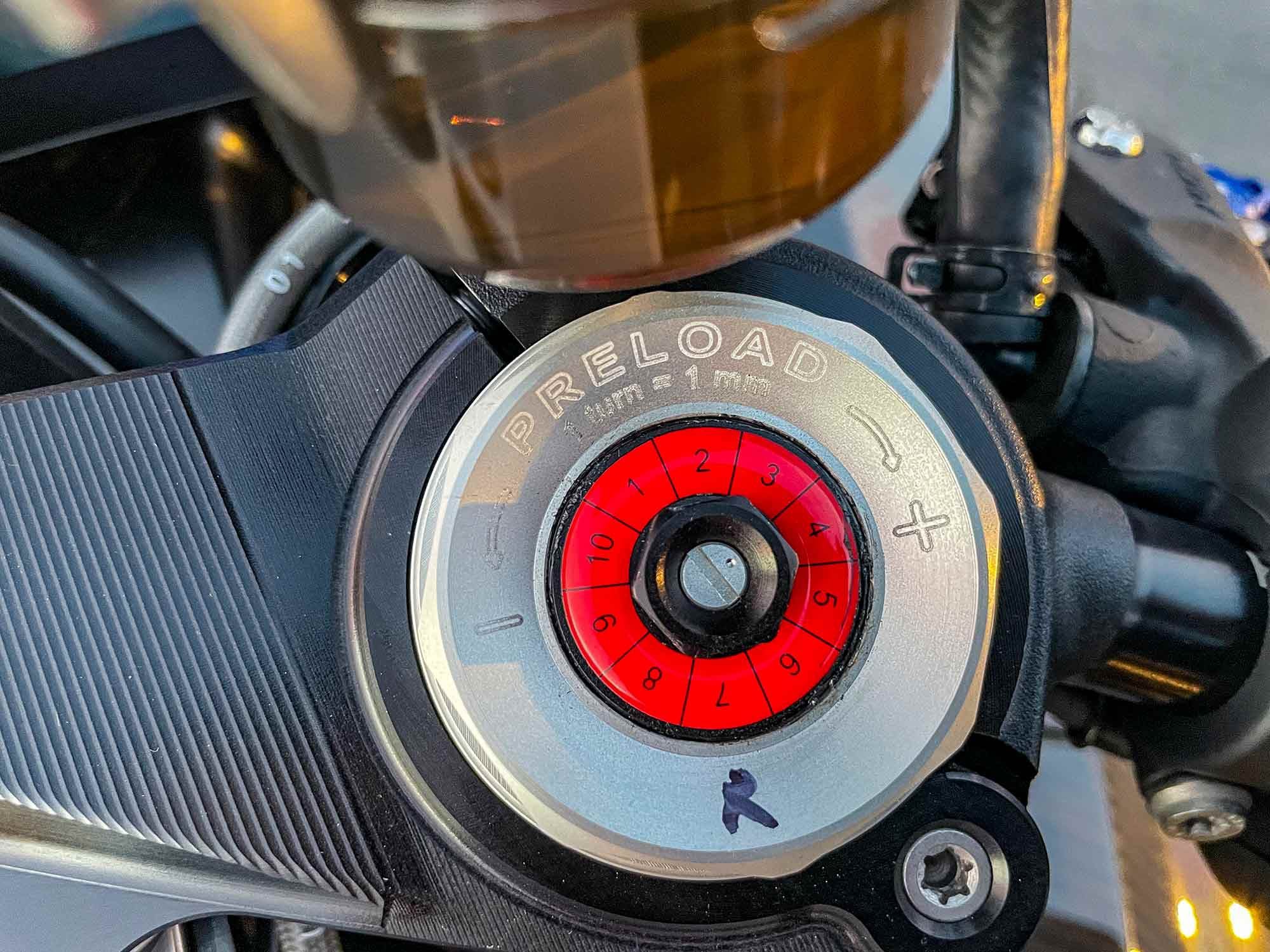

The Marzocchi fork features full adjustability to dial in to rider preference.
The Marzocchi fork features full adjustability to dial in to rider preference. (Jeff Allen/)
