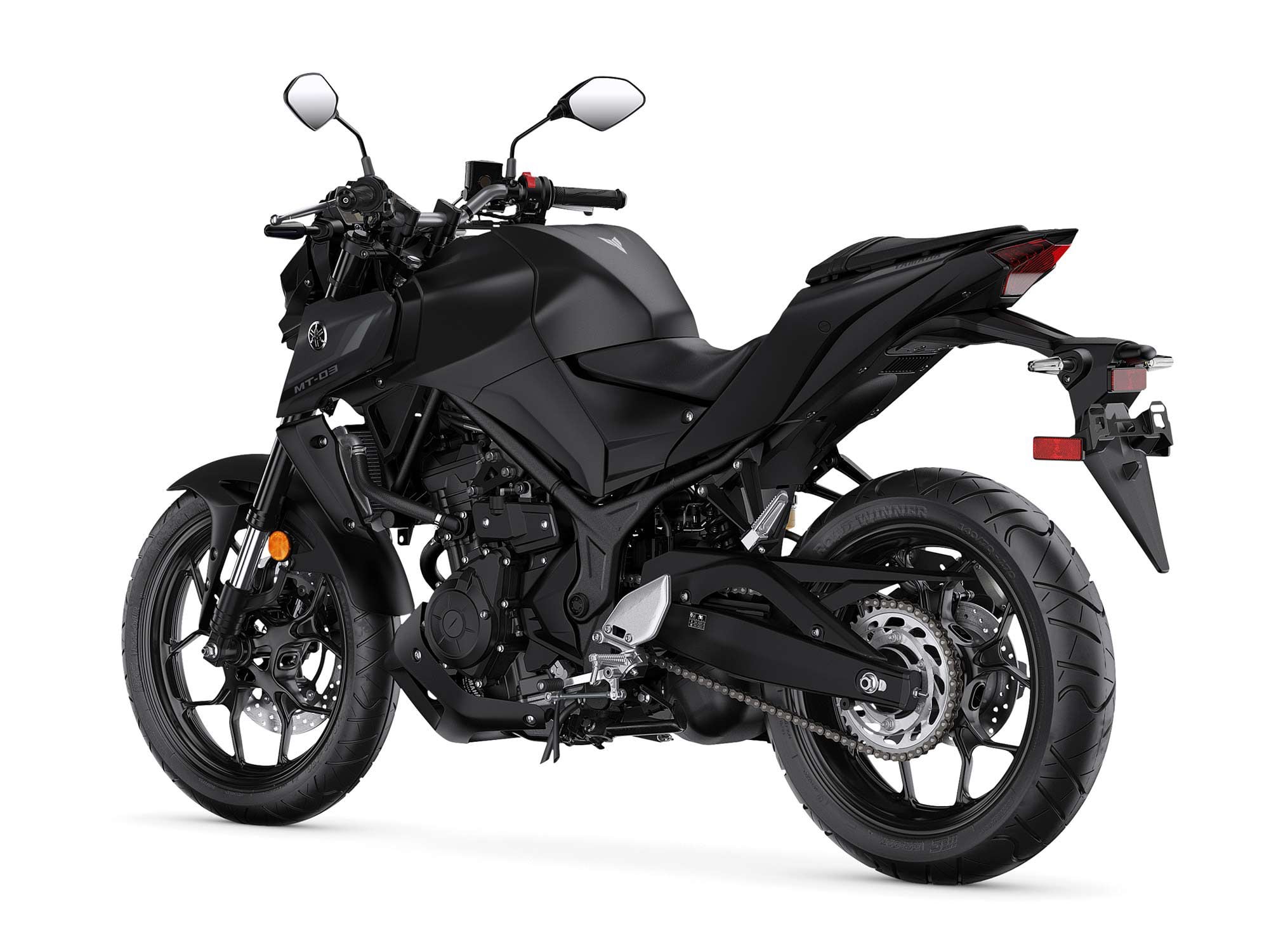

The MT-03 in Matte Stealth Black.
The MT-03 in Matte Stealth Black. (Yamaha/)
The MT-03 comes with a one-year, limited factory warranty.
Whether you like the styling or not, the MT-03 has admirable fit and finish. The only minor grievance we have is that the fuel cap’s keyhole cover was flimsy and held on only by a pin.
The MT-03 is available at an easy-to-swallow $4,799, regardless of color choice.
The MT-03 is available at an easy-to-swallow $4,799, regardless of color choice. (Yamaha/)
