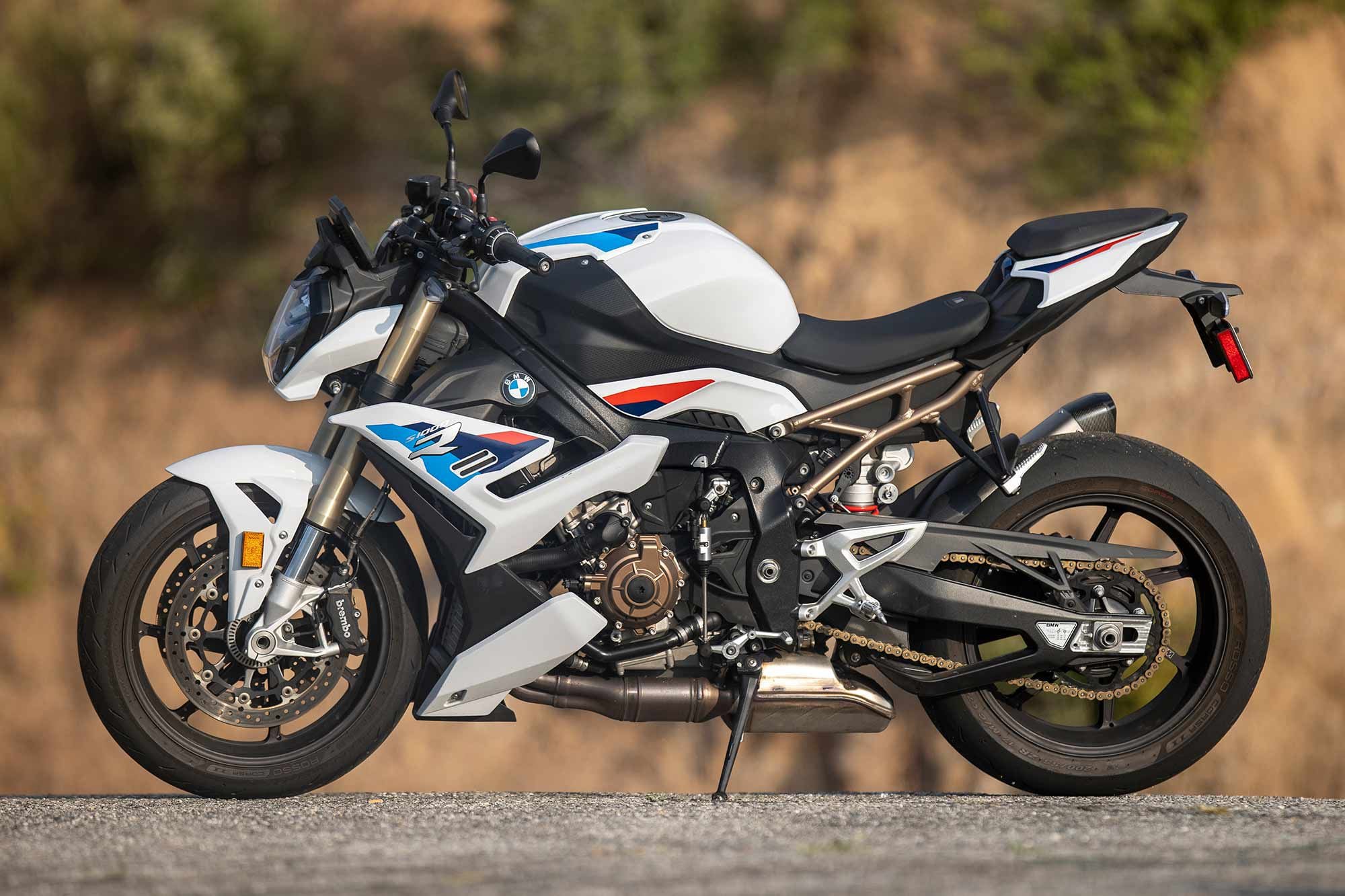

BMW’s S 1000 R comes in various trims and packages; our test unit was fitted with the M package that includes forged wheels.
BMW’s S 1000 R comes in various trims and packages; our test unit was fitted with the M package that includes forged wheels. (Jeff Allen/)
We’ve been eager to ride the M-series since Motorcyclist, our sister publication,  did a First Ride in the UK a year ago. We’ve finally got one stateside, looking handsome in its M colors, sounding authoritative with its carbon-tipped Akrapovič titanium muffler, and dripping with lots of other cool bits.

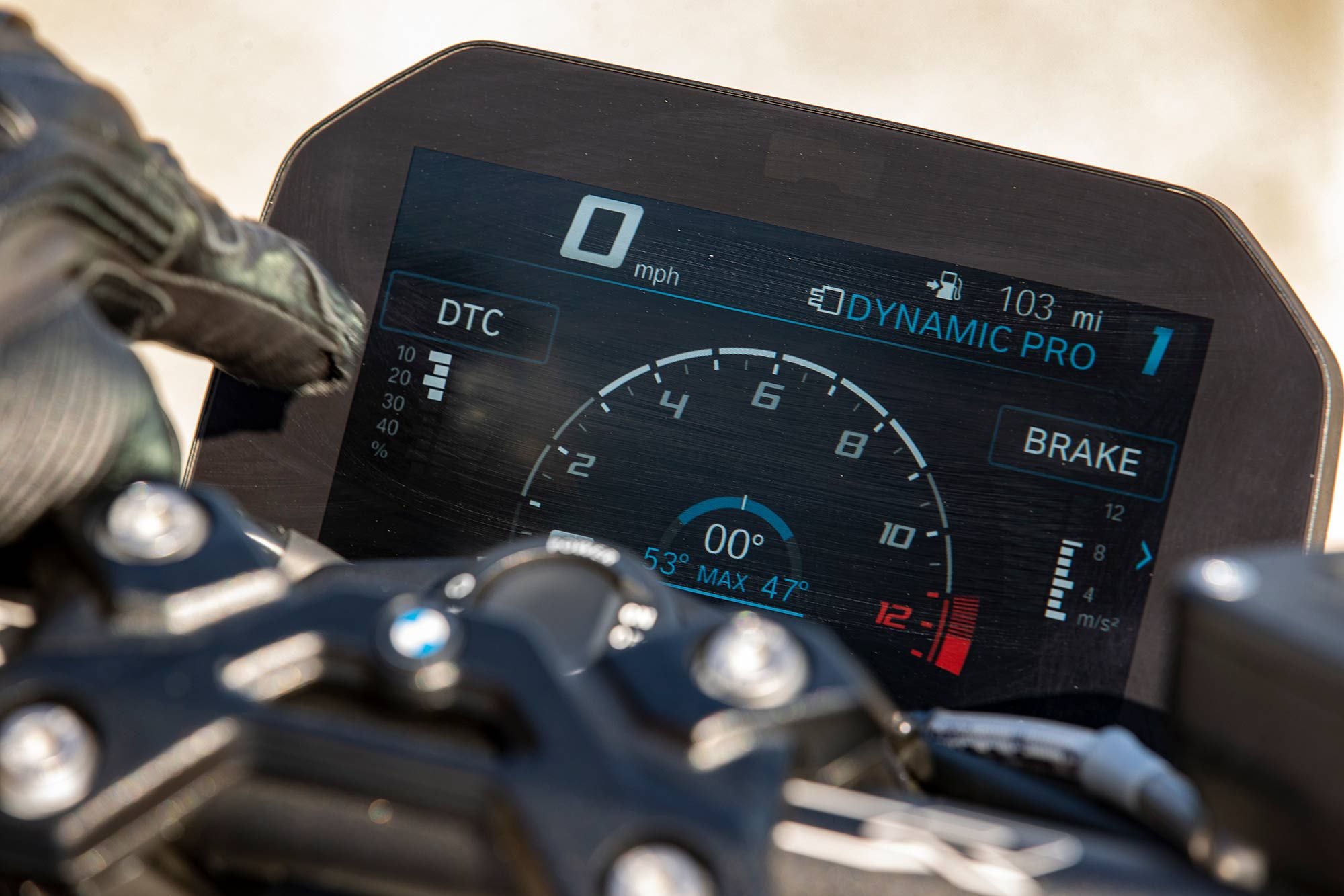

A 6.5-inch TFT dash has multiple screens and is easy to read.
A 6.5-inch TFT dash has multiple screens and is easy to read. (Jeff Allen/)
About that dash: BMW has done top-notch work on the dash display, which is clear, bright, and easy to read in any light. A standout feature is the Dynamic Redline, which starts out low when the engine is cold and gradually rises as engine temperature increases. The M-series also adds another dash screen for a total of four for configurations and information.
Another difference with the M is the sheer number of settings for engine and chassis electronics, rider aids, and available information within the dash. There’s so much information and so many available options that familiarization before riding is essential; before turning a wheel, the rider should get everything set up to personal preference, riding style, and riding conditions. For those who want to go deep into this, a notable M upgrade is Dynamic Pro mode, which allows even more detailed adjustments and goes far beyond the preprogrammed settings. The M electronics package is so comprehensive that it even has an option to display tire pressures, very much appreciated as tire pressure is an underrated aspect of a good ride.

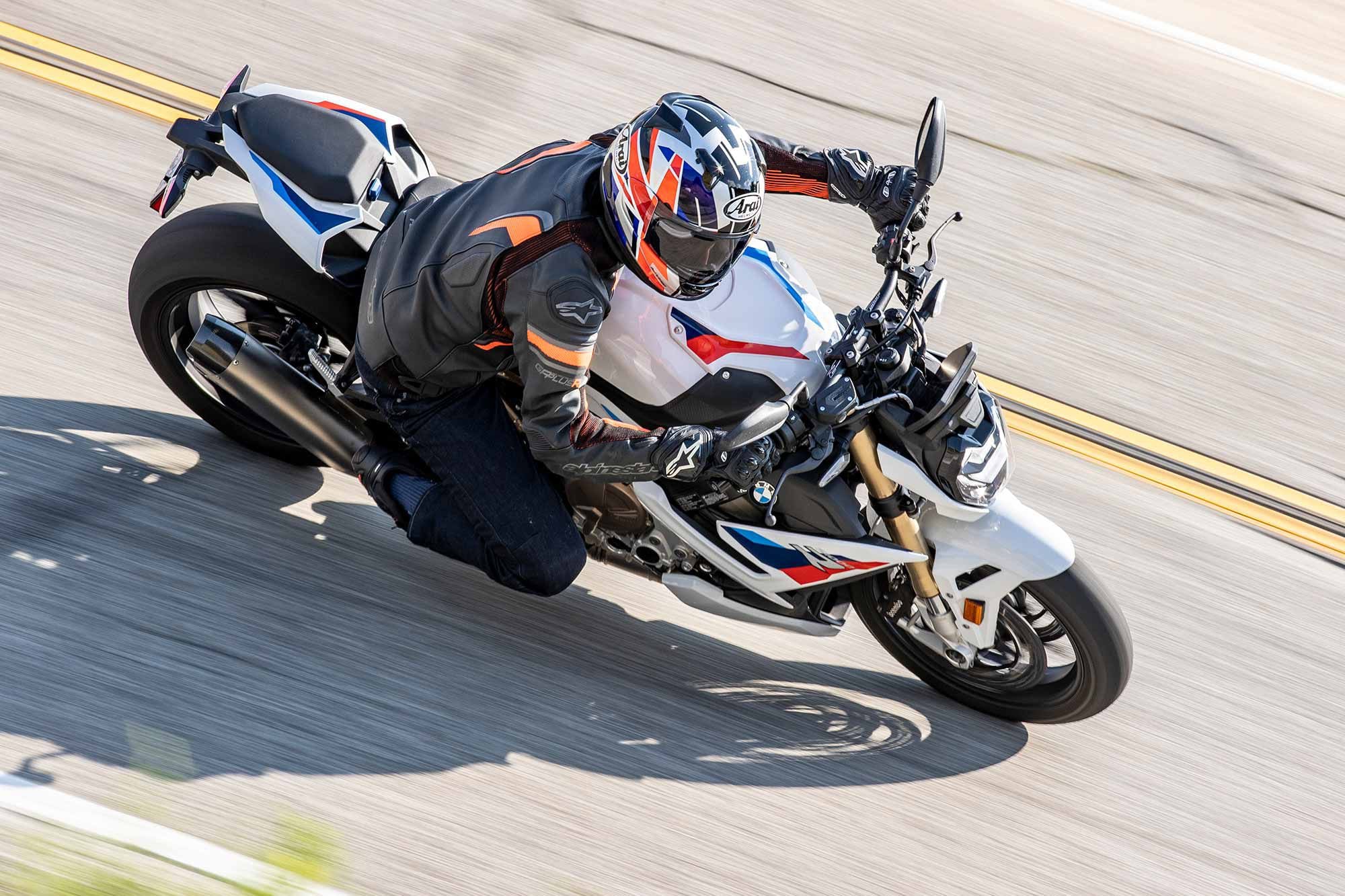

Steering is light on the 2022 BMW S 1000 R and is a breeze to ride around town and on backroads.
Steering is light on the 2022 BMW S 1000 R and is a breeze to ride around town and on backroads. (Jeff Allen/)
Once set up and underway, something as simple as running errands around town on the M is a breeze and actually pretty fun. The bike is very refined, turning tight and steering light. The rider can quickly change the Marzocchi semi-active suspension damping while riding by thumbing the suspension button on the left handlebar. Riding around town on the Road setting, the softest damping setting, provides a comfortable ride that easily soaks up just about anything.

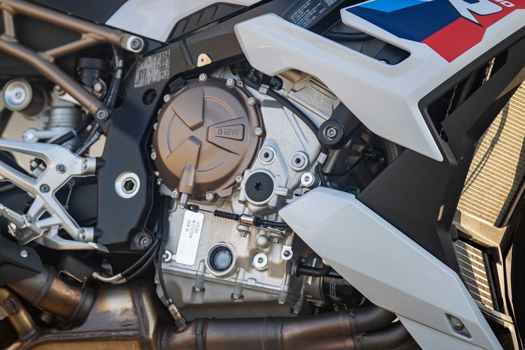

On the <i>CW</i> dyno, the 2022 BMW S 1000 R produced 155.7 hp from its 999cc inline-four.
On the <i>CW</i> dyno, the 2022 BMW S 1000 R produced 155.7 hp from its 999cc inline-four. (Jeff Allen/)

As comfortable as the M is in mundane riding, it truly shines when the road starts getting curvy. All the rider has to do is long-push the suspension button, select the double-helmet (two-up) option on the screen for even more damping force, select the firmer Dynamic settings front and rear, and go ride. Quick, simple, and easy.
And the M-series loves a winding road. Thanks to throttle-by-wire, spot-on fuel mapping at any rpm and smooth off-corner power delivery, the engine doesn’t stumble or miss and couldn’t be better during closed-to-open throttle transitions at any rpm. This fuel mapping system makes it incredibly easy to ride fast going through the gears, up or down; speaking of which, the M has the option of changing shift patterns to a race-shift pattern of one-up and five-down.
Smooth off-corner power delivery and well-sorted fueling makes fine throttle adjustments consistent and predictable.
Smooth off-corner power delivery and well-sorted fueling makes fine throttle adjustments consistent and predictable. (Jeff Allen/)

Measurement on the CW Dynojet dyno shows that power below 6,500 is linear, if a little on the soft side driving out of corners; this is also what makes it fun and easy to ride. Keep in mind that when saying the power is “a bit soft” on corner exit, the measured 155.43 hp at 11,250 rpm (79.85 pound-feet at 9,310 rpm), 999cc four-valve inline four-cylinder engine still very easily lays down long strips of rubber from its wide, sticky 200/55-17 Pirelli Diablo Rosso Corsa II rear tire in any gear when provoked, if you’re willing to take the bike down into the 27 mpg range. The dyno also shows that this engine makes very significant linear power and torque increases after 6,500 rpm. Oddly, while riding, the engine seems to start building its full head of steam closer to 8,000 rpm (tachometer error, perhaps?) and pulls extremely hard to its 11,500 redline, leaving even longer tire stripes and, of course, often lifting the front wheel. At the risk of becoming repetitive: The M is a blast to ride.
BMW has matched the S 1000 R’s potent engine with a chassis that delivers excellent handling.
BMW has matched the S 1000 R’s potent engine with a chassis that delivers excellent handling. (Jeff Allen/)
All this smooth, controlled, abundant power would be nothing without an equally matched chassis. The M delivers quite well; complementing and containing the engine is an aluminum bridge-type frame and under-braced swingarm that offer great feedback of what’s going on. The chassis has great balance, easily managing its CW-measured 442 pounds (with a full tank of gas). There’s exactly the right amount of rigidity and the ideal geometry to beg the rider to push harder, make midcorner changes while hard on the (radial-mounted Monoblock Brembo-calipered 320mm dual-disc) brakes, and generally do things that other motorcycles may struggle with, and to do them predictably and easily.
