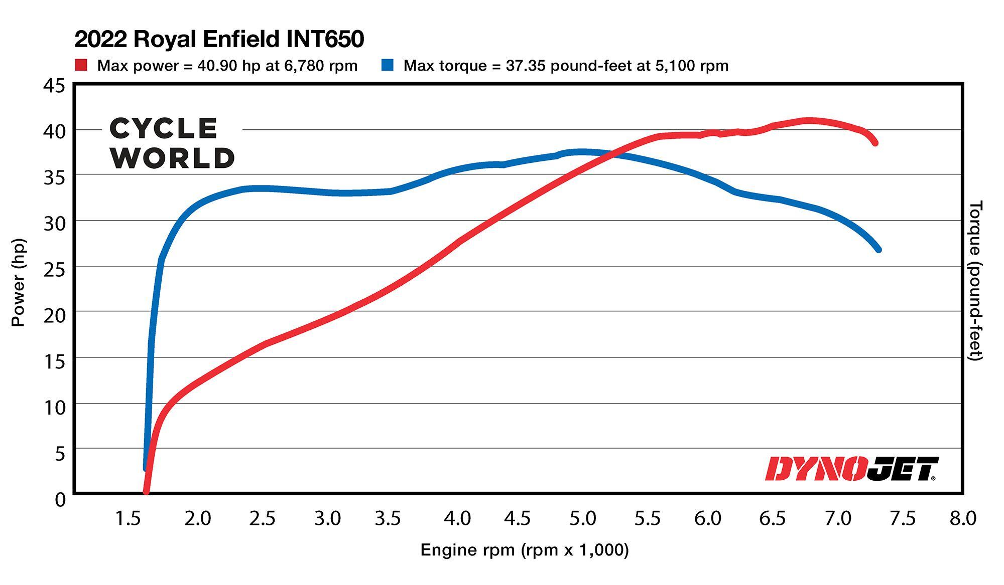

Horsepower and torque figures of the 2022 Royal Enfield INT650 recorded on the <i>Cycle World</i> dyno.
Horsepower and torque figures of the 2022 Royal Enfield INT650 recorded on the <i>Cycle World</i> dyno. (Robert Martin Jr./)
In anticipation of our upcoming review of the 2022 INT650, we strapped it to Cycle World’s Dynojet 250i dynamometer to get horsepower and torque figures. The INT650 produced a modest 40.90 hp at 6,780 rpm and 37.35 lb.-ft. of torque at 5,100 rpm. Not earth-shattering, by any means, but you can see the aforementioned smoothness on its charts. Roughly 34 pounds of torque is readily available from 2,500 rpm, with a relatively flat torque spread following. All this adds up to linear power delivery, which translates to everyday flexibility.

As the review says, it's not just about peak power, but how it's delivered.
