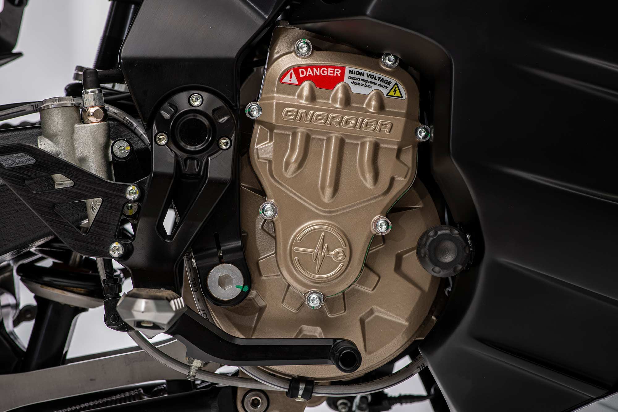

The other reason for the Experia’s range is its relatively restrained power. Energica’s Ego superbike has already proved the company can make more powerful machines, topping out at 169 hp, but the Experia has a completely new Permanent Magnet Assisted Synchronous Reluctance Motor (that’s PMASynRM) powertrain. As its designation suggests, it uses a combination of permanent magnets and an electromagnet-based synchronous reluctance system. It drives through a single-speed transmission, with no clutch or gearshift, and is rated at a continuous 80 hp or a peak of 102 hp for brief periods.

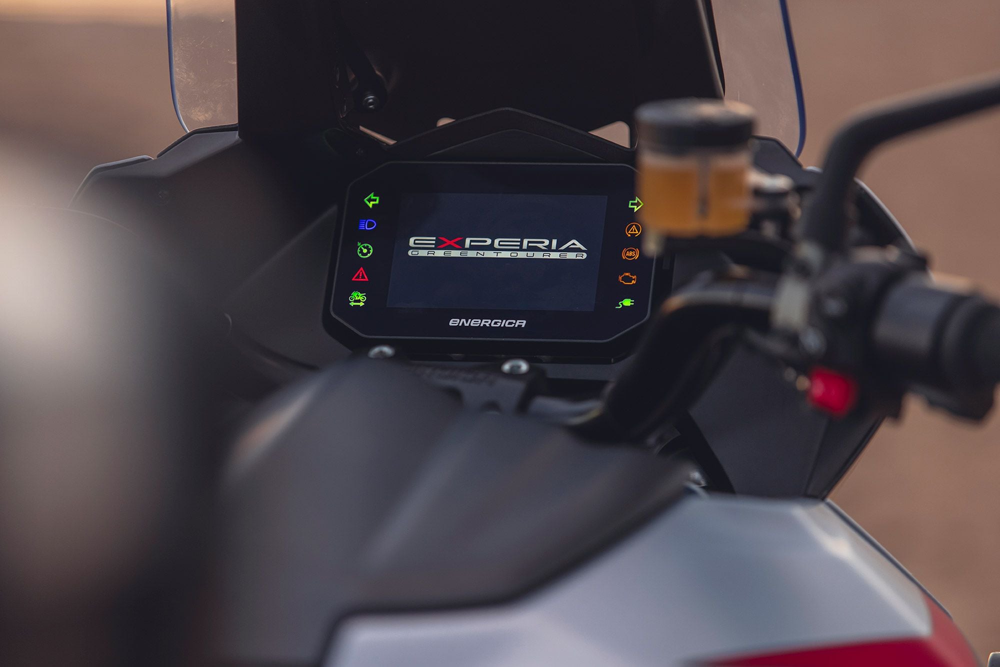

Electronic controls include seven riding profiles—four factory presets and three customizable ones—four riding modes (Eco, Urban, Rain, or Sport), and four regenerative braking modes. There’s also traction control, with six levels of intervention, and Bosch cornering ABS.

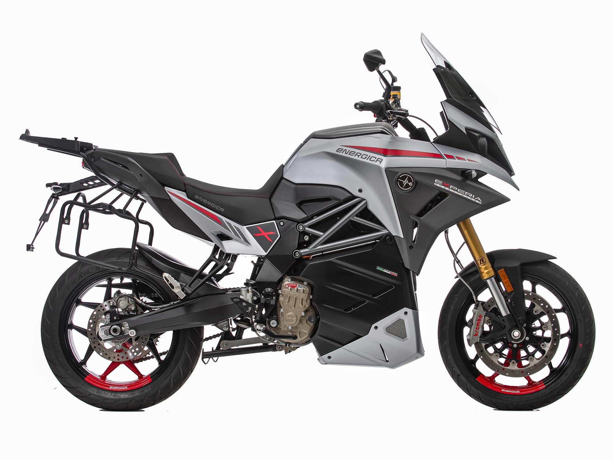

Away from the powertrain, the Experia’s components are pretty conventional fare. The frame uses a combination of a steel trellis section at the front bolted to aluminum side plates clamping the swingarm pivot. The swingarm is cast alloy, as are the wheels: 17-inchers at either end, clad in Pirelli Scorpion Trail II rubber.
Sachs supplies the suspension: a 43mm USD fork with adjustable preload, compression, and rebound, and a monoshock at the back with rebound and preload adjustment, giving 5.9 inches of travel at each end. It’s an Italian bike, so of course the brakes are Brembos: two 330mm discs up front with four-pot calipers and a single 240mm rotor at the back with a two-piston unit.
The bike’s dimensions, including a 59.5-inch wheelbase, 33.3-inch seat height, 83.9-inch length, and 34.1-inch width, are all pretty close to the numbers you’d find on a BMW R 1250 GS spec sheet.
