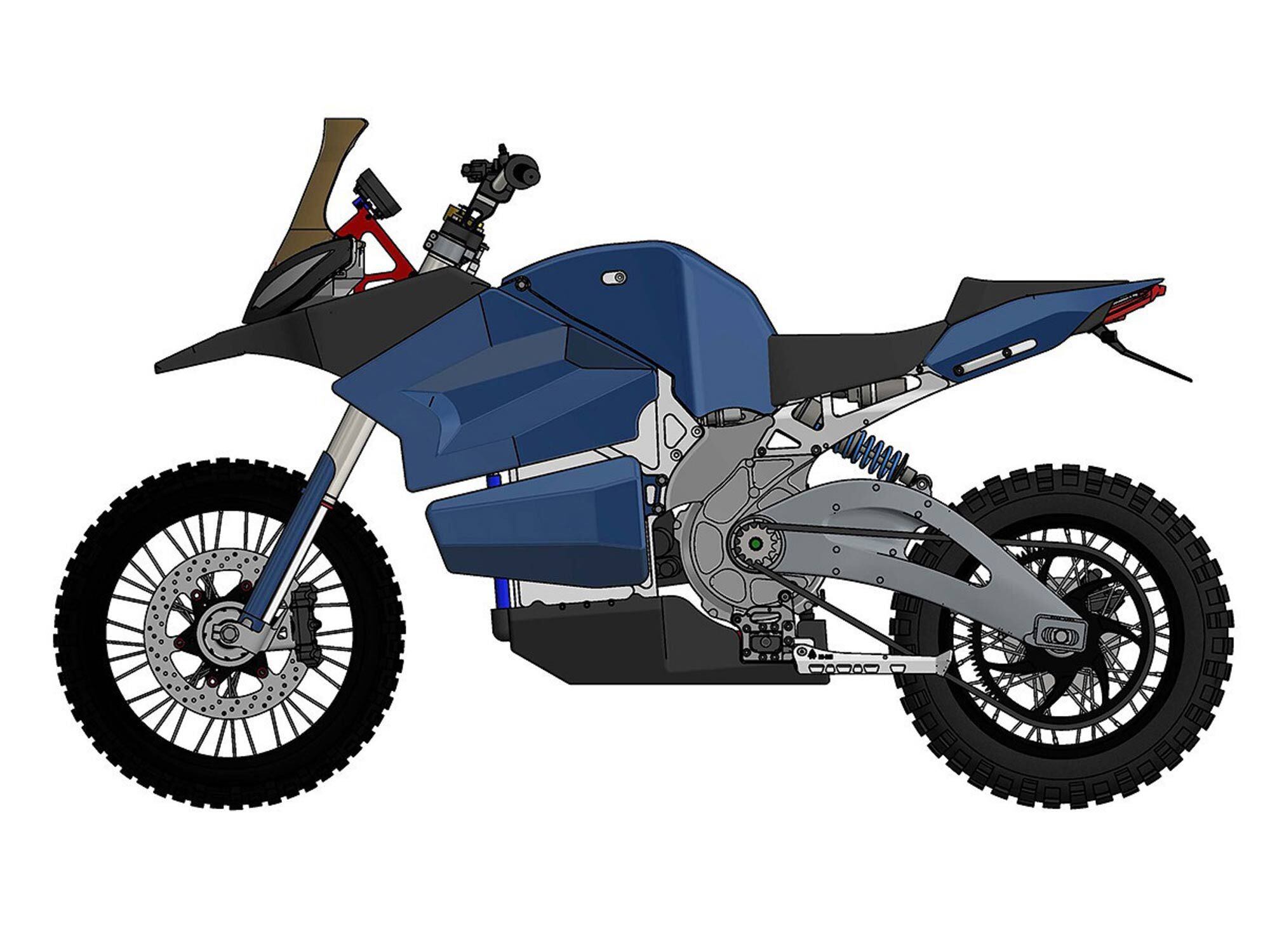

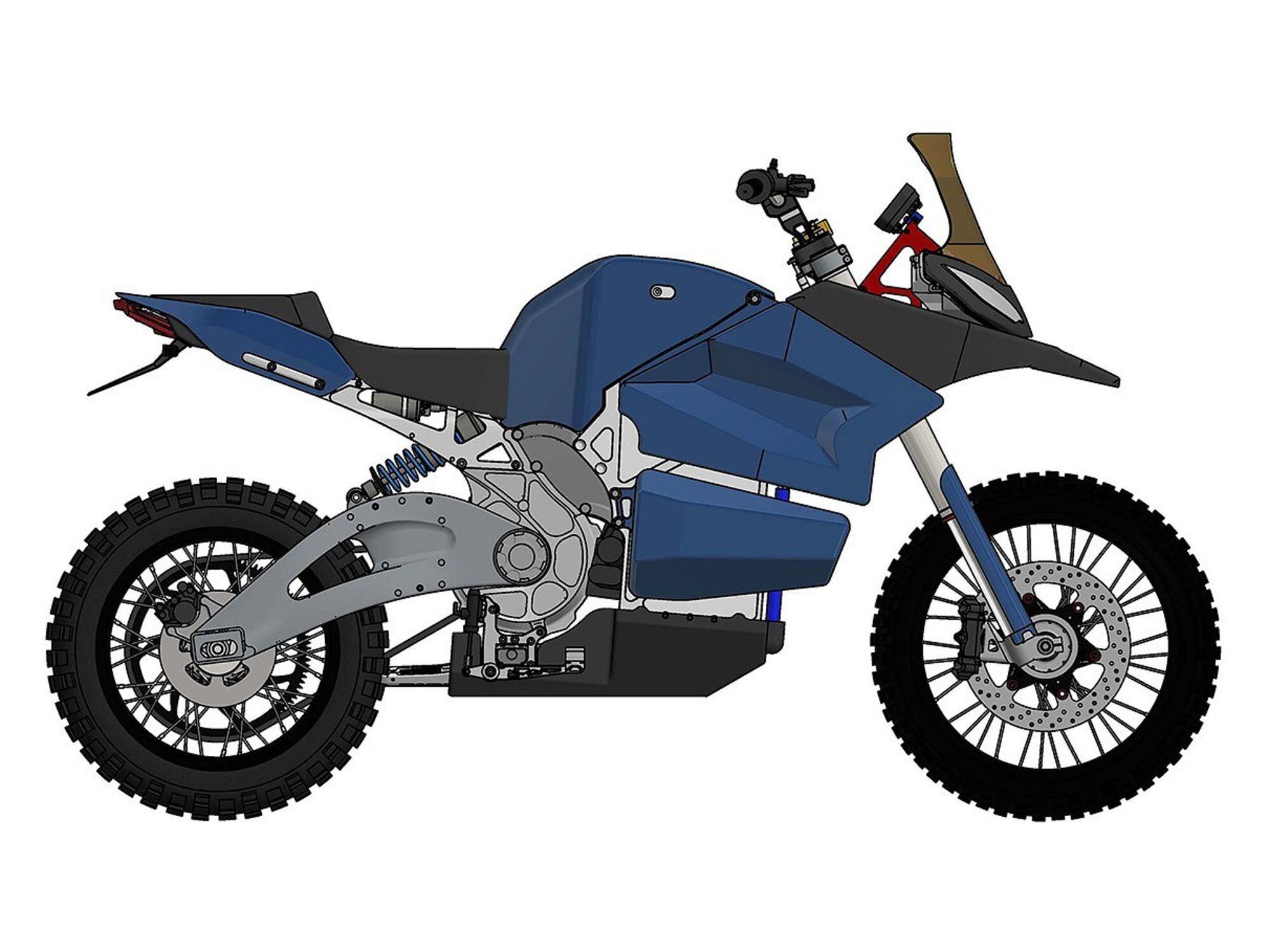

In this image you can see how the swingarm is mounted concentric to the motor’s shaft.
In this image you can see how the swingarm is mounted concentric to the motor’s shaft. ( Lightning Motorcycle/)
It’s clear that the chassis and drivetrain are closely related to the Strike. The distinctively curved swingarm is extremely similar in style, but where the older Lightning models have the swingarm pivot relatively low, the Dakar’s version is mounted concentrically to the motor’s shaft. That suggests the reduction transmission of the Strike and LS-218 has been removed, with the electric motor instead powering the final drive directly.
It looks like final drive is by belt, with a massive rear pulley providing the ratio needed to multiply the motor’s torque and to gear the motor correctly for an adventure bike’s performance demands.
As on the Strike and LS-218, the motor plays a structural role in the chassis, with billet-style subframes front and rear to carry the steering head and the seat. A direct-action shock, with no rising-rate linkage, is bolted between the swingarm and an upper mount on top of the motor, while the fork is suitably long to give the bike the adventure stance that the firm is looking for.
Like Lightning’s other models, the battery pack is mounted ahead of the motor, stacked vertically to extend up into the area where you’d normally find a fuel tank. The Lightning Strike, revealed back in 2019, uses a substantial 20kW battery pack to provide a claimed 152-mile range in mixed usage, with the firm claiming a possible 200 miles at urban speeds. As an adventure bike, the Dakar is likely to be at least as long-range as the Strike and could feature an even larger battery.

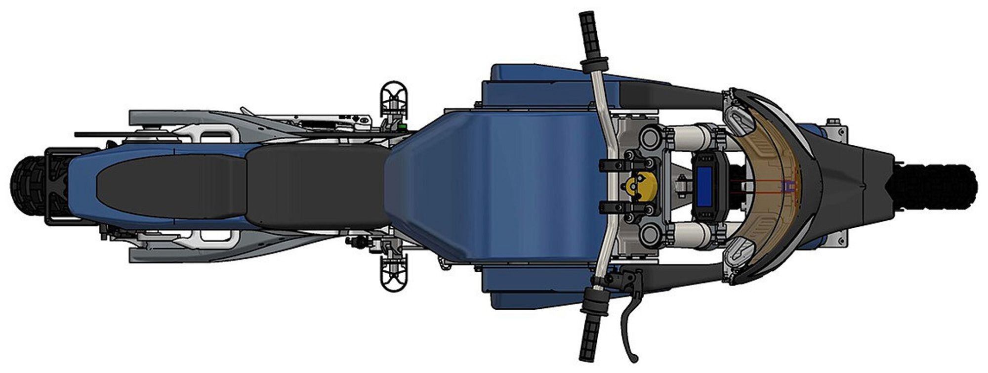

The top view shows the broad upper “tank” area that conceals the battery pack.
The top view shows the broad upper “tank” area that conceals the battery pack. (Lightning Motorcycle/)
If the motor is the same used in the Strike—which would make sense to reduce development and manufacturing costs—then it’s good for 120-peak horsepower according to Lightning’s own figures, although a detuned version might make sense given the bike’s style and the range advantages that a lower-power output could offer.
