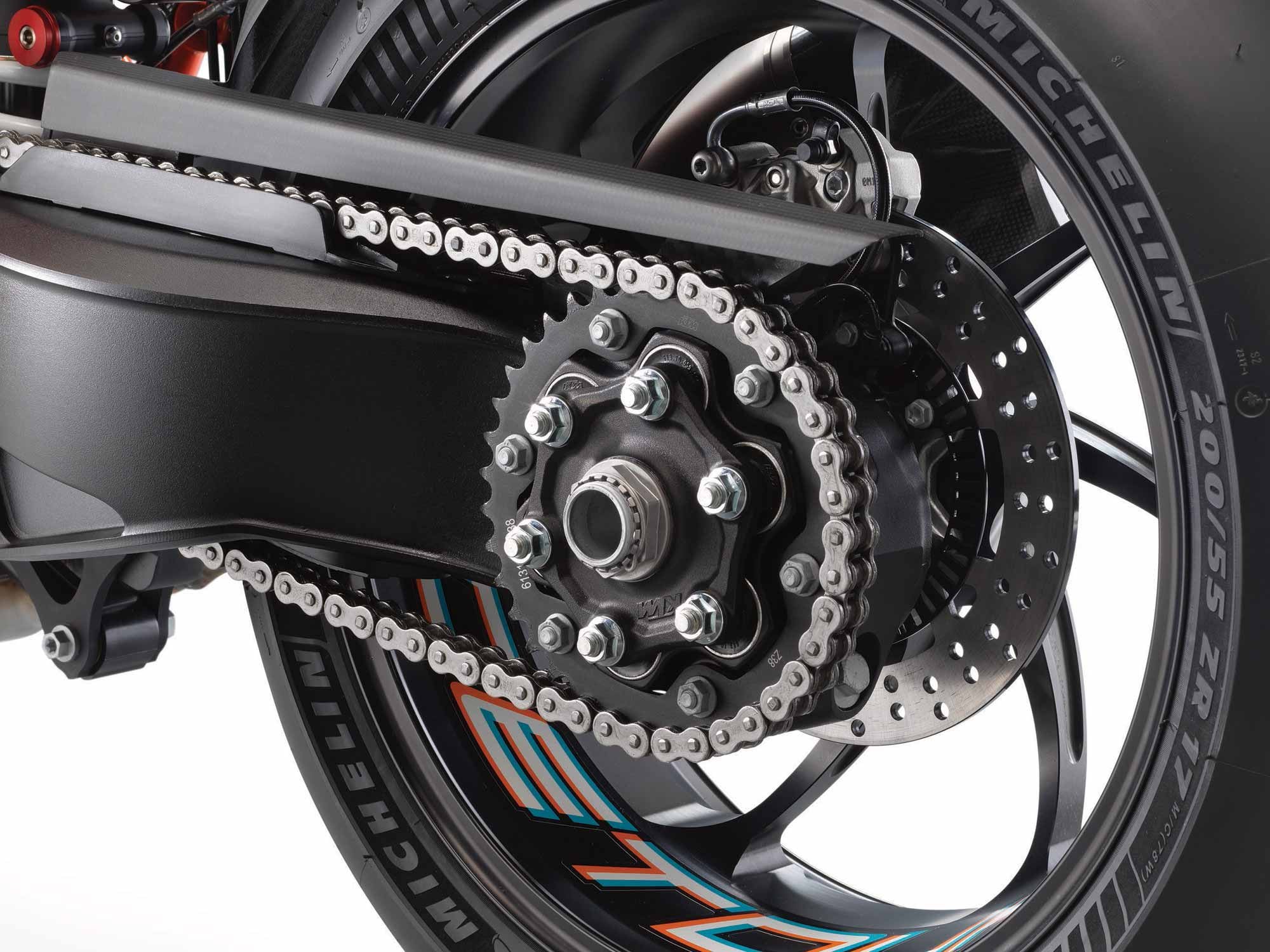

The swingarm wasn’t always a common component of a motorcycle, despite Indian offering swingarm rear suspension as early as 1912.
The swingarm wasn’t always a common component of a motorcycle, despite Indian offering swingarm rear suspension as early as 1912. (KTM/)
The first swingarms were basically nothing but three pieces of pipe welded together, and desperately needed more stiffness. The swingarm-pivot bolt passed through the middle piece, and the rear axle joined the ends of the two beams.
Single-Sided Swingarms
Back in the early days of motorcycle chassis experimentation, the French fuel company Elf (and, later, Elf-Honda) created a single-sided swingarm to speed up wheel changes in endurance racing; with no axle to pull out, as a stub live axle on its own bearings projected from the single robust swingarm beam, wheel changes could be as fast as for race cars. For whatever reason, this so tickled the public fancy that both Honda and Ducati have offered production bikes with single-sided swingarms. Even the current Gold Wing, far removed from a racebike, offers the feature.
