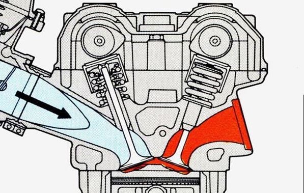

What does a narrow-included-angle four-valve head look like these days? This KTM is a fine example. As engineers learned more and more, the included angle inevitably tightened up.
What does a narrow-included-angle four-valve head look like these days? This KTM is a fine example. As engineers learned more and more, the included angle inevitably tightened up. (KTM/)

Honda’s RC30 V-4 was pretty exotic for a 1988 streetbike, with its 38-degree included valve angle and compact combustion chamber. But just a few years later, when the RC45 showed up, the valve angle had narrowed to 26 degrees.
Honda’s RC30 V-4 was pretty exotic for a 1988 streetbike, with its 38-degree included valve angle and compact combustion chamber. But just a few years later, when the RC45 showed up, the valve angle had narrowed to 26 degrees. (Honda/)
