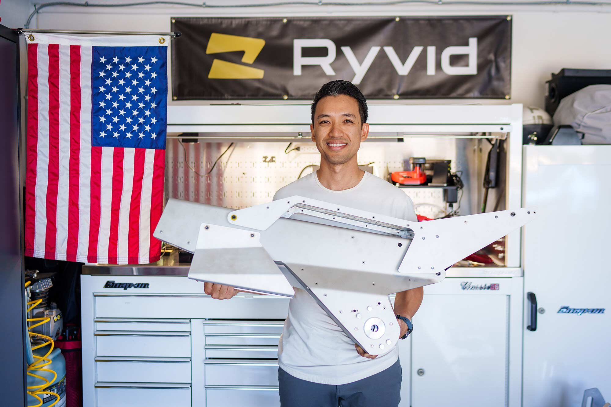

E-bike stan and man with a plan Doug Tran holds Ryvid frame and seat pan.
E-bike stan and man with a plan Doug Tran holds Ryvid frame and seat pan. (Ryvid/)

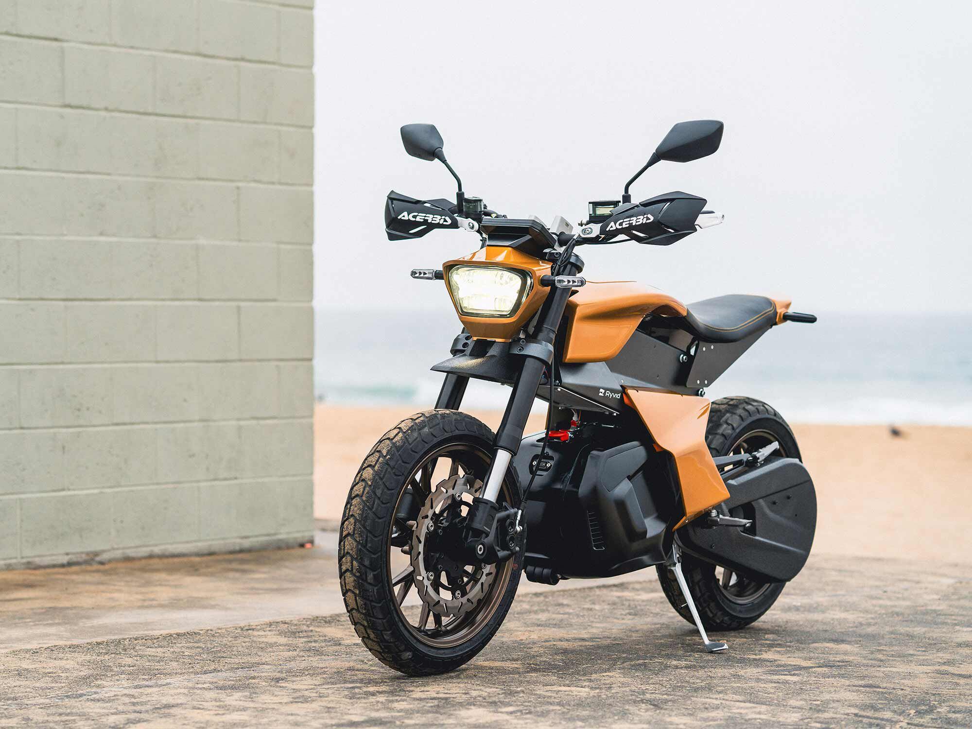

The $7,800 Anthem is a first step in that direction, a modular design that can be different things for different markets, and a machine designed around the limitations of a start-up motorcycle company. Its frame is made from flat 316-stainless-steel plates, laser-cut and riveted together; there’s not a single weld in sight. The steering head is modular and can be easily substituted with a different design to offer different chassis geometry.

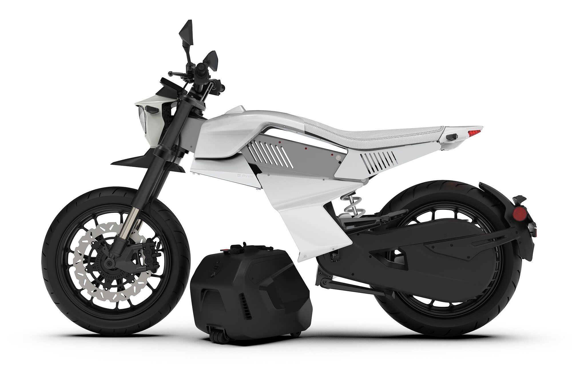

What you see hanging in the lower front of the bike, where an internal combustion engine might be on a conventional bike, is a removable battery pack, equipped with wheels so it can be wheeled to a remote location for charging. The pack itself uses cells from Farasis, the American/Chinese brand that has been used in every Zero motorcycle for the last decade; the Anthem pack carries 4.3 kWh of them.
The Ryvid’s removable 4.3 kWh battery pack. Note the clever rollaboard wheels.
The Ryvid’s removable 4.3 kWh battery pack. Note the clever rollaboard wheels. (Ryvid/)

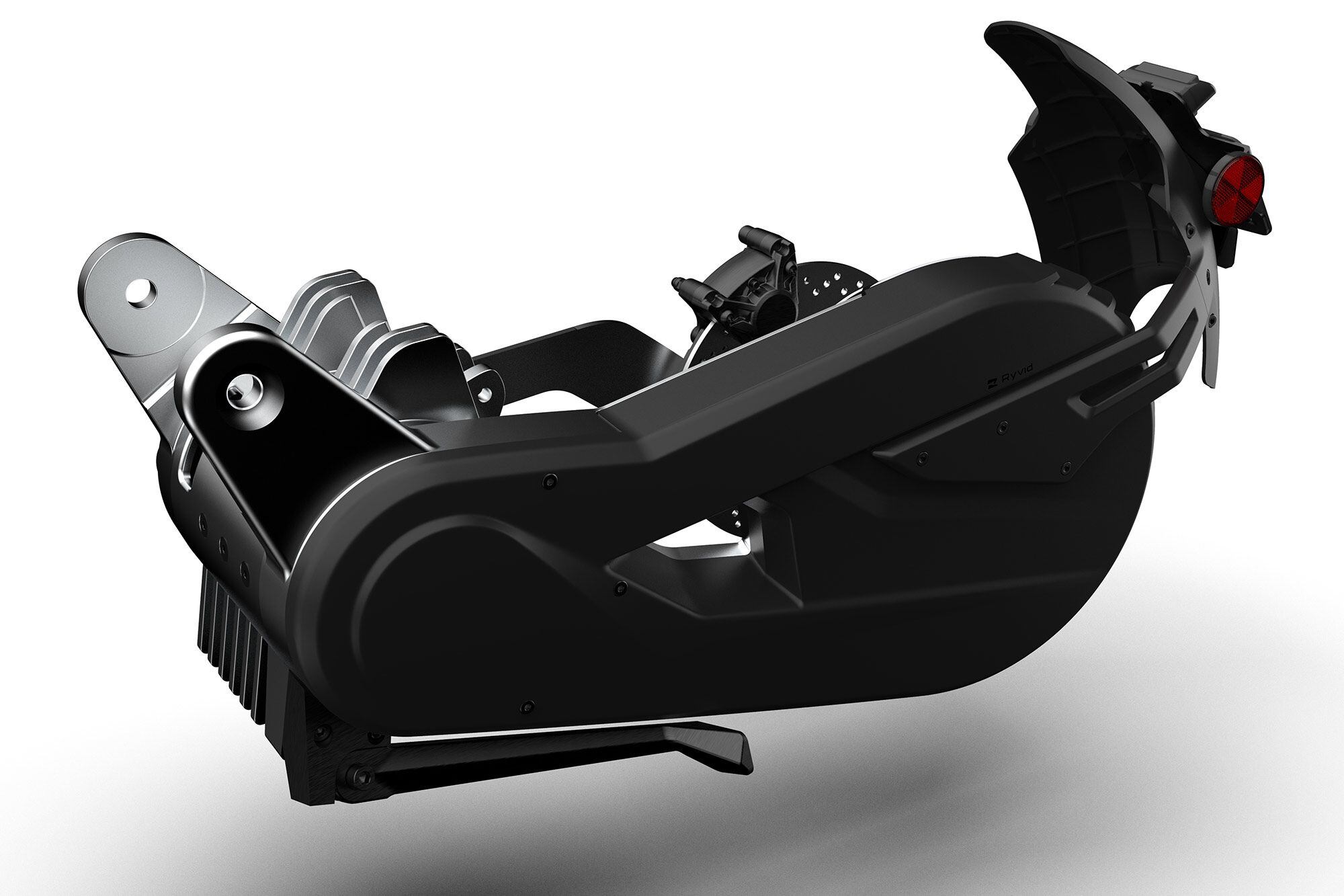

Aft of the pack is the stainless-steel frame and an integrated motor/swingarm, generally like the design that’s commonly used on internal-combustion-engined scooters. The motor doesn’t mount to the frame, but directly to the swingarm, and drives the rear wheel through a long-lived Gates belt that’s fully enclosed inside the swing arm. The original BMW electric scooter, the C Evolution, used a similar design. All three designs, ICE scooters, the BMW C Evolution, and the Ryvid Anthem, take advantage of the fact that the swingarm doesn’t move very much at points close to the pivot; a heavy electric motor can be hung there and have minimal effect on the unsprung weight, because it moves only a small fraction as much as things back by the axle. For the Anthem, the aluminum swingarm also acts as a heatsink and a cooling surface for the motor. In addition, the entire drive system can be pre-assembled off the main assembly line, just plugging into the chassis.
With the 65-pound battery carried low and forward, and the motor also low, the center of gravity of the Anthem should be far less than for most motorcycles. According to Tran, that’s indeed the case, and he says that the already light 240-pound Anthem “feels like an e-bicycle.”
The Anthem’s motor is mounted to the swingarm scooter-fashion, which may seem odd but makes all kinds of engineering sense.
The Anthem’s motor is mounted to the swingarm scooter-fashion, which may seem odd but makes all kinds of engineering sense. (Ryvid/)
