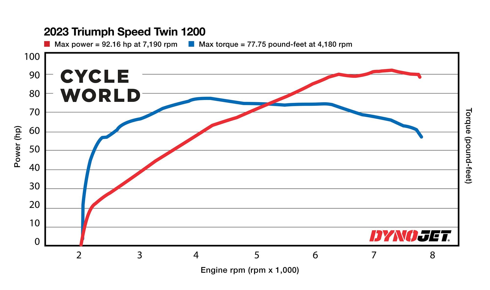

The 2023 Triumph Speed Twin 1200 horsepower and torque figures recorded on the Cycle World dyno.
The 2023 Triumph Speed Twin 1200 horsepower and torque figures recorded on the Cycle World dyno. (Robert Martin Jr./)
In anticipation of our upcoming comparison test of similar retro-modern models, we put the Speed Twin 1200 to the test on the Cycle World dyno to record horsepower and torque measurements. The Twin ripped 92.16 hp at 7,190 rpm and an impressive 77.75 lb.-ft. of torque at 4,180 rpm. For reference, that’s a very slight increase in horsepower compared to the last iteration of the Speed Twin we tested, which produced 91.4 hp. It’s also a slight decrease in torque to the 79 lb.-ft. of torque that the last Speed Twin recorded.
