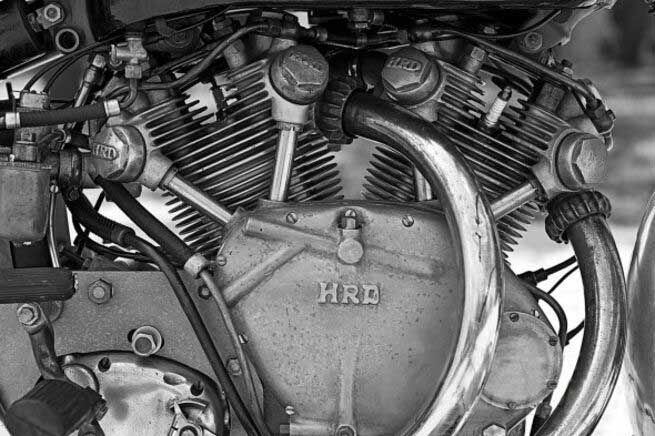

The method of adding the second connecting rod varied. Harley and Indian placed the two rods in the same plane by attaching them to the single crankpin, fork-and-blade style. Curtiss added a boss to the big-end of the first or “master” rod and attached the link or “slave” rod to it with a pin. Vincent, and others, placed the two rods side-by-side on the single crankpin.

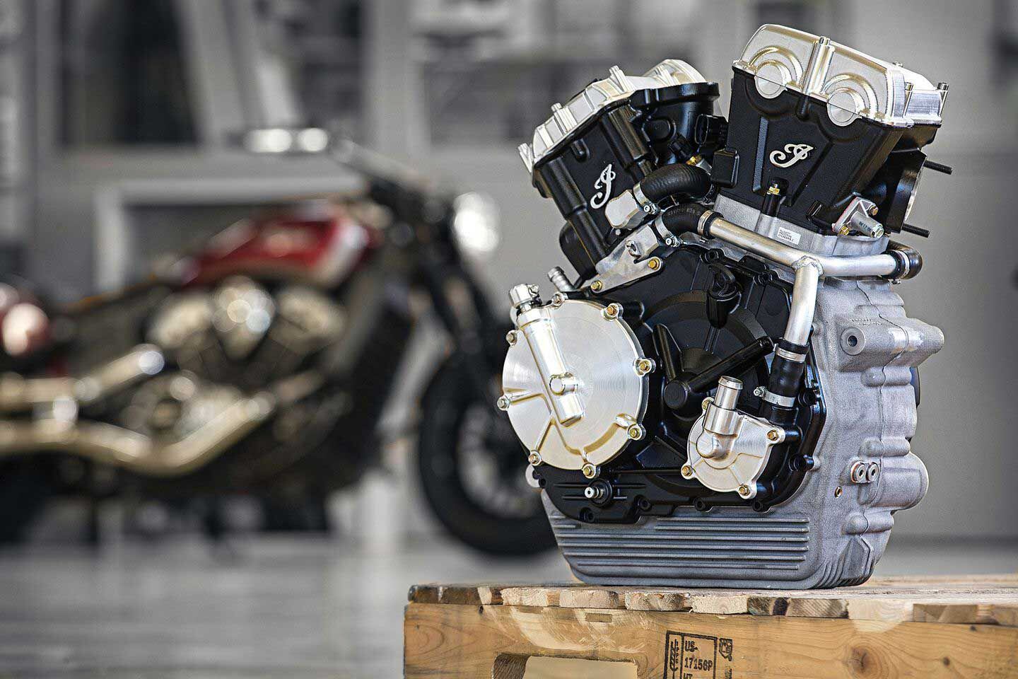

Aprilia wanted to avoid the extra engine length of a 90-degree V (for years this was a problem for Ducati, who only gradually addressed it), so it decided to close it 1,000cc RSV Mille’s cylinders to a more compact 60 degrees and handle the resultant primary shaking with dual balance shafts. Harley, too, chose 60 degrees for its VR1000 Superbike racer project. In the case of Erik Buell’s Rotax-built twins, a 72-degree V angle was chosen to allow more room for its intake system. Yet when Indian subsidiary Swissauto designed the FTR dirt-track race engine, the absolute need for a quick-responding short wheelbase pushed the choice to a narrower 53 degrees. Different priorities, different choices.
Indian’s FTR dirt-track engine designed by Swissauto.
Indian’s FTR dirt-track engine designed by Swissauto. (Jeff Allen/)

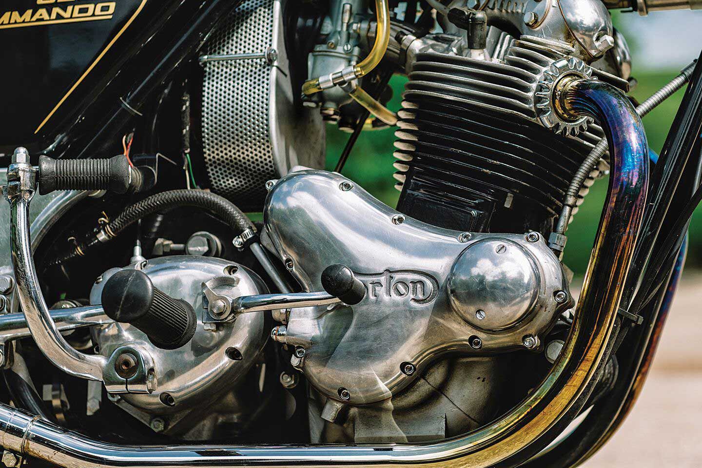

A Norton 850 parallel twin.
A Norton 850 parallel twin. (drew ruiz/)

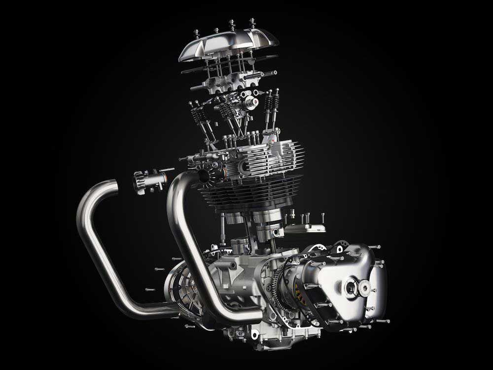

These new-generation twins offer something else: 270-degree crankpin spacing, something which Vincent engineer Phil Irving (author of the classic text Motorcycle Engineering) recommended back in the 1950s. Why? With crankpins at either 360 or 180, both pistons are stopped at top and bottom center, imposing an “inertia torque” on the crankshaft. Having to start and stop both pistons simultaneously imposes a fluctuating load on the crank. This motivated Yamaha engineer Masao Furusawa, now retired, to give Valentino Rossi an inline-four MotoGP engine whose crankpins were spaced at 90 degrees to each other rather than the traditional 180. That fluctuating load from piston starting/stopping interfered with traction on the track; with Furusawa’s and Irving’s 90-degree crankpin spacing half the pistons are stopped while the other half are near their top speed. Thus they exchange energy with each other, and crankshaft instantaneous speed varies but little.
Royal Enfield’s 650 parallel twin utilizes a crossplane crankshaft. design.
Royal Enfield’s 650 parallel twin utilizes a crossplane crankshaft. design. (Royal Enfield/)

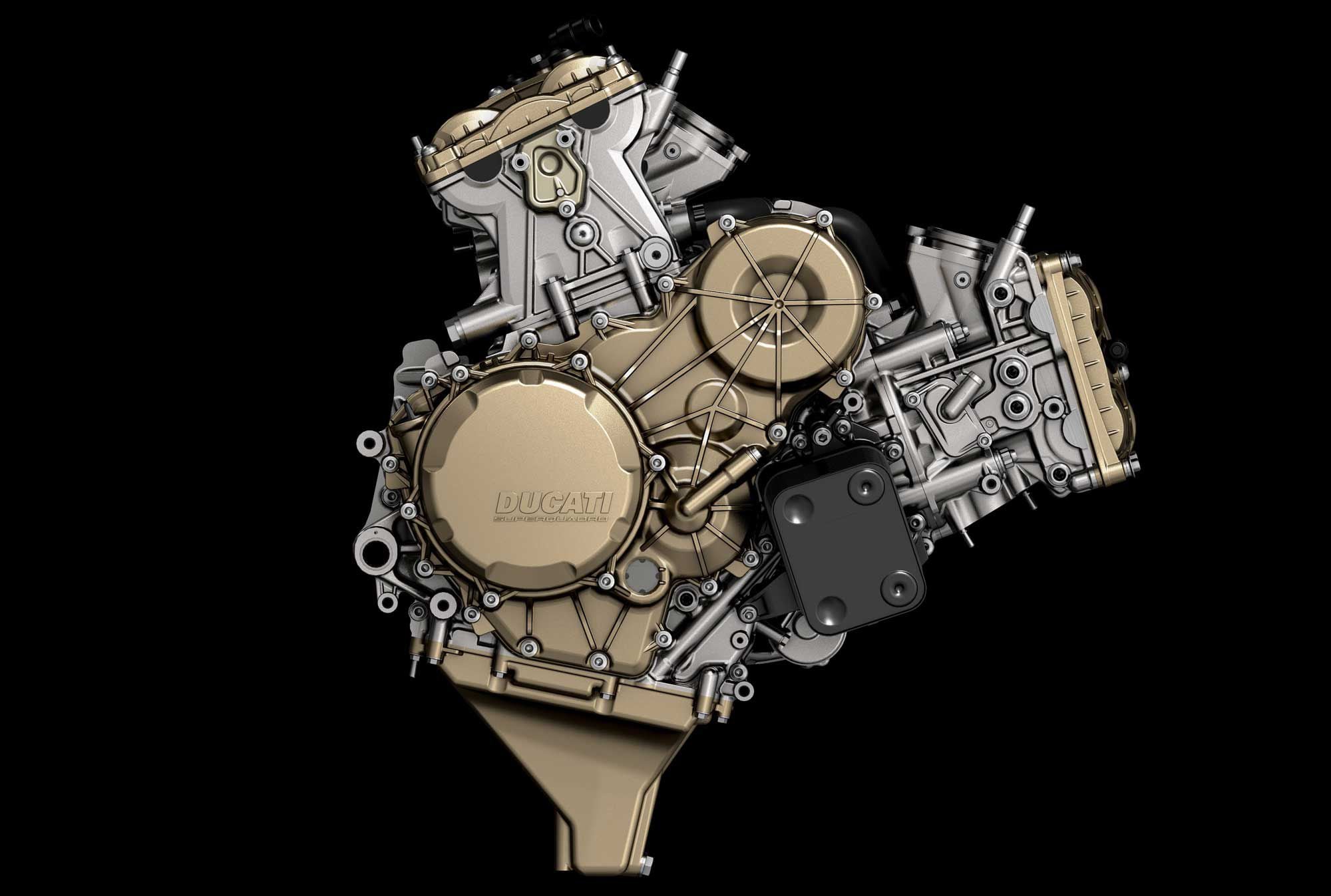

Chief engineer Fabio Taglioni knew the solution. By adding a second cylinder at right angles to the first he made a 90-degree V-twin. Placing counterweights on the crank able to balance 100 percent of one cylinder’s reciprocating weight (the piston, rings, pin, and the small-end of the con-rod) produced a twin with zero primary shaking force. This meant that unlike parallel twins, vibration was not a barrier to high-rpm operation. In 1972 when the late Paul Smart arrived for the Imola 200, he exclaimed in disbelief, “They’re telling me this thing makes peak power at 9,750 rpm! Is that even possible?” Ducati would go on to develop giant Superbike racing twins that were capable of more than 12,000 rpm despite giant bore sizes far over 100mm.
The 1,285cc 90-degree V-twin powering the 1299 Panigale.
The 1,285cc 90-degree V-twin powering the 1299 Panigale. (Ducati/)
