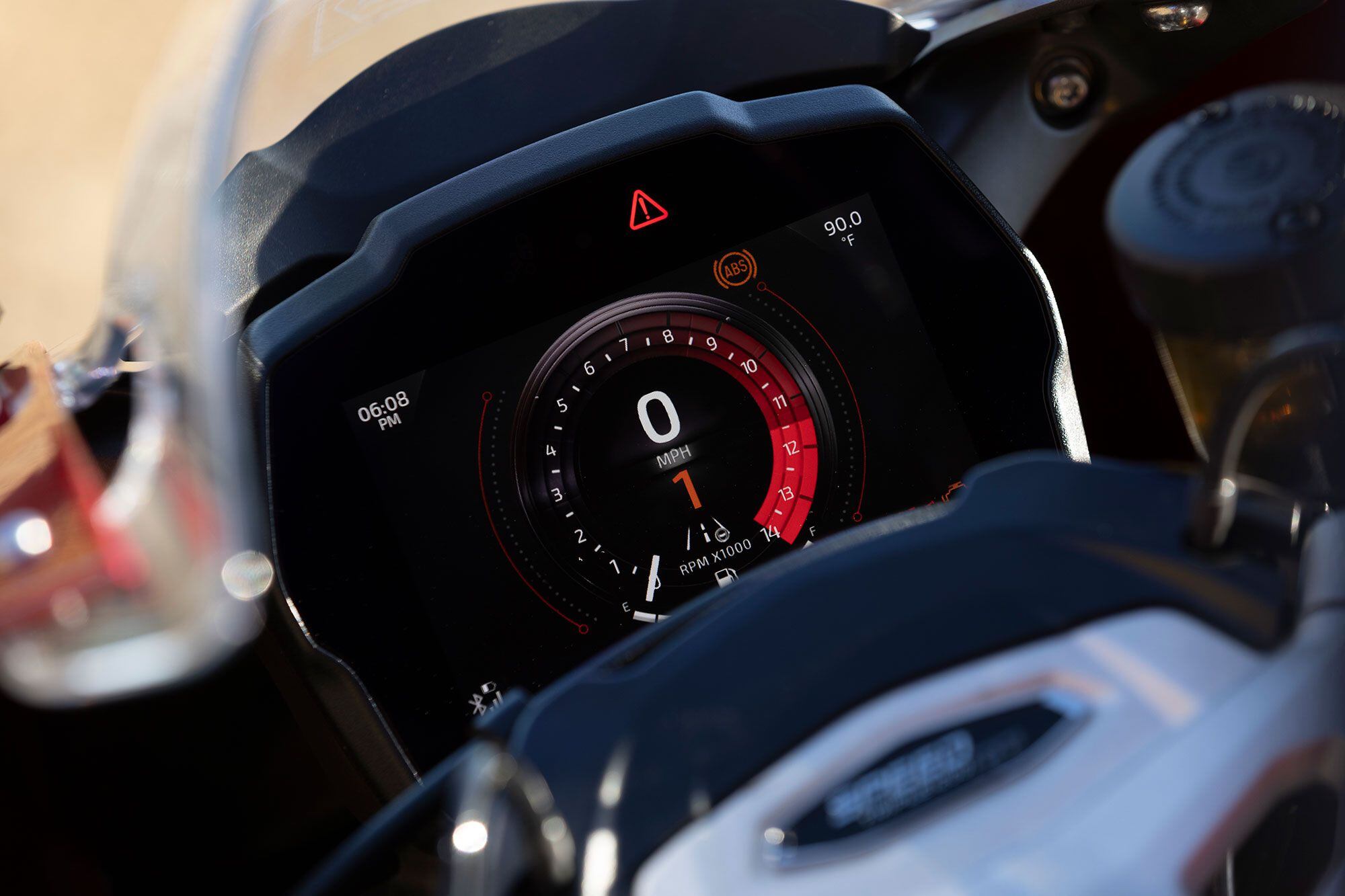

There are plenty of options to adjust through the Speed Triple 1200 RR’s 5-inch TFT dash.
There are plenty of options to adjust through the Speed Triple 1200 RR’s 5-inch TFT dash. (Adam Campbell/)
But complexity issues aside, there’s really no such thing as too many options for your ride. And riding the Speed Triple RR anywhere is pretty comfortable. It’s a snug fit, yet a good fit with the positioning and rider triangle falling somewhere between a hyper-naked and a hard-edged superbike. Even clocking 300-plus-mile days that mixed in both freeway and curvaceous roads in the hills, my 5-foot-10 body didn’t complain, thanks to the height of the clip-on handlebars and the easygoing footpeg distance relative to the CW-measured 32.7-inch seat height.

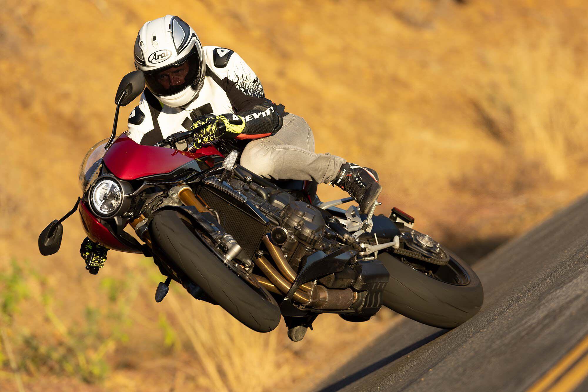

Comfort is impressive on the Speed Triple 1200 RR confidering how well it performs on the twists and turns of Southern California’s mountain roads.
Comfort is impressive on the Speed Triple 1200 RR confidering how well it performs on the twists and turns of Southern California’s mountain roads. (Adam Campbell/)
At any rate, the Speed Triple 1200 RR was never intended to be a track star. That’s all perfectly fine and dandy, because what the Triumph does best is reward the rider with heavy doses of giggles and grins. It’s an impressive streetbike that does a fantastic job around town, in the mountains, and through canyon twisties, all with sophisticated athleticism.

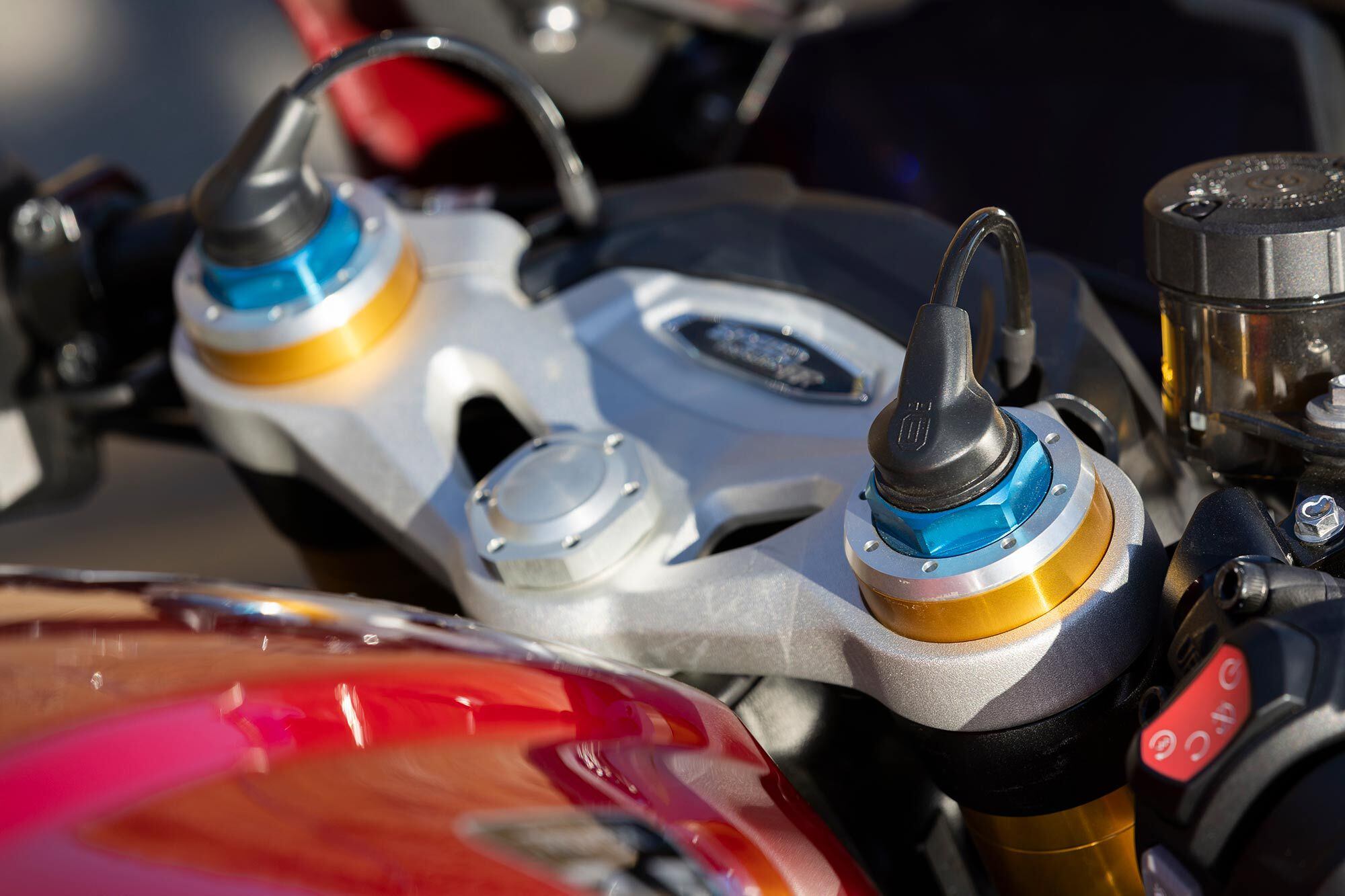

A 43mm Öhlins fork is electronically controlled and can be adjusted with the various riding modes.
A 43mm Öhlins fork is electronically controlled and can be adjusted with the various riding modes. (Adam Campbell/)
The S-EC 2.0 Öhlins suspension offers various predetermined damping settings based on the selected mode. Even within a selected mode, the rider still has a choice of different damping settings, which are applicable to that mode. Want to get a bit more personalized with your suspension settings? Just select one of the two Rider modes to open a menu that allows you to make more specific compression and rebound damping changes over a very broad range. The available suspension programming options even include three “fixed” options that are saved separately so it’s easy to toggle between, say, straight-line highway, twisties, and two-up riding without having to remember what settings you preferred.

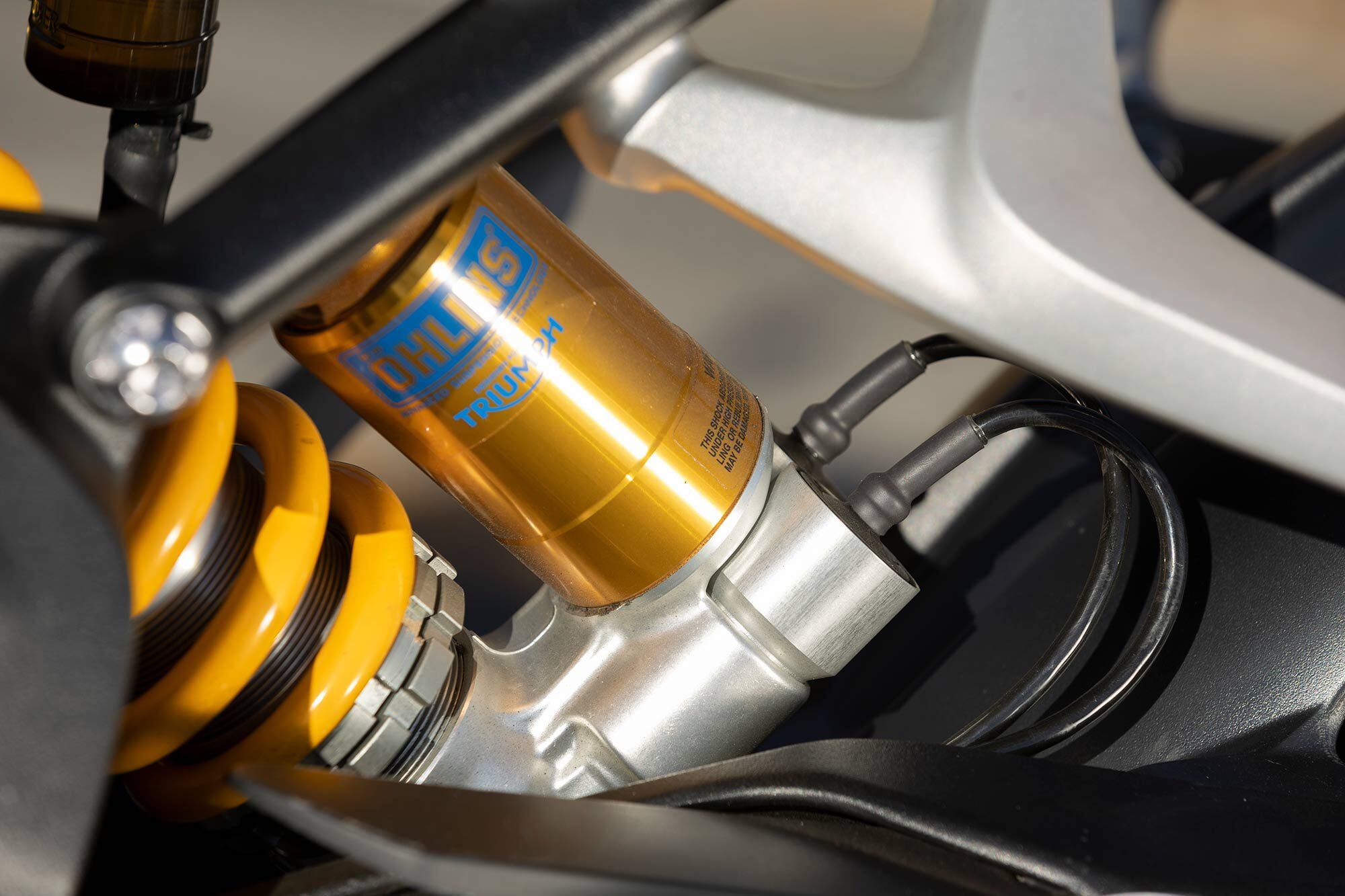

The Speed Triple 1200 RR’s S-EC 2.0 Öhlins shock.
The Speed Triple 1200 RR’s S-EC 2.0 Öhlins shock. (Adam Campbell/)
Triumph also makes this whole process simple, if you like. Four preprogrammed modes, Rain, Road, Sport, and Track, have very usable default settings. The two Rider modes, Road and Track, allow many options. You can also adjust the various internal default settings in each of the four preprogrammed modes or simply use the Dynamic setting, which constantly responds to road conditions.
More electronically programmed features within various modes of the RR suspension include Brake Support, Corner Support (in Dynamic mode only), and Acceleration Support (also in Dynamic mode only). Essentially, what happens is that for each type of Support, the rider can program the amount of damping assistance that occurs during braking, cornering, and acceleration to reduce front dive, keep the chassis geometry of 23.9 degrees of rake and 104.7mm (4.1 inches) of trail more consistent, and reduce rear squat based on data from the six-axis IMU.

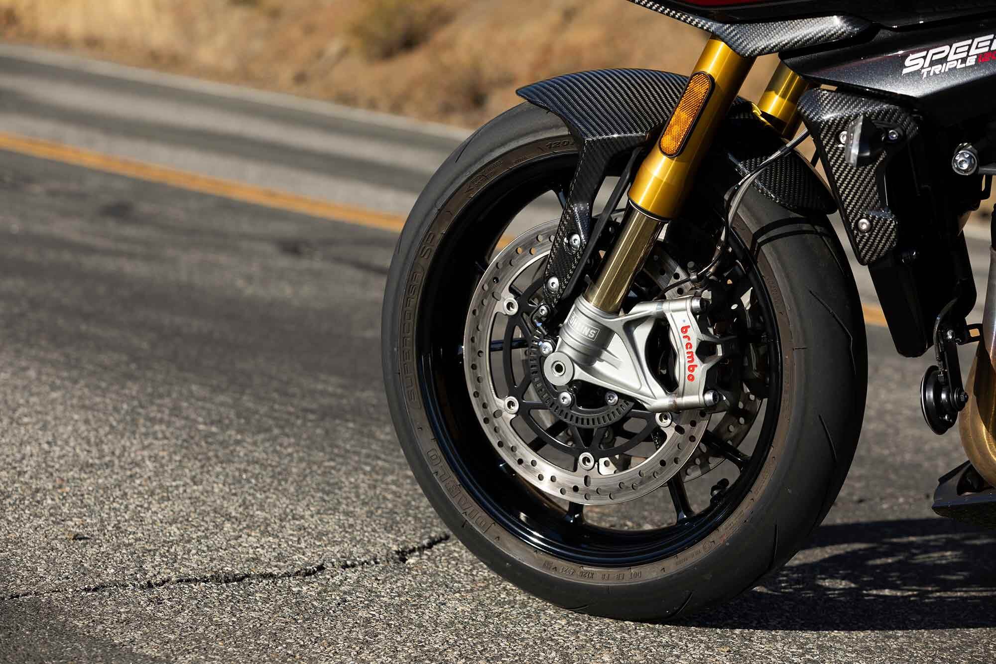

Brembo Stylema clippers and dual 320mm rotors slow the Speed Triple 1200 RR with authority and excellent feedback.
Brembo Stylema clippers and dual 320mm rotors slow the Speed Triple 1200 RR with authority and excellent feedback. (Adam Campbell/)
Braking duties up front include a Brembo radial MCS adjustable master cylinder with a piston diameter range from 19 to 21mm. It’s a pretty slick operation, allowing the option for different lever feel and firmness to better match the rider’s braking preference. The MCS master cylinder pushes the brake fluid through steel-braided lines to dual radial-mounted four-piston Monoblock Brembo Stylema calipers squeezing 320mm rotors; these can easily lift the rear wheel quite high in the Track ABS mode, as discovered during 60–0 mph braking tests. Rear braking duties include an inboard mounted Brembo twin-piston caliper acting on a 220mm rotor, all mounted to the aluminum single-sided swingarm.
The RR also enables various functionalities based on conditions for its Road and Track mode ABS and cornering ABS system. For example, in Road mode, the brakes include a linked brake function that is very transparent but becomes disabled when Track mode is selected. The same goes for “progressive brake applications” for anti-stoppie and cornering ABS, which are disabled during Track mode.

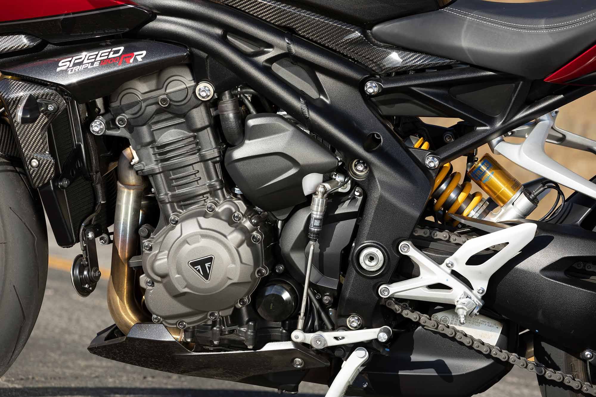

A 1,160cc triple powers the Speed Triple 1200 RR—of course.
A 1,160cc triple powers the Speed Triple 1200 RR—of course. (Adam Campbell/)
On the CW Dynojet 250i dyno, the four-valve, 13.2:1 compression 1,160cc triple lays down 150.5 linear horsepower at a relatively low, very usable 10,500 rpm. Match that with a constantly rising torque curve that peaks at 8,500 rpm with 82.6 lb.-ft. of grunt, and you’ve got remarkably smooth, almost electric, power delivery in a machine that tipped our scales at 443 pounds, full of gas. On the street, that makes it feel like the fabled gentleman’s superbike, and behave like one too; during top-gear roll-on testing, the Speed Triple took only 2.52 seconds to vault from 60 to 80 mph, and the big triple is just starting to wake up and pull even harder from there.

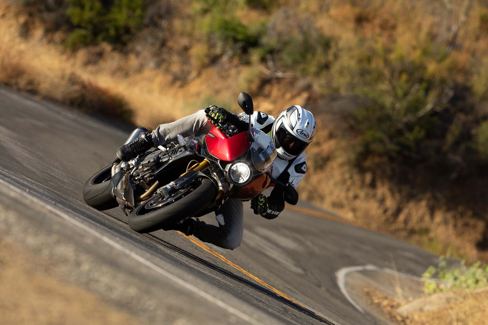

Riding at a spirited pace in the local mountains, the Triumph RR has an uncanny feel once all the support options and other available chassis and engine settings are dialed in. There’s an almost glued-to-the-road connection, as the RR’s 56.6-inch wheelbase is complemented by a reduced amount of front dive under light braking and lack of front/rear chassis pitching, all of which makes for a less active ride than one might expect.
This planted ride, smooth acceleration, seamless throttle-by-wire response, and the ability to click through the gears with the quickshifter all allow the Pirelli Diablo Supercorsa SP V3 tires to corner hard enough to easily use up the better part of the Speed Triple’s 4.7 inches of front and rear wheel travel.

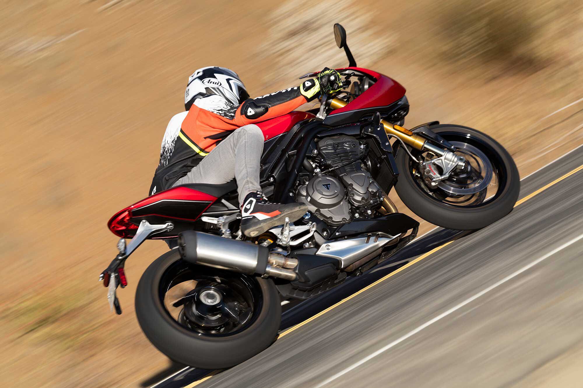

There’s plenty to like about the Speed Triple 1200 RR, and the 150 hp and 82 lb.-ft. to the rear wheel is near the top of that list.
There’s plenty to like about the Speed Triple 1200 RR, and the 150 hp and 82 lb.-ft. to the rear wheel is near the top of that list. (Adam Campbell/)
Shoppers care about fuel economy as well, as do we. While ripping around the hills, accumulating highway miles, and running errands, the 1200 RR managed to return anywhere from 27.2 mpg to 42.2 mpg out of the 4.1-gallon fuel tank. Given the somewhat relaxed rider comforts, a tank of gas seems to go pretty quick, both in the hills or on the highway, because the Triumph does not take a great deal of physical or mental energy to ride.

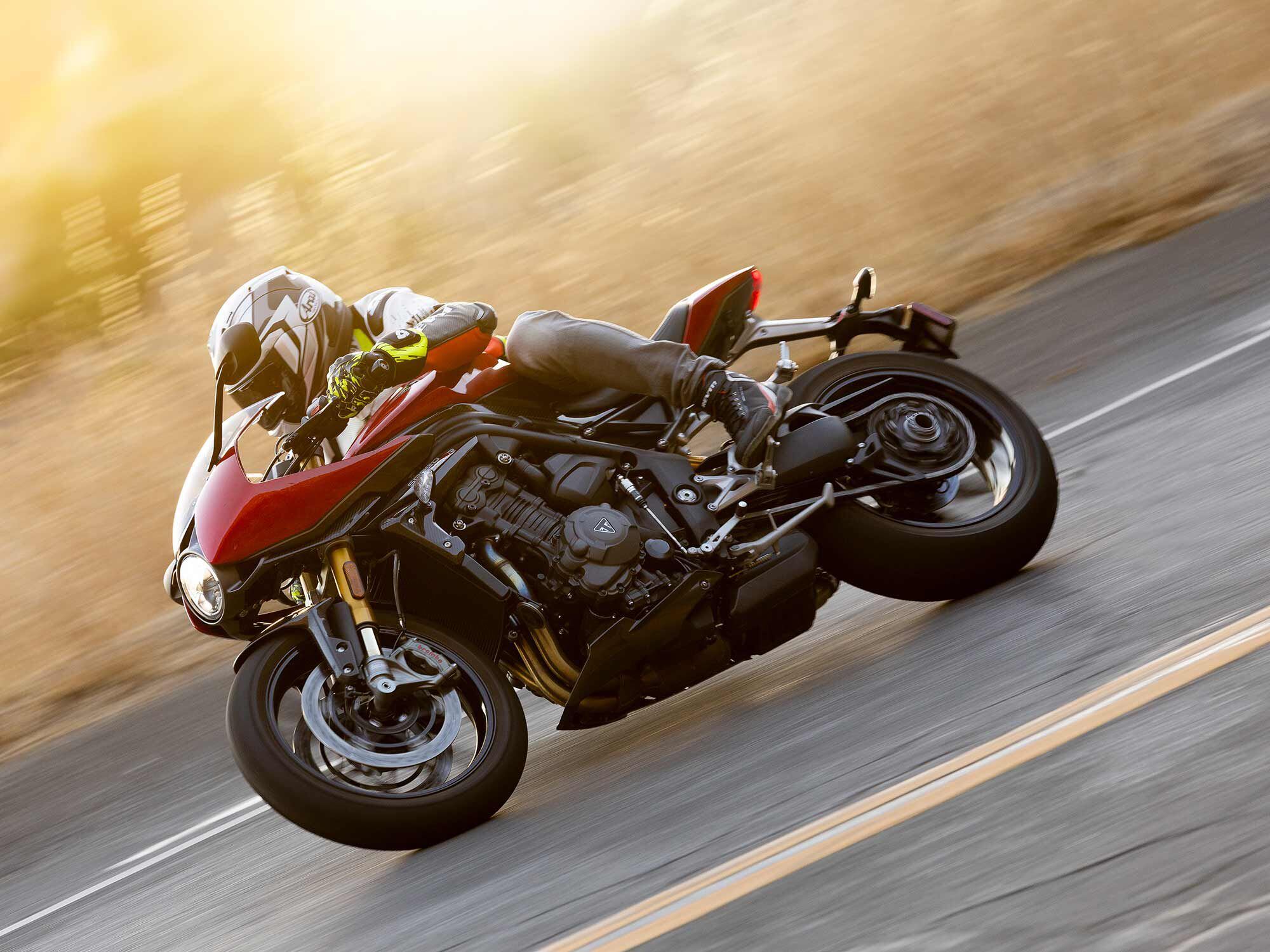

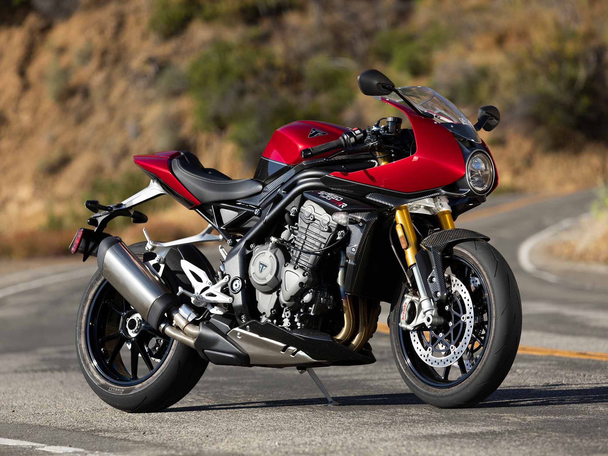

Rich red paint and plenty of carbon fiber suit the sublime character of Triumph’s Speed Triple 1200 RR.
Rich red paint and plenty of carbon fiber suit the sublime character of Triumph’s Speed Triple 1200 RR. (Adam Campbell/)
Taken as an entire package, the 2022 Triumph Speed Triple RR comes complete with the latest electronics, rider aids, and a top-level suspension that allows countless combinations. Combine that with silky-smooth power delivery, the inimitable triple exhaust note, and a relaxed riding position, and you’ve got the makings for easy all-day rides that will leave the rider unruffled. Yes, at an MSRP of $21,275, it may be a little pricey. Yet it’s a unique motorcycle with a subtle personality, a very different level of class, and style like nothing else.
