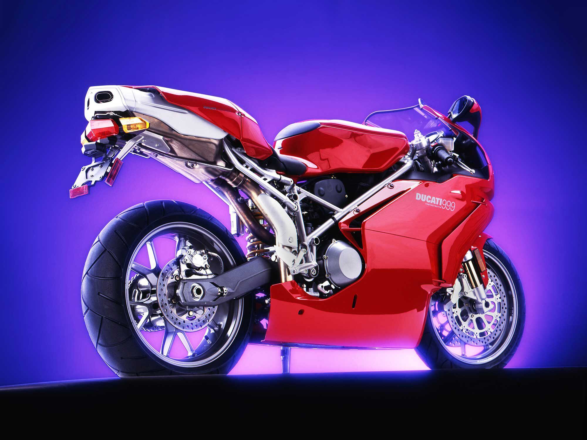

2003 Ducati 999S
If you’re too young and missed how polarizing the Pierre Terblanche-designed 999 was back in 2003, you only need to read the opening paragraph of Cycle World’s test, written by then-editor David Edwards: “Nay-sayers, armchair industrial-design critics, unwavering disciples of the Great 916, Tamburini-is-God partisans—all due respect—but now is the time to shut yer yaps. Ducati’s new 999 is about to hit U.S. showrooms, and up close and in the metal it is a stunning piece, spectacular, sublime even. All of a sudden, most other sportbikes look as if they were drawn with a blunt crayon.”
Related: Lessons Learned, Challenges Overcome, Part 2
When the 999 was first shown, Ducati fans around the world were shocked by the huge styling change.
When the 999 was first shown, Ducati fans around the world were shocked by the huge styling change. (Cycle World Archives/Brian Blades/)
That passage, whether you agree with its bold claims or not, should give you a sense of how much negative buzz Ducati generated when it dared make a radical design departure from its 998, a bike almost universally regarded as one of the best designs of all time. Despite the criticism, one thing was for certain: The new 999 was a better superbike. Getting down to the nuts and bolts of things, the 999′s Testastretta 90-degree “L” twin had 100mm by 63.5mm bore and stroke measurements and displaced 998cc, measurements identical to the version in the 998. But there were some important improvements in performance, thanks to a pressurized airbox and new exhaust. Plus, with easier access to the cam belts on the right side of the engine, it took significantly less time to adjust the belts and the desmodromic valvetrain.
Despite producing what now seems like a paltry 116 hp, the 999 showed impressive on-track performance back in the day.
Despite producing what now seems like a paltry 116 hp, the 999 showed impressive on-track performance back in the day. (Cycle World Archives/Brian Blades/)
Our testing at the time found that the engine produced 116.4 hp at 9,500 rpm and 70.1 lb.-ft. of torque at 8,580 rpm. That might not sound that impressive in a world of legitimate near-200 hp superbikes, but at the time those were very good numbers for a V-twin. The 999 ran a 10.39-second quarter-mile at 133.31 mph and recorded a measured top speed of 167 mph.
In 2003, the suggested price of the 999S was $17,695, which we can assure you was a lot of coin for a sportbike when compared to Japanese models, such as the Suzuki GSX-R1000 ($10,499), Yamaha YZF-R1 ($10,299), Honda RC51 ($10,999), and Kawasaki ZX-9R ($9,499). Adjusting for inflation, the 999S would sticker at $27,803 in today’s money, or roughly the price of a new Panigale V4 S at $29,995.
The 999 was polarizing at the time to be sure, but it was also a very good motorcycle. But you had to pay the price in terms of MSRP and required maintenance.
The 999 was polarizing at the time to be sure, but it was also a very good motorcycle. But you had to pay the price in terms of MSRP and required maintenance. (Cycle World Archives/Brian Blades/)
The 999′s service manual recommends valve-adjustment intervals of 6,200 miles, which most certainly makes it a bit of a prima donna, especially since it was not an improvement over the bike it replaced. And when compared to the 2003 Suzuki GSX-R1000, which had 15,000-mile recommended valve-check intervals, made 147 hp and 76 lb.-ft. of torque, and was $7,000 less expensive, prospective buyers really had to be in love with the 999.

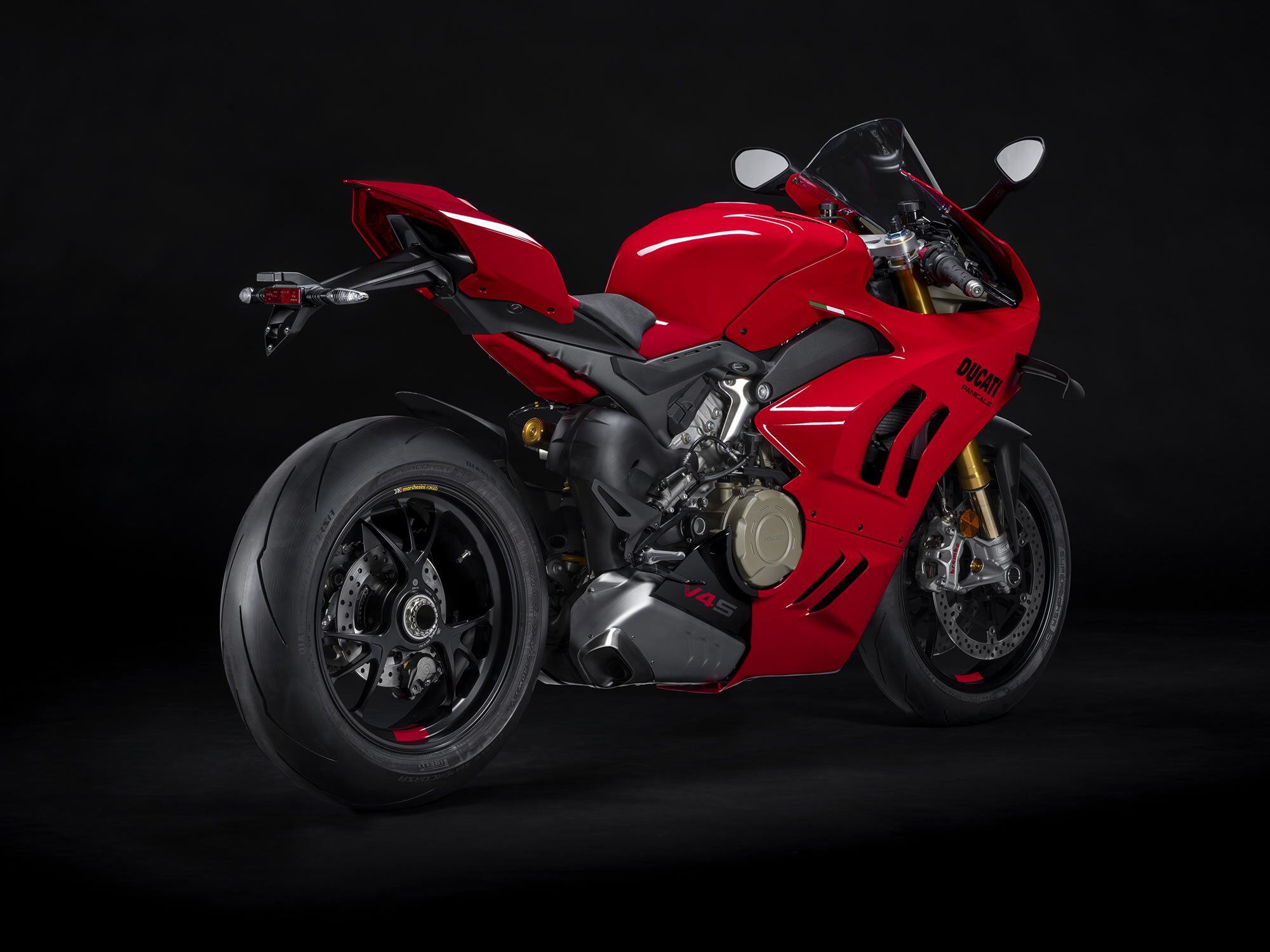

2022 Ducati Panigale V4 S
Turning our eyes back to model year 2022, we find a Panigale V4S getting a host of updates and changes to improve upon an already impressive motorcycle. From Bruno dePrato’s first look: “The first hints of the new model can be seen in its bodywork, which has been updated both aerodynamically and ergonomically. Wind tunnel testing at the Dallara Automobili R&D department helped improve the Panigale’s overall drag numbers and engine-cooling airflow.
Ducati’s Panigale V4 S is proof of massive progress over the past 20 years.
Ducati’s Panigale V4 S is proof of massive progress over the past 20 years. (Ducati/)
“The 1,103cc V-4 (81mm bore and 53.5mm stroke) now complies with full Euro 5 homologation. In the process it gained 1.5 hp and now puts out 215.5 hp [claimed] at 13,000 rpm. Rev the engine to 14,500 and you get another 2.5 horses. While torque remains unchanged at 91.2 lb.-ft. [claimed], that number comes up at 9,500 rpm, 500 revs below the previous peak. The torque curve has also grown flatter: 80 percent of peak twisting force is already available at 6,000 rpm. A new exhaust system features a final-duct diameter increased to 38mm, 18 percent larger than the 2021 version.”
The last Panigale V4 S that we put on the Cycle World dyno, back in 2019, produced 186 rear-wheel horsepower at 13,320 rpm and 79.6 lb.-ft. of torque at 11,310 rpm. Note the numbers mentioned above are manufacturer-claimed output measurements at the crankshaft.
Two decades on, the Panigale V4 S not only needs to visit the dealership far less for scheduled maintenance, but produces 70 more horsepower than the 999.
Two decades on, the Panigale V4 S not only needs to visit the dealership far less for scheduled maintenance, but produces 70 more horsepower than the 999. (Ducati/)
Think about that progress for a moment. In the roughly 20 years separating these two machines, Ducati has managed to extract an additional 70 hp and increased peak torque by more than 10 lb.-ft. with just a 105cc displacement increase to its premium superbike engine. All the while engineers had to grapple with increasingly stringent emissions regulations. An amazing feat on its own.
And it isn’t just engine power that improved. The Panigale’s performance is on a totally different level. The most recent V4 S we tested didn’t even have the latest 2022 updates, but recorded a 9.76-second, 155.08-mph pass through the quarter-mile. That’s 22 mph faster. As a matter of fact, the current Monster, with its Testastretta V-2 11-degree engine, has about the same performance as the 2003 999S. Ducati has come a long way.
